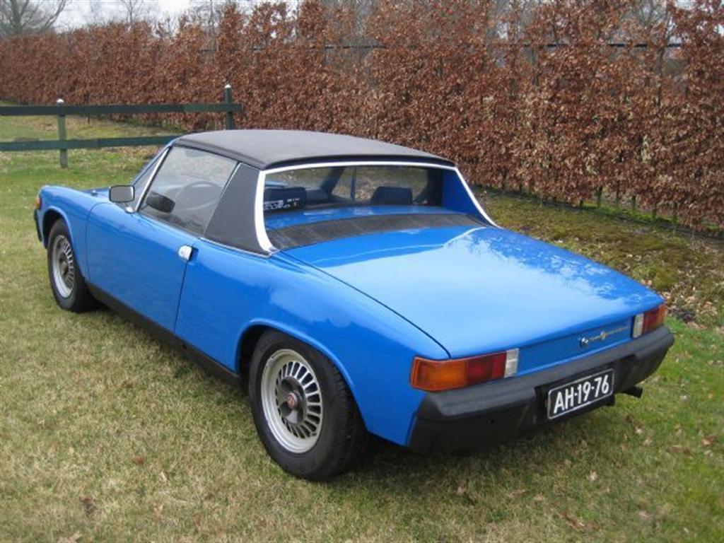

As I bought my dream car, the 914, I want to share some project details. For a long time I was looking for a 914, this little one was always standing on op of my monitor at work:
(IMG:http://www.914world.com/bbs2/uploads_offsite/static.skynetblogs.be-14329-1334958638.1.JPG)

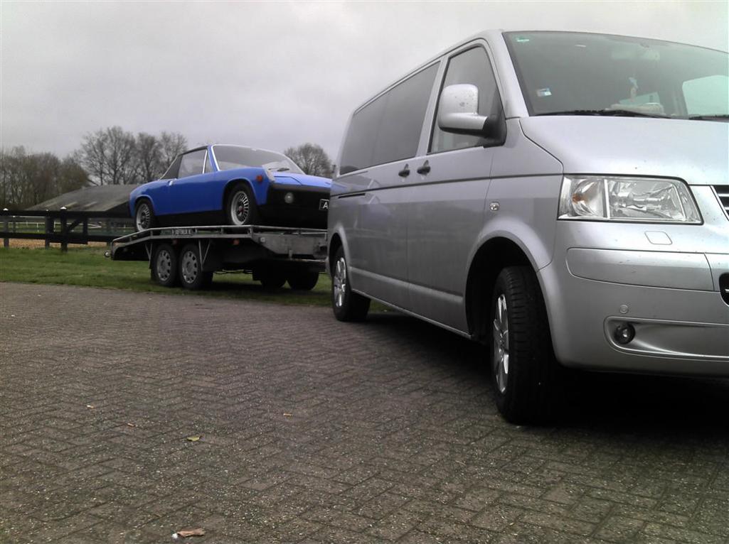

I passed some 914's but due to no guts / no money -> but a few weeks ago I couldn't resist this one:
As the car was not starting / needed some work, my boss (Kieft from Kieft en Klok, thanks Gert) helped me to get it to base:
A week later I swapped the headlight relais for the fuel pomp relais, overhauled the fuel pump, and she was starting. I drove a round (actually my first meters in a 914 (IMG:style_emoticons/default/smile.gif), knowing that the next job was get rid of the standard type 4 oil leakage.
I'm not going for the full resto, except the engine and brakes will need a lot of my TLC, so more photo's will follow.

(IMG:style_emoticons/default/welcome.png) Nice wheels! must be some VW fitment. I have never seen them before. (IMG:style_emoticons/default/idea.gif)

Nice to see a real Euro versions of the 914. I'm trying to create one from a USA model in Canada. I can't wait to see some detailed pictures of the interior.
I love Holland, it has the 3B's -Beer, Bikes and Blondes. I have Family in Henglo!
Nice 914 by the way! Just noticed it's a US version.....or did someone just add the front markers "warts"

Wheels look Italian possibly.

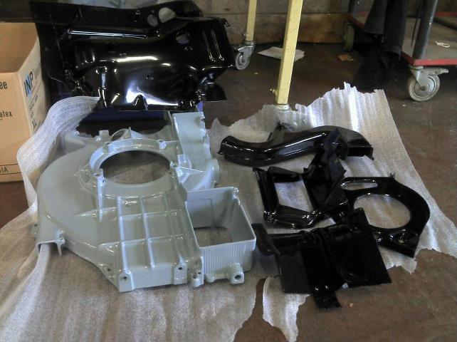

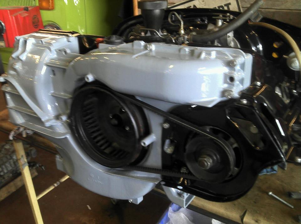

It has been a while, but I'm back on track. Got the engine cooling parts powder coated,

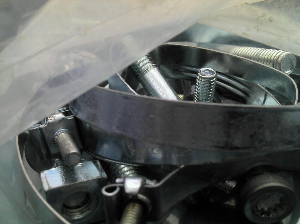

all the bolts has been galvanized,
the heat exchangers are sandblasted and sprayed again,
and past weekend I did some engine rebuilding,
Still waiting for some parts (clutch bearing, muffler, and some gaskets), but soon the engine will be mounted in the car again (IMG:style_emoticons/default/smile.gif)

@ Strudelwagon: It's an Italian car, and they have the 'different' markers as well, just like the US

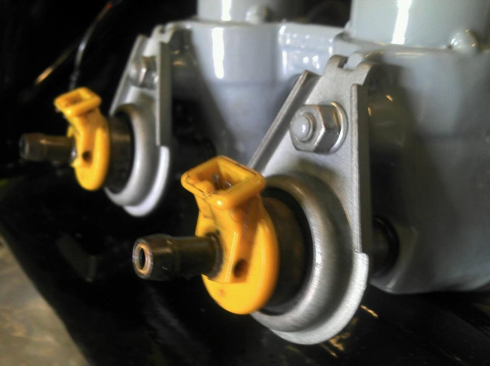

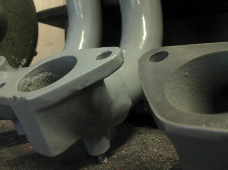

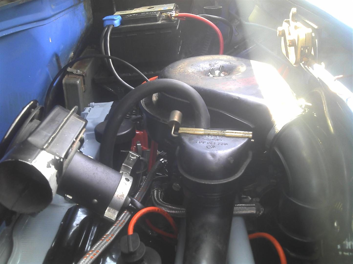

So 2 days of work and we have some new pics. First tested the injectors and mounted them after testing (they didn't leak and sprayed beautifull:):
(IMG:http://www.914world.com/bbs2/uploads_offsite/a4.sphotos.ak.fbcdn.net-14329-1337530236.1.jpg)

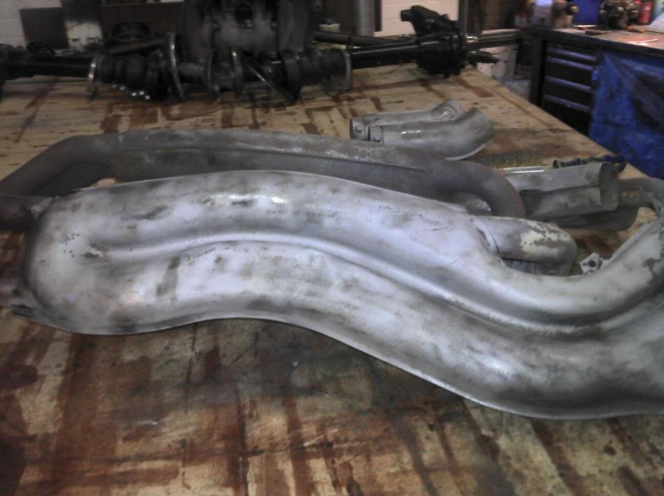

Get rid of some powder coat:
(IMG:http://www.914world.com/bbs2/uploads_offsite/a6.sphotos.ak.fbcdn.net-14329-1337530236.2.jpg)

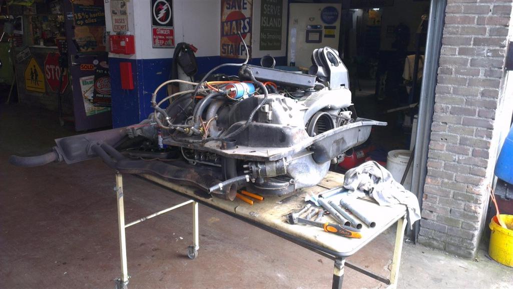

And mounted the gearbox with new bearing and mounted the heat exchangers:
(IMG:http://www.914world.com/bbs2/uploads_offsite/a5.sphotos.ak.fbcdn.net-14329-1337530236.3.jpg)
Next week some wiring and mount everything back in place!!!

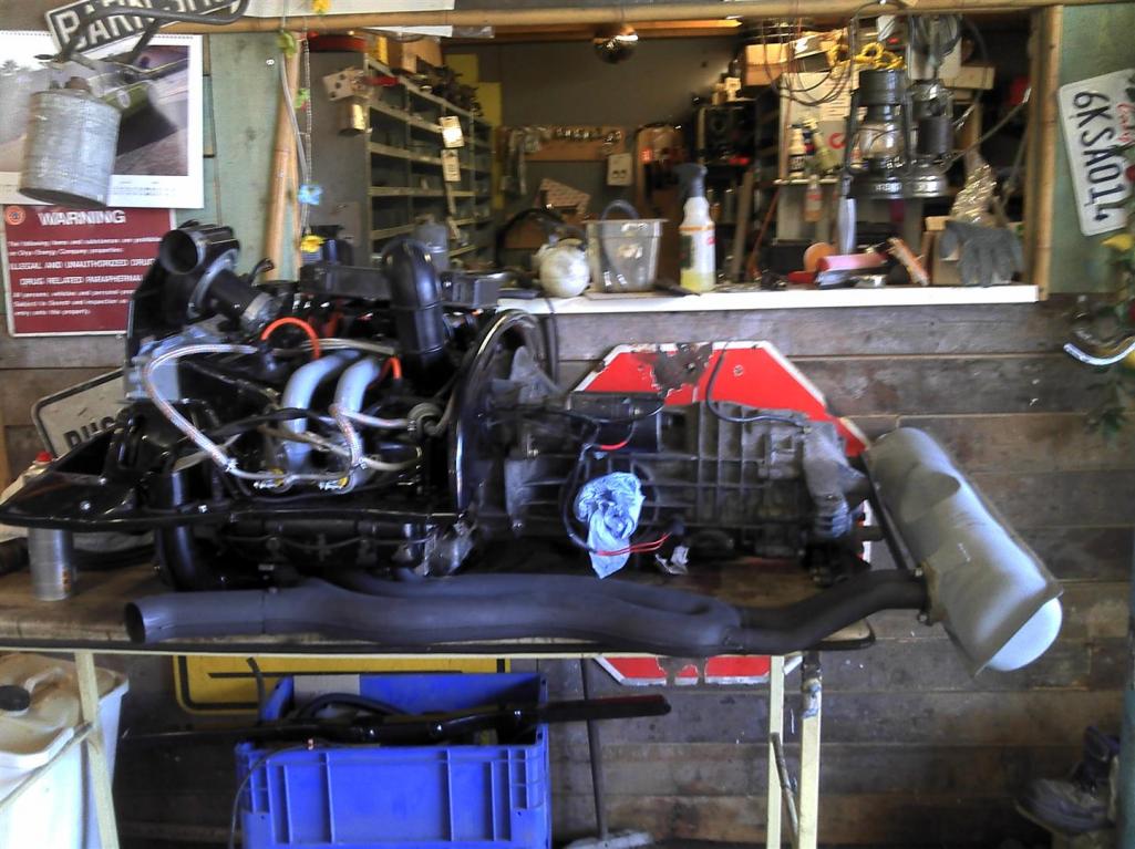

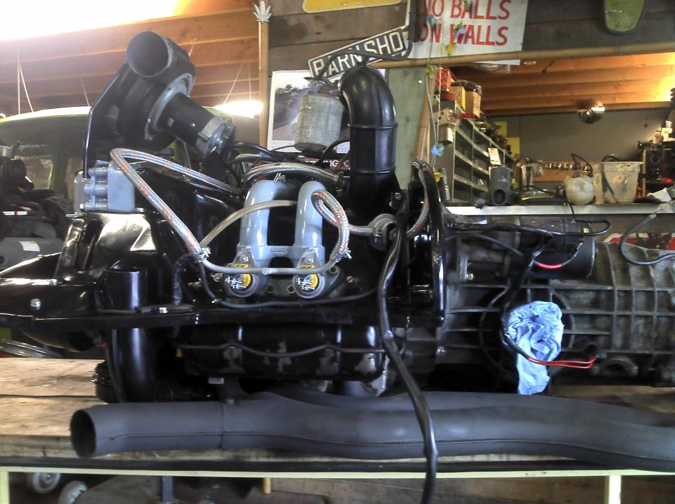

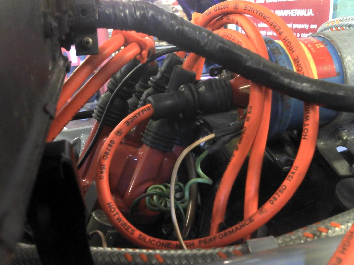

Engine and gearbox ready to be mounted back in the car:
And as a true dutchmen, off course orange HT leads:
Next weekend I'll try to put the engine and gearbox, back in the place they belong (IMG:style_emoticons/default/smile.gif)

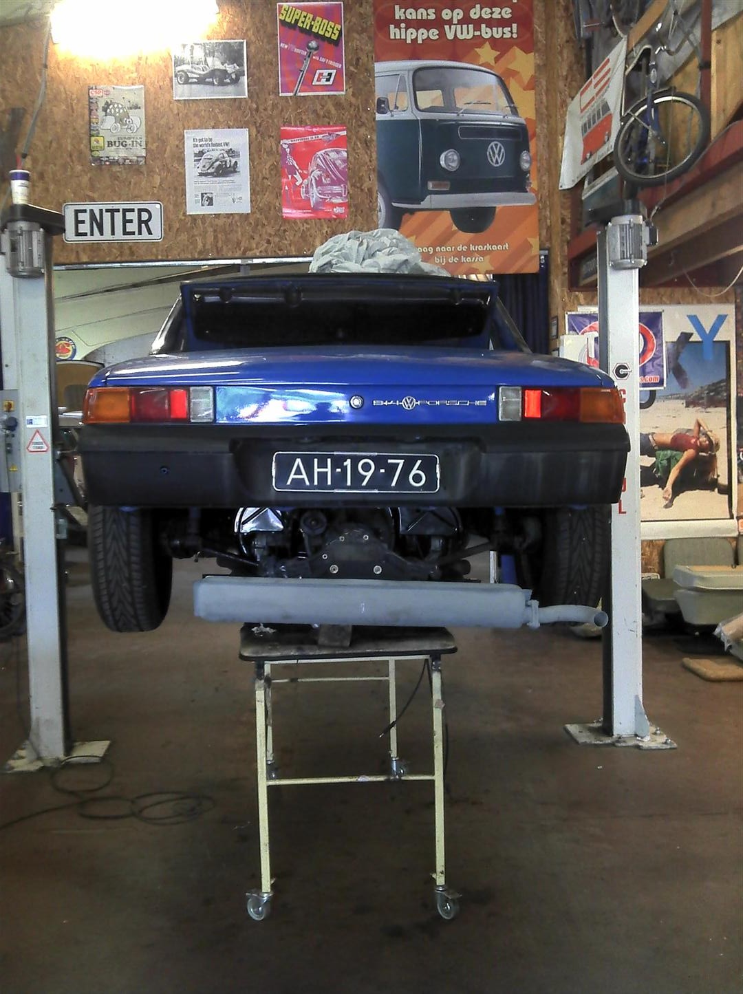

So a few weeks later:
Engine back in the car. Easy job, I expected it to be more difficult, but it was lower the car and an hour later done. And that for a 914 noob (IMG:style_emoticons/default/smile.gif)

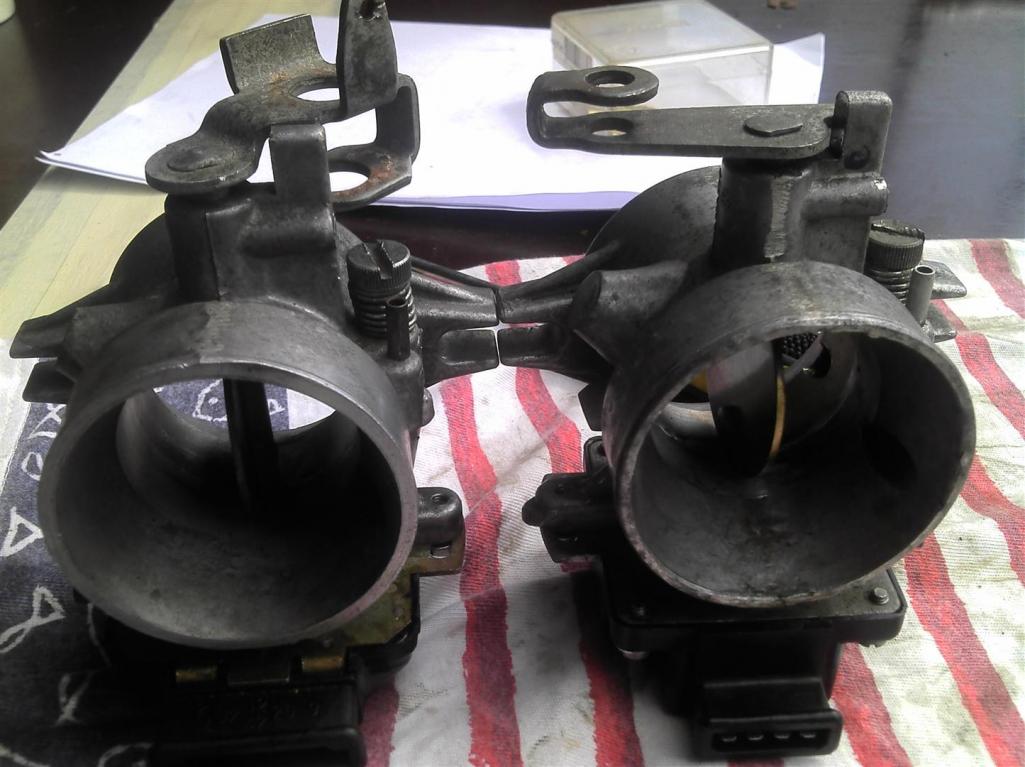

After the easy part, the fuses where blowing every time I hit the key, some big malfunction in the FI harness, and a short cut in the ignition didn't help either I think I was (IMG:style_emoticons/default/yellowsleep[1].gif) while rebuilding the ignition, and connecting the harness.....

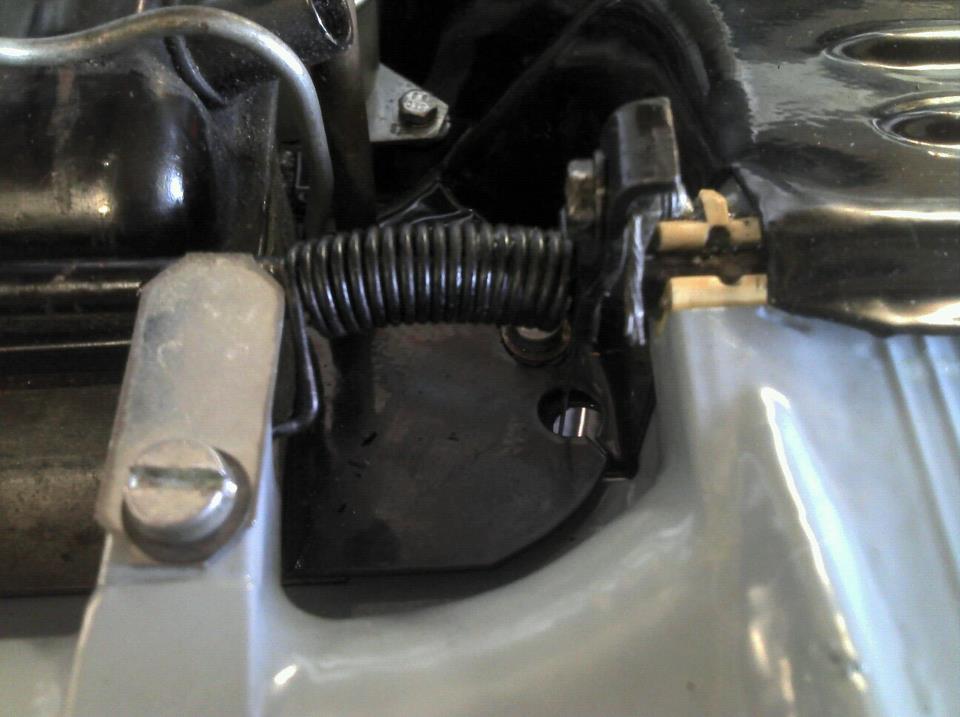

Luckily I found a spare FI harness and ecu (1 year later model I think, with a knob on the ecu?), only problem was that the matching throttle house did not work with the position of the throttle cable (left new one, right old one).
After a bit of grinding and welding, she works excellent now, and past sunday I turned the key for the first start (IMG:style_emoticons/default/smile.gif) It worked!!! No more oil leakage and a clean engine!
Now time for some adjustments, new clutch cable and renovate the brakes. To be continued.

Weird it has the euro badge, tail lights, no lid letters, but has the warts, like you said. Also wierd it is adriatic blue ? but has black bumpers.
