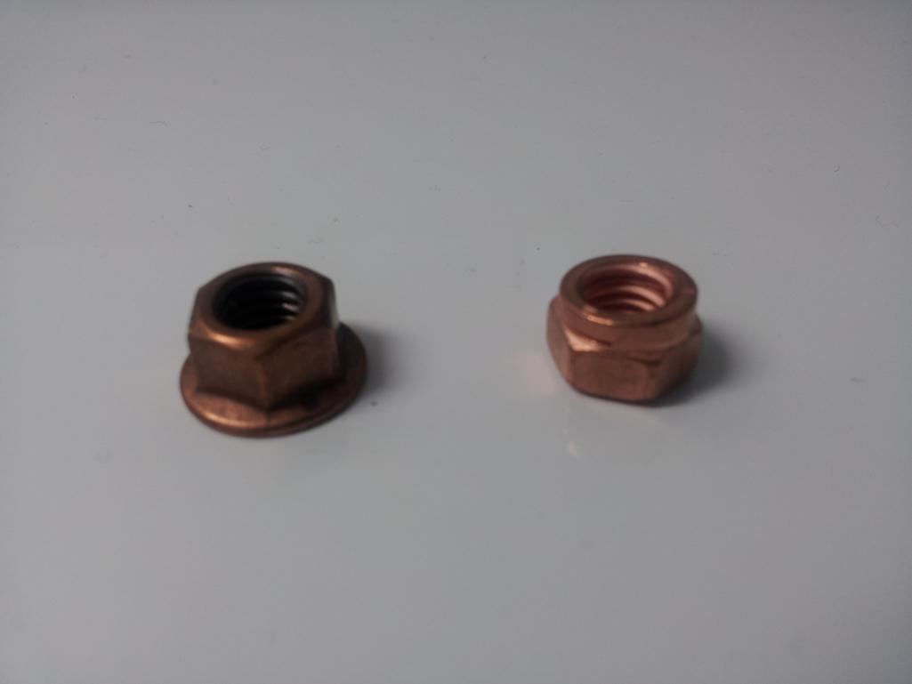

Does anyone know where you can pick up a nut like the one pictured on the left with the shoulder flange? I have 8 and need 12. Would like a few other sets as spares as well.

close but no copper
http://www.mcmaster.com/#hex-flange-nuts/=hjj40g

Are you talking about copper coated? They are still currently used on newer Porsches and should be easily attained at the dealership.

pelican sells them.
I'm too lazy to find a link to the part though

Crushed Nutz from the Bird

I can mail you some today, just let me know before 3:00.

This is a BMW part also, part # 11 62 1 711 954.

They're still currently used on WATER COOLED Porsches. They were NEVER used on air cooled Porsches.

What's correct to use on aircooled 914/6 911?

Hey Cap'n!
Tell me true. Are you saying that the nuts in copper with the flange were never used on 914 2.0L motors on the exhaust studs?
Pelican only sells the ones on the left.
I want to know!
Thanks!

I need to do a better job searching before asking...Bird says....
11-62-1-711-954-M58 Exhaust Nut (8 per car, sold individually), 914 1.7/1.8/2.0 (1970-76), Each [More Info]
Exhaust Nuts
[view in catalog] $0.75
999-085-001-02-M260 Exhaust Barrel Nut (6 per car, sold individually), 911 (1965-73), Each [More Info]
Brand: OEM
Exhaust Nuts
[view in catalog] $3.25
PEL-TOL-P243 Heat Exchanger (Barrel Nut) Removal Tool, 911 (1965-73), Each [More Info]
Exhaust Nuts
[view in catalog] $29.40

Here is link to Pelican Parts Exhaust Nuts:
http://www.pelicanparts.com/cgi-bin/smart/...76%29%2C%20Each
Used them when I replaced my heat exchangers.

I don't have time to take a photo, but here's the truth. 911s DID NOT have copper plated steel self locking nuts anywhere in the exhaust system. They DID NOT have ANY kind of self locking nuts anywhere in the exhaust system. The Bird sells locking nuts for half the studs, non locking for the other half. Why is that? Because they can, I guess, and it simply doesn't make sense. They're in the business of selling parts, not repairing or restoring cars, and their advice should be taken with that in mind. 911s came with 6 non-locking barrel nuts on the 6 studs accessed through tubular holes in the HEs, and 6 plain old conventional, non locking, 8mm nuts, 13mm wrench size, on the other 6.
ALL 1.7 and 1.8 914s came with what look very much like plain 8mm nuts on the exhaust studs. However, despite the looks, they're different; They're helicoiled. The same nuts are used on the studs holding various sections of the transaxle together. All 1973 and 1974 2 liter cars used a relatively bulky looking thickly flanged 8mm nut with a helicoil inside on each of the exhaust studs. I don't remember what kind of exhaust nuts the '75-'76 cars used, but I can guarantee it WASN'T any kind of locking fastener, same as the earlier cars.
That's the truth. Anyone telling you any different doesn't know what he's talking about, or he's trying to sell you the product he has in stock.
