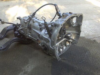

For the drive line end of things I have absolutely NO original 914 tranny to start with. This is why I went with the Subaru tranny. It's FWD so I don't have to worry about the headache of the AWD trannies. There's a great shop near me that builds very solid custom CVs and are reasonably priced so going from the Subaru tranny to Porsche hubs won't be a problem. However if anyone knows a good place to get adapters to make the bolt pattern 4x100 I'd appreciate the lead. I'll be fabricating a push/pull cable system for the shifter which will eliminate shift linkage.

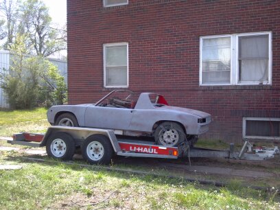

Total project cost so far (car included): $140
This was as soon as we got it on the trailer after sitting for nearly 30 years
This is the 5 speed FWD Subaru transmission all cleaned up ($140)
