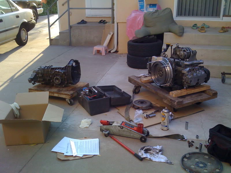

VOX and i are also doing an EJ22 swap, but went with the original 914 901 transmission adapted using the Kennedy Engineering Plate.
Our thread:
http://www.914world.com/bbs2/index.php?showtopic=92942

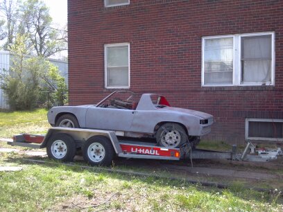

May 18 2012, 05:08 PM
Wow! Thanks for the warm welcome into the Porsche 914 world. I'm excited to be a part of this community.
Thanks for all of your input and help on some of the things I was curious about.

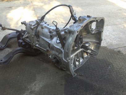

For the drive line end of things I have absolutely NO original 914 tranny to start with. This is why I went with the Subaru tranny. It's FWD so I don't have to worry about the headache of the AWD trannies. There's a great shop near me that builds very solid custom CVs and are reasonably priced so going from the Subaru tranny to Porsche hubs won't be a problem. However if anyone knows a good place to get adapters to make the bolt pattern 4x100 I'd appreciate the lead. I'll be fabricating a push/pull cable system for the shifter which will eliminate shift linkage.
On the cooling side of the project I've seen builds with lines plumbed into and through the interior, and lines that were run under the chassis of the car. I'm planning on plumbing through the interior as I see it to be more beneficial. Does anyone have any reason(s) I should plumb underneath the car instead. (outside of putting holes in the firewalls) It's funny that the Miata radiator was brought up because my buddy is thinking about donating his Miata radiator to the project. He also suggested 2 12" fans. Hmmmmm....I think I'll do that.
Thanks again for the warm welcome and help.
Total project cost so far (car included): $140
This was as soon as we got it on the trailer after sitting for nearly 30 years
Click to view attachmentThis is the 5 speed FWD Subaru transmission all cleaned up ($140)

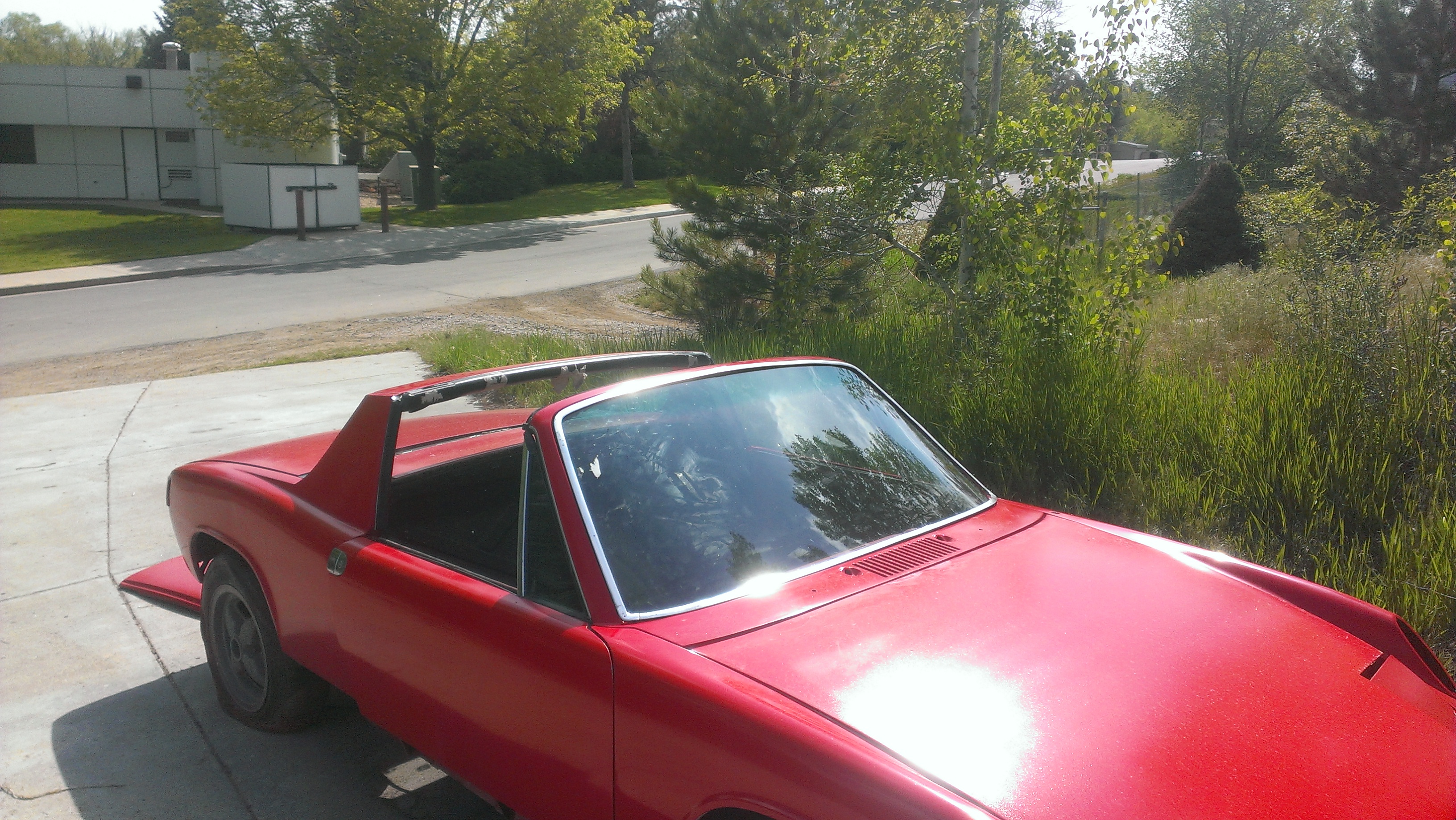

I hope to fire my WRX swapped 914 in the next couple weeks, but as far as the interior goes....you might want to look into black carpet on the rear firewall. I would fit with the aftermarket buckets you are putting in and will save cash.
Also, to save you time searching, those cooling hoses pictured above with the yellow stripe are from NAPA and are sold by the foot. Gates green stripe hoses are also a good option.

Yesterday I picked up a new windshield. I paid $110 dollars for the brand new piece of glass!
