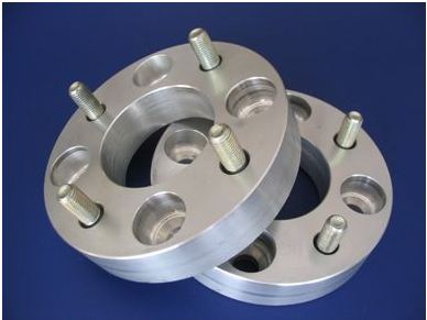

We got our 4x130 to 4x100 bolt pattern conversion adapters from these guys on ebay:
http://www.ebay.com/itm/Wheel-Adapter-4x13...ad9&vxp=mtr
