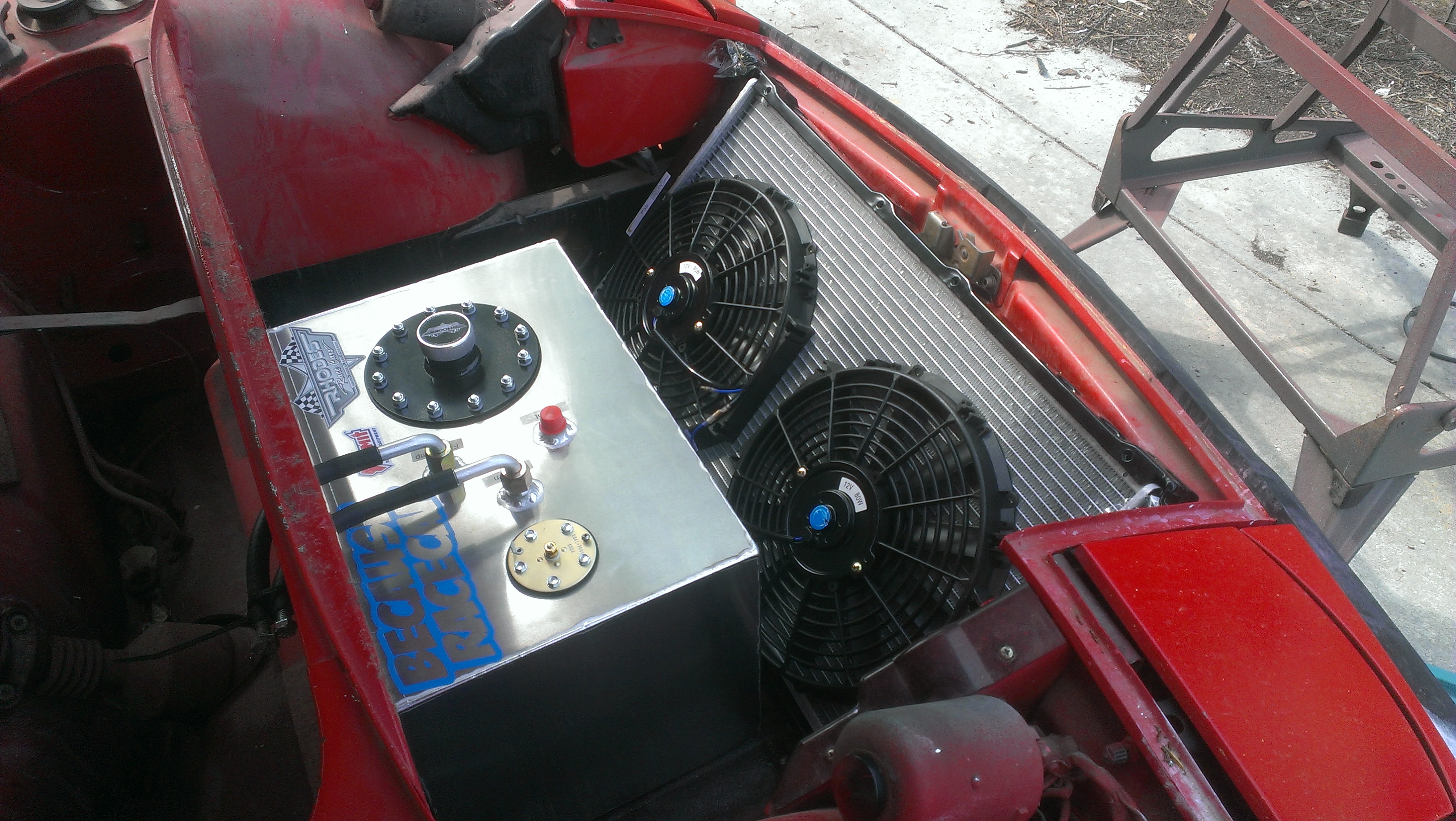

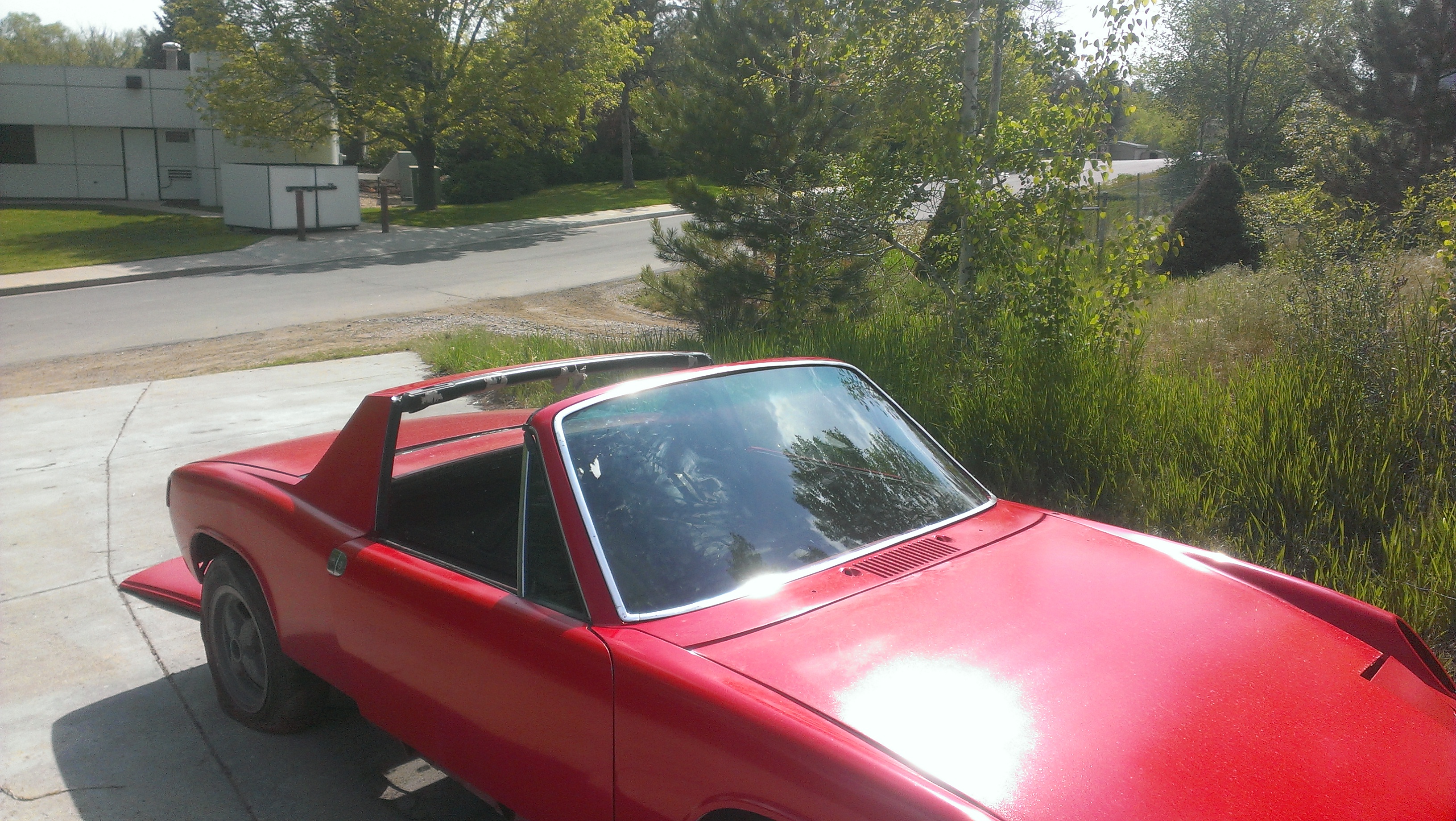

Fuel cell from Rhodes Racing, fans and legacy radiator mocked up. Also installed the windshield todayAttached Image

Sorry here's fuel cell fans and radiator. Also I only paid $110 for the windshield, brand new.
