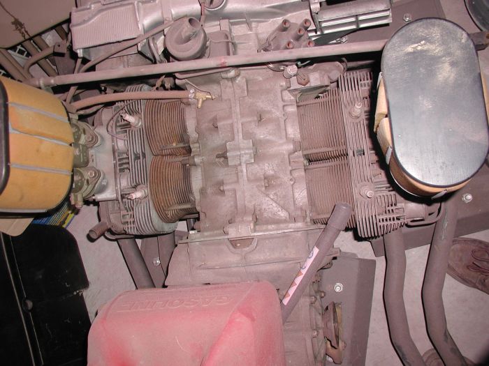

Where on this are the ID codes at I cant find them (IMG:style_emoticons/default/confused24.gif) its supposed to be a 1.7 the pink color is overspray it sat in the corner of the shop andI thought I covered this when I painted the car

what is the threaded hole next to the intake for? Should I plug it for a non street eng?
davep
post Oct 15 2004, 06:04 PM
914 Historian
Posts: 5,359
Joined: 13-October 03
From: Burford, ON, N0E 1A0
Member No.: 1,244
For a 1.7 it should be on the angled rib towards the flywheel end. A 2.0 would be in front of the oil filler. A replacement block would have neither.

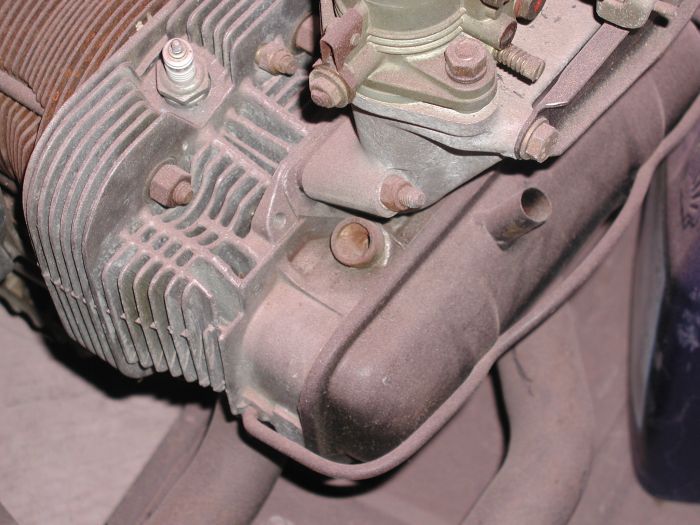

are these the angle plug heads? The intake has four bolts holding it on.

4 bolts= 1.7, 1.8 or Bus 2.0 heads

No, they point straight up so its a 1.7,1.8 or bus head.
Hmmm, they filled the head breathers with the bolts and added vent tubes on the valve covers.

QUOTE(Bleyseng @ Oct 15 2004, 07:07 PM)
What ones are filled? The holes Im asking about are next to the intake ports and have threads in them. Is that the head breather you are talking about because it is not plugged?

QUOTE(spare time toys @ Oct 15 2004, 06:33 PM)
yes, it looks redundant ...
the head-breather and the vent on the valve cover serve the exact same purpose.
you need only one of the two. the head-breather is usually preferred because you don't need to cut into your engine sheetmetal to use it ...

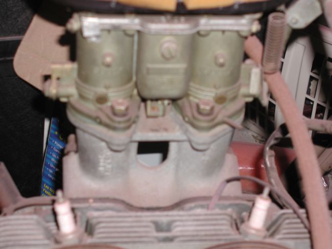

anyone else trippin on those funky intake manifolds? those are funky!!! (IMG:style_emoticons/default/laugh.gif)
they match the cage i guess (IMG:style_emoticons/default/lol2.gif) , jk
Larry, its lookin good, what are the plans for the motor?
remember - POEAF (pink overspray'd engines are faster)
PS-what carbs are those?

the little threaded holes are for the engine cooling sheet metal?

also, whats with the oil filler cap? ive never seen one with a breather port

Yep…those manifold are funkadelic, what are the carb #’s and do the manifolds have any markings?

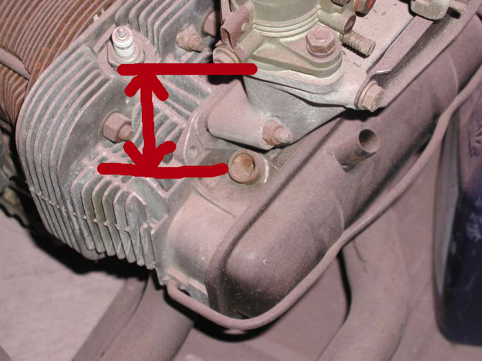

Can you give me the measurement (see pic) from top of the carb to the top of the valve cover?.
Also I'd love to know whats up with that plate bolted to the VC side of the manifold.

The carbs look like some old DCNF carbs I had awhile back. They had that same type of manifold. The small screw holes next to the manifold are for screws to hold the sheetmetal down. You do not need to put anything in there if you are not going to put the sheetmetal back on. I would not run one of these engines without the sheetmetal however, it wont live long without cooling. 1.7 heads I thought were the only ones with the vent tube, 1.8 heads didnt have them.
Ok I went out and got what you wanted. The carbs are Solex mod. 40-p11-4 the measurement on the intake is 3.5 inches and the numbers cast into the intake is the VW in a circle then 021 12 0 with 709n under it. The plate holds the linkage on the forward side.

Solex 40-p11 are real old school...they were never a great carb...ebay them and put the cash towards a new set of webers. OR gut them and use them as TB's for a FI setup.

dude! i believe those solexes and manifolds are worth some money to vintage racers!
werent these the RARE VW 914 manifolds for the euro 1.8?
these were sought after by racers as a 'factory' way of putting carbs on a Production class race car
please correct me if im wrong

Maybe to a vintage buff...I'd rather have new (newer) Weber carbs. I've only ever tuned them once (on a T1 bug) and they were a total PITA.
