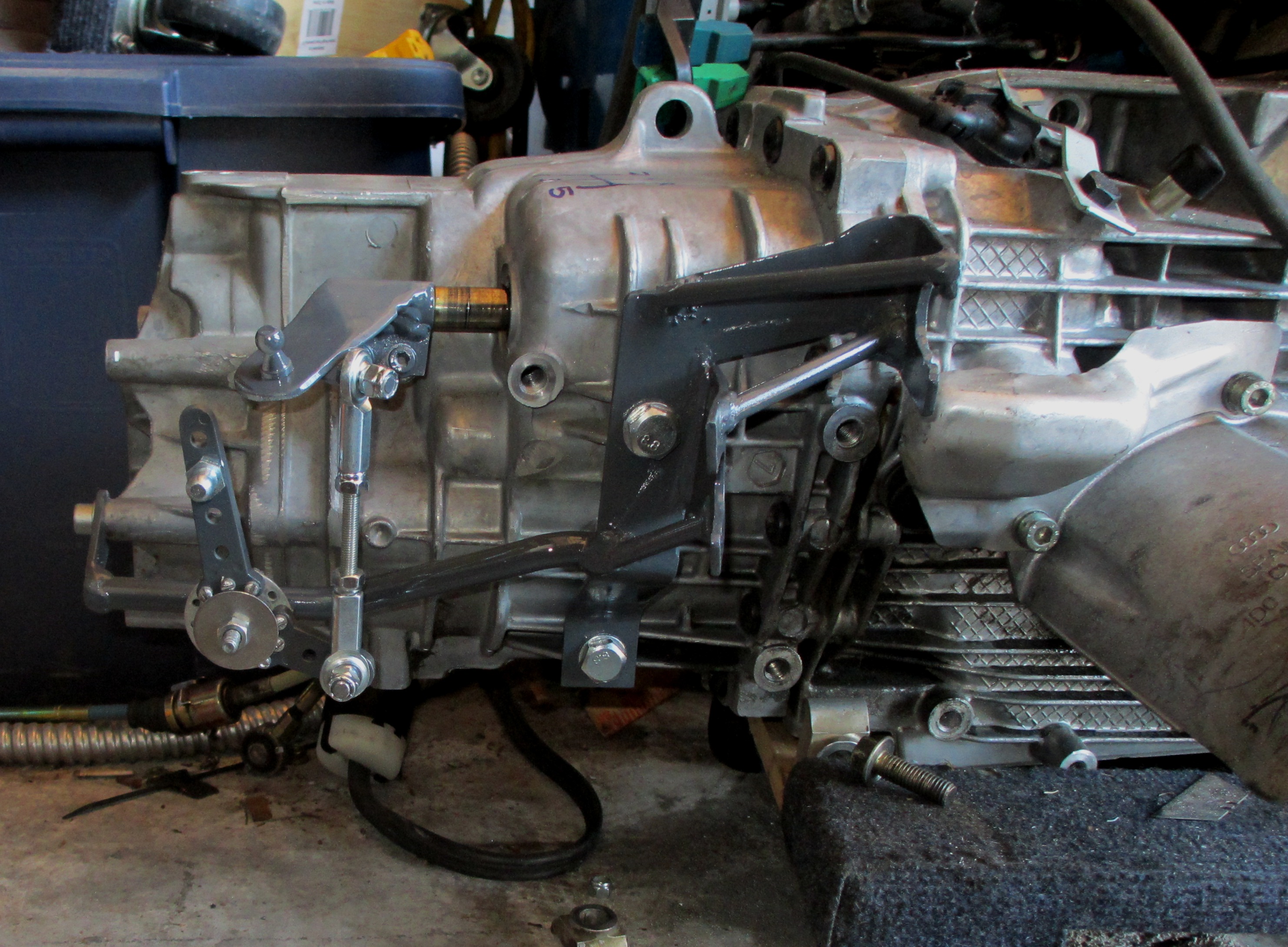

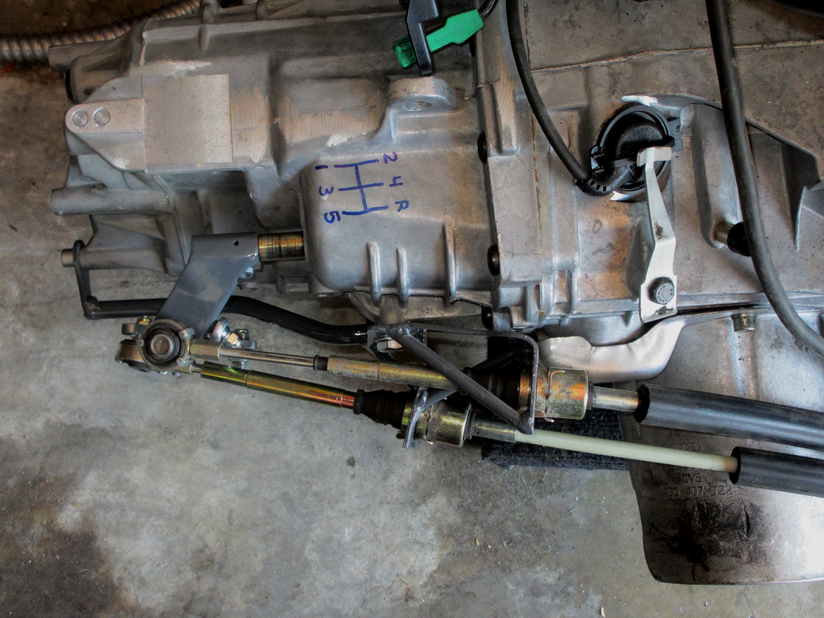

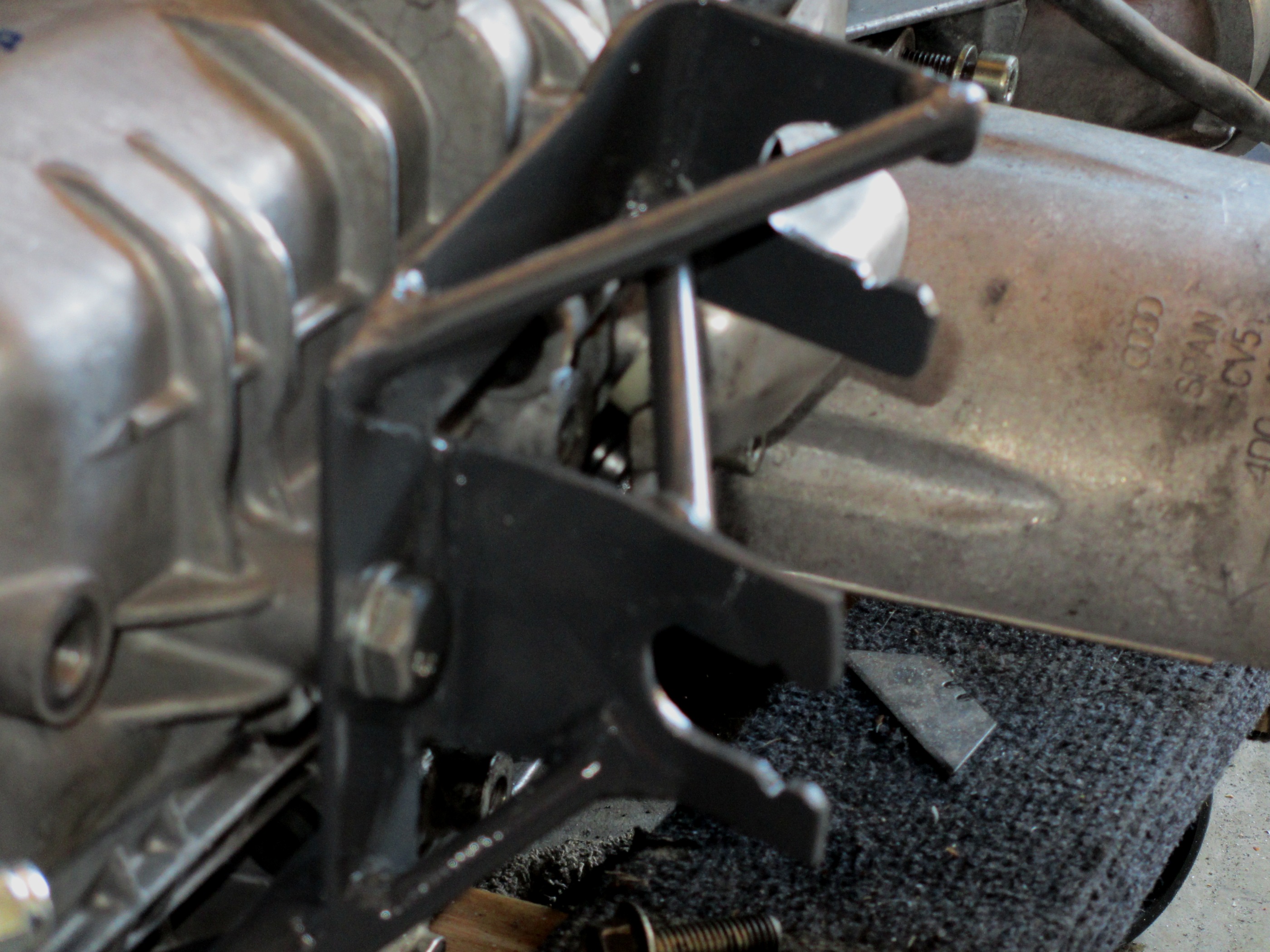

Got it finished and painted. Moved the cable inboard, the angle looks better. I plan to keep the (Audi Only) axle shield. But the cast aluminum Audi tranny mounts have been replaced with Boxster Steel units. This will give the mounts some symmetry over the Audi's.
Here you can see the notch needded to capture the factory locking clip.

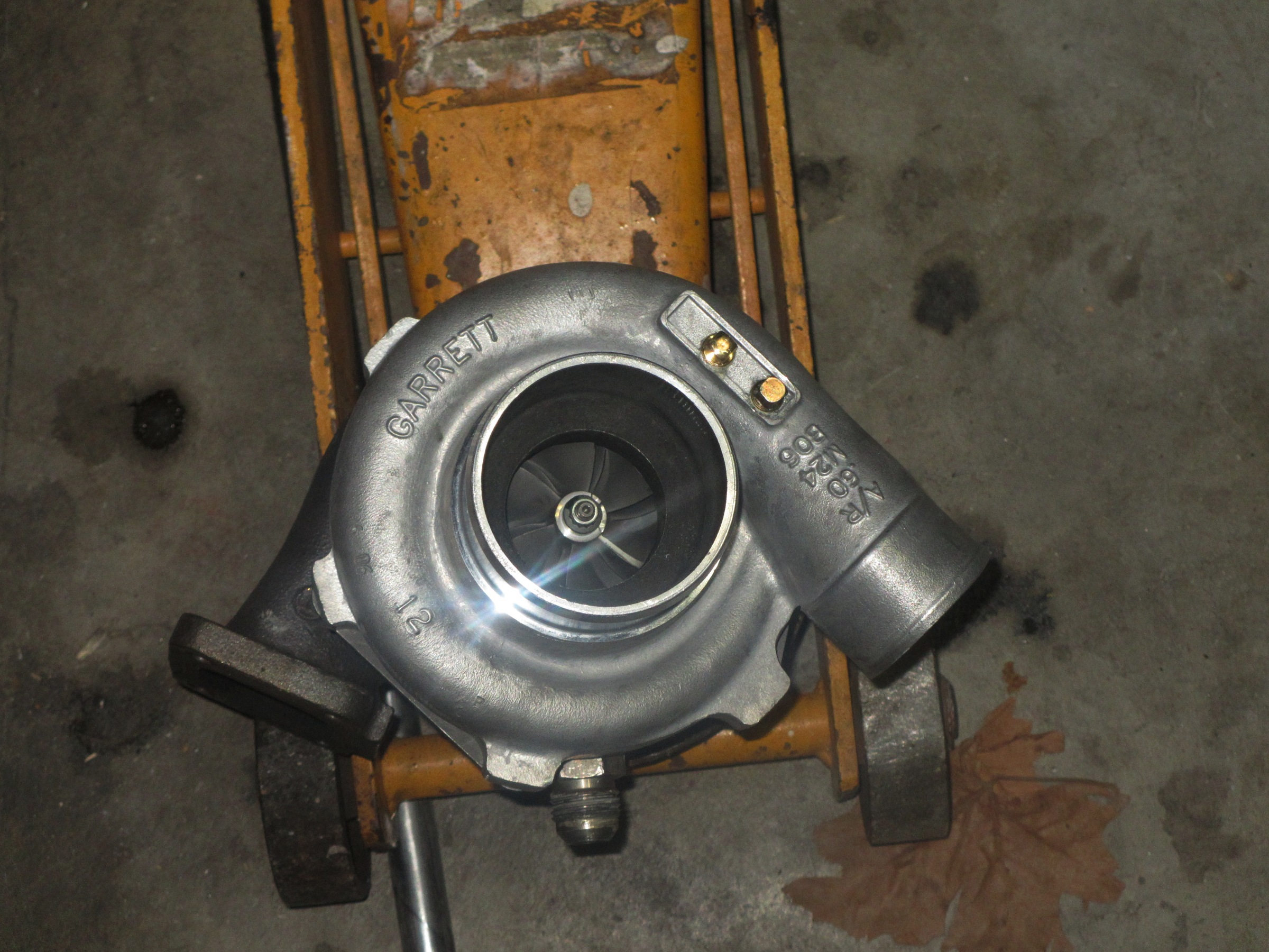

Teaser photos... Rotary gets pulled this weekend. New turbo good for up to 350hp. Not sure which exhaust manifold to use. I need to get the engine in place to see where the turbo fits best...
Garrett GT28RS Disco Potato...

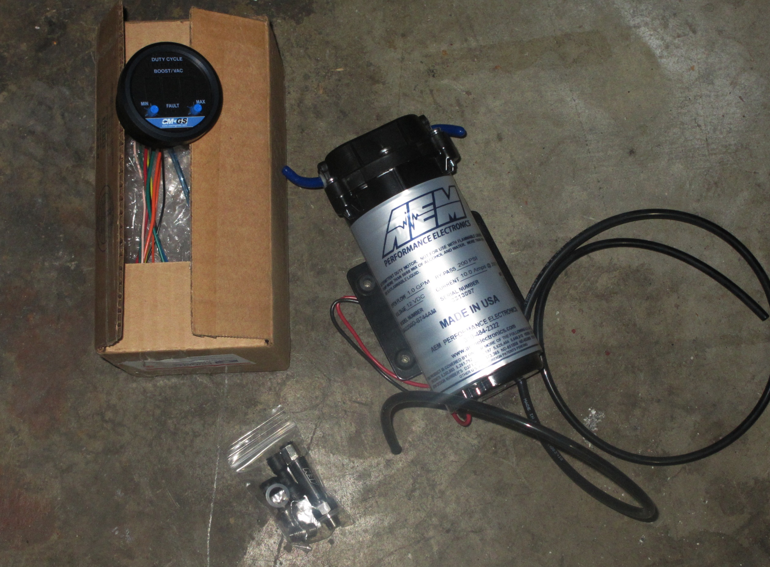

Methanol Injection... Coolingmist progressive controller gauge with vac/boost display, fail safe control, flow meter, AEM 200 psi pump, 600cc injector, hose, misc fittings. Not shown is the 2 gallon tank...

Mike, are you going to run the stock turbo/tune for the initial testing and then upgrade?
GT28r is a great turbo.. I wish I took you for a ride in the Audi prior to me blowing that turbo...
Turbo should fit fine, the 914 has more side to side room than most cars, I would go with a bottom mount turbo due to the exhaust and the firewall clearance (VS going with like the SPA manifold..). Not very many available though... I see one on ebay, but not sure how long it would last before it cracked... ( My APR one is bottom, but its made of Iconell, so it will never crack...).

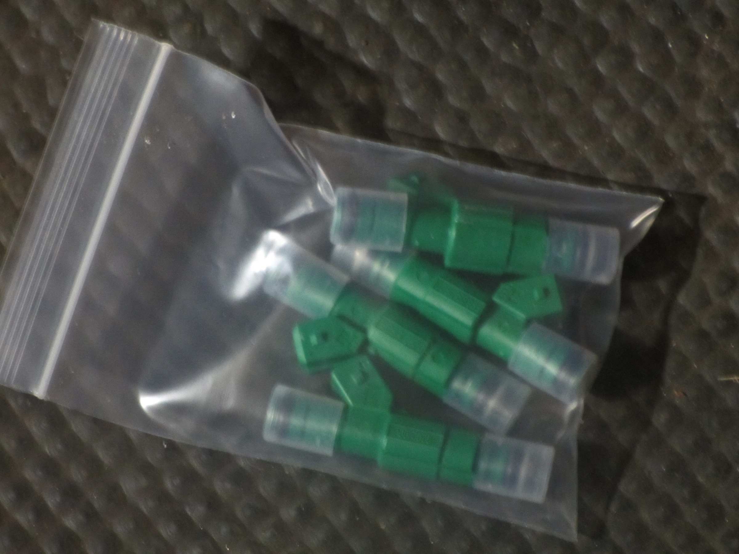

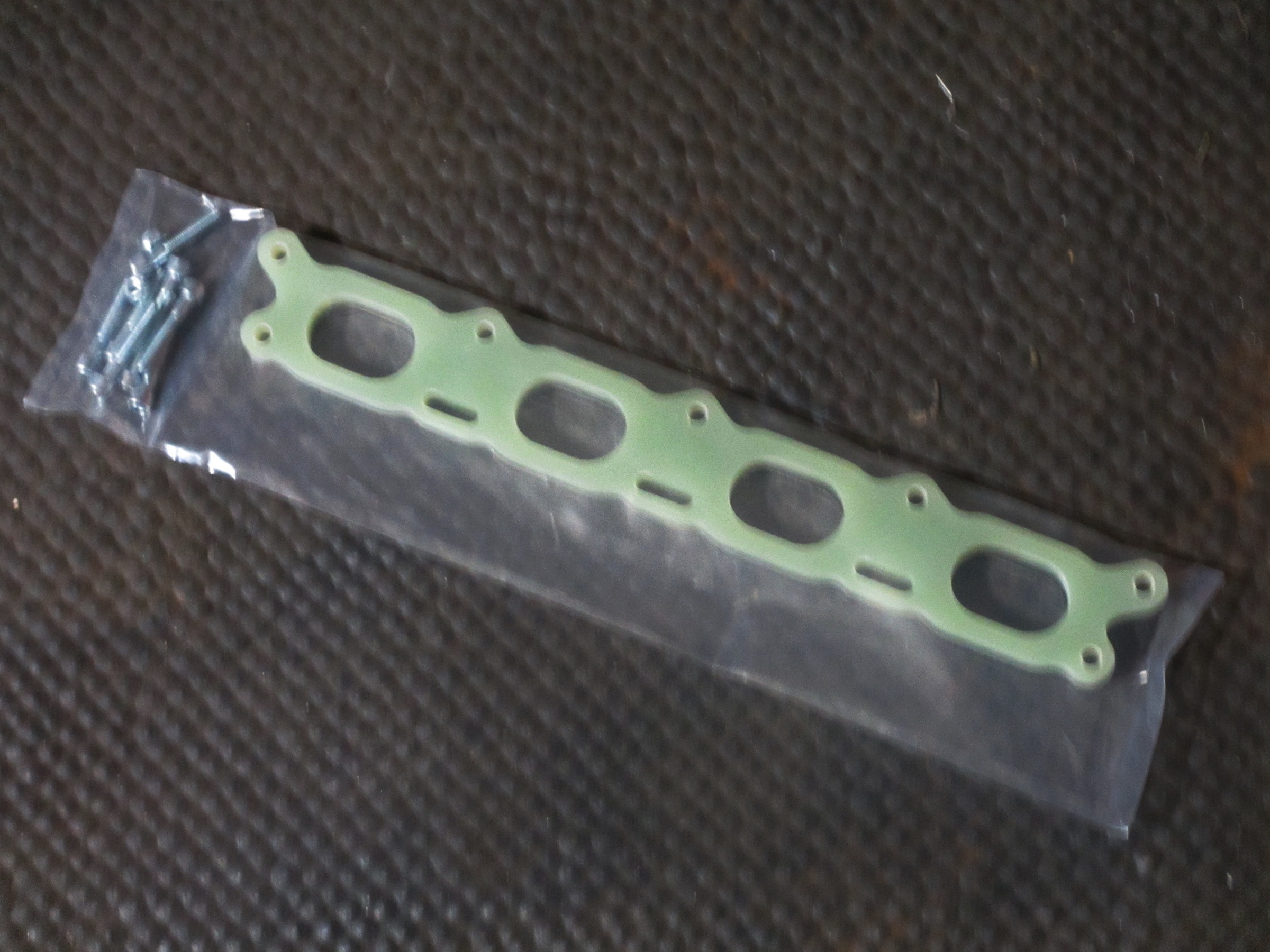

Fenolic intake spacer. 034 says it can lower the manifold temp by 20F. can't hurt...

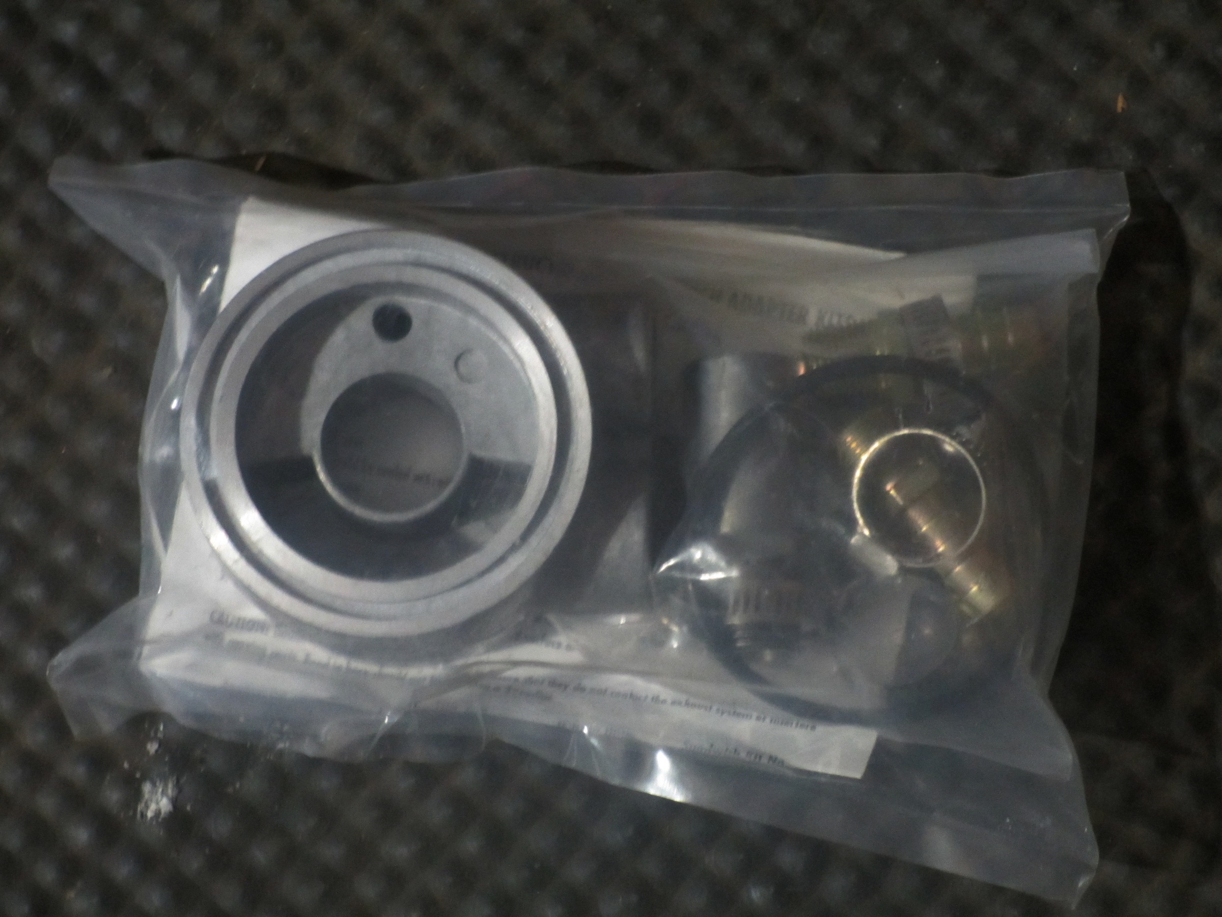

Oil sandwich to connect my external oil cooler. Now I need to flush out all the dino oil from the system...

I've heard mixed reviews on the intake spacer.
