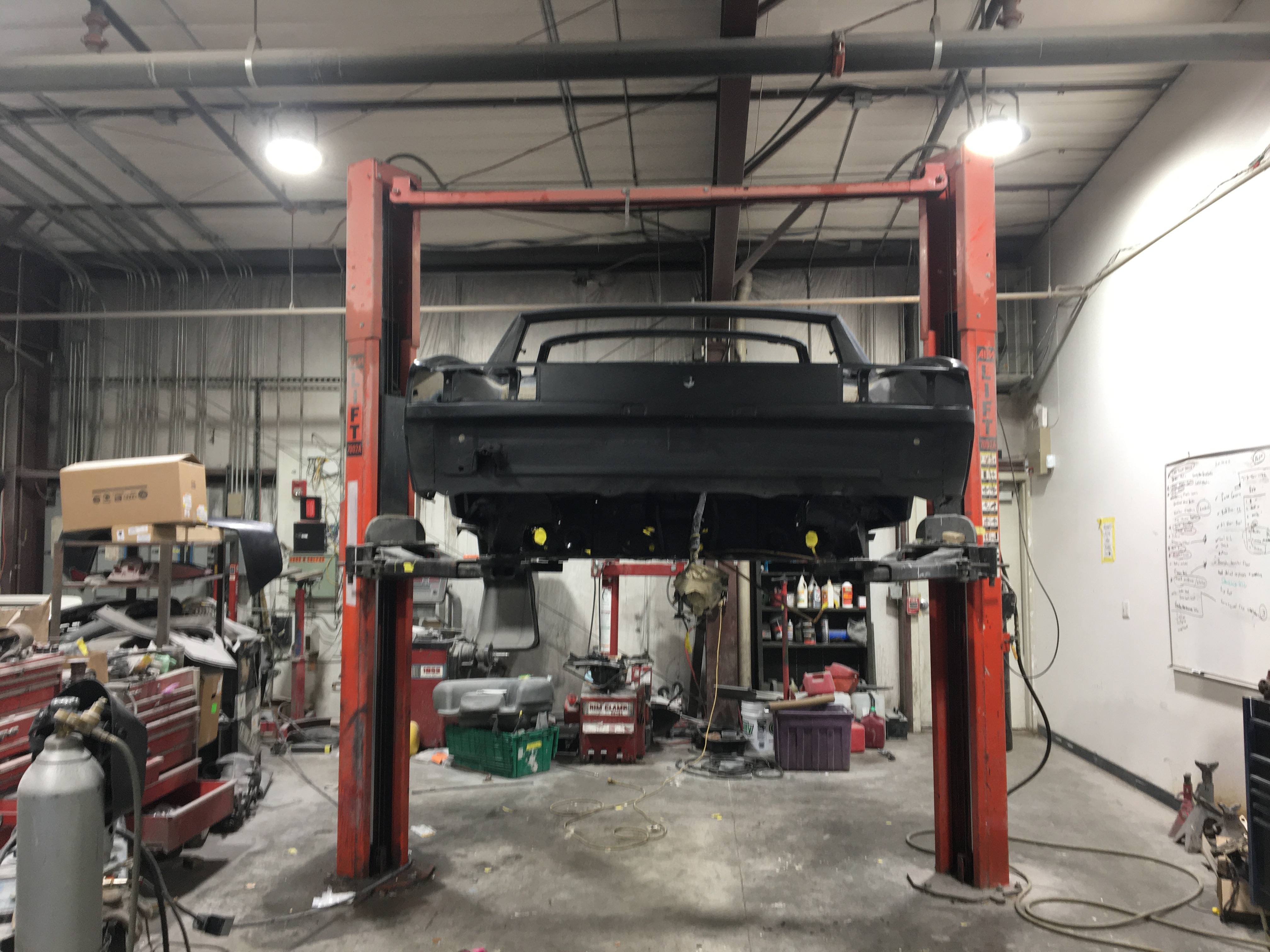

Apex called and they anticipate three weeks.
Said my "metal work" was all done...not sure what that means...?
I plan to go visit and do the seam sealing after the epoxy sealer.
He says he has the seam sealing products...and he has everything in the shop from speedsters to RSRs so I'll go with his product recommendations.
The 914-6s were brushed seam sealer, correct? He also has the body "shutz" for me to apply under coating...so I will need to be clear on where to apply that too.

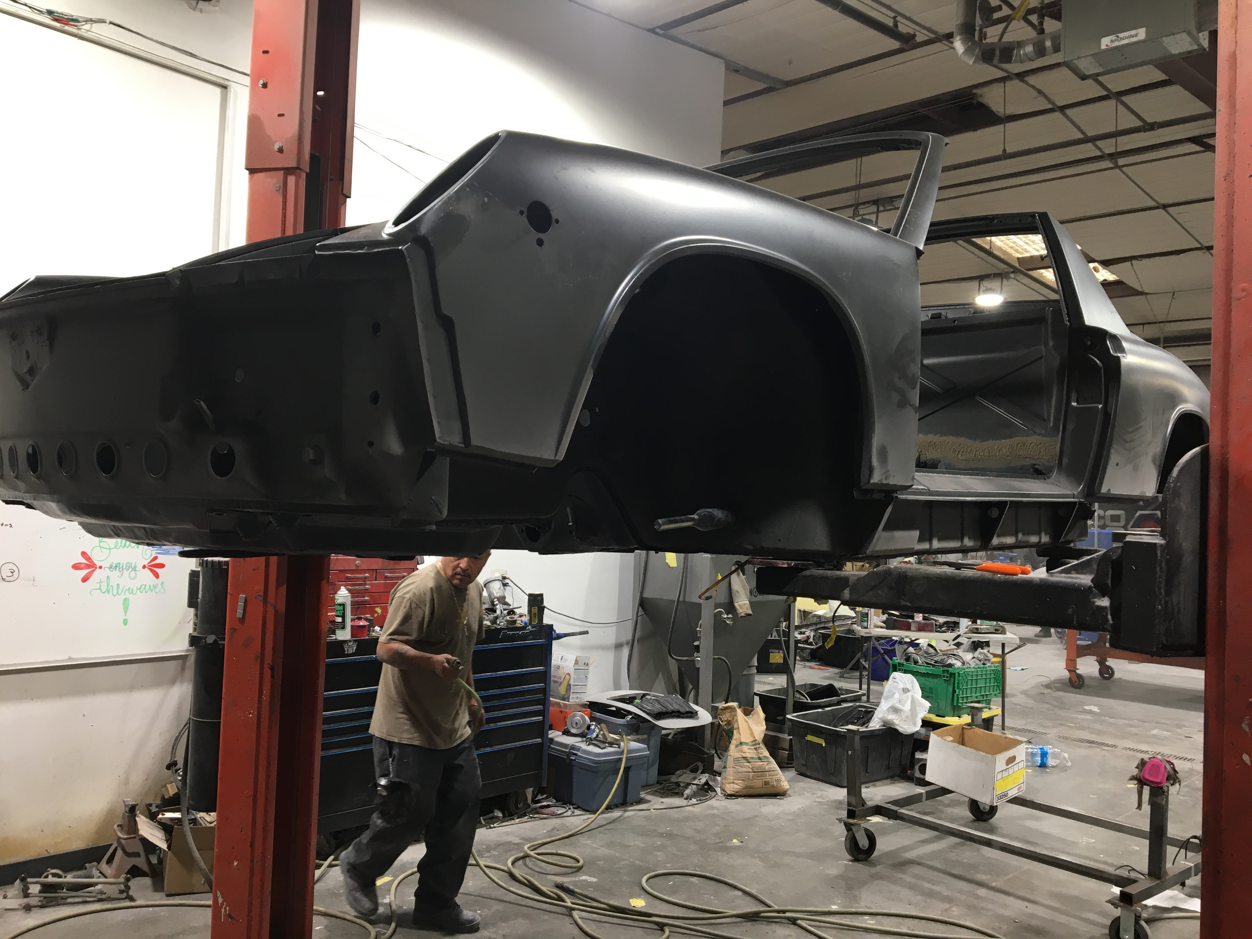

My sons car (70 1.7) is on the lift and we are finishing up the hell hole. So while it is in the air, we will have a good opportunity to walk around underneath and figure out where the color is supposed to go vs black and where the "shutz" starts and ends.
This was the butt kick I needed during this sheltering in place. Been getting a lot of "other" car projects done (sons 914)...but the 2.4 S engine kept getting kicked back down the list.
Case is cleaned and prepped, crank and rods assembled. Parts are all here and all the machining is done. Weber 40s are rebuilt and the shroud is repaired and repainted.
Need to inspect the oil pump...decide on 574 vs 3bond for the case adhesives and put it together. No excuses now.
I am going to be sending a batch of hardware to be refinished...so I need to double check what needs to be silver vs yellow zinc (son's 914 should be telling) and send it off. Anybody local that wants to "piggyback" on my refinishing, let me know asap.
When I go to look at it I will grab some pics.
