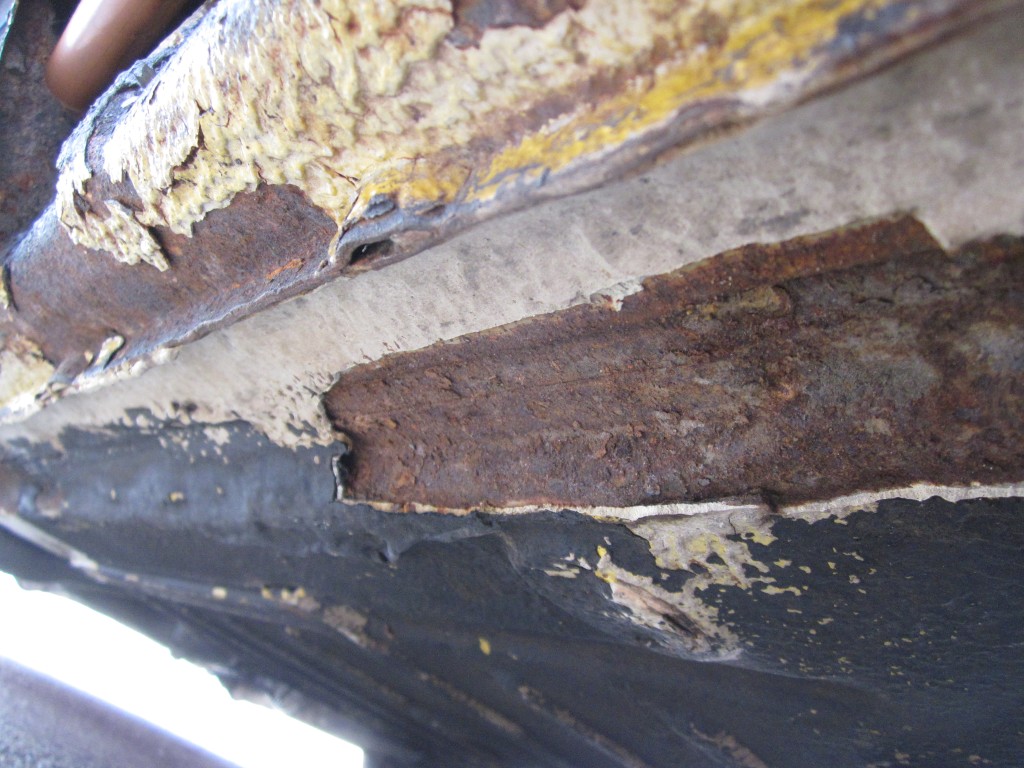

Uh oh that's not gold (IMG:style_emoticons/default/unsure.gif) Looks like the rear has been clipped

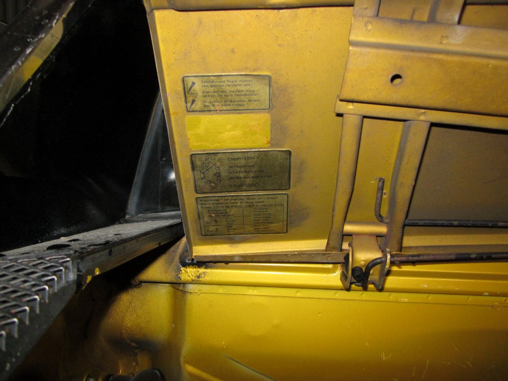

Does anyone know what this is ? It is on the drivers side and uses factory looking dome head screws. I also forgot about the speaker mod pics (IMG:style_emoticons/default/barf.gif)

Did the seat belt tongue sit in that? Shot in the dark here.....

The piece on the inner long is a seatbelt holder. I may be wrong but there should be one on both sides. Or was that only with adjustable seats?
My 72 4 had it on both sides
Ah makes sense. This car only had the one in it. Was this a six only feature or did the early 4's have it as well ?

I think they were only on the drivers' side....and indeed are for the belt. Mine had neither side, have been trying to sort that out. Are there any holes for the screws in the sheetmetal, or does it just attach to the carpet?
Looking forward to watching this....wish I"d taken a series of pics, not just for thread value, but so I could figure out how to reassemble years later (IMG:style_emoticons/default/sad.gif)

QUOTE(scotty b @ Jun 19 2012, 06:28 AM) *
QUOTE(cwpeden @ Jun 19 2012, 05:26 AM) *
There was debate on this a couple years back and my 72 4 cylinder car had both sides.

QUOTE(cwpeden @ Jun 19 2012, 09:36 AM) *
I have a 1.7 manufactured August 1970 - it had the holder on the driver's side. Probably had one on the other side before the rust set in.

QUOTE(Cairo94507 @ Jun 19 2012, 05:25 AM) *
Yes. Only on the driver side with the moveable seat. My /6, #0137 did not come with it, but my #0876 did. There has been some discussion as to whether it was factory (Karmann installed) or after market. IMOH, it was factory as I have seen them on '71's also. They could be on both sides of a '72 prior to the retractable belts, but I have not a '72 up close. Many get broken or lost, so consider yours a unique part.
They were screwed into the metal and the two that I have (one was a '71 /4) were in identical locations.
Good pictures. I'll be watching.

Do a search for that seat belt holder, I remember reading about it before. I too have a real 6 and need to know. Al

I have found these seat belt holsters on the drivers side (only) on 1970-71 fours and sixes. the non-retractable seat belt years on the adjustable seat side of the car.
I have never parted out a 1972 so I cannot say for sure.
