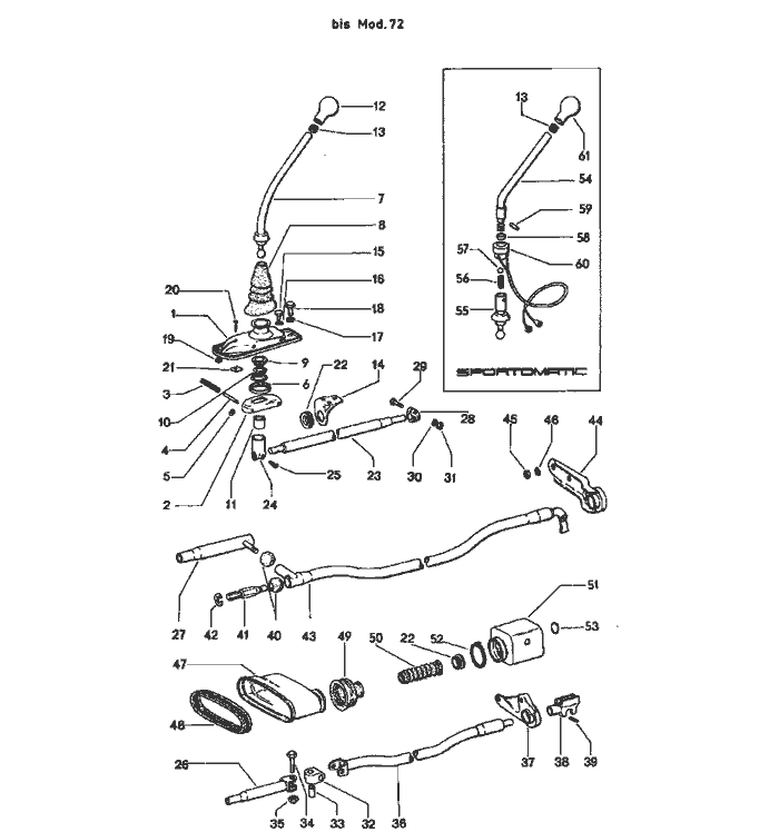

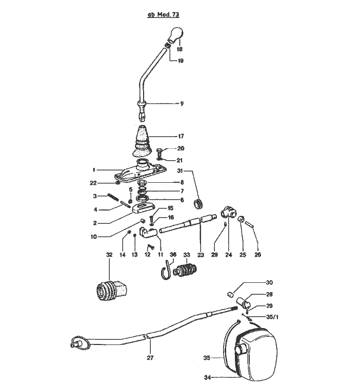

Are these two parts interchangeable?
Part No. 28 in this diagram:
and part No. 24 in this diagram:

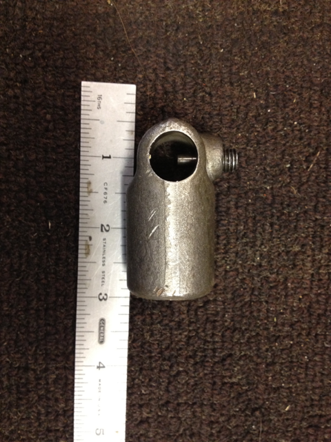

It's easy to say "no" as they are different part numbers. However they are very close. Here's a picture of part 24 (930-424-241-00):
I need part 28 (914-424-241-02). If anybody could verify the distance from the center of the screw to the flush end I would very much appreciate it. It's about 1 7/8" on part 24.

That's an interesting question (IMG:style_emoticons/default/idea.gif)
What's the OD of the front shit rod where part (24) attaches? ... same as the OD on the rear shift rod? (I don't have either handy at the moment).
I think part (29) looks a littler 'beefier' (IMG:style_emoticons/default/confused24.gif)

No, the side-shift rear cup is taller than the shifter cup.

While they seem to be interchangeable, and both attach to the rod identically, using the tailshift piece at the console of a sideshift trans doesn't work out too well.
The ball cup bushing hangs out of the end, jams, and breaks quickly.
Somewhere around here I have a tailshift piece which I extended using a 12pt. socket at the race track, after discovering (the hard way) that I had used the wrong piece when assembling the car.
Fortunately I had a spare bushing in my parts box as well. (IMG:style_emoticons/default/unsure.gif)
