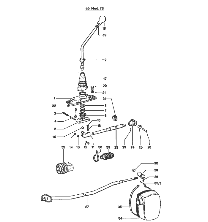

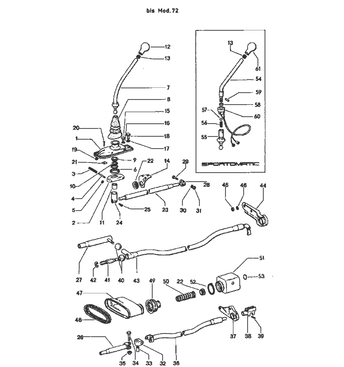

Are these two parts interchangeable?
Part No. 28 in this diagram:
and part No. 24 in this diagram:

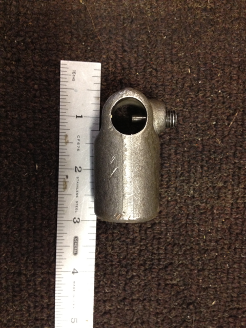

It's easy to say "no" as they are different part numbers. However they are very close. Here's a picture of part 24 (930-424-241-00):
I need part 28 (914-424-241-02). If anybody could verify the distance from the center of the screw to the flush end I would very much appreciate it. It's about 1 7/8" on part 24.
Thanks

No, the side-shift rear cup is taller than the shifter cup.
ChrisFoley
While they seem to be interchangeable, and both attach to the rod identically, using the tailshift piece at the console of a sideshift trans doesn't work out too well.
The ball cup bushing hangs out of the end, jams, and breaks quickly.
Somewhere around here I have a tailshift piece which I extended using a 12pt. socket at the race track, after discovering (the hard way) that I had used the wrong piece when assembling the car.

Another use for old sockets smile.gif i imagine it worked out fine. Probably got you through the day.
I had a hunch the one part was longer. Other than length, the tail shift piece does look like it would work. It only needs another 1/4" so it's easy to confuse the two. Thanks for clarifying, guys.

@bugsy0 =im in the same situation, did a side shift conversion and all parts were there minus shift-rod head (part 28) since i have (part 24, diagram 2) from swap, tried it to no avail. used a 11/16 socket and tried that, but ball cup bushing kept slipping out. called local Porsche dealer (Brumos) and i was told that part is discontinued.
