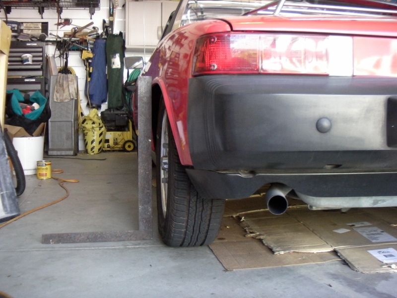

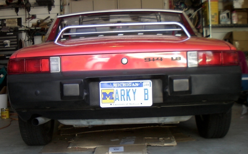

Dr Evil   A pic from behind the car may be enlightening. See...   Jun 27 2012, 11:49 AM
markyb   O yeah, they be leanin' a bit. You can't...   Jun 27 2012, 02:26 PM
Dr Evil   From more of a distance you can usually see one or...   Jun 27 2012, 02:37 PM
MikeM   I mean when the motor is running and the wheels ar...   Jun 27 2012, 03:09 PM
vsg914   Not an engineer, but I would think anything other ...   Jun 27 2012, 04:35 PM
