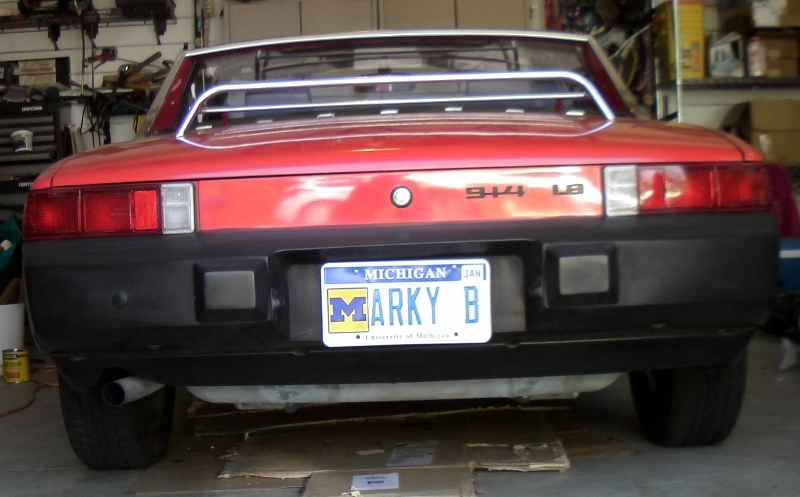

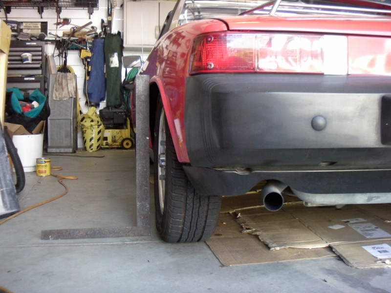

A pic from behind the car may be enlightening. See if your wheels are even and not leaning.
markyb
Jun 27 2012, 02:26 PM
Click to view attachmentClick to view attachmentO yeah, they be leanin' a bit. You can't really see it on the full ass shot, but next to the framing square it shows.
Dr Evil
Jun 27 2012, 02:37 PM
From more of a distance you can usually see one or both have bad camber. Hard to tell in those pics. Jack up the end of the car and wiggle the wheel from top and bottom looking for play in the arm.
