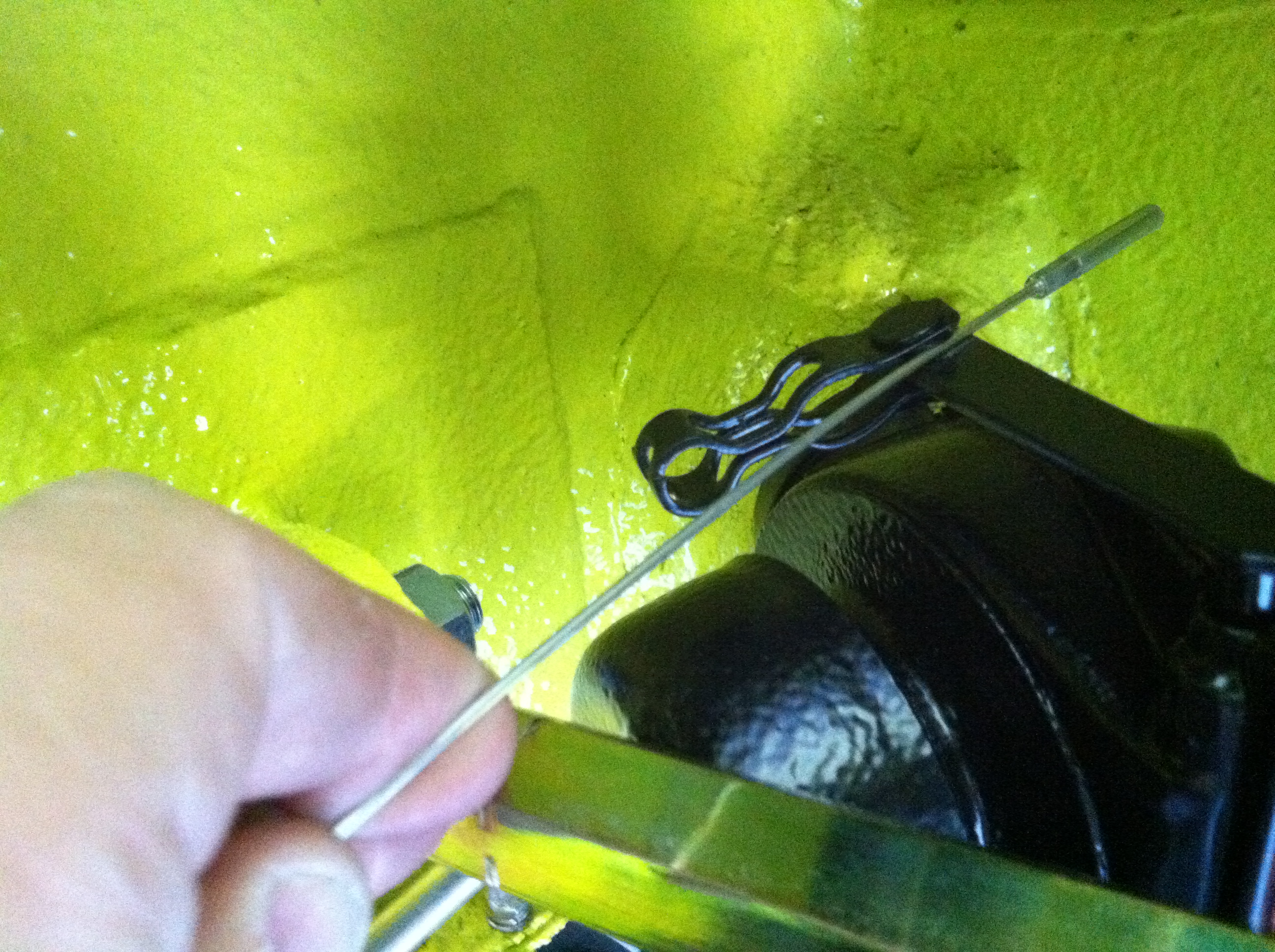

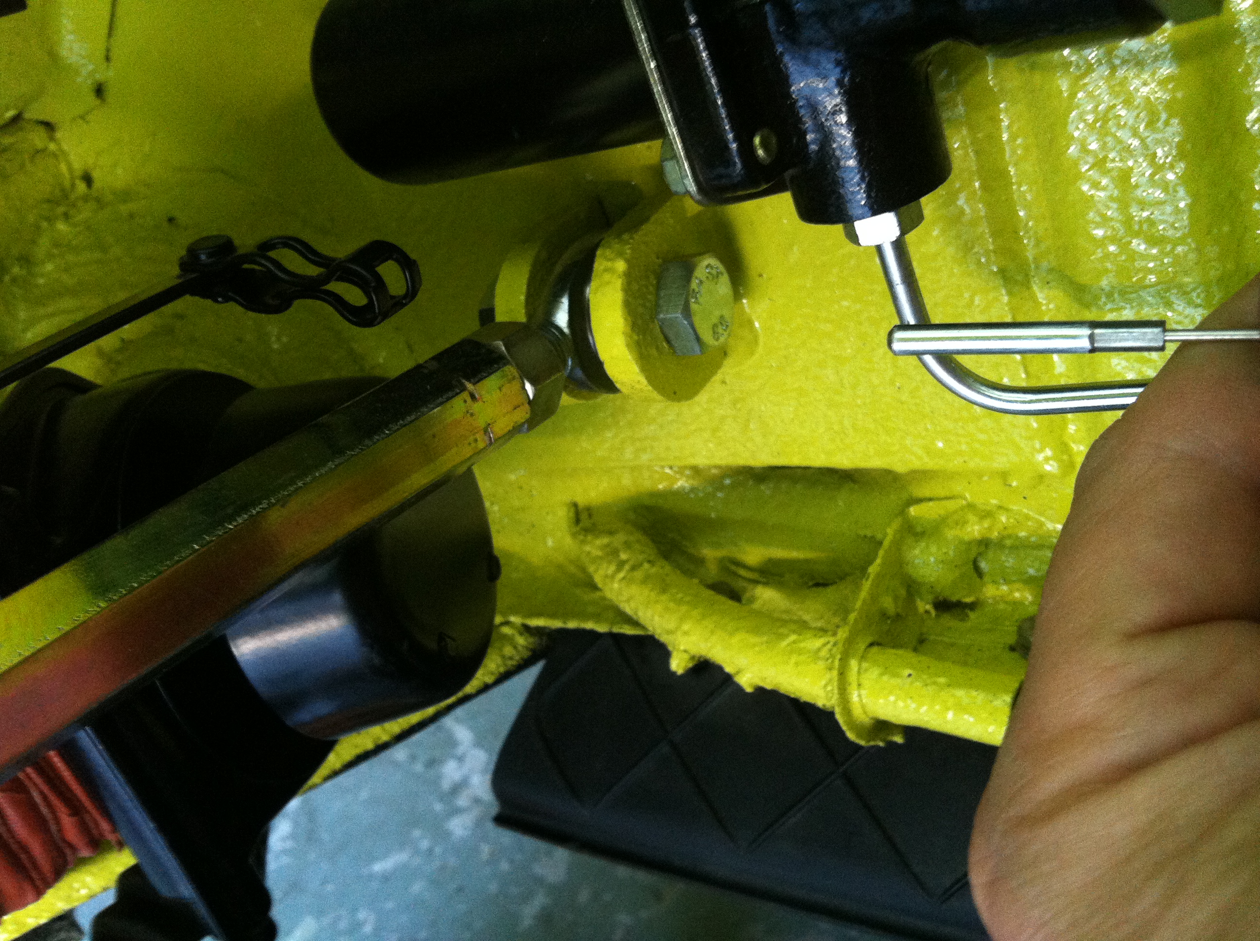

Installing the heater control cable and ran into a problem. Yes, I realize there is a left and a right (longer/shorter etc.) but, after trying both ways it appears the cable is bent wrong from the factory. I'm about 3.5" off each way.
Has anyone run into this in the past?
Too Short:
Too Long:

That's the same as my new Porsche Cable. The old Porsche is the right length/bend.
I haven't experimented yet with the new cable to make it work.

Are they equal lengths from the bend? Can you straighten and re-bend?

I was successful in re-bending the original. Had to take 3 5/8" from the long side to the short side. YMMV

I had to rebend mine. Worked perfectly when the passenger side was 2" longer than the driver side. (as per eric's suggestion)

I had the same problem. Tried it both ways then measured old cable and rebent and it worked.

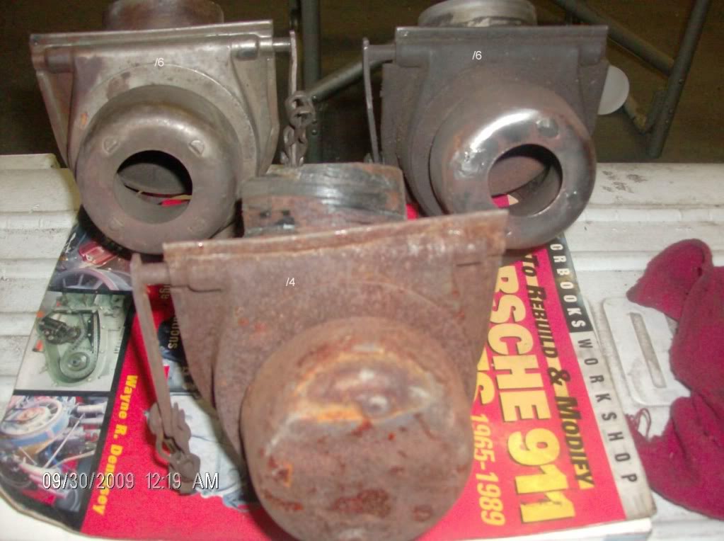

I'm not that anal ... I just clamped the wire in the barrel nut ... it works.
Shame on you Erc ... those aren't real 914/6 flapper valves ...

QUOTE(SLITS @ May 19 2013, 08:37 AM) *
(IMG:http://www.914world.com/bbs2/uploads_offsite/i239.photobucket.com-1696-1368978196.1.jpg)
Does this mean Erc is banned from future 914 events until this oversite is corrected?

Red lever forward. This will create slack on the cable. Tighten barrel nut on the flapper valve. Now when you pull the red lever up and back, you will pull the flapper valve lever and open the heat loop. Passenger side cable should be 2" longer for perfect fit. Lube up cable with light grease before you thread into hard metal tubes in tunnel. If the solid cable end gets stuck in the tube before it exits into the engine compartment, open up the radius of the hard metal tube - just a little bit.
