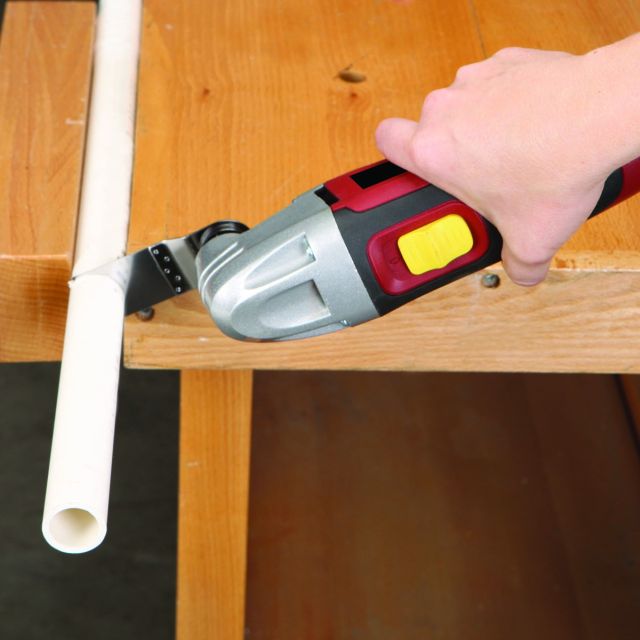

Here's what I found worked the best with the least effort and mess. . On sale now Harbor Freight for $19.99 . . buy some extra of the scraper blades though. . and with the 30 day warranty you can use the hell out of it. . you don't need any heat or cold. . just plug in and go. . . you should be able to do you entire floor in an hour or so. . . only bad part is it make a hell of a racket. . .
http://www.harborfreight.com/oscillating-m...tool-68861.html

One of these with the scraper blade. Amazingly simple and leaves things clean as a whistle.
Can cut through about a 12"x12" section in about a minute:
http://www.harborfreight.com/power-tools/o...tool-67537.html

simple minds think alike. . .
I tried everything i could think of and most of it was messy. . I stripped the entire car, everywhere in a week. . . Bad part was when i went inside in the evening, i realized how bad my ears were ringing from the noise. . On a bare tub, it's like you're inside a giant cymbal so you might think about soem ear protection. .

HF sells EarPlugs for the 1/2 hour it takes to take the tar off with the vibrator tool... (IMG:style_emoticons/default/beer3.gif)
