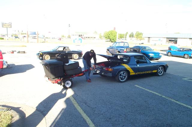

Lawrence took these pics at the MUSR. This would be a nice setup for my AX project. I would like to get a few more details on how / where the hitch was mounted. I assume the plug for the trailer lights just comes out of the trunk? (IMG:style_emoticons/default/confused24.gif)

I don't have pictures, but he had a receiver that had the retaining pin inside the rear trunk. Very nicely done, but He has to move the license plate to attach the trailer.

Um, that's why I want one. (IMG:style_emoticons/default/biggrin.gif) I really don't want to keep the racing tires in the car, plus all the other crap I take with me when I AX. I have a tailer, just interested in the way this hitch is mounted to the car. Anyone got moe pics??? Please..... (IMG:style_emoticons/default/pray.gif) (IMG:style_emoticons/default/beer.gif) (IMG:style_emoticons/default/biggrin.gif)

I did one on the Rocket. Welded a reciver in the trunk, hitch went thru the old trunk lock hole. When not in use it was covered by the reflector....

That car belongs to Murphy, who apparently is pretty active in the PCA or SCCA autocross events in Tulsa - I know that he lives near George Schaffer, who also frequents this board. The mount is the smaller type receiver (1.25"), that has been flipped upside down, and bolted to the trunk floor, directly under the latch.
(Similar to this, only the smaller reciever.)
The receiver goes through the rear wall and is mounted flush with the bumper. Murphy had his trunk covered in custom carpet, and you would never know the receiver was even there if you weren't looking for it. I'm sorry, but I did not take any photos -
