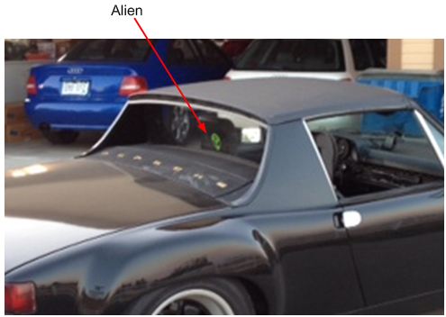

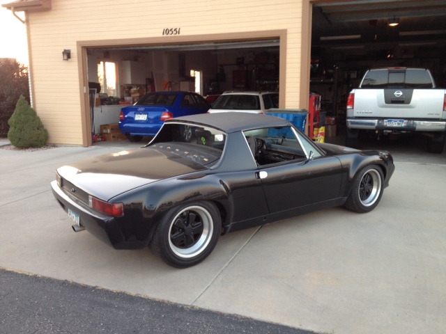

The Alien has landed.
(McMark, a LiveEventUploader would be greatly appreciated and richly rewarded (IMG:style_emoticons/default/beerchug.gif) )

Nice Rick! Glad to see you made (IMG:style_emoticons/default/piratenanner.gif)

He just beamed himself in. Yeah!

Well done! That Alien has to be one of the most traveled cars out there?? Does anyone keep track of those kind of things?
