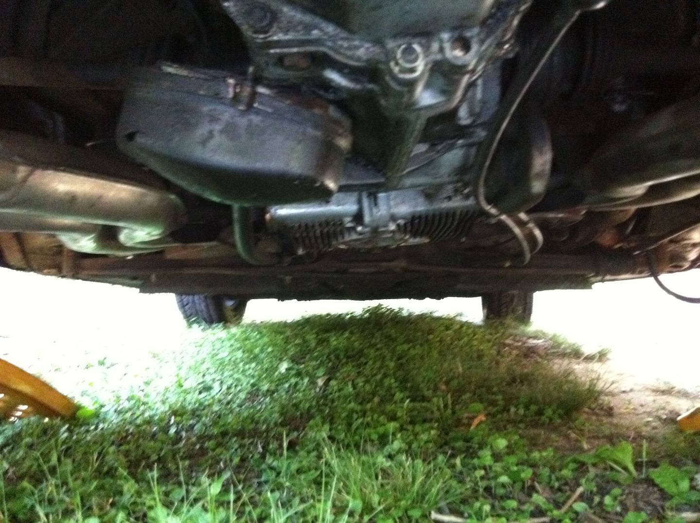

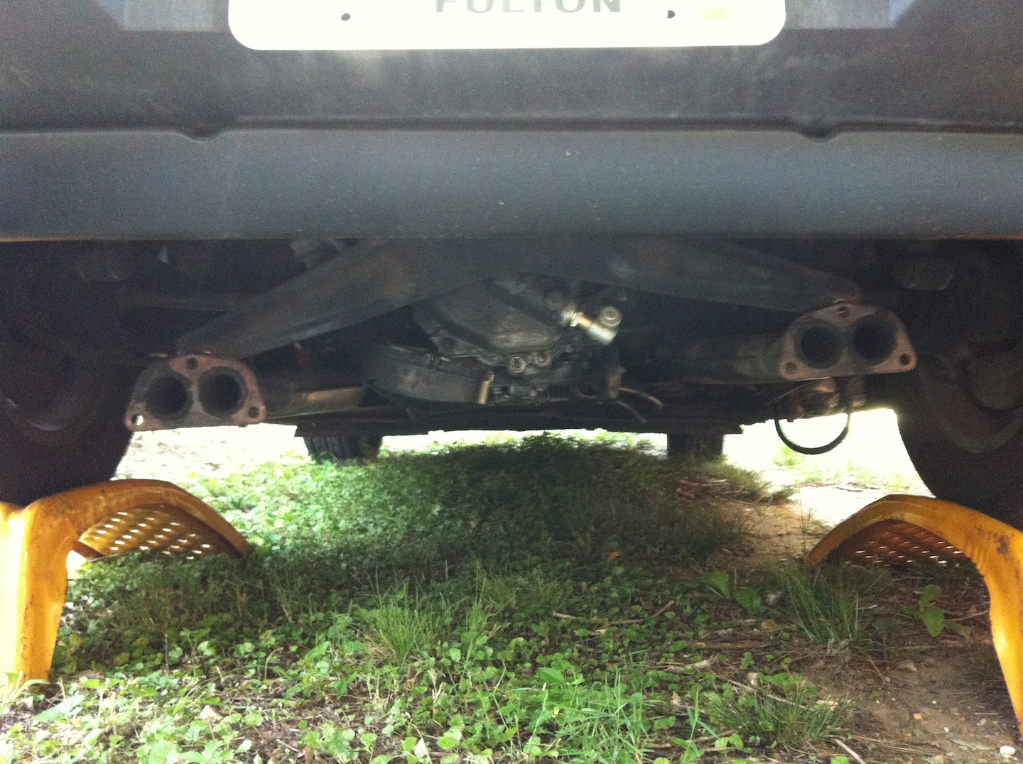

Replacing my Monza muffler with something quieter and noticed one side of the exhaust was a good bit lower than the other. Once the exhaust was removed, it seems the whole engine + transmission is rotated a bit towards the driver's side.
Any clue as to why this would happen? Pics below. Thanks in advance.
MarkAttached Image Attached ImageAttached Image

Has your left transmission ear broken loose from the mount? Is it bolted into place without the bushing between the right ear and the bottom of the trunk?

Either your mounts are bad / damaged / ?? or the body is twisted.

take a picture of the rear of the tranny looking up at the mount, you may even be missing some harware
also from the top of the engine does the tin line up on both sides or can you get your fingers in there. Scarry

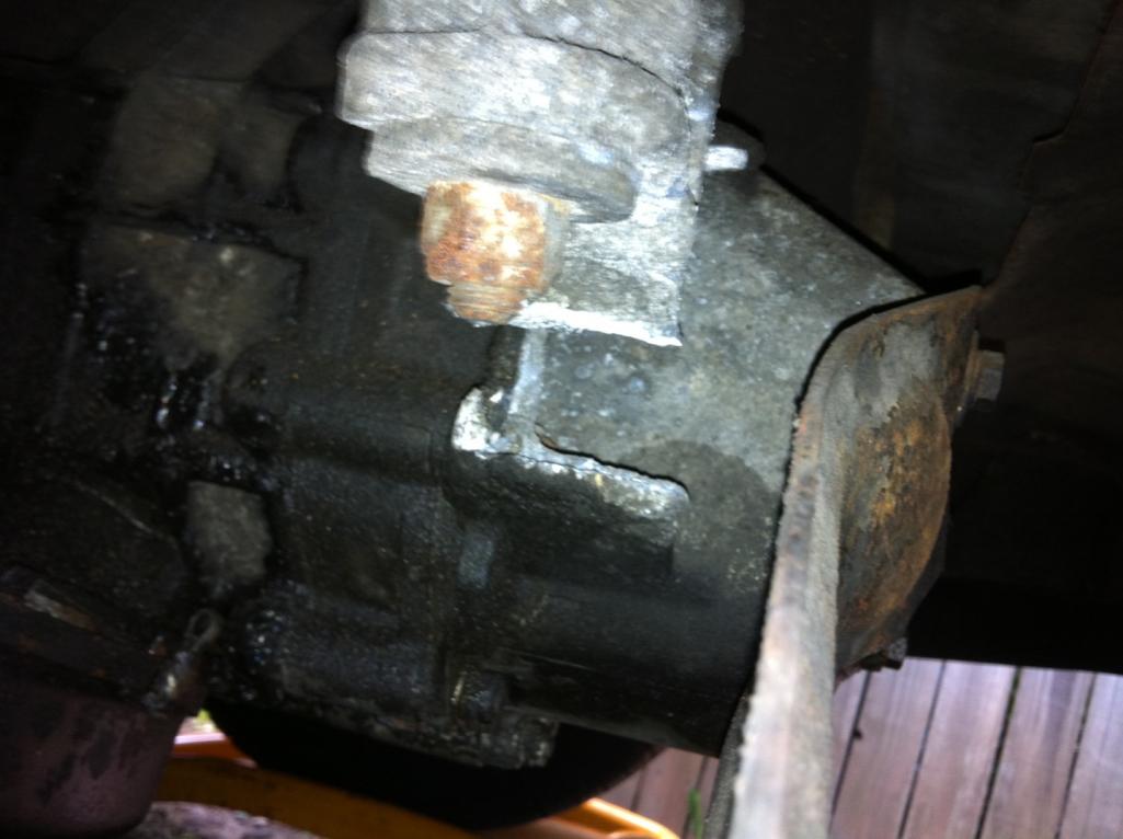

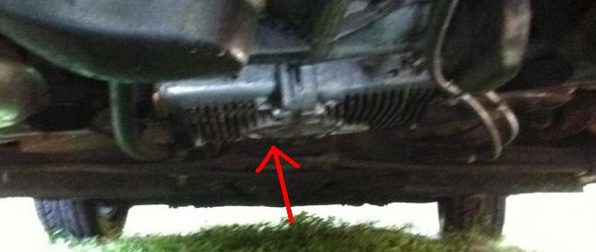

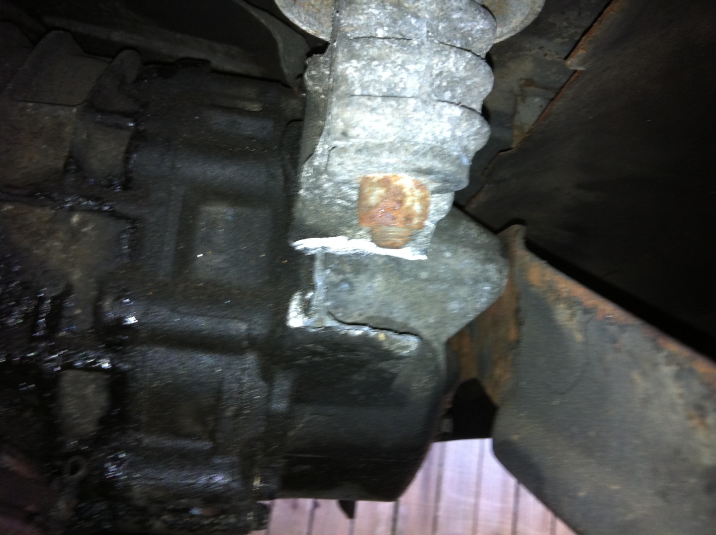

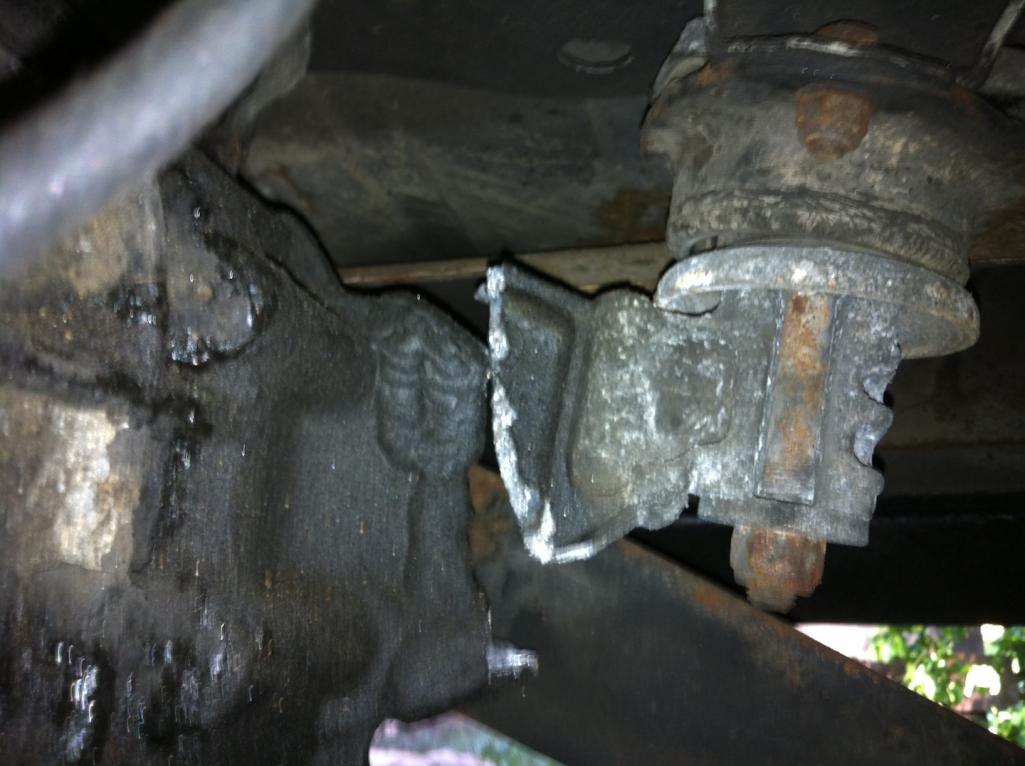

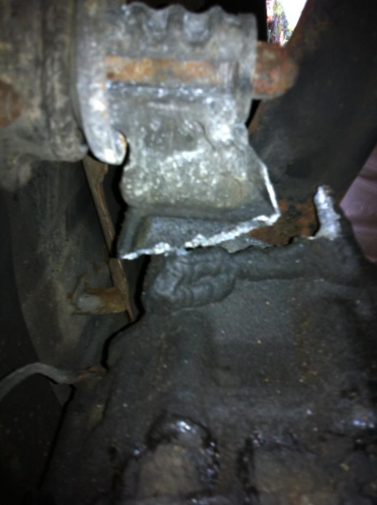

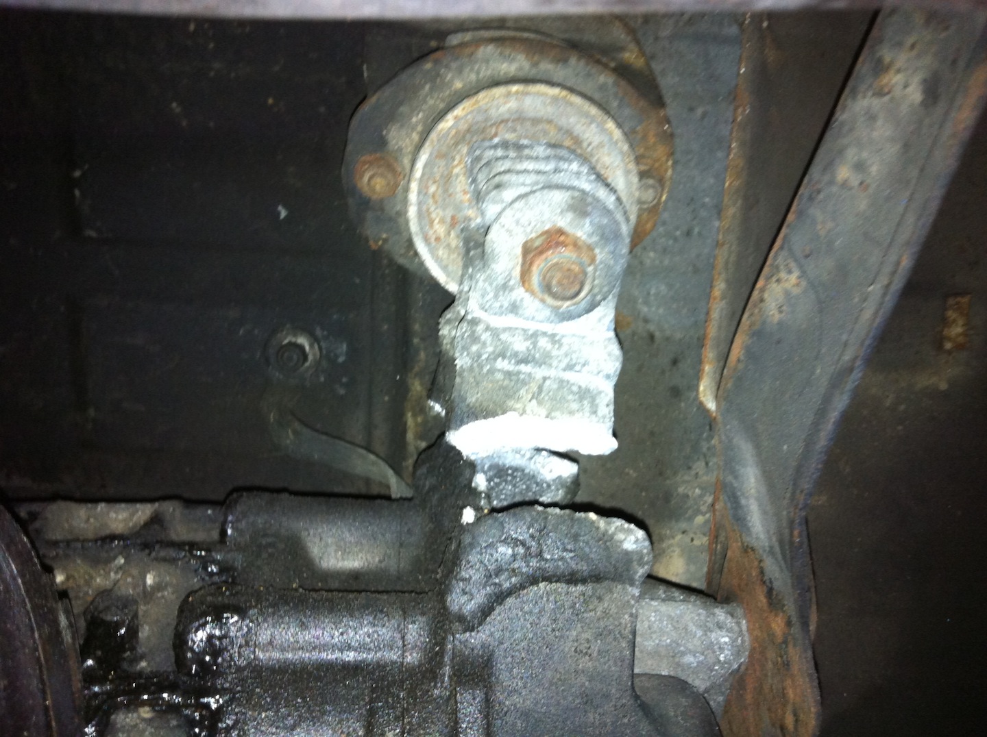

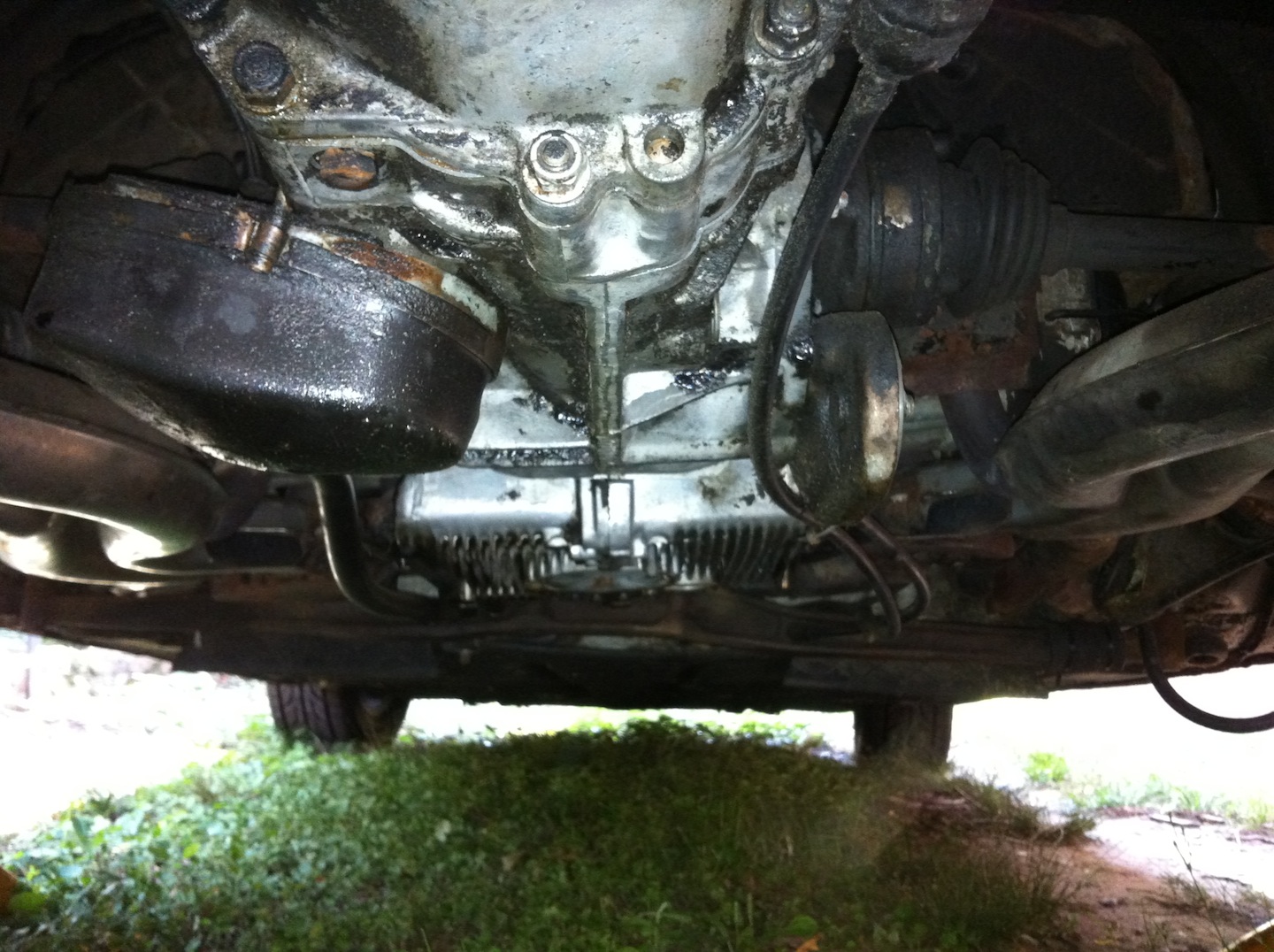

ok, found it. see pics below. this does not look cheap.
what is the fix? Attached ImageAttached ImageAttached Image[attachmentid=319

Looks like it's been fixed before. It's not as bad as you would think. Dr. Evil can hook you up with parts. I have two nose (or is it tail on a teener) cones hanging around my garage. I'm sure others closer to you have spares. I'd check the front engine mounts too. The rubber may be torn up.

It does look like it may have been welded before.
What does the fix involve? Replacing the nose/tail?

Replace it. Has the car been in a wreck? That is usually what happens when it gets in hit the rear or from one side. Have two here with both sides snapped on impact.

Looks like the transmission has been neglected. It can be changed in the car but I would suggest sending it out or do a swap. I am guessing you are way overdue for an oil change.

Since the ear broke twice in the same place there are 2 possibilities:
1. bad welding the first time
2. there is some stress on that ear due to body deformation. Make sure this is not the case before you make the repair and brake it again.

Check your front engine mounts. I think they're torn up putting extra stress on the left ear.

Think you should change both the motor mounts and trans mounts. You don't want to go through this twice if you can avoid it.
