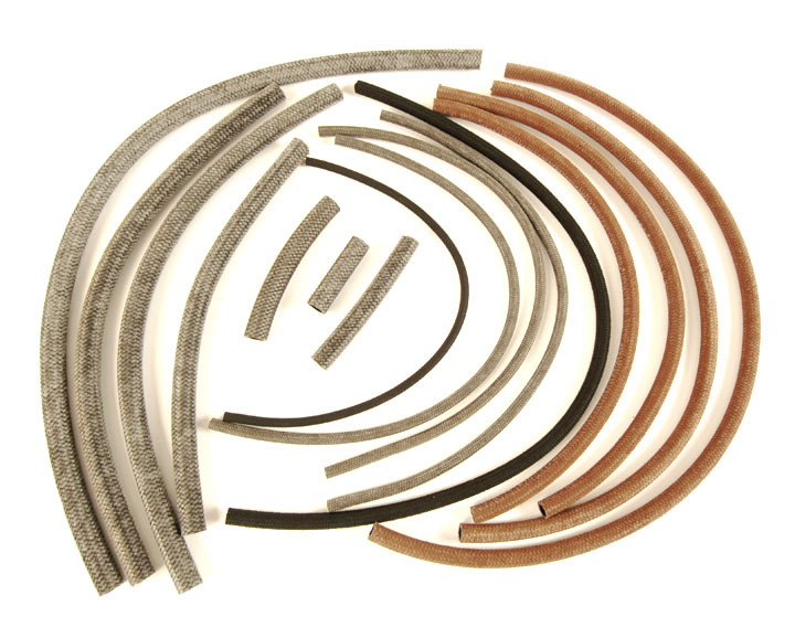

Hello' I am looking to buy a complete set of hoses/vacuum lines for my 2.0l engine. I know I can buy all the individual hose by the metre from Pelican but, is a there a complete, pre-cut set available?

I believe auto atlanta sells a kit
Automobile Atlanta
Type in "914 vacuum kit" in the search field - several results

Here is link:
http://www.autoatlanta.com/Porsche-Vacuum-...BAAVACKIT3.html
I purchased the kit for my 1.7 last fall.
Here is link for fuel line kit.
http://www.autoatlanta.com/Porsche-Fuel-Li...AA20100074.html

I would caution you about using that cloth covered fuel hose. Its not compatible with ethanol fuels. It will breakdown the rubber inside, and leak thru the fabric hose. Use only hose meant for modern fuels. Goodyear 30R, or Cohline, or even napa now has a high pressure hose that is rated for use with any fuel. Use the proper FI hose clamps too. Not the serrated worm gear clamps with the holes in the band.

Does this kit include everything needed to replace the fuel lines in engine compartment? The description talks only about under fuel tank.
