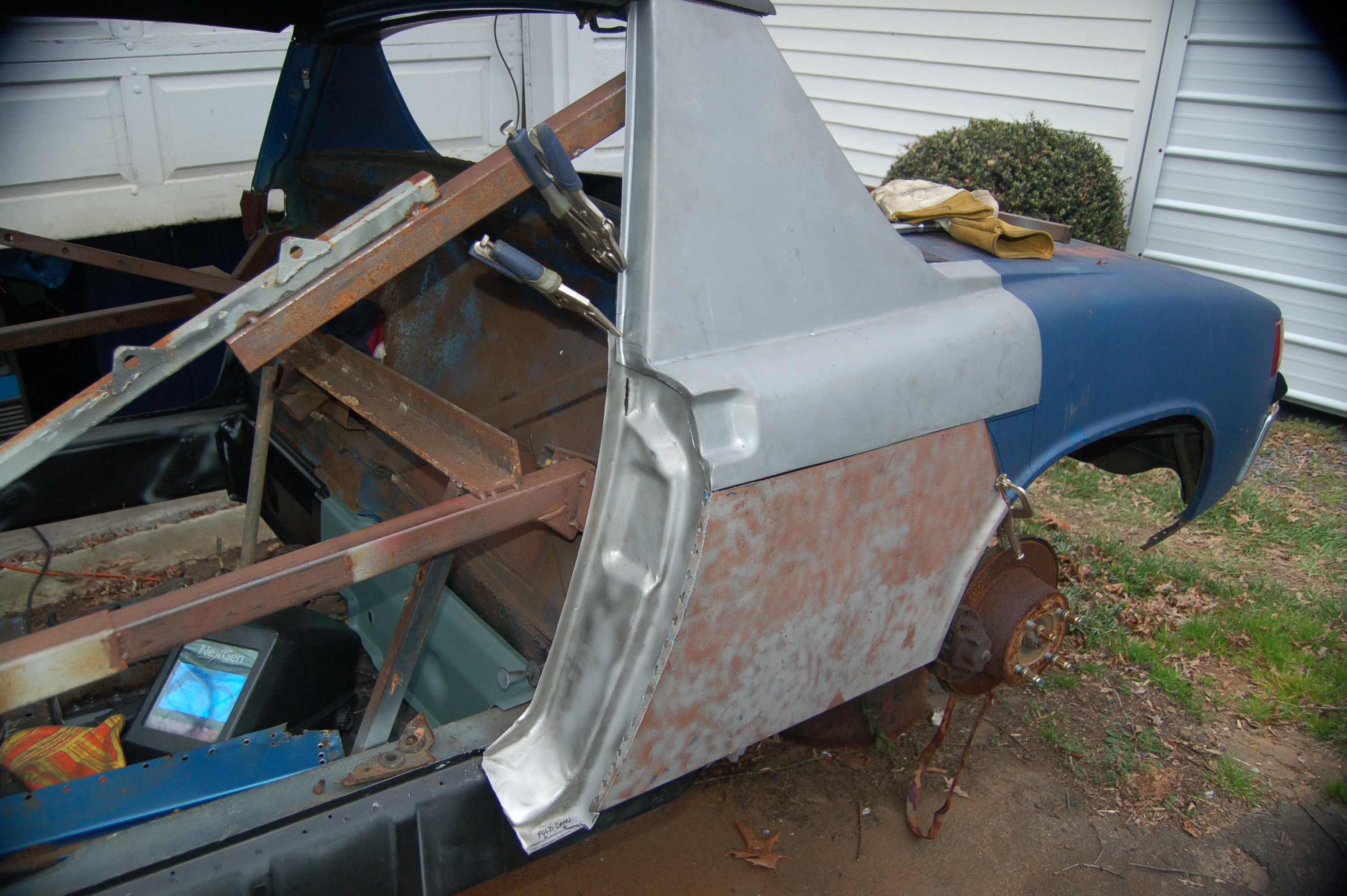

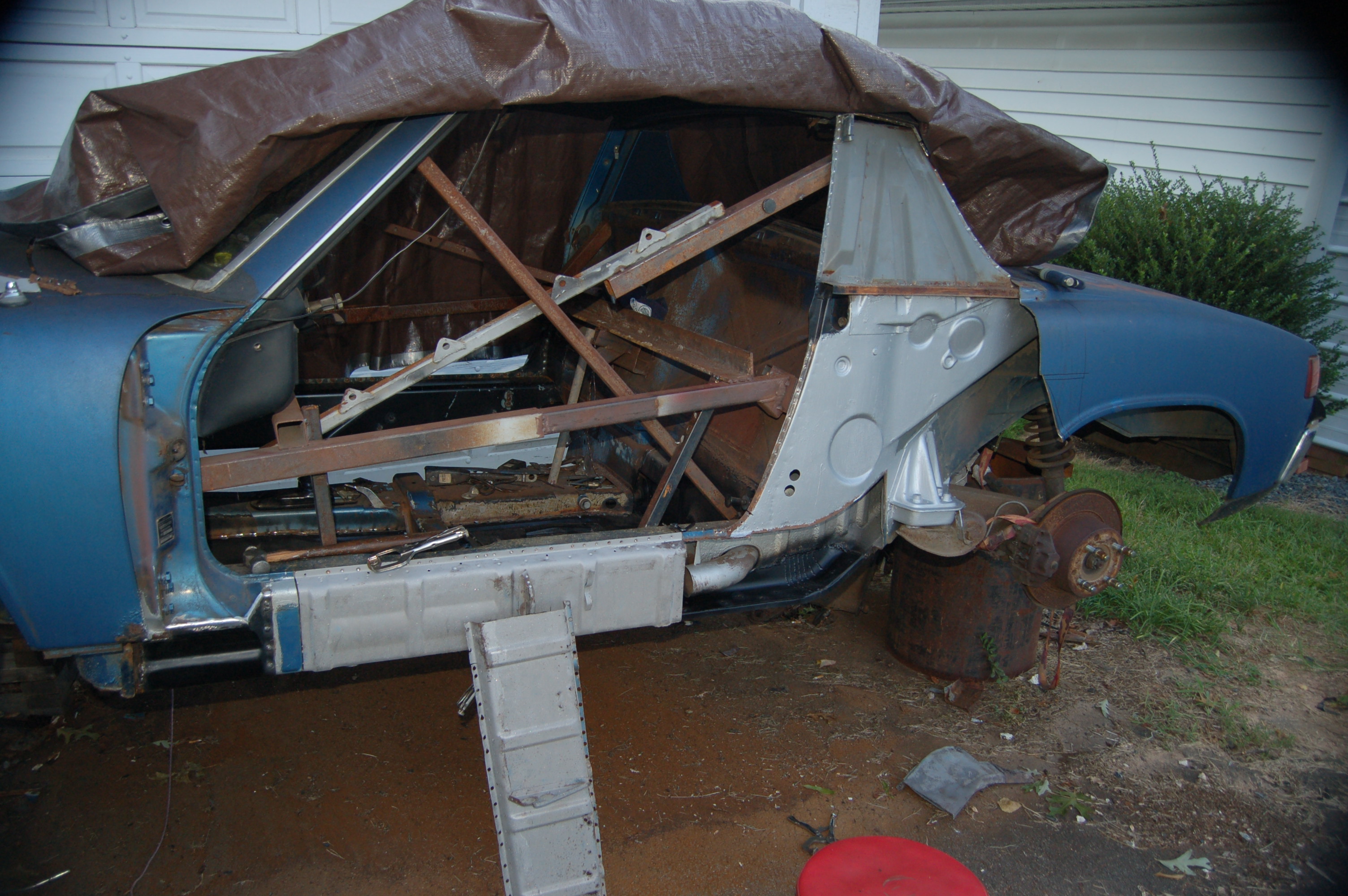

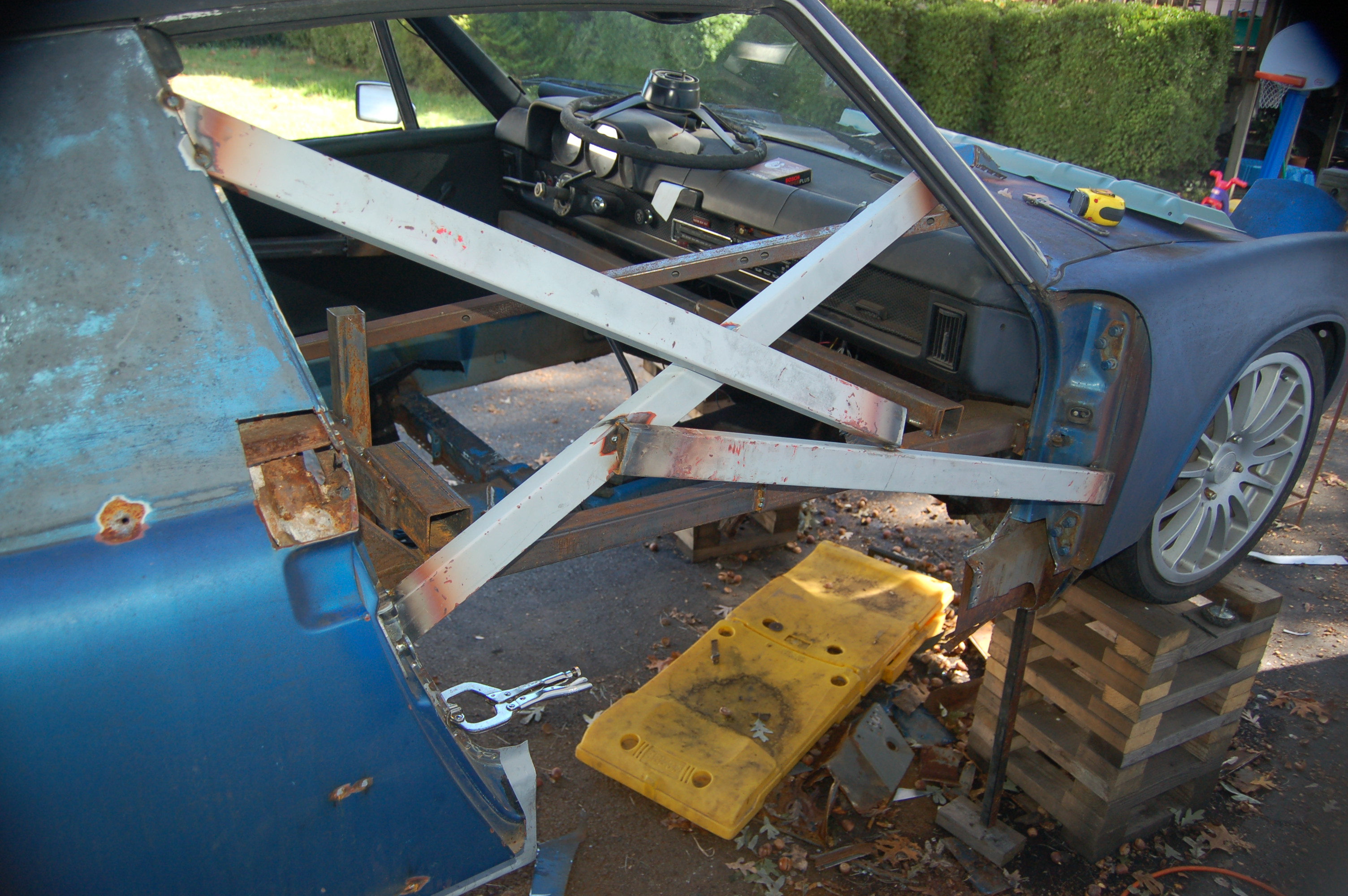

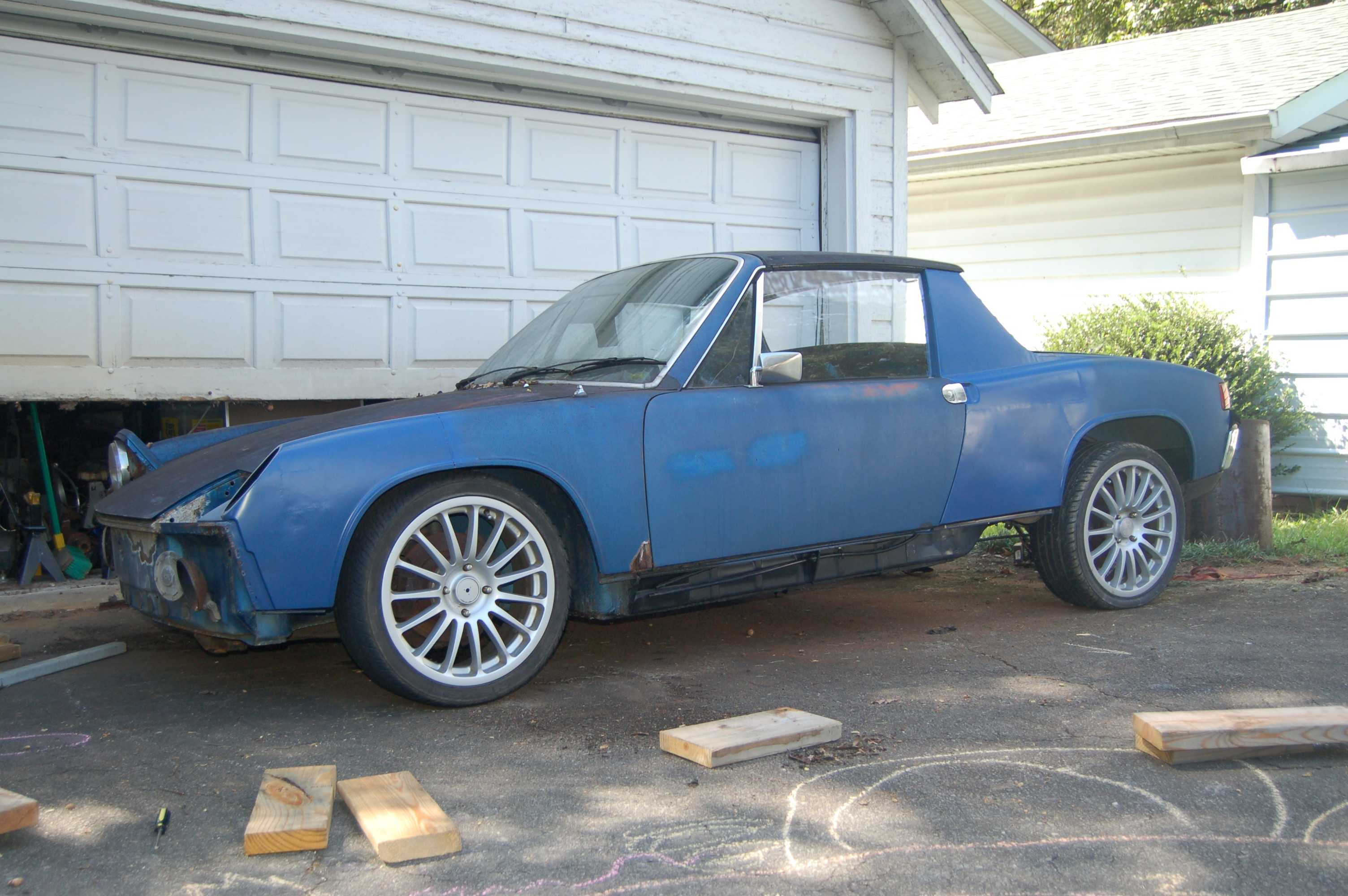

Hello 914 world! Ive been lazily lurking here for way too long and finally decided
to change that tonight. So heres my 1st contribution to all this 914 awesomeness.
This is my 914 back in 2010 when I started the rust repair. I'm almost done with
rust repair now and I have lots of pics but I have to resize and post latter. It seems like these pics are gonna work even though they are big so I guess we'll see what happens.

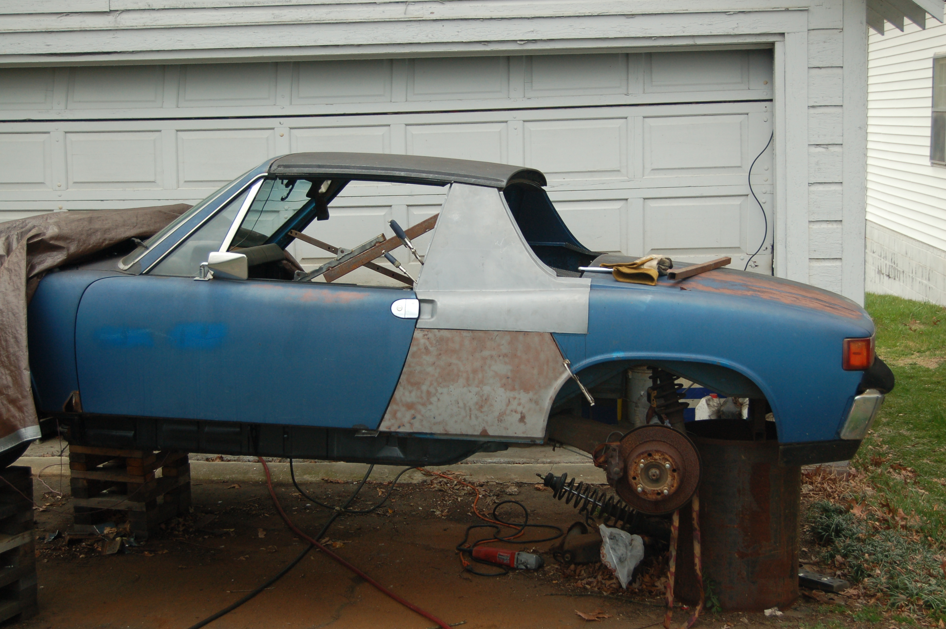

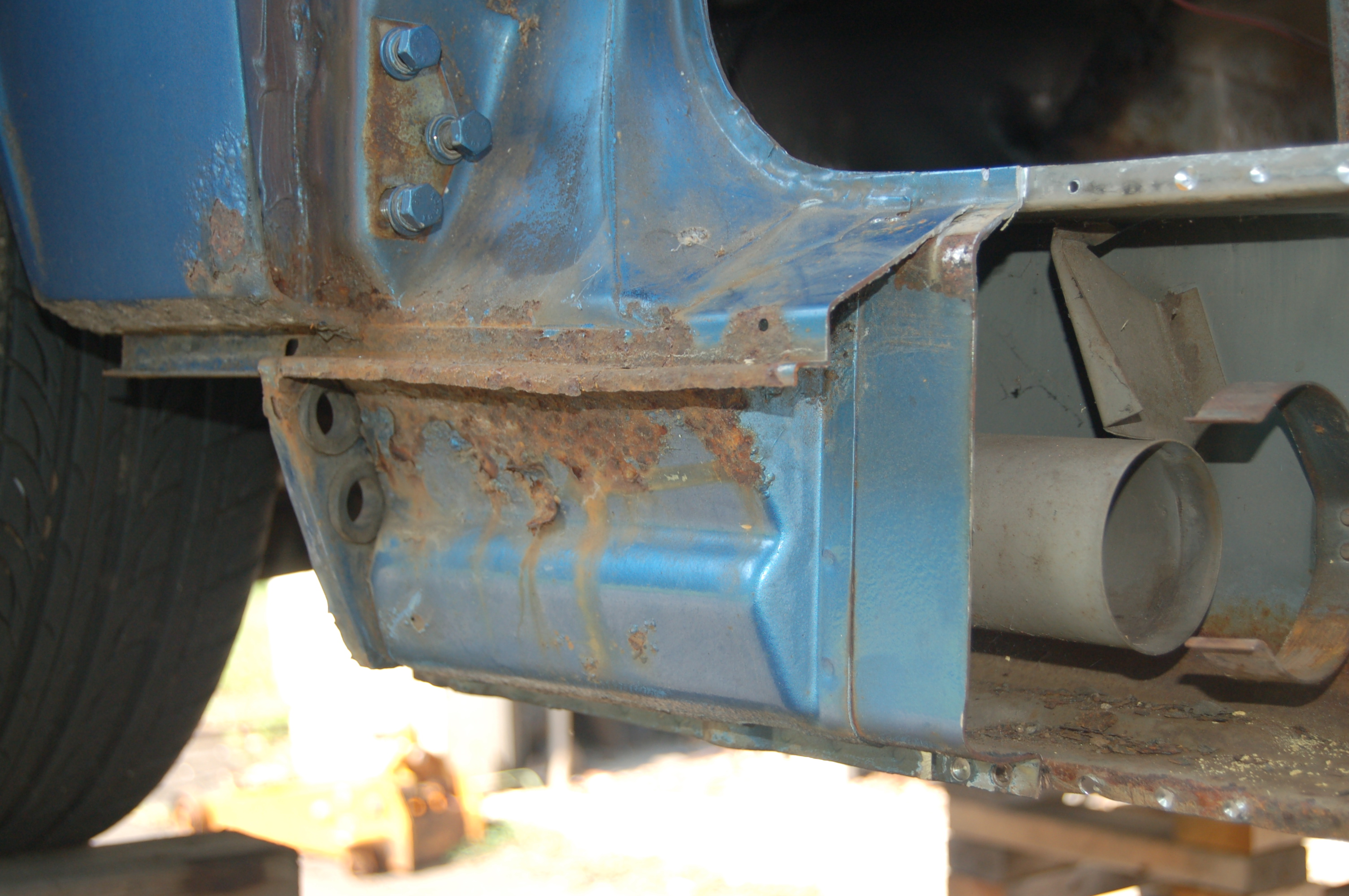

metalmorphosis   Heres a few more from 2010. Kind of k-rusty. Hey D...   Jul 31 2012, 09:11 PM

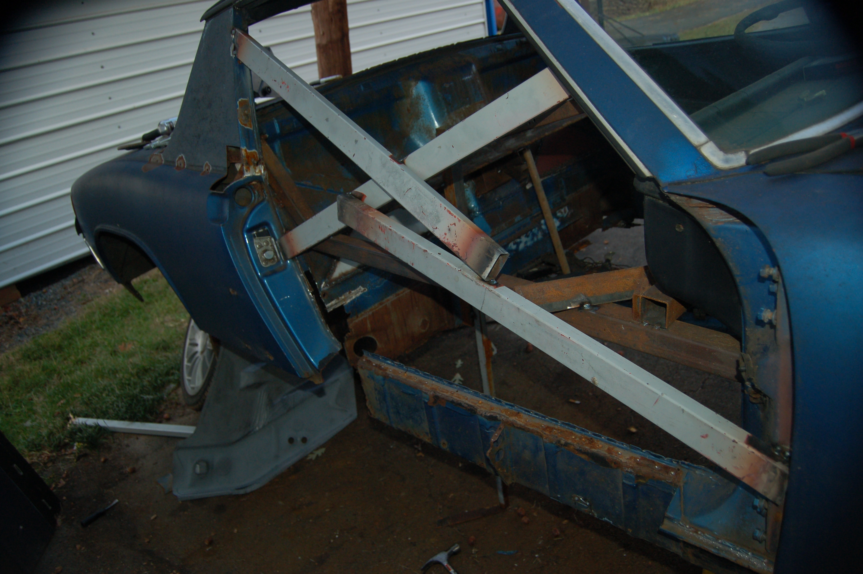

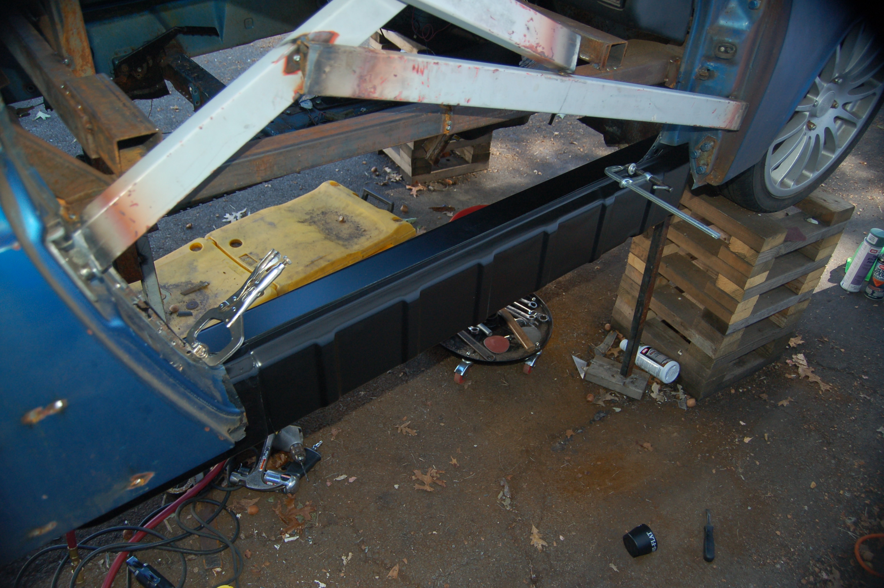

metalmorphosis   Check out my "jackstands"   Jul 31 2012, 09:15 PM
scotty b   That's trouble just waiting to happen. Nice kn...   Jul 31 2012, 09:45 PM

mepstein   Please add me to your life insurance. $...   Aug 1 2012, 06:08 AM

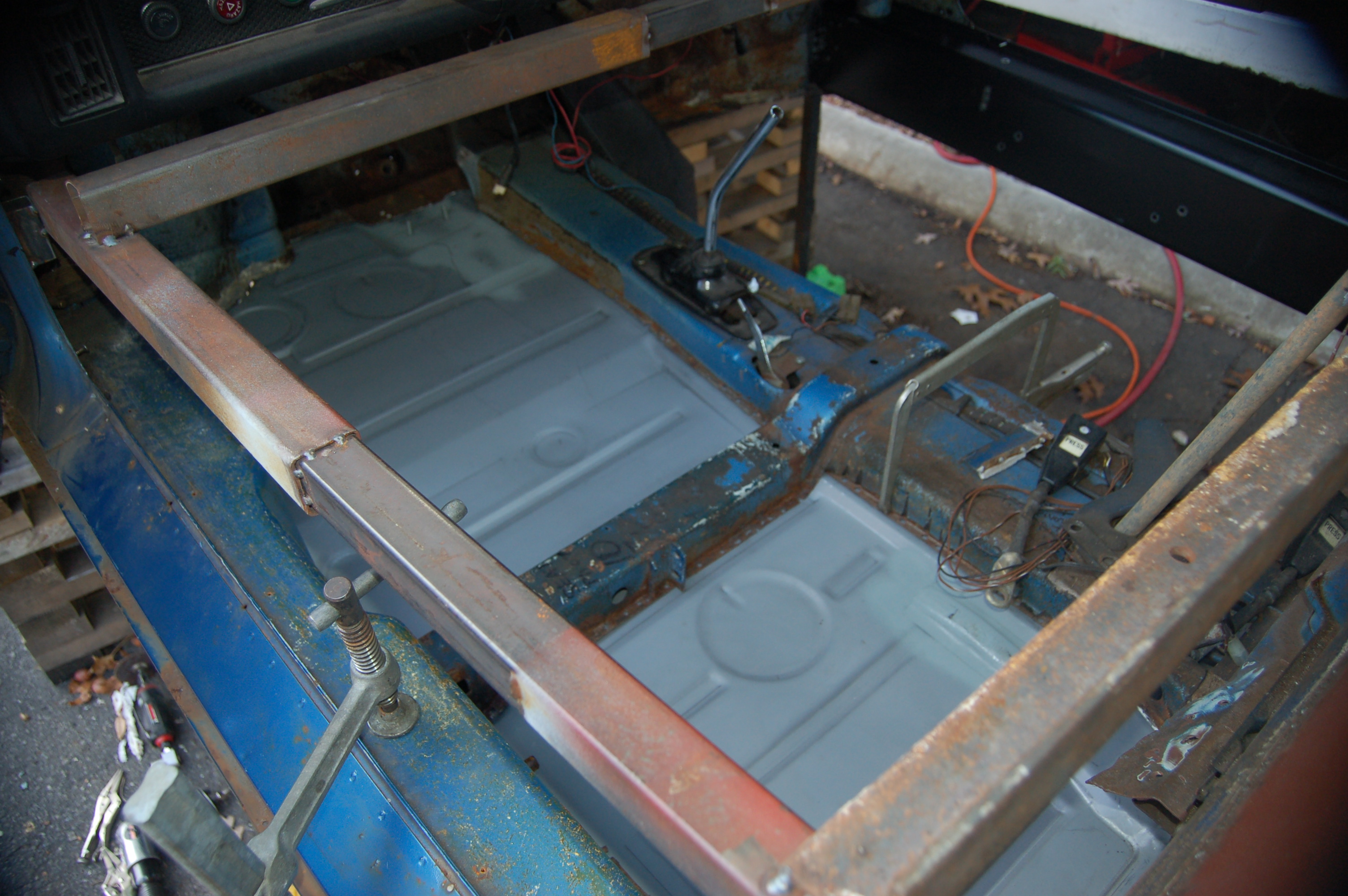

arkitect   Looks like you have it braced thru the doors and a...   Aug 1 2012, 08:08 AM
Spoke   Good luck with the rustoration. As others said, g...   Aug 1 2012, 10:11 AM
metalmorphosis   Hey guys I appreciate all of y'alls concern ab...   Aug 1 2012, 11:12 AM

metalmorphosis   more k-rust   Aug 1 2012, 08:24 PM

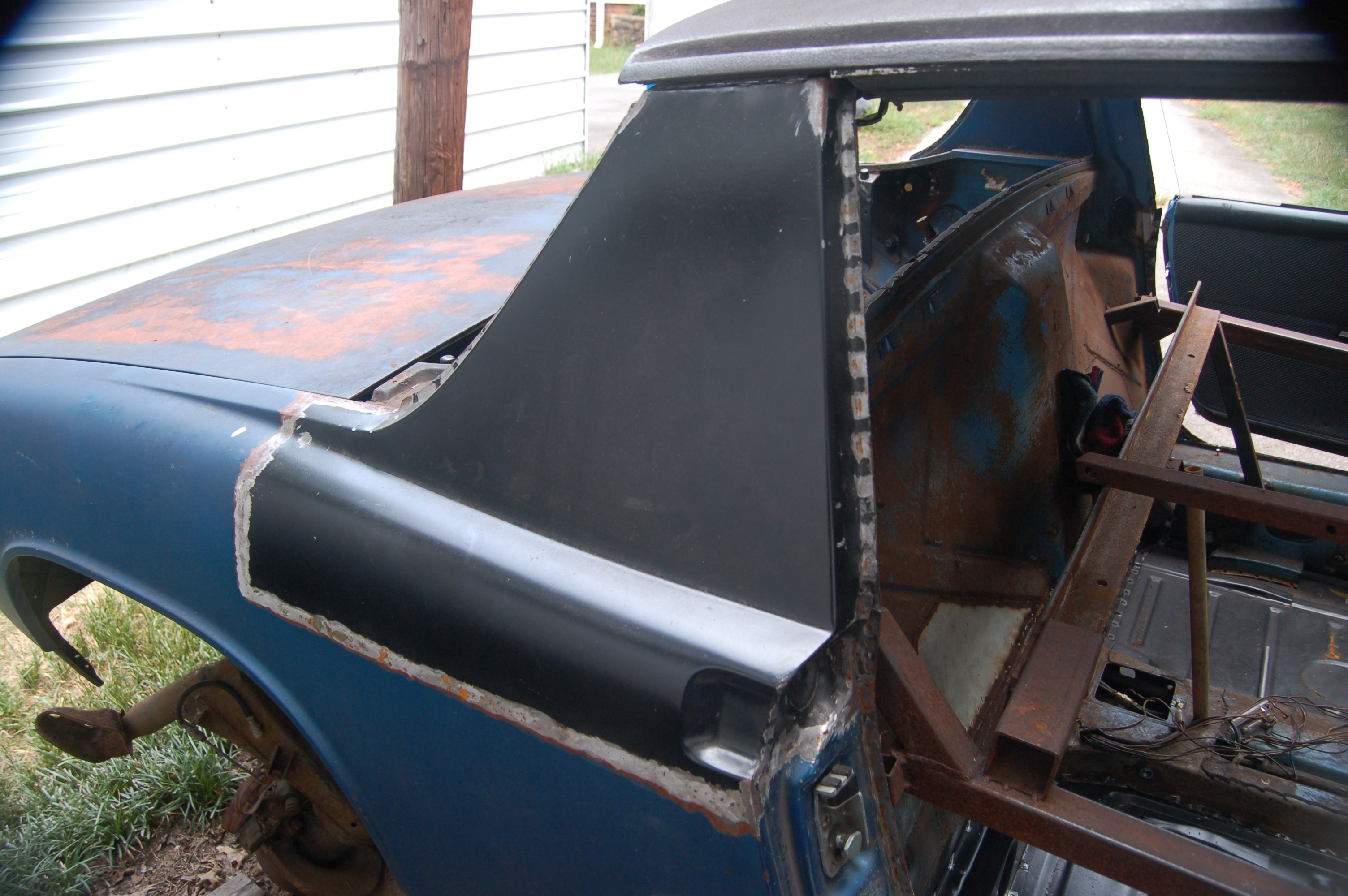

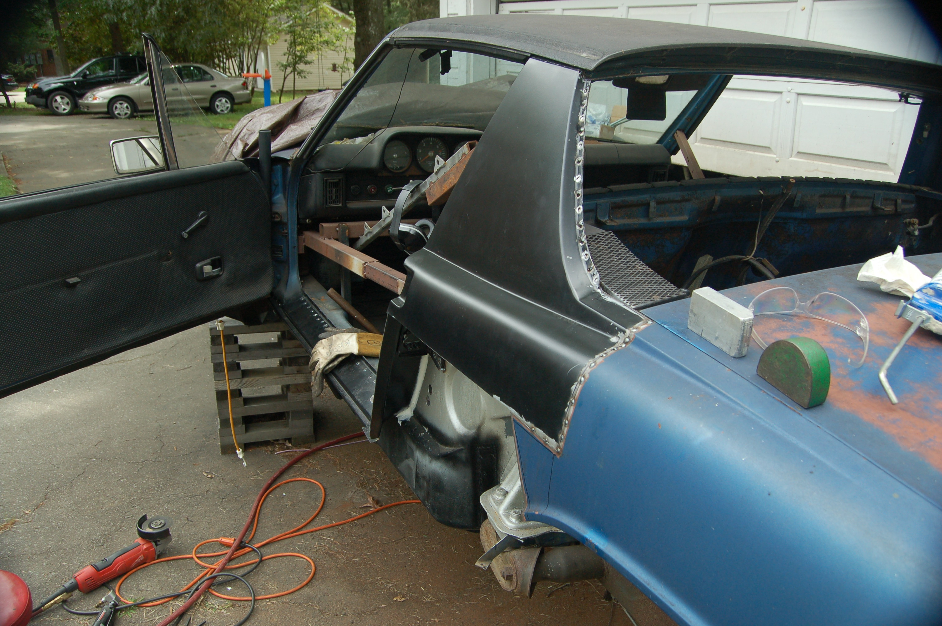

metalmorphosis   Heres a little more of the pass side going back to...   Aug 2 2012, 06:52 PM

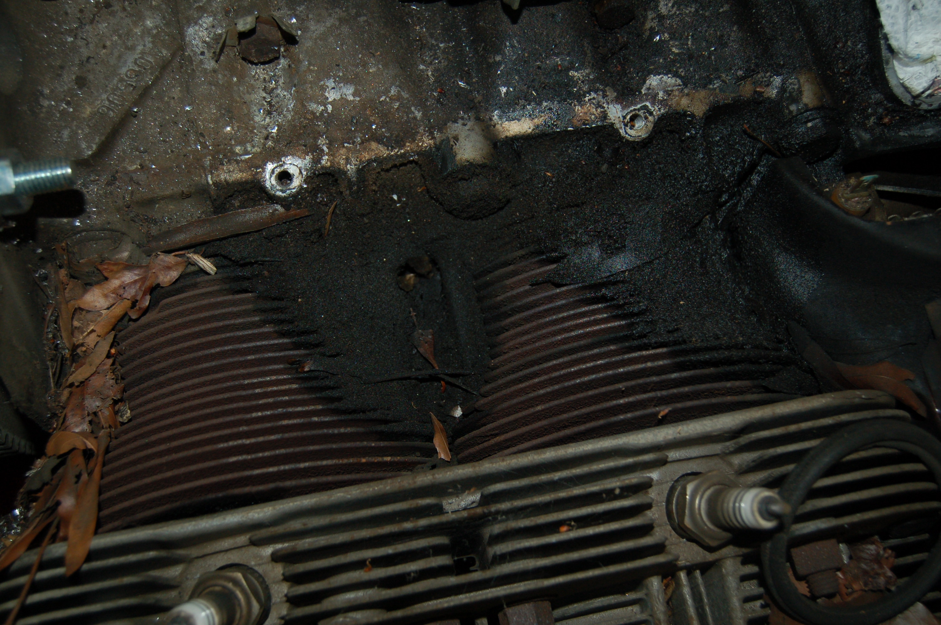

metalmorphosis   Well I had hoped to paint my engine compartment an...   Aug 5 2012, 07:19 PM

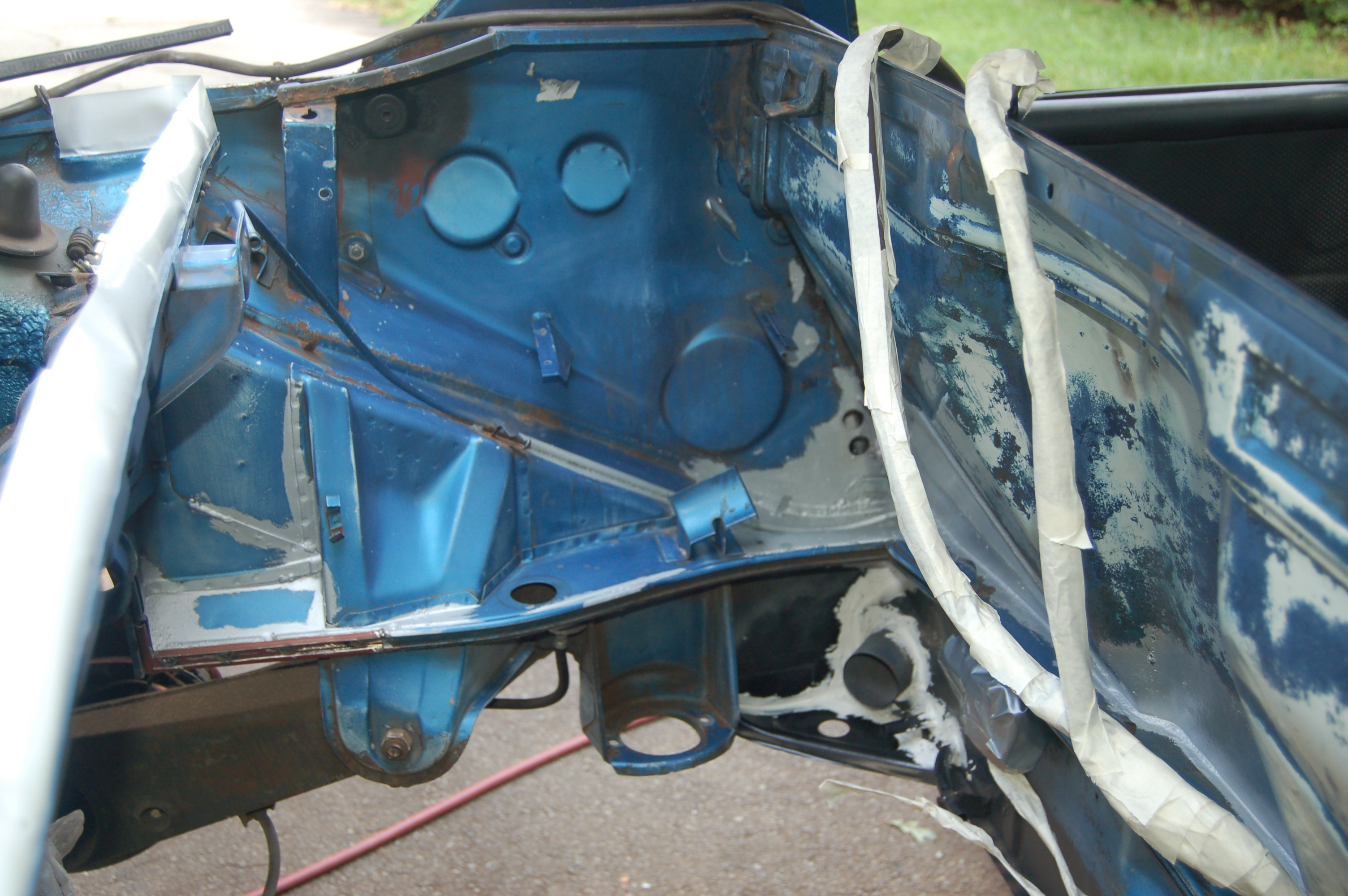

metalmorphosis   Hello again everyone, its been almost 2 wks since ...   Aug 19 2012, 06:24 PM
metalmorphosis   Heres a few after shots.   Aug 19 2012, 06:26 PM

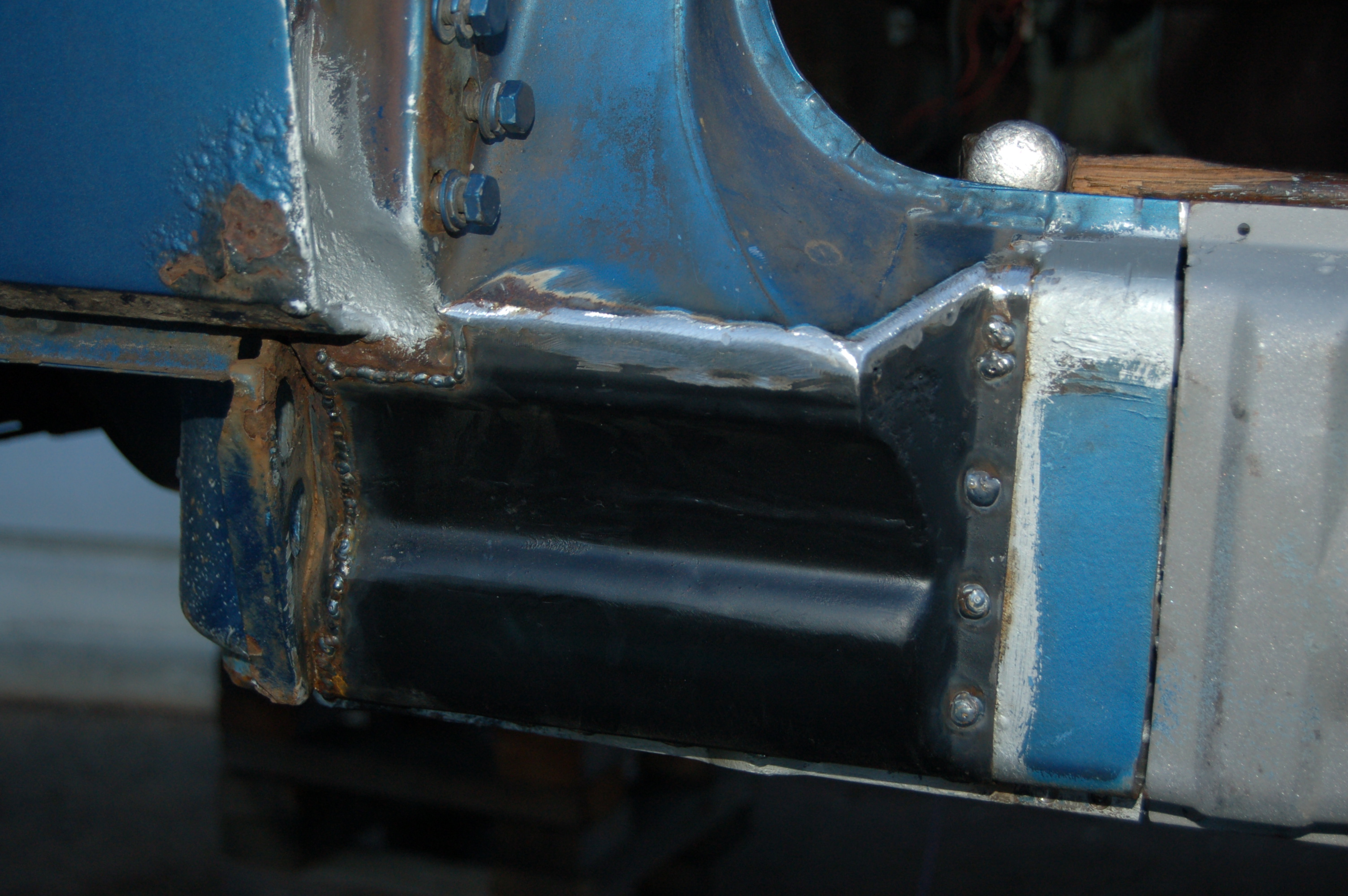

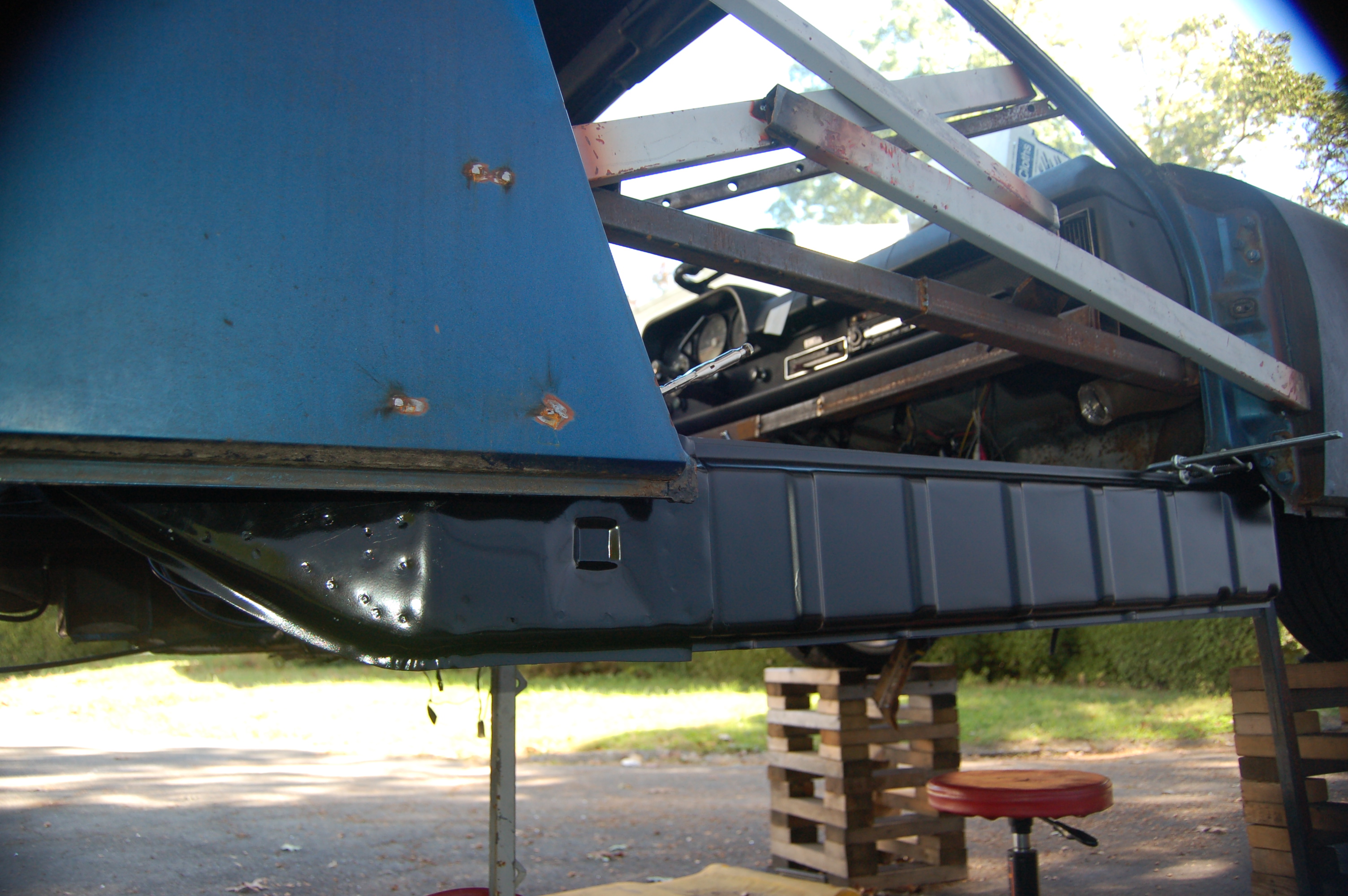

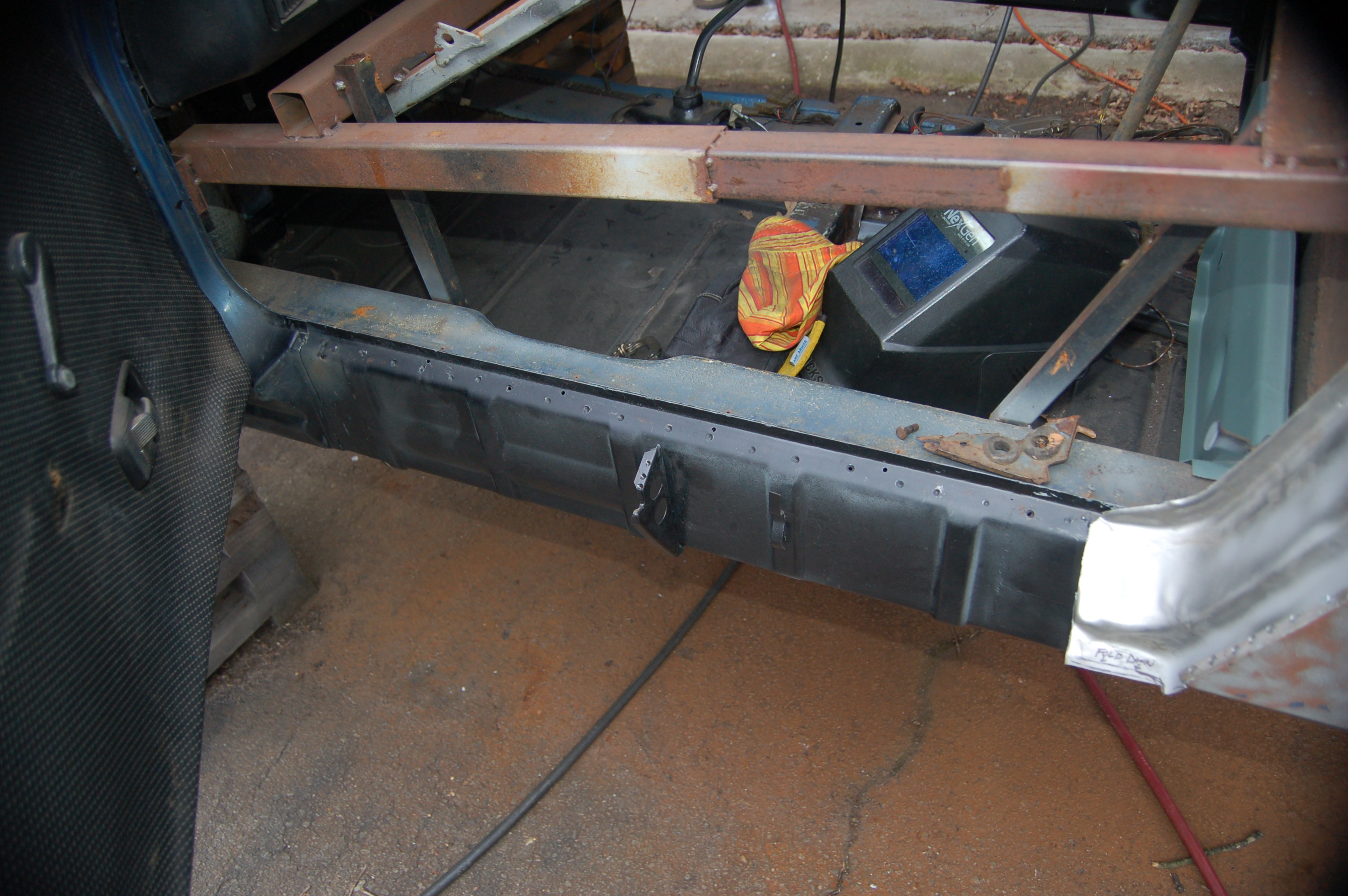

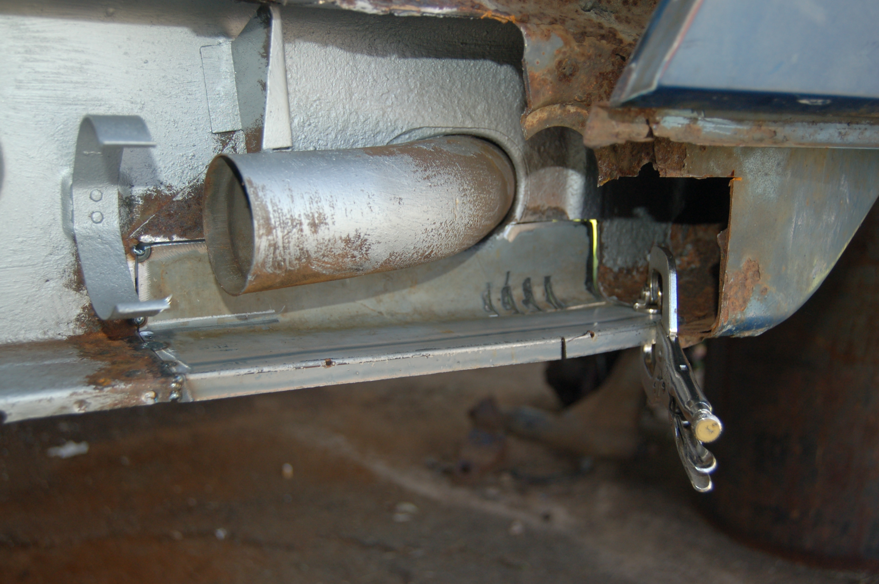

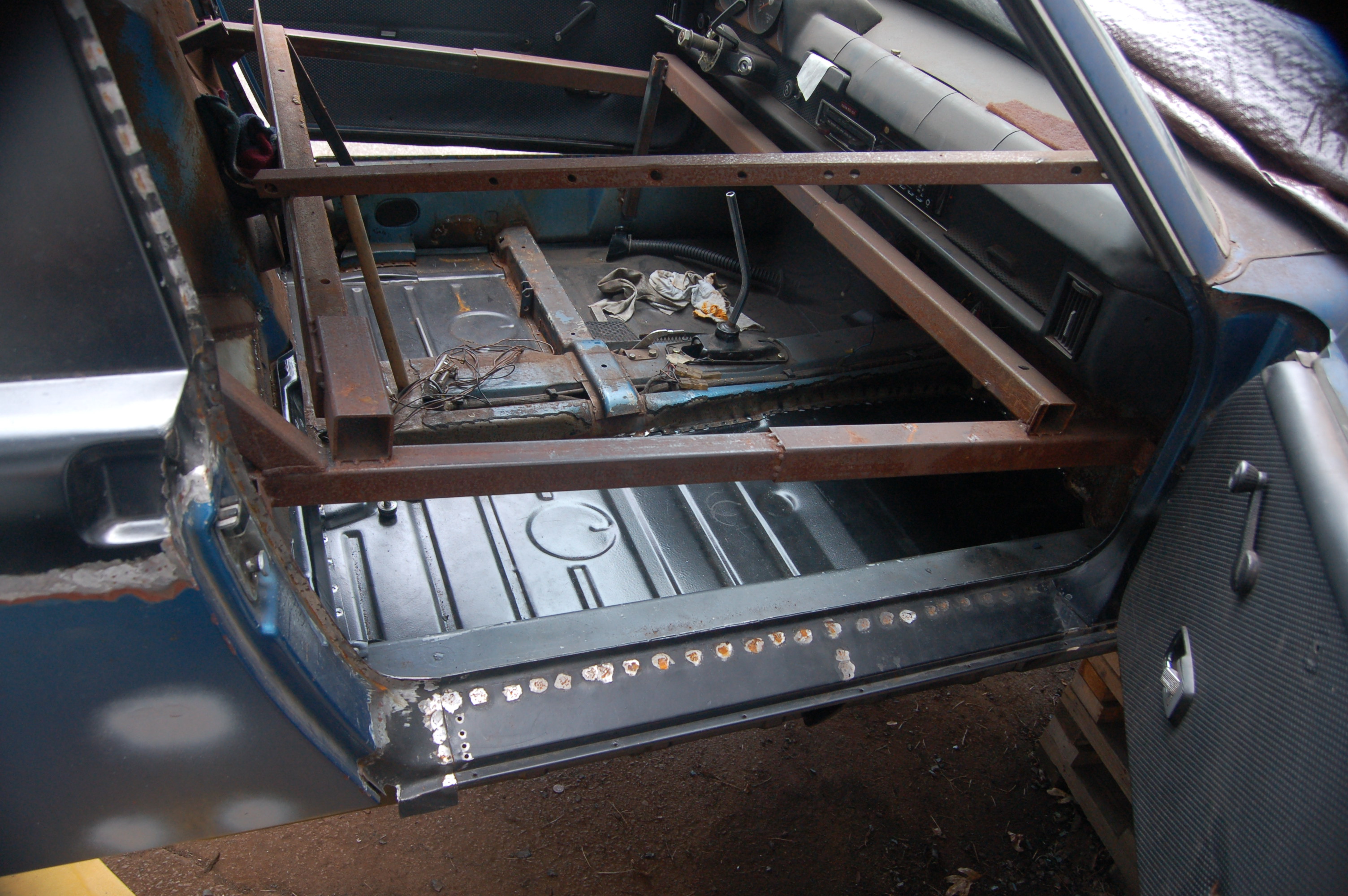

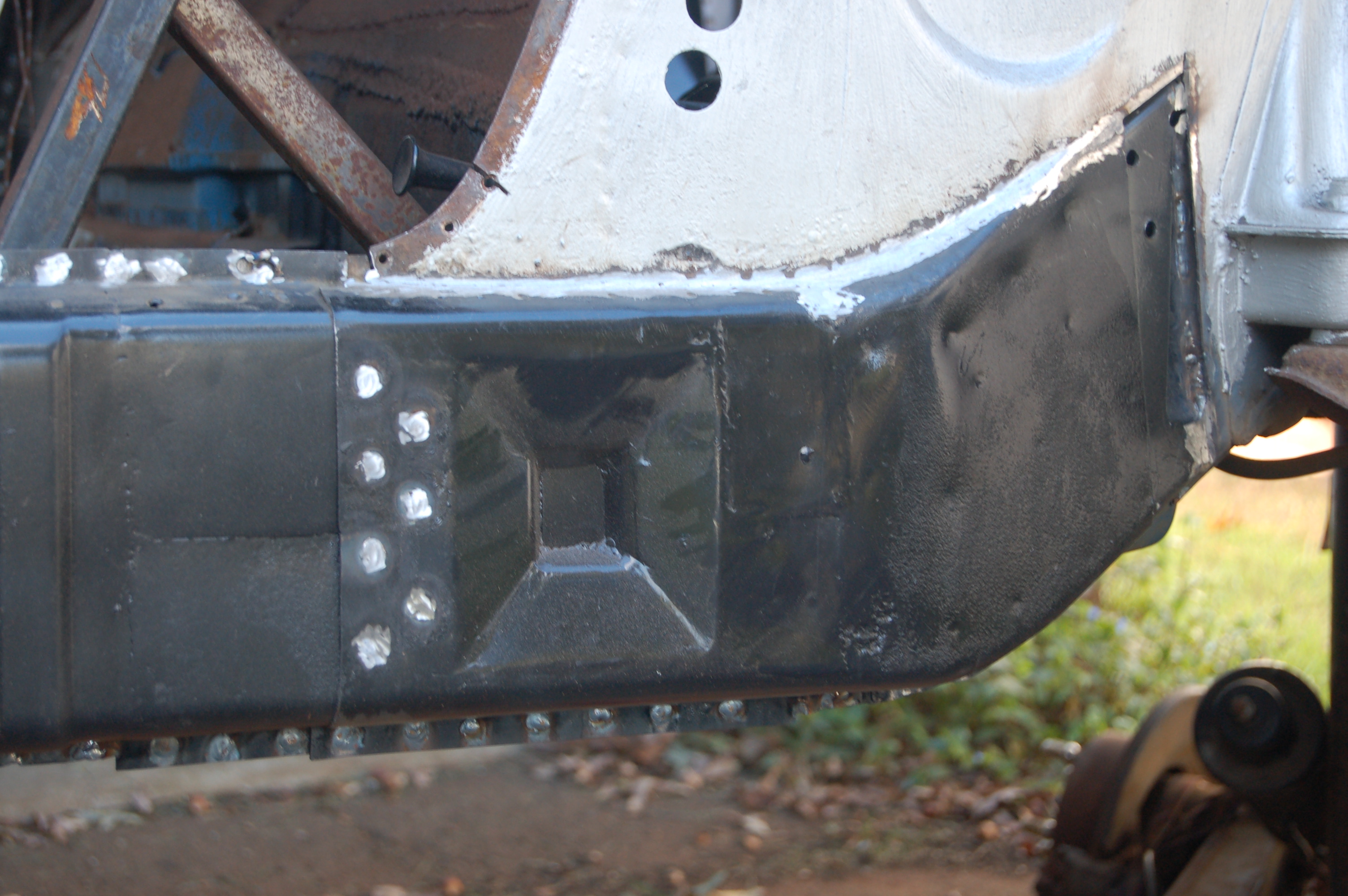

metalmorphosis   And now for the sill plate.   Aug 19 2012, 09:56 PM

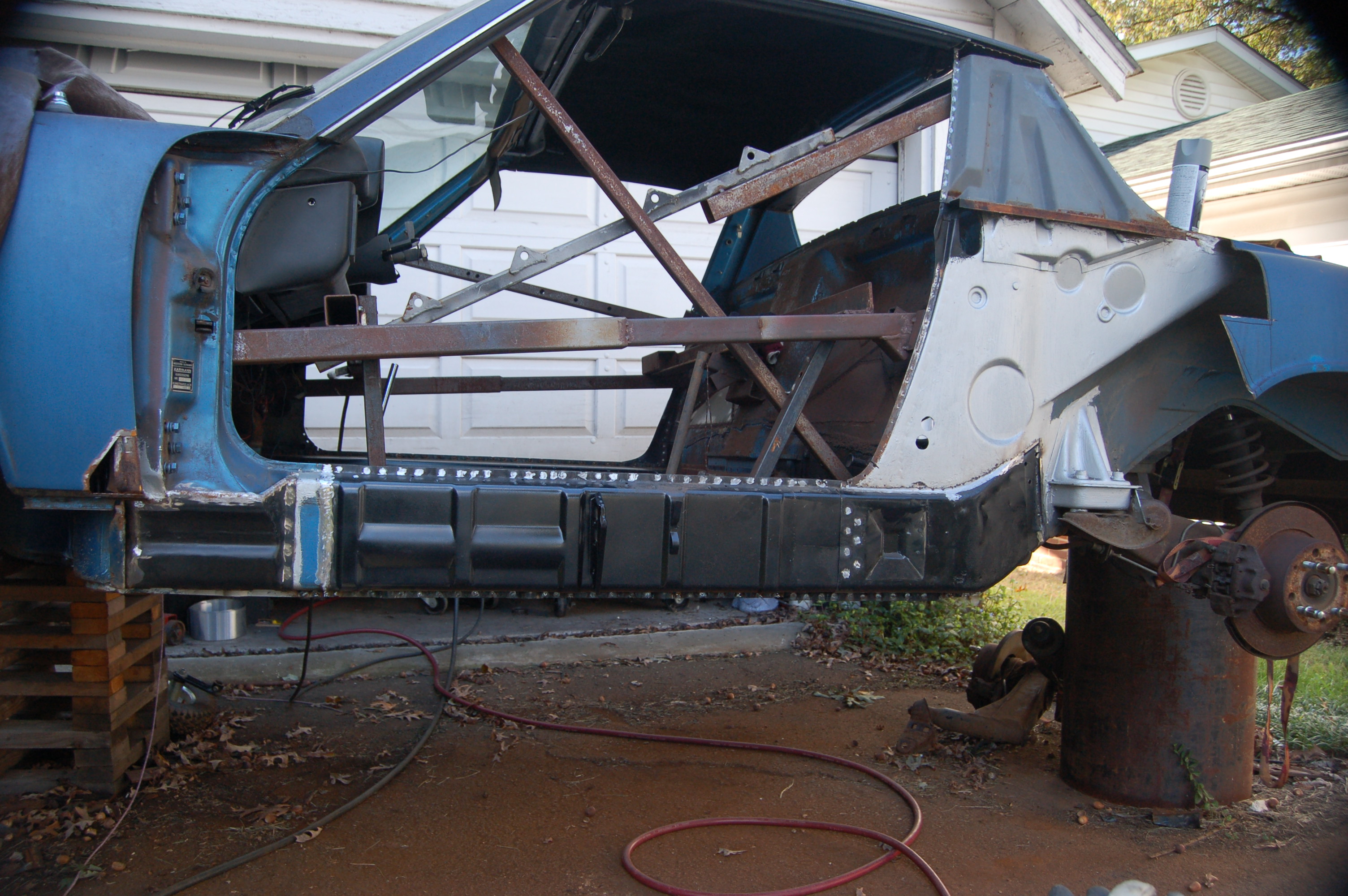

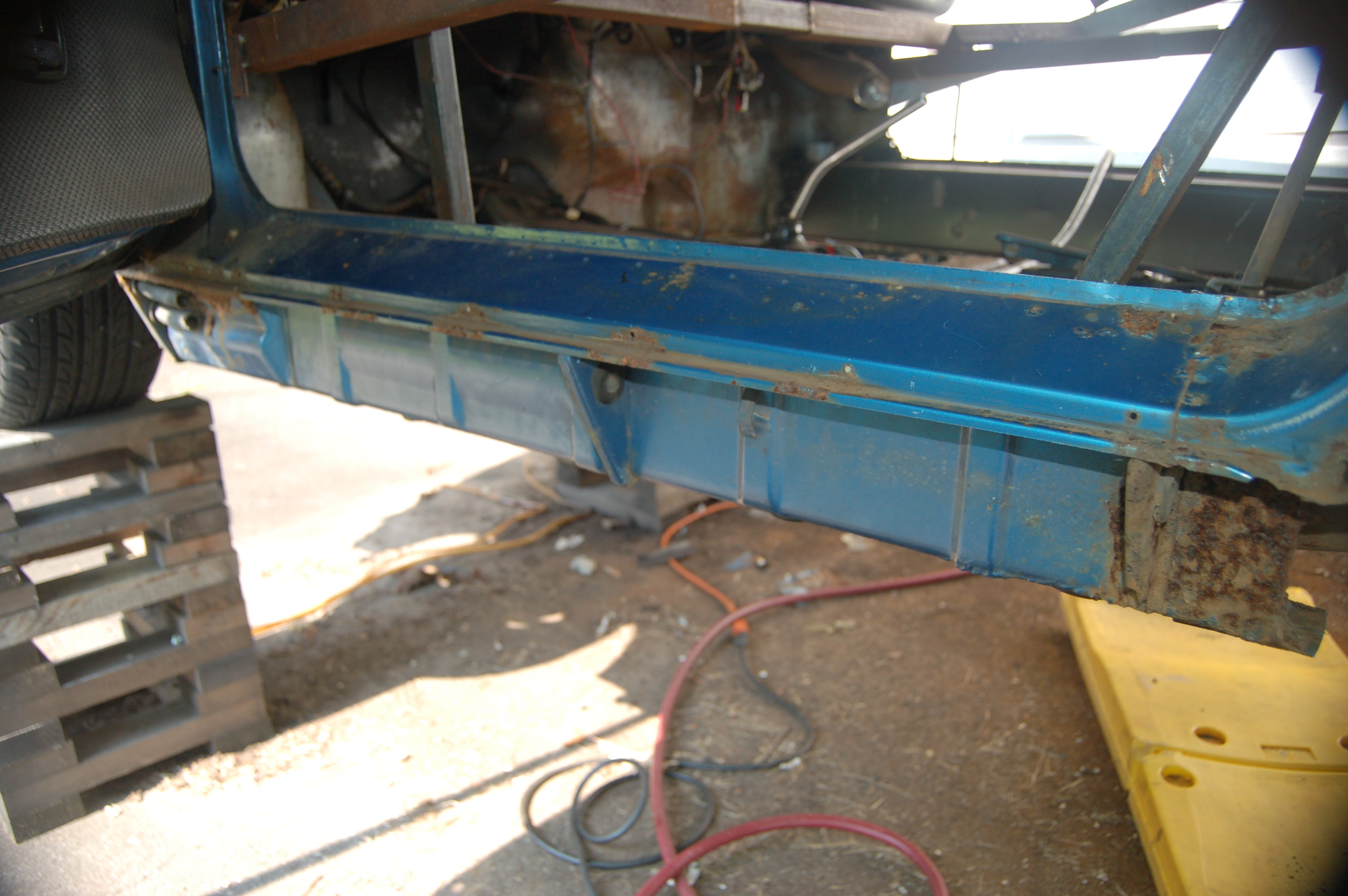

metalmorphosis   Heres more of the drivers side goin back together ...   Aug 20 2012, 10:10 PM
metalmorphosis   A few more.   Aug 20 2012, 10:12 PM

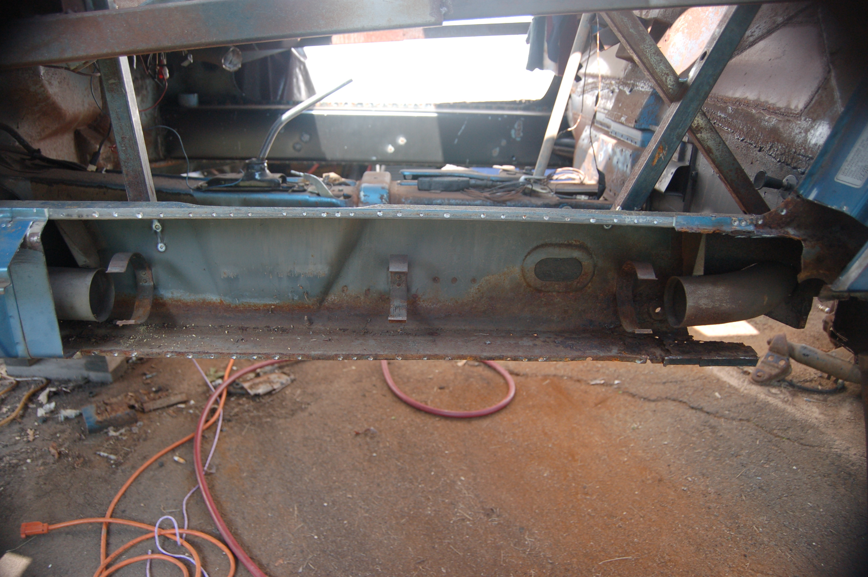

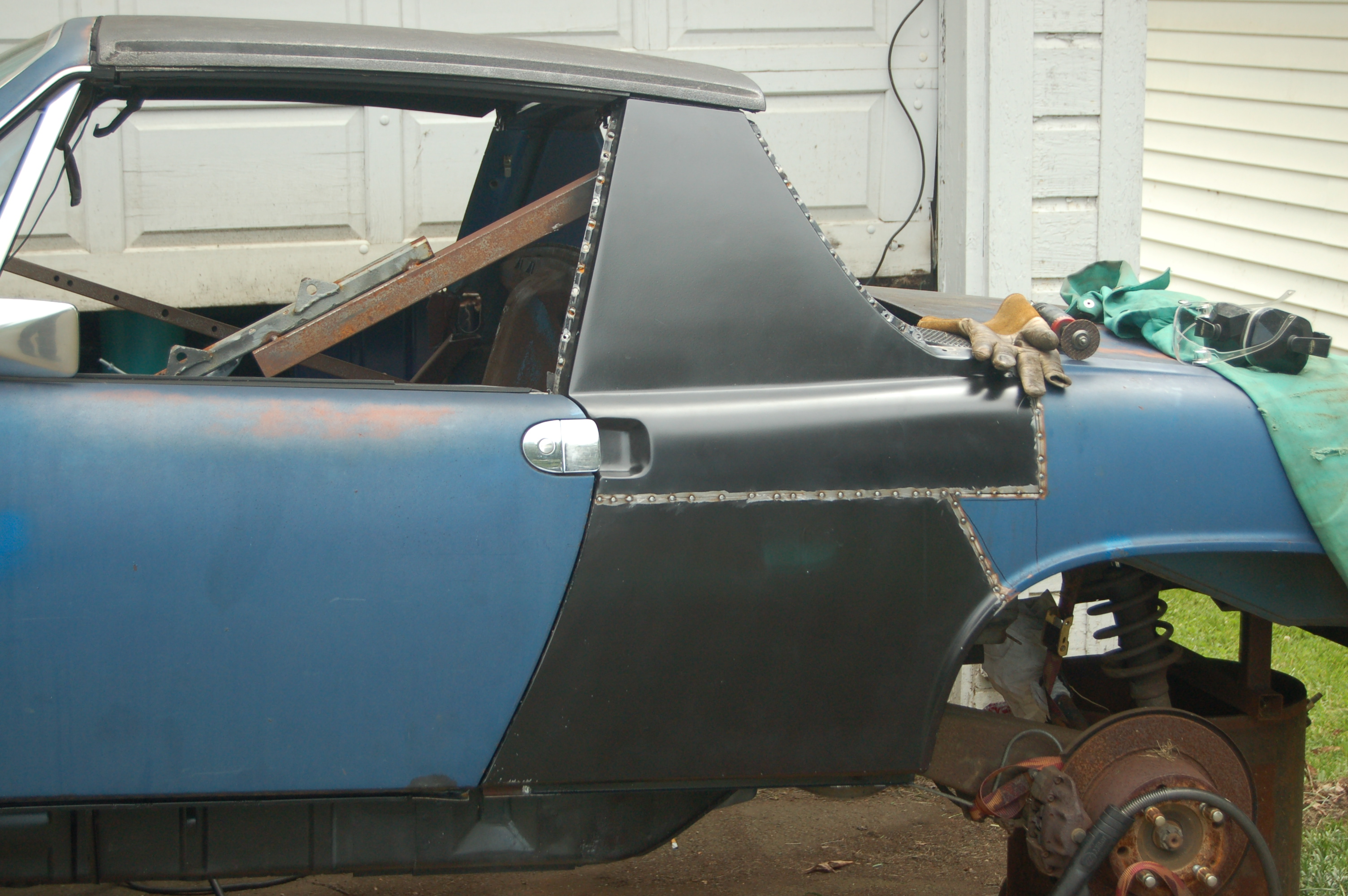

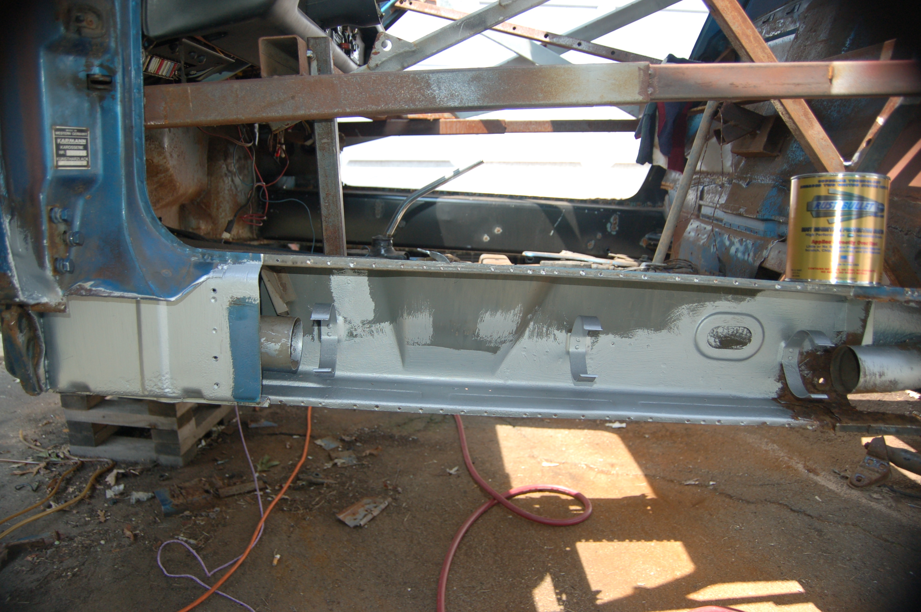

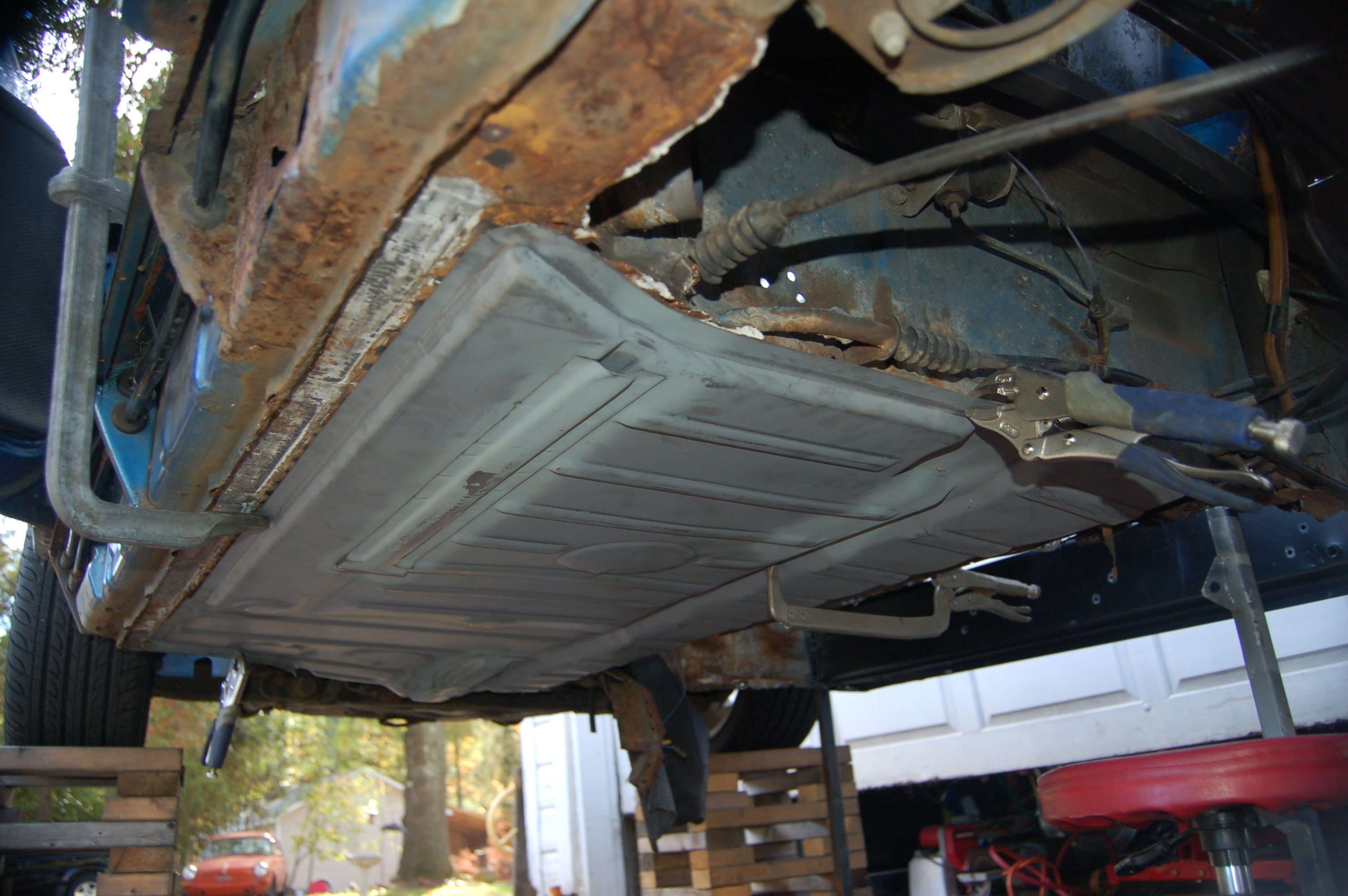

metalmorphosis   Here we go back to the lost but now found out of o...   Aug 23 2012, 08:50 PM
metalmorphosis   Inner wheelhouse   Aug 23 2012, 08:55 PM

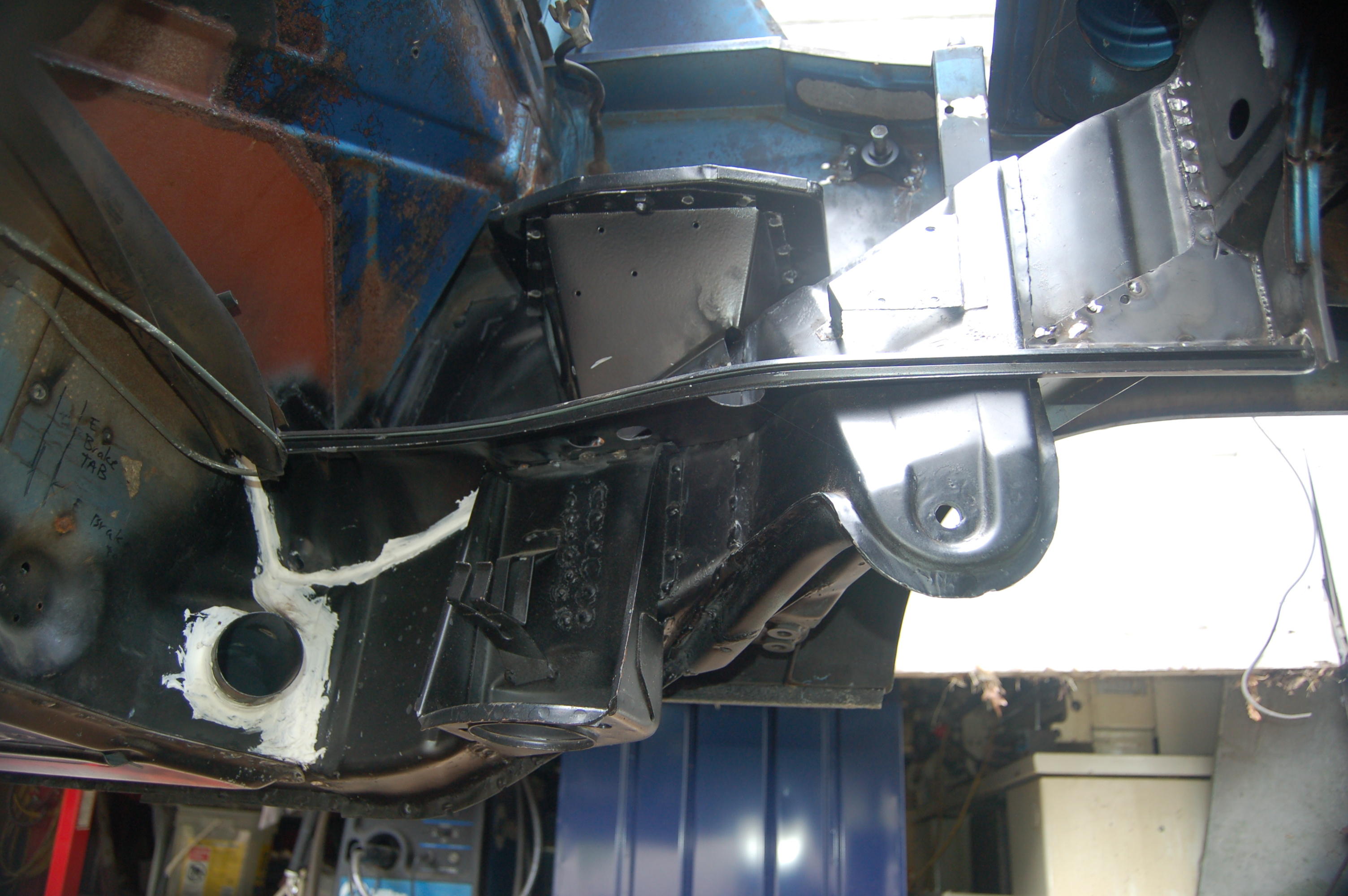

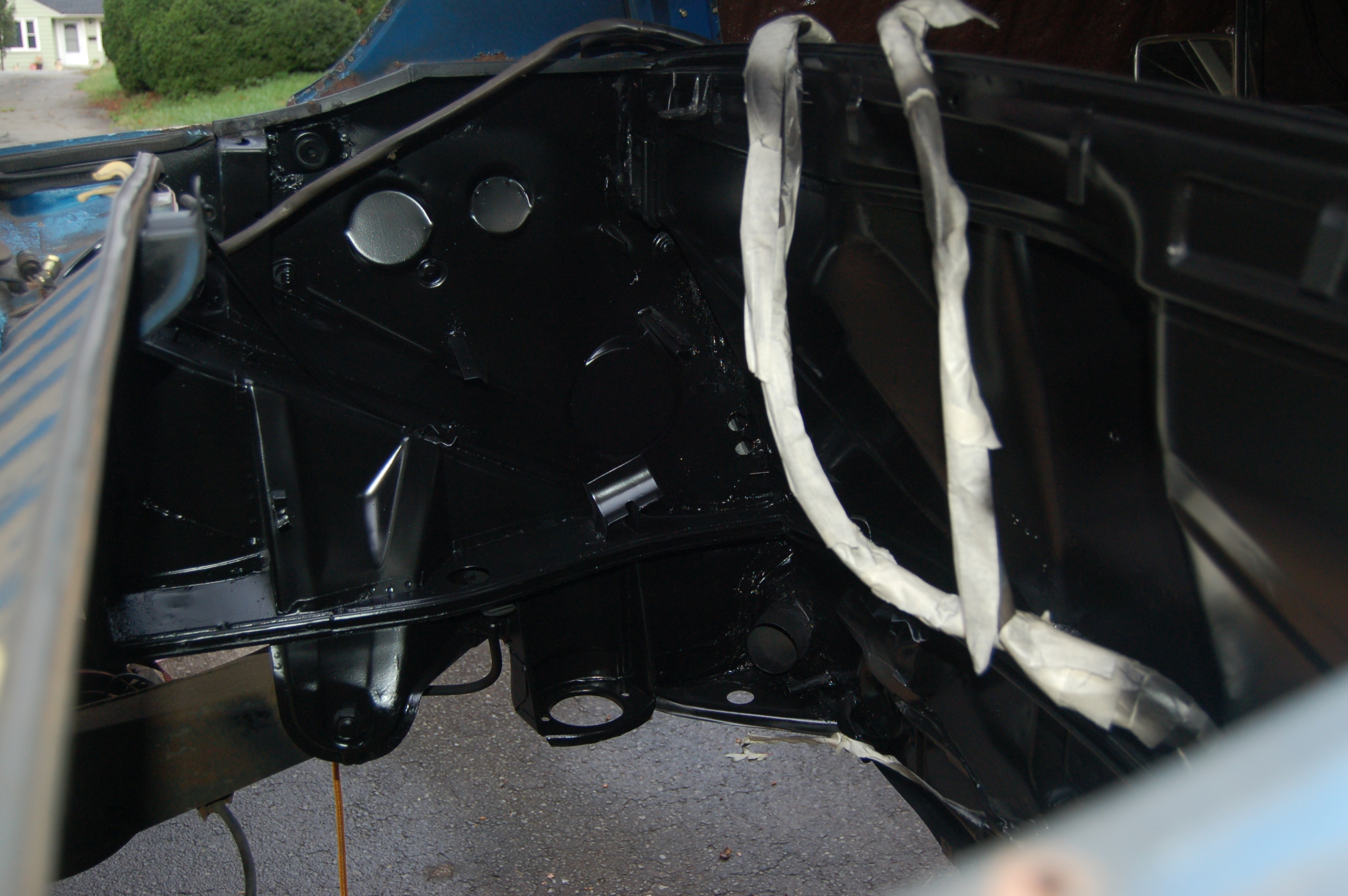

metalmorphosis   All traces of the k-rusty long gone and the new pc...   Aug 23 2012, 09:01 PM
dlee6204   Holy Smokes! :woohoo:   Aug 23 2012, 09:04 PM

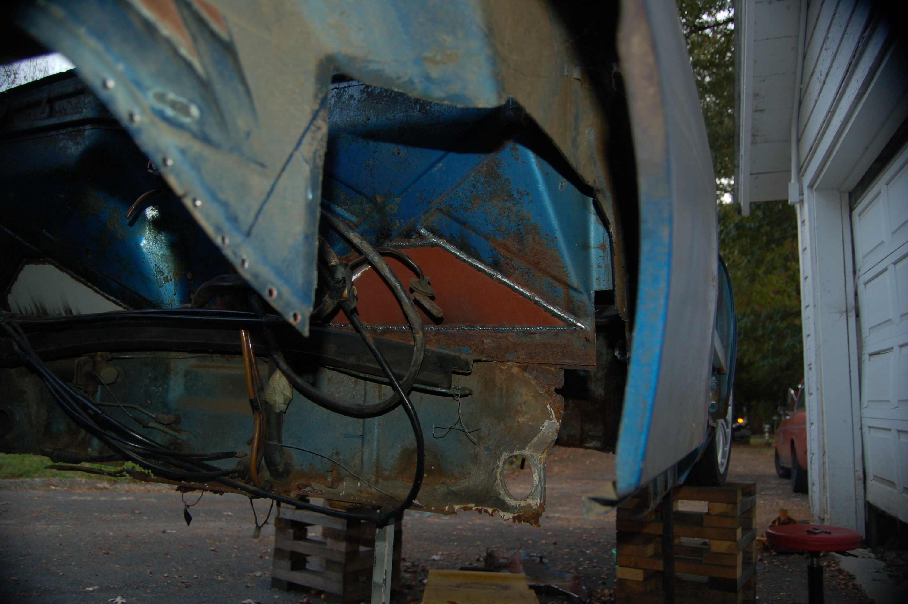

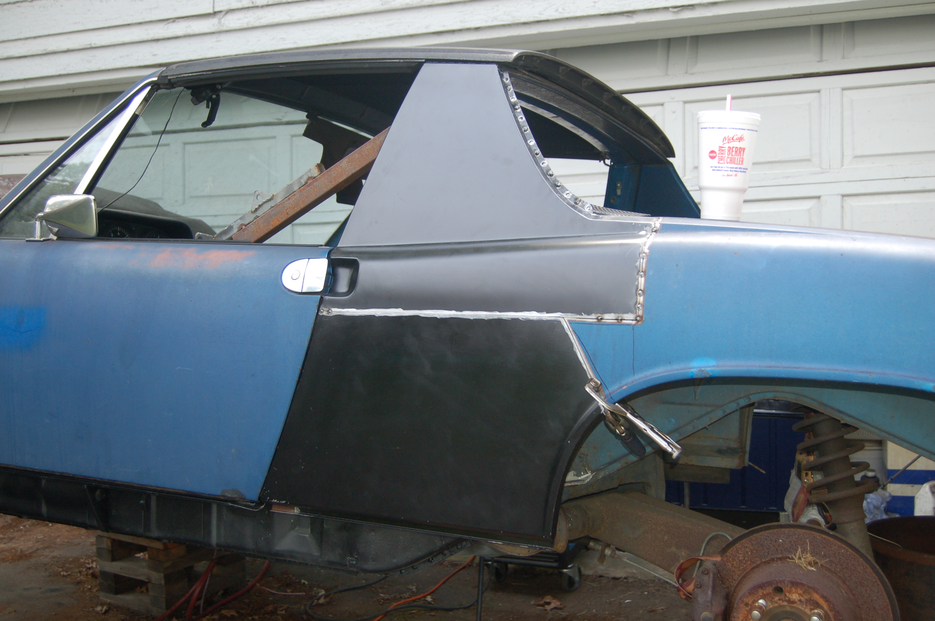

metalmorphosis   Inner long half being installed and presto change-...   Aug 23 2012, 09:08 PM
metalmorphosis   Heres a little more of the engine compartment area...   Aug 23 2012, 09:14 PM

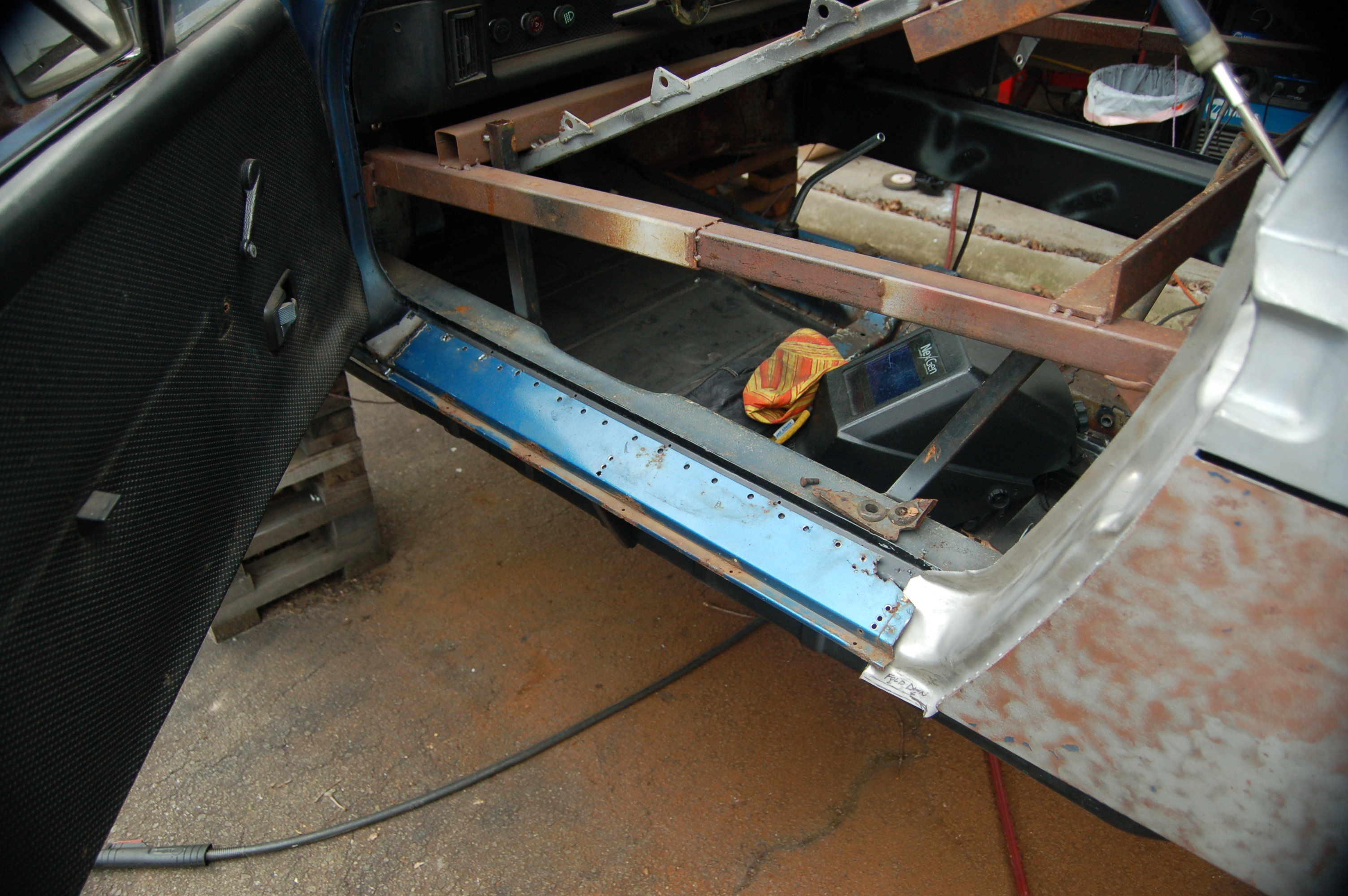

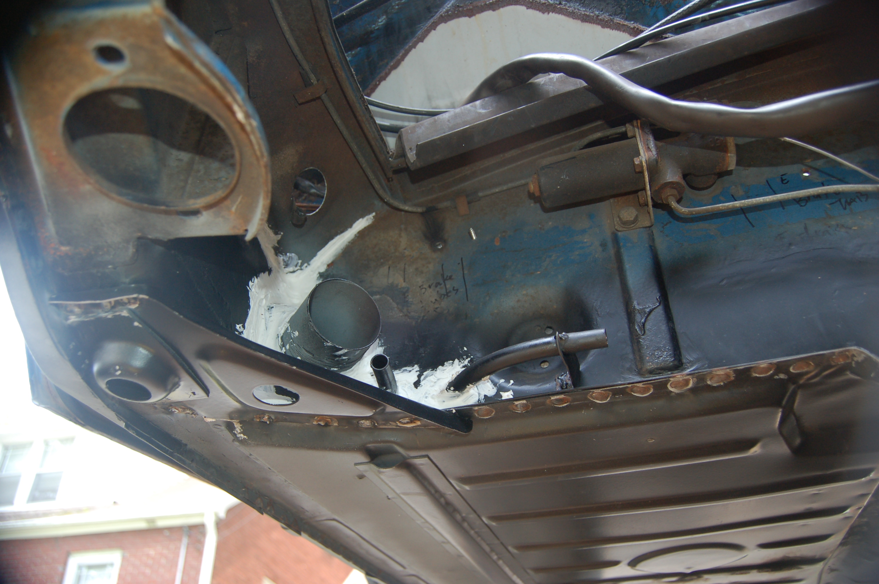

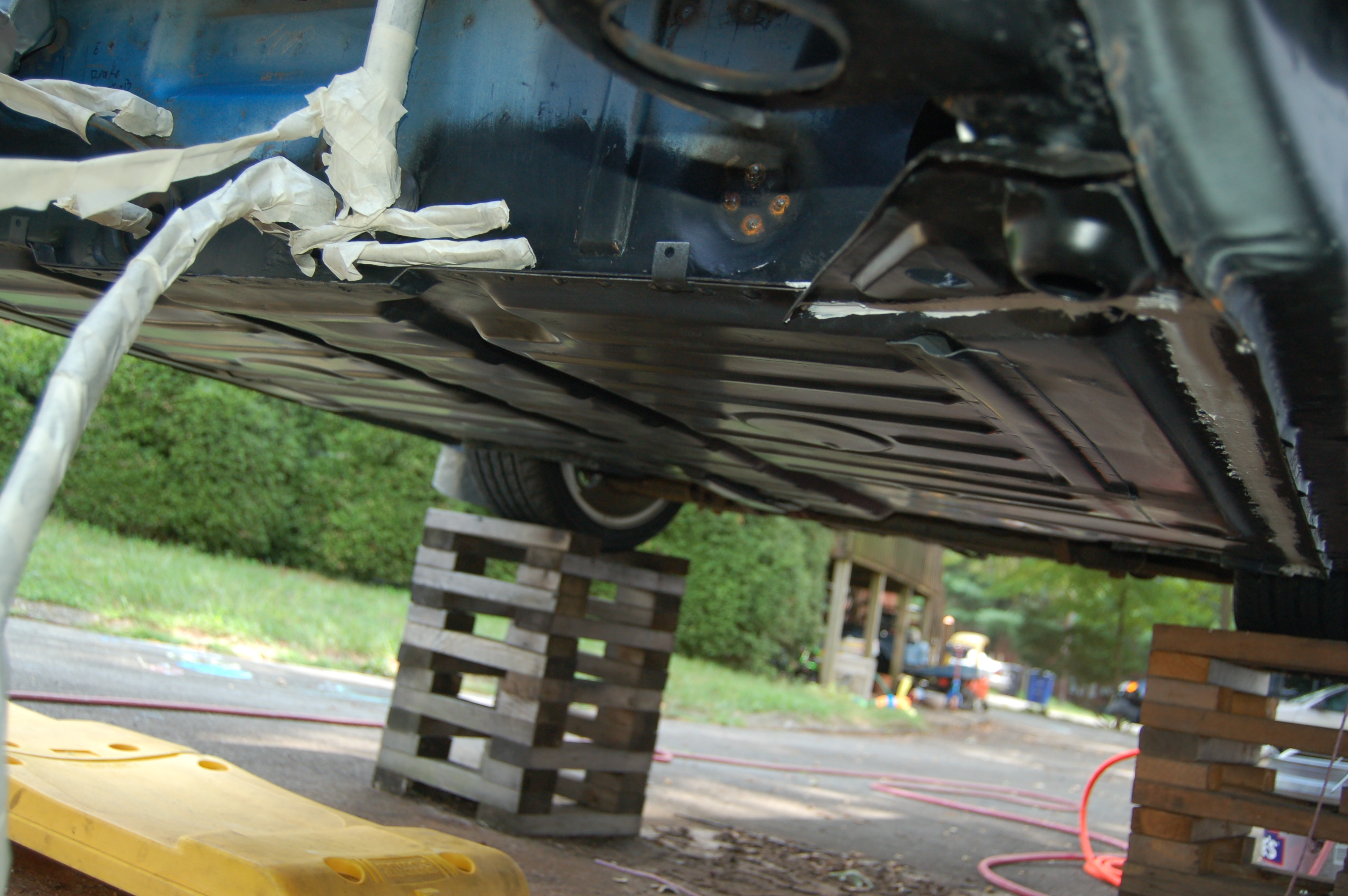

metalmorphosis   And some inner fire wall and btm of floor action.   Aug 27 2012, 09:13 PM

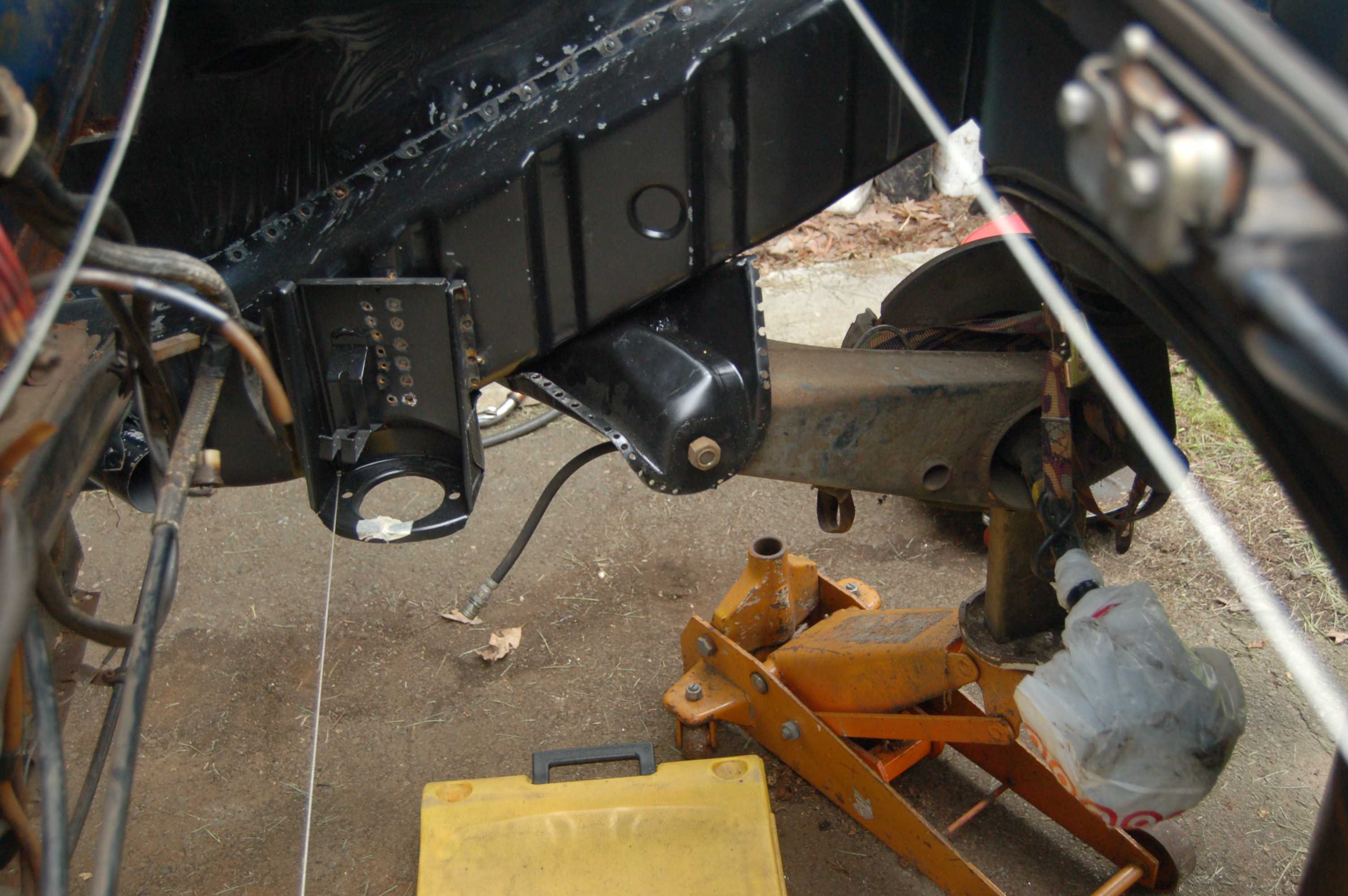

metalmorphosis   And from below the hell hole area pretty much done...   Aug 27 2012, 09:17 PM

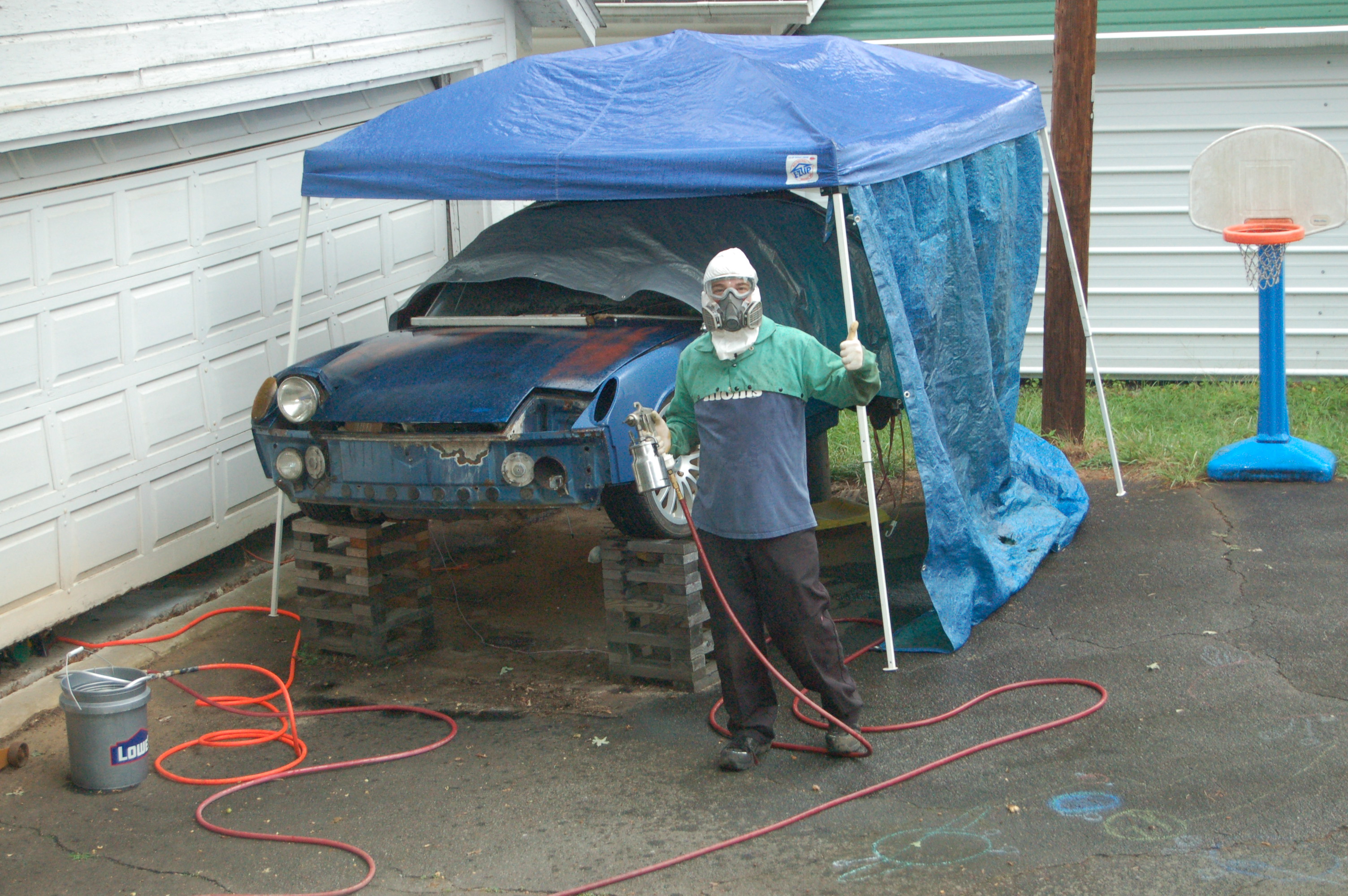

metalmorphosis   Here I am in my crazy painting get up. It started ...   Sep 7 2012, 09:33 PM

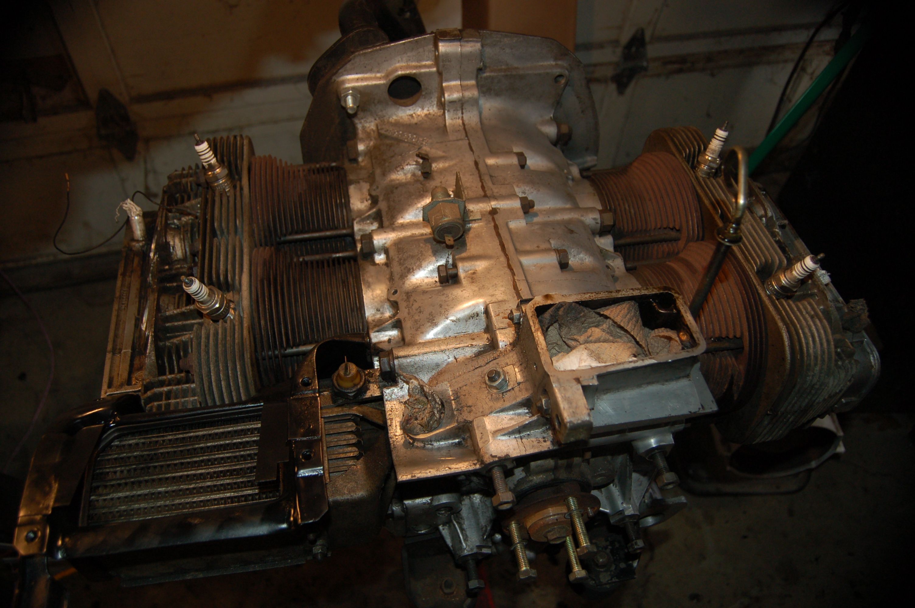

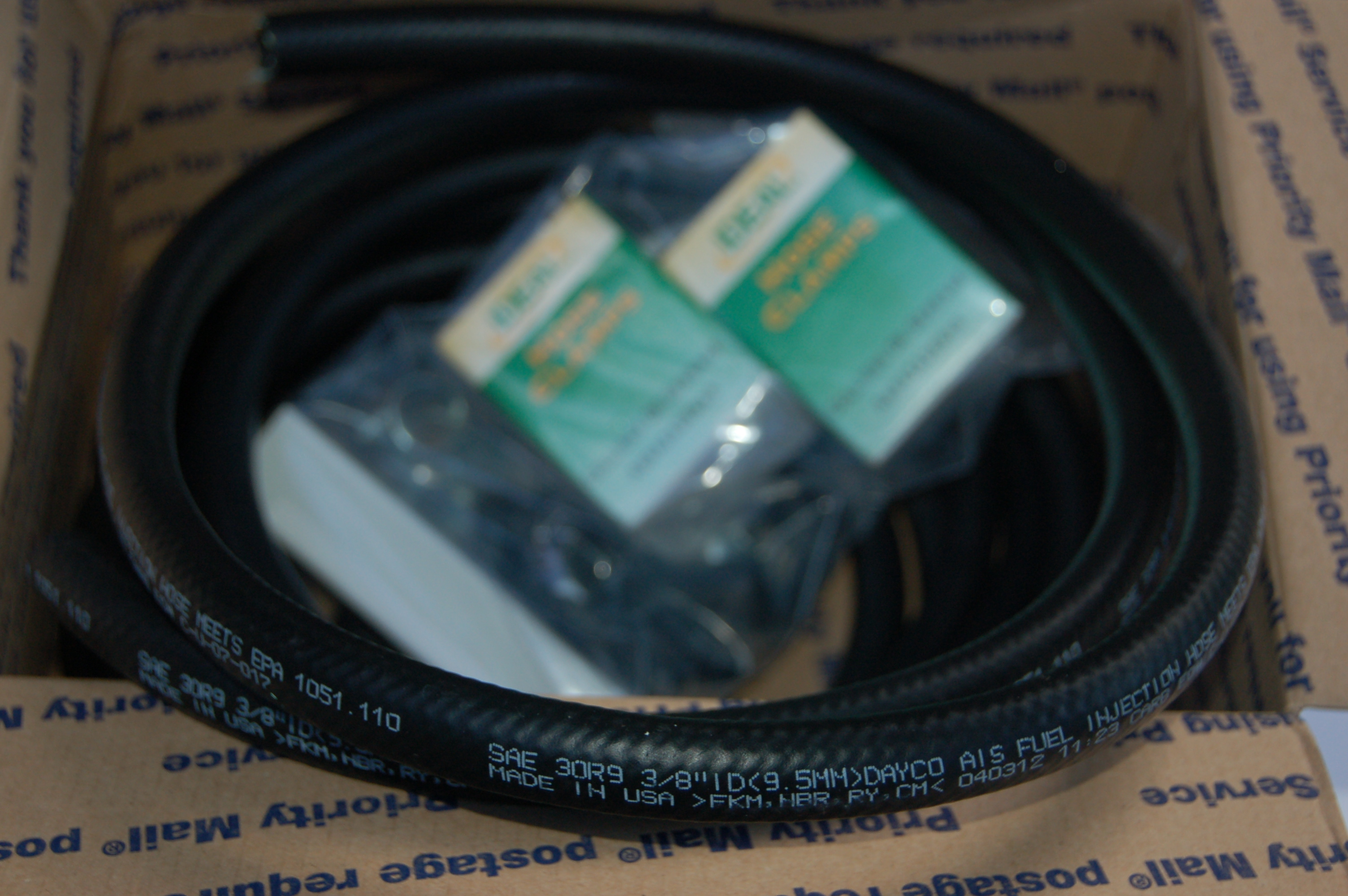

metalmorphosis   Also got my new 30r9 fuel lines from Tangerine rac...   Sep 10 2012, 06:20 PM
metalmorphosis   Last one for tonight, heres whats next when the 91...   Sep 10 2012, 06:25 PM

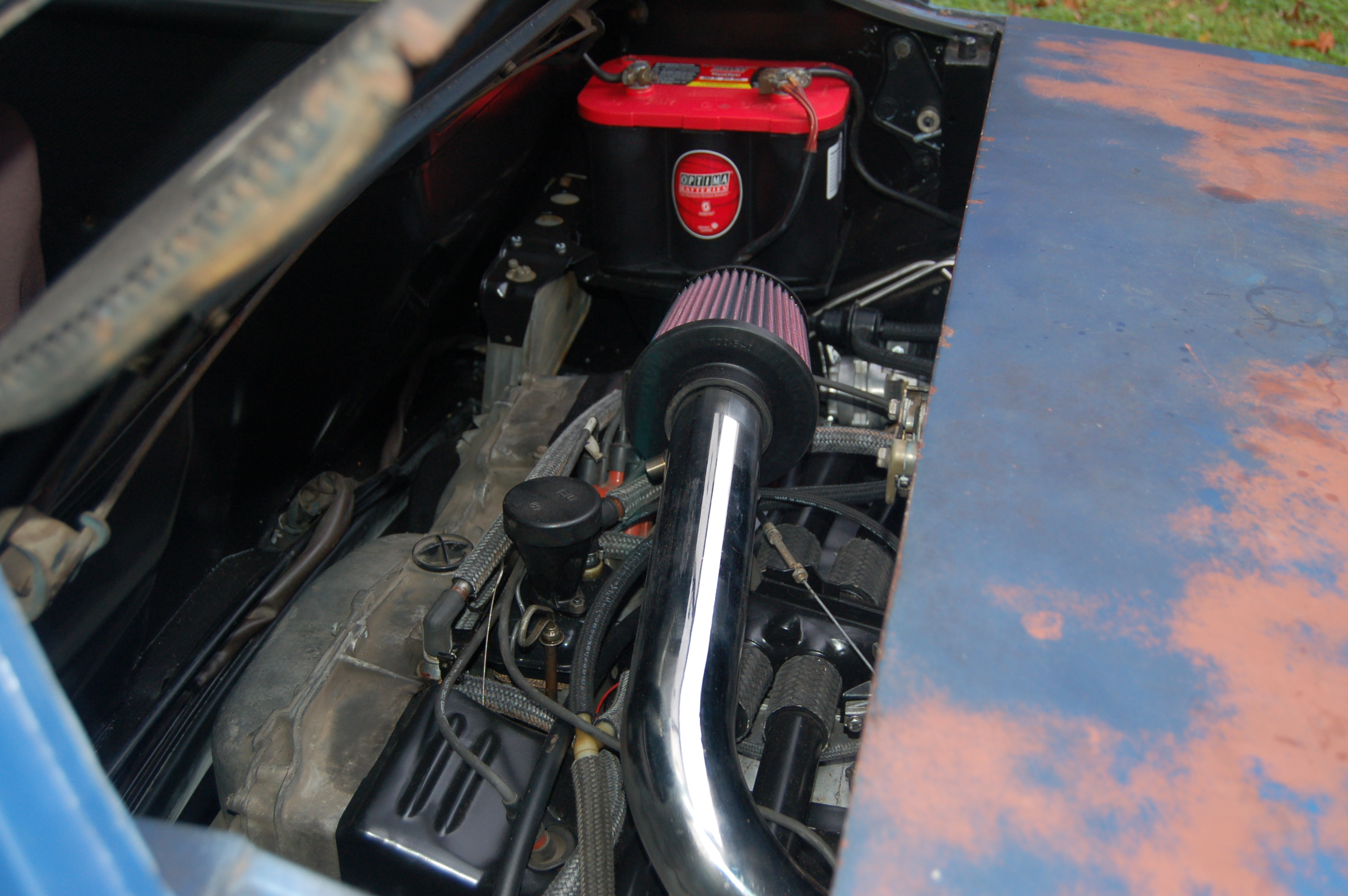

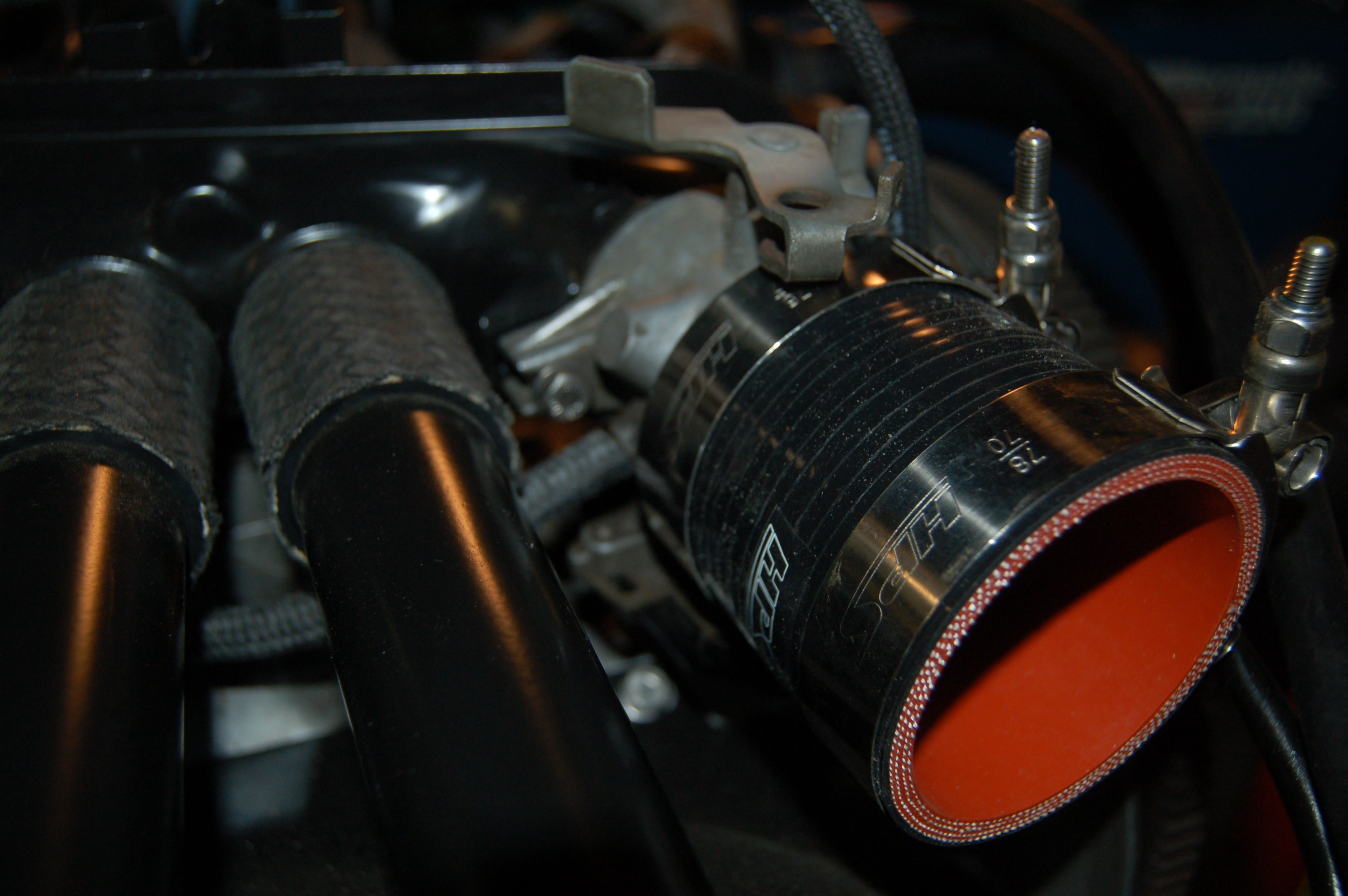

metalmorphosis   I don't want to reinstall the org air cleaner ...   Sep 28 2012, 10:11 PM
metalmorphosis   So heres what I've come up with. I still have ...   Sep 28 2012, 10:22 PM
metalmorphosis   last one for tonight   Sep 28 2012, 10:28 PM

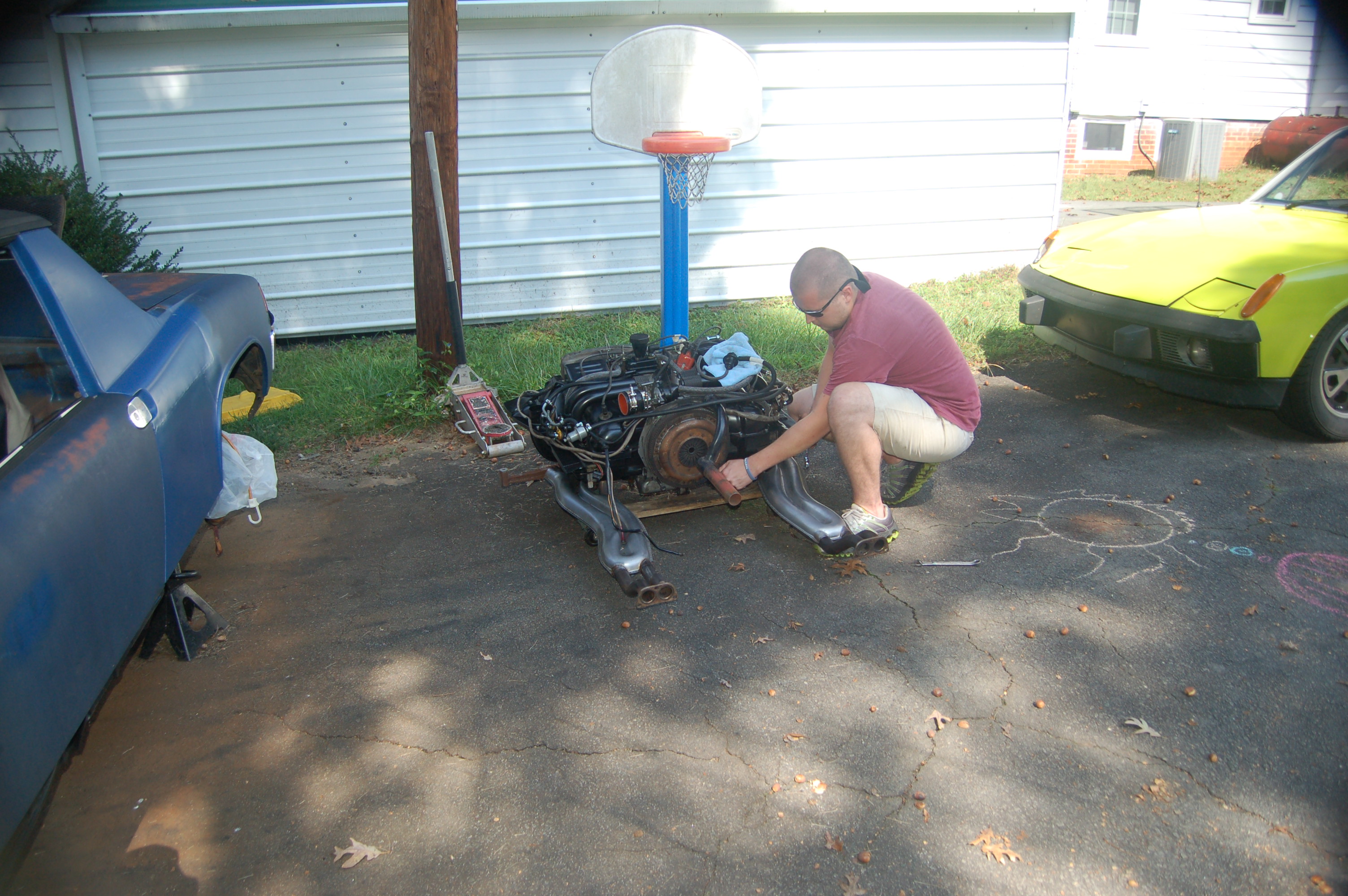

metalmorphosis   So today was the day for the motor to go back in m...   Oct 6 2012, 10:16 PM
metalmorphosis   Closer. And finally its in the hole!!...   Oct 6 2012, 10:20 PM
