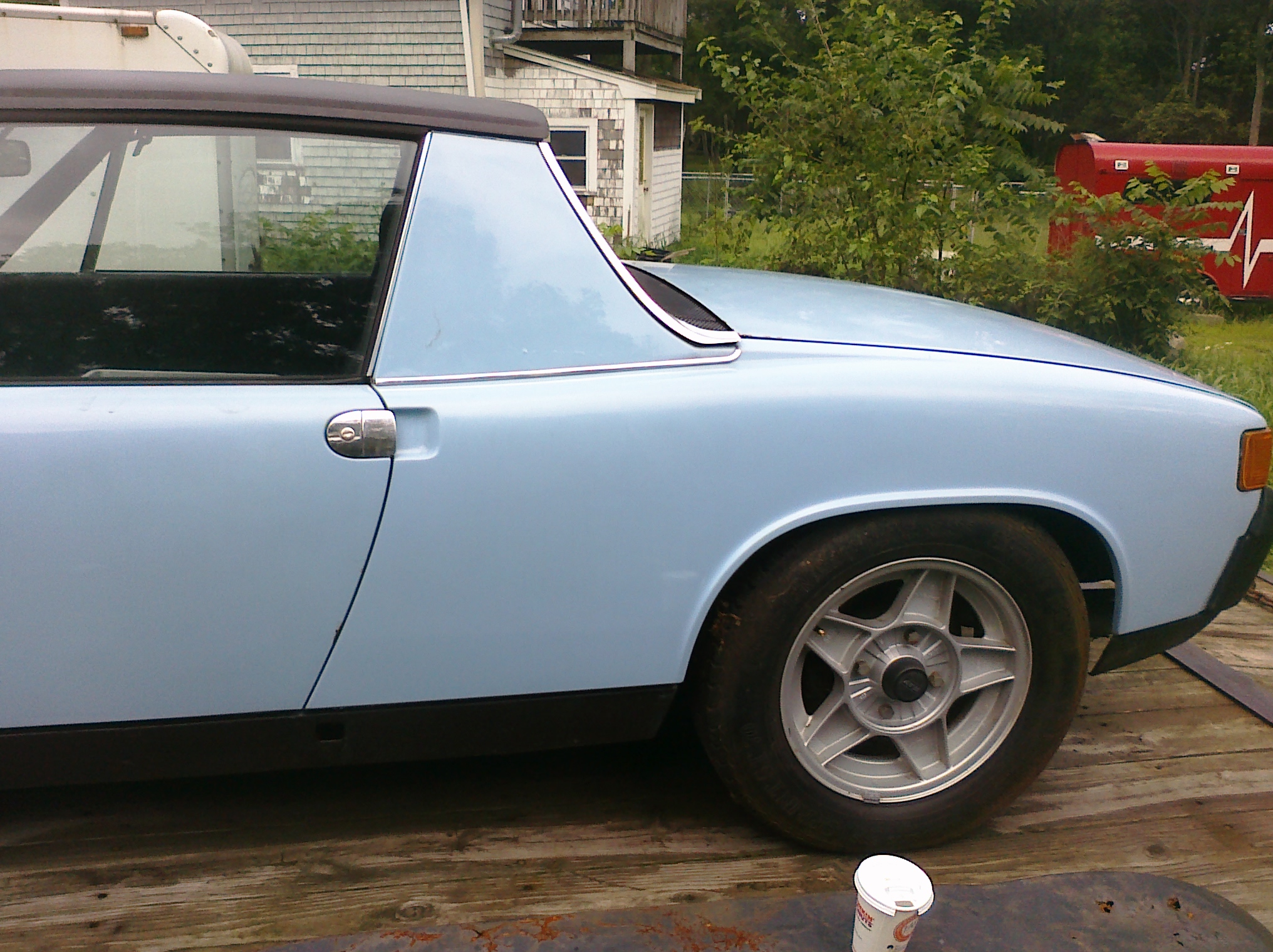

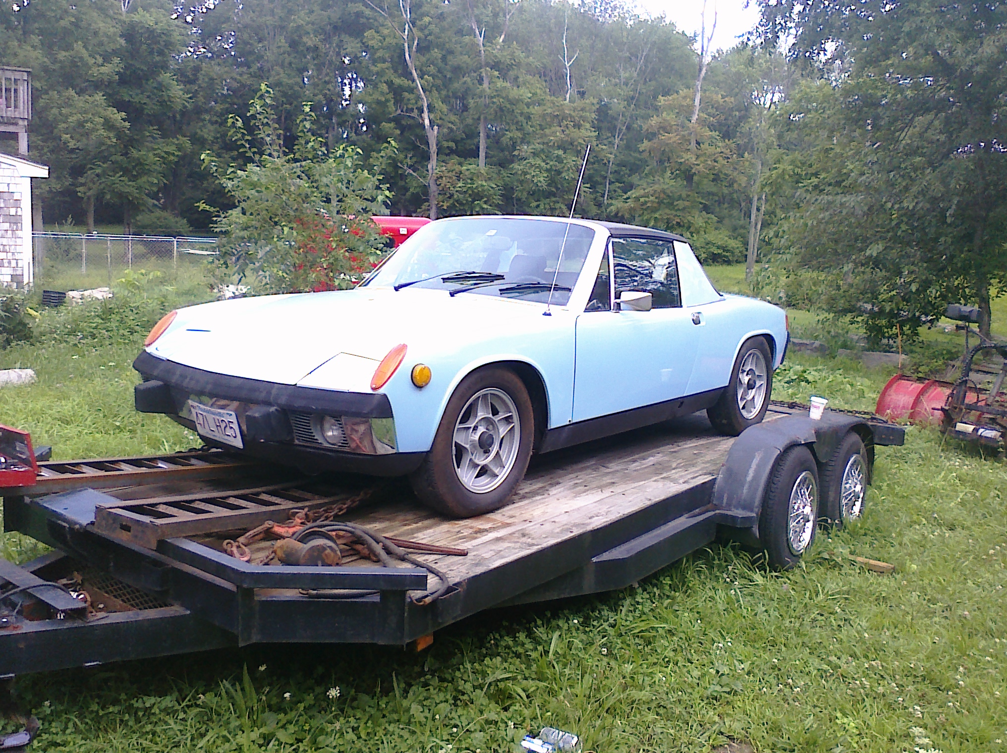

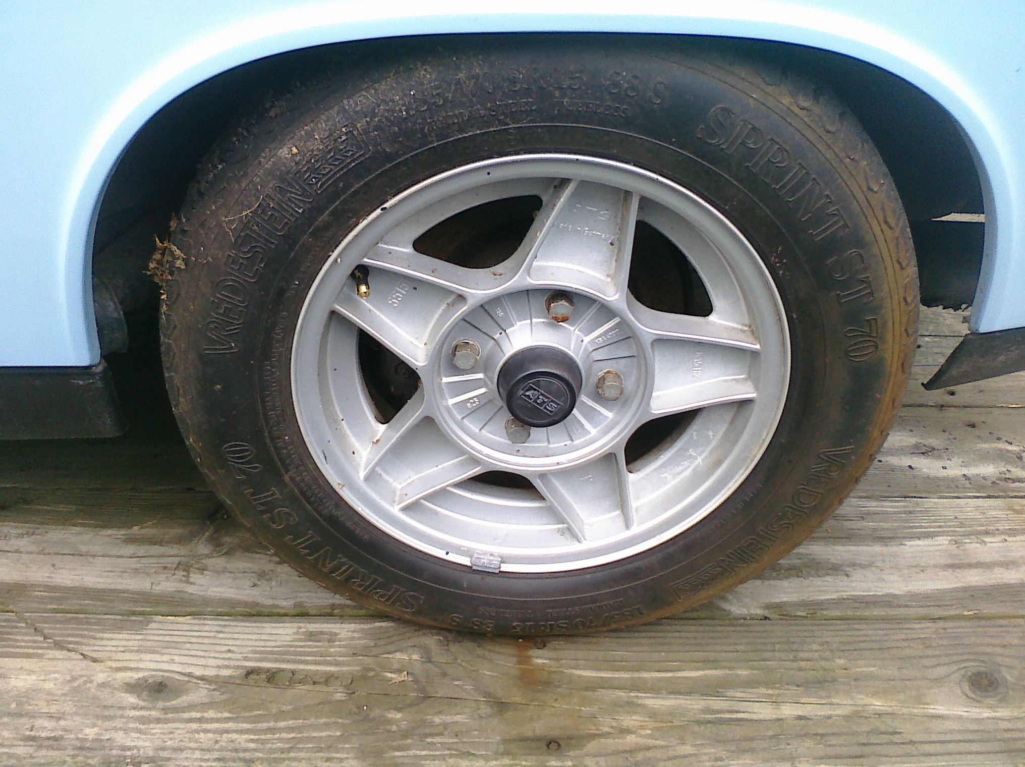

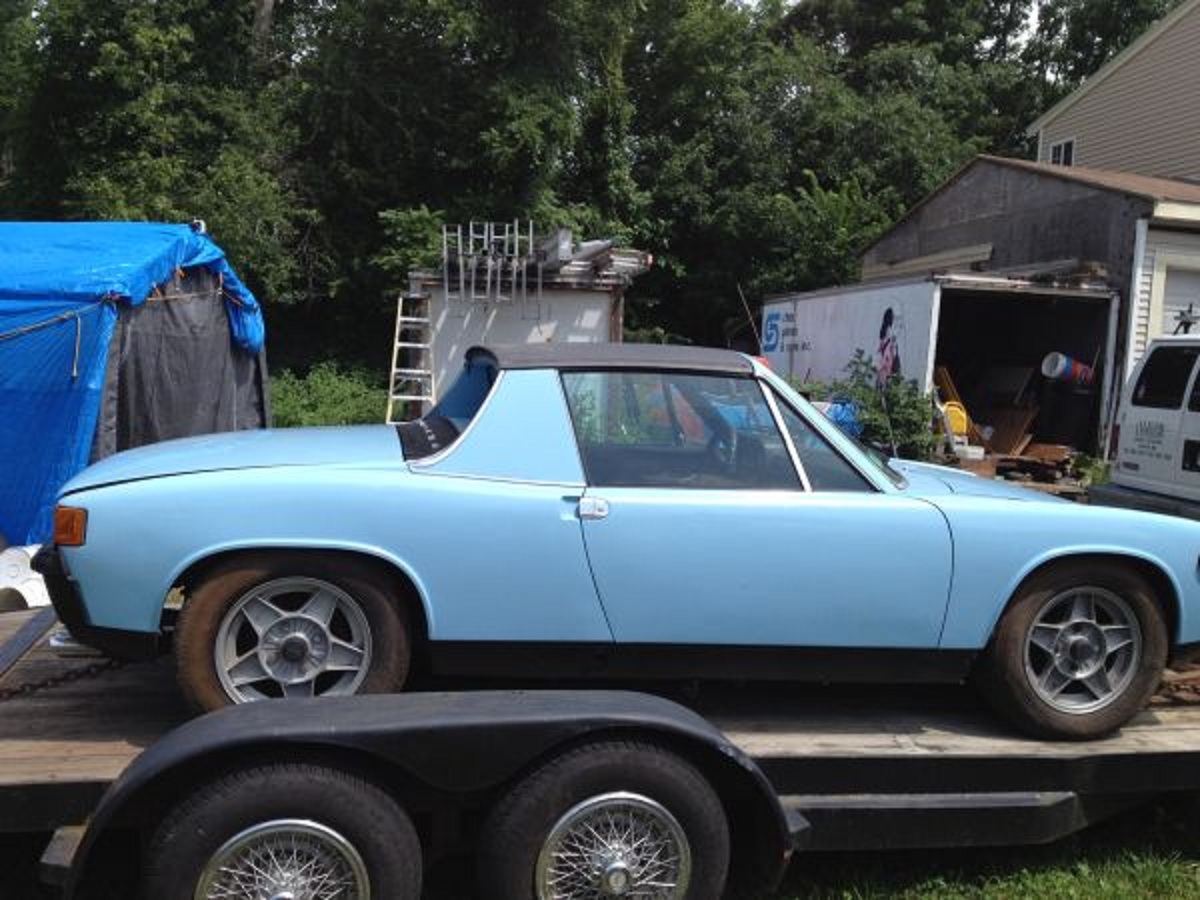

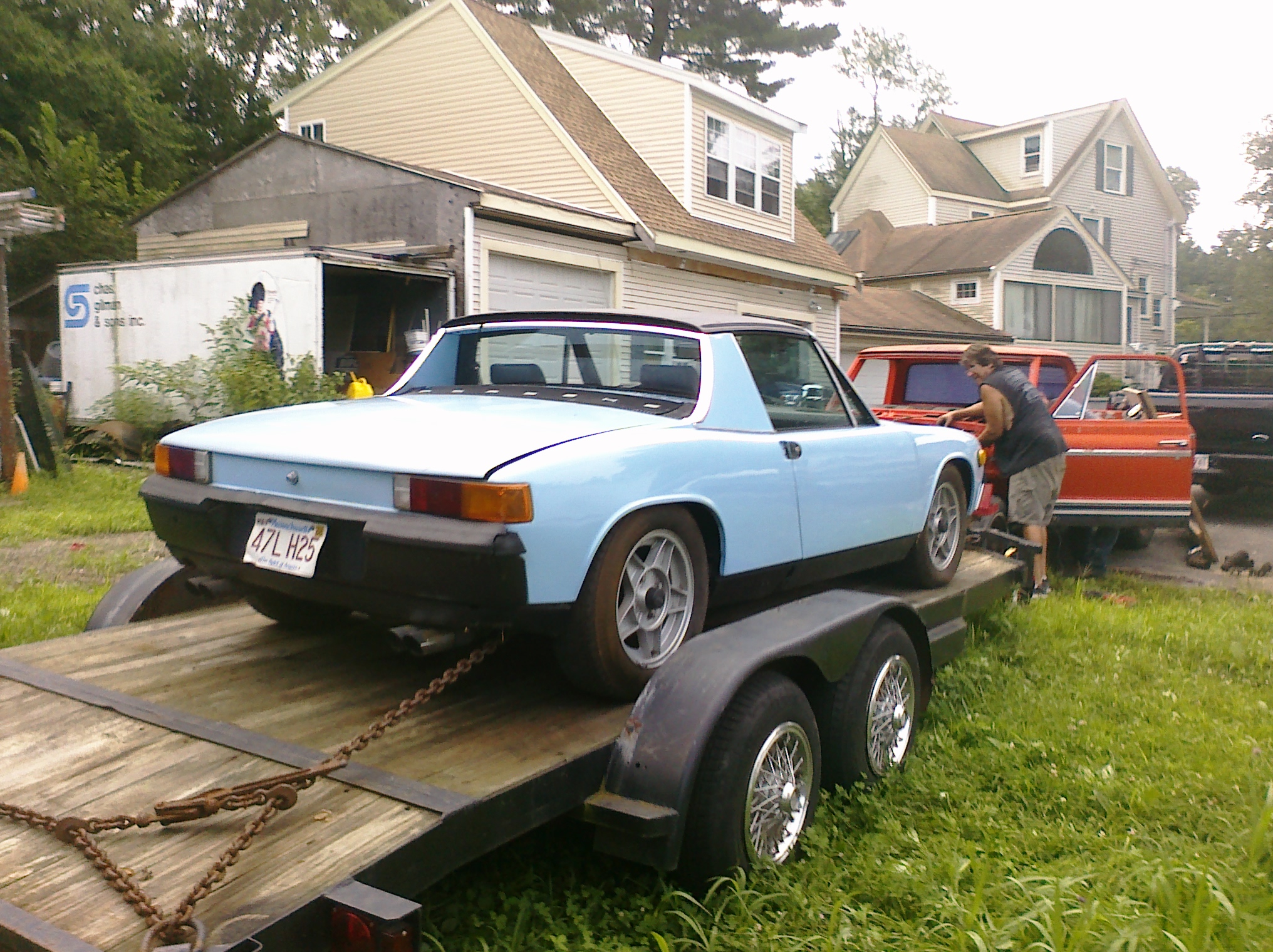

I think I am an addict, I have a 914 hoarding problem.
I just went to look at a 1973 1.7 this weekend. It is real good looking at 10 feet but it turns out that it is a typical east coast car. It has had the longs repaired once already and it was repainted. Once I started digging into it, I found the hell hole damage was not repaired, and the wall between the passanger compartment & engine bay is rotted out due to the old soundproofing material and it would need a rear floor.
I showed the seller all the damage, and he stated "well, this fucher is going to the scrap yard, I want my car trailer back." Really? (IMG:style_emoticons/default/idea.gif) Asked him if he would part with the rims, and he threw me a price for the whole car that I couldn't pass up. I am going to evaluate it when I get it home, but have a feeling that it may be too far gone to repair.
I bought it for the rims as I really like the look of them. I searched the site but haven't found much information on them. Were these a dealer option? Anyone have any input on them?

they've been mentioned for sure, they look like a copy of Campagnolo Alfa Romeo wheels. I think they're nice looking, but nothing beats 4 and 5 lug Fuchs (IMHO).

AA sold them many years ago. Might have VW Beetle spacing.

Car has a ton of nice parts. Nice score.

These are bug wheels. I took a set from my super beetle and put them on my 72 914. I think they look good on it. ATS was very popular in Norway in the 80s, especially on bugs. You could get the 5,5" with E25 or E34.

They were also made for 914s as well as bugs, I believe. They were very popular in Europe; check the "914 Caught by Camera" book and you'll see quite a few cars with them.
I like the look, myself! But you don't see a whole lot of them in the 'States from what I have seen.
It looks like the tires on there right now are 185s, and that the sidewall is pretty close to the fender. If so, you may not be able to fit the now-standard 205s on that car.

Always liked them, see how the shape of the spokes is similar to the shape of sail panel of a 914 ?

THis is probably a stupid question, but is there a big difference between bug & 914 rims? I thought they were interchangable aside from being wider.
I really like the look of these rims. My 75 1.8 came with steel wheels, and I also have complete sets of Riviera and Fuch wheels. I was planning on using the Fuch, but I really like the look of these.
The ATS wheels are 5.5"x15" and they do currently have 185s on them (which are junk). I will have to look at the fender clearances before buying tires. I used to run 205s on my 74 2.0 which had Fuchs. They used to rub the front fenders a little; as I recall my buddy rolled the lip of hte front fenders when he painted it.

The key difference in the wheels is the offset.
Put a straight edge on the rim and measure to the mounting face on the back of the wheel.
Bug wheels have a larger offset than 914 wheels so you are limited in how wide you can go with the rubber or it hits
