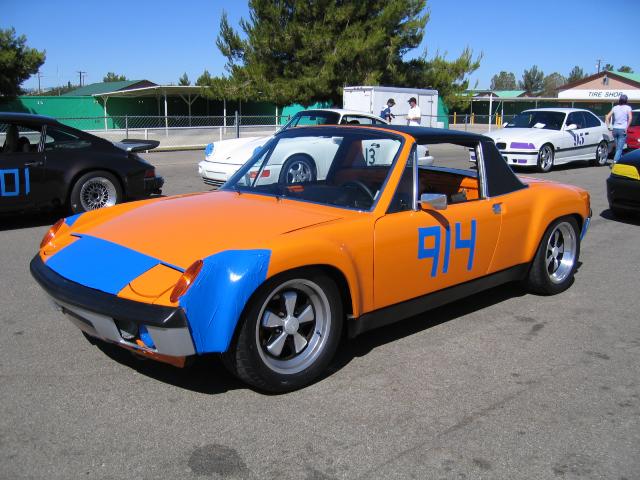

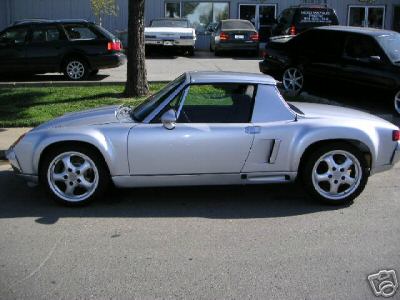

I don't have many good side pictures of my car, but here is one...
Whaddya think?
-Steve

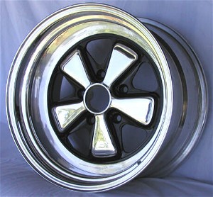

17" Fuchs:

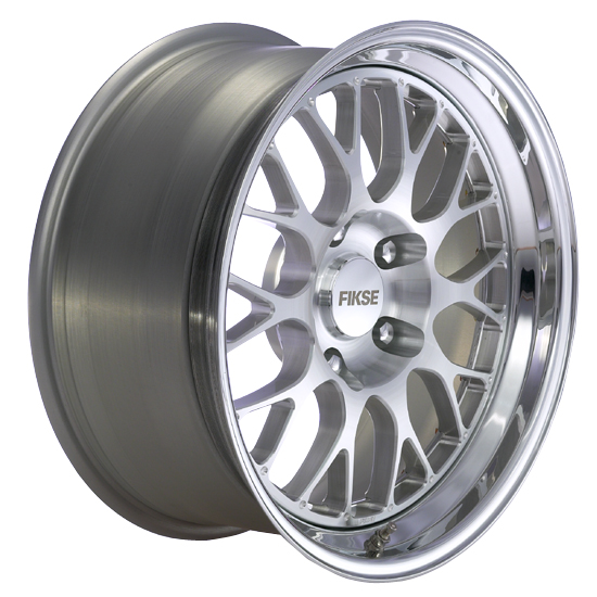

Fikse:

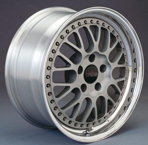

Kinesis:

I have those Fikse rims....nice to be able to repair 'em by replacing a rim half (had to do this once)....the rims are a PITA to keep clean with all the little spokes...

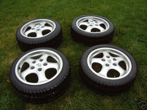

siverson
post Oct 24 2004, 09:53 AM
Posts: 2,464
Joined: 5-May 03
From: San Diego, CA
Member No.: 654
Hmmm... That's not a bad idea, but I thought all of the later wheels would require use of spacers. Which wheel are you talking about?
-Steve
This one?
siverson
post Oct 24 2004, 09:54 AM
Posts: 2,464
Joined: 5-May 03
From: San Diego, CA
Member No.: 654
Or this one?
siverson
post Oct 24 2004, 09:55 AM
Posts: 2,464
Joined: 5-May 03
From: San Diego, CA
Member No.: 654
Or this one?

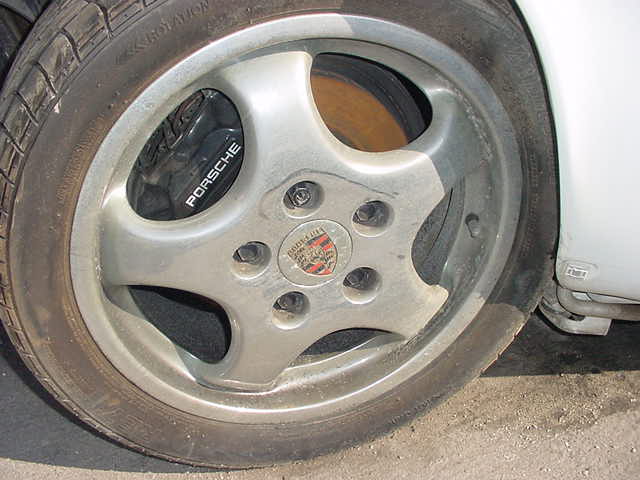

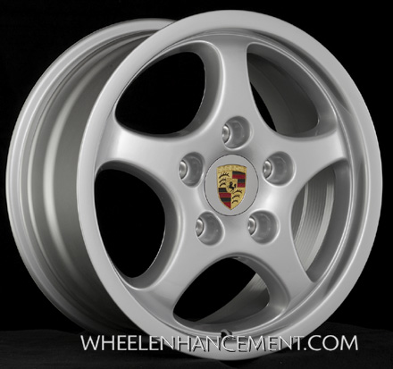

Jeroen
post Oct 24 2004, 03:04 PM
Posts: 7,887
Joined: 24-December 02
From: The Netherlands
Member No.: 3
Region Association: Europe
First pic is the Cup1 wheel in 16"
Came on the 964 and 968 cars
Second pic is the Cup1 wheel in 17"
Came on the same cars as above
Third pic is the 17" Cup2 wheel
Came on the 993
You can get the 17" cup1 and cup2 design as replica's (same manufacturer as the originals), but with offsets for earlier 911s ('till 1989) so you won't need spacers.

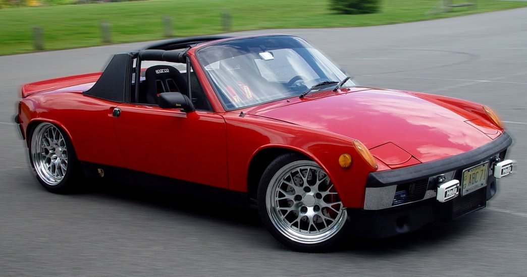

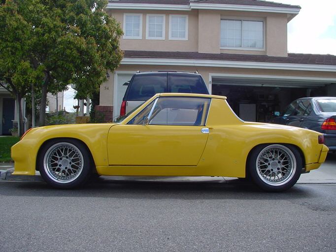

soloracer
post Oct 24 2004, 06:45 PM
Posts: 793
Joined: 7-April 03
From: Calgary
Member No.: 538
kinesis 914
soloracer
post Oct 24 2004, 06:47 PM
Posts: 793
Joined: 7-April 03
From: Calgary
Member No.: 538
Fikse 914

Mueller
post Oct 24 2004, 07:51 PM
914 Freak!
Posts: 17,155
Joined: 4-January 03
From: Antioch, CA
Member No.: 87
AKAIK, no factory Cup wheels are available with the correct offset for a 914 w/flares...the aftermarket Cup wheels are very heavy and a few have cracked (during track use)
C2 rims are the incorrect offset as well (spacers still needed)...by going with any of the 3 custom choices, no spacers are needed.
