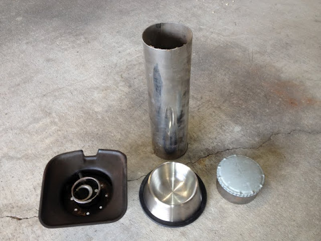

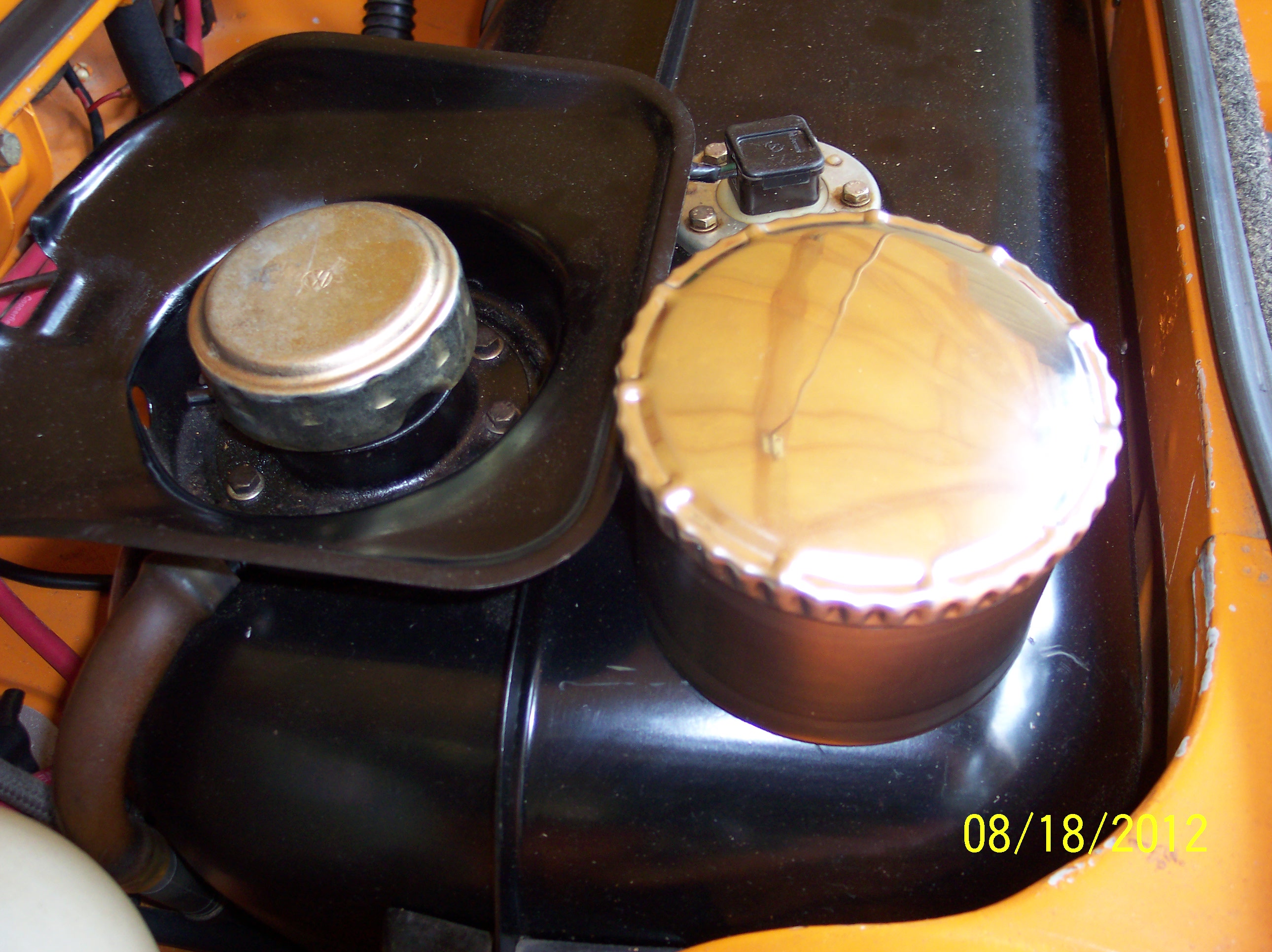

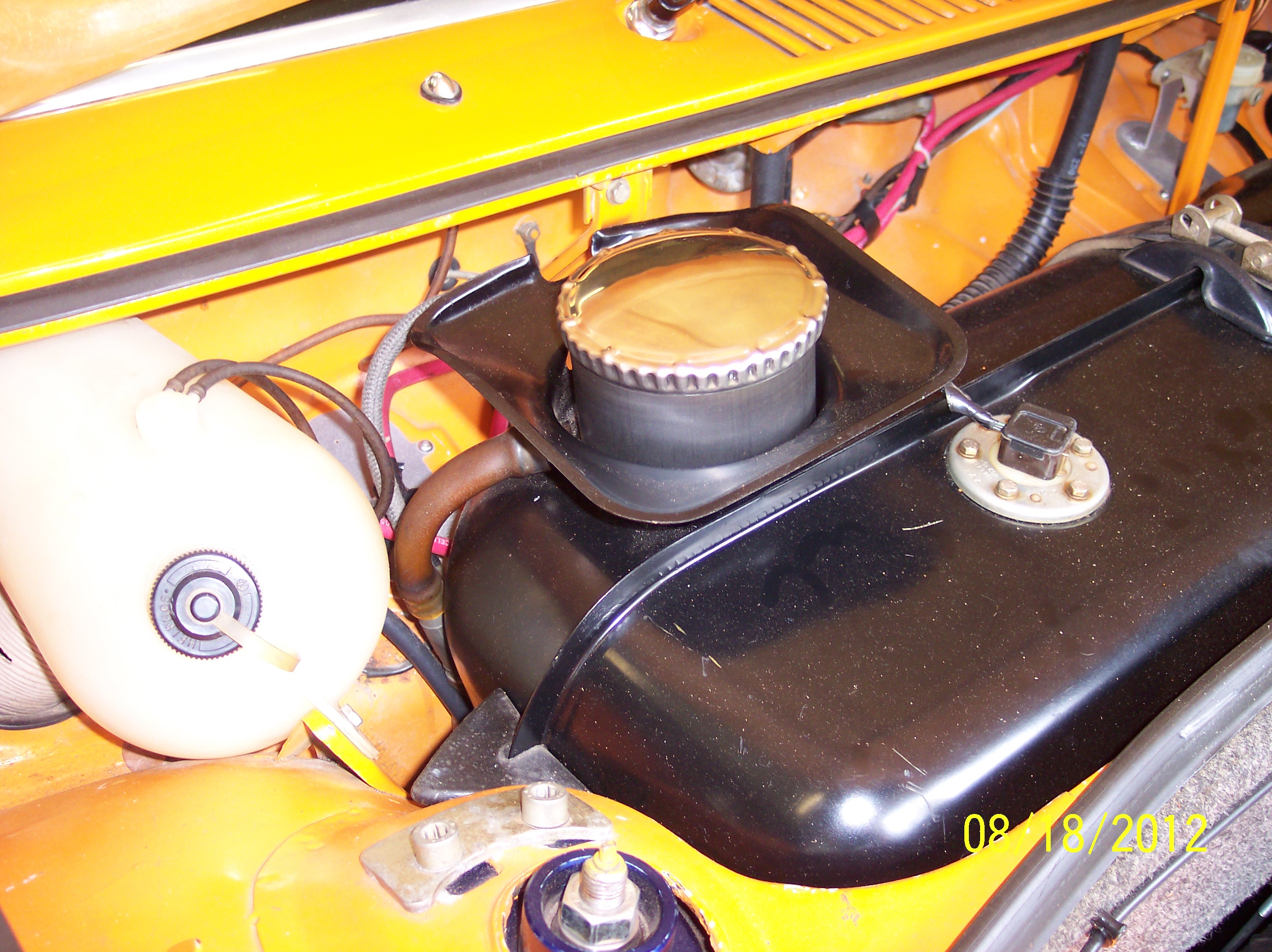

My next project for the rocket will be to convert the Fuel and oil caps over to the Blau 110mm for the fuel, and 80mm cap for the oil tank.
I just received these caps today from a guy over in Europe. I answered an old posting in the classifieds over on the bird board, and I shocked that he still had a few sets left. I got the caps and the filler necks. The Fuel cap is as received, and is actually polished Stainless Steel. The oil cap is polished Aluminum. Both are genuine Blau caps as stamped on the bottom. Made in Austria.
The caps in the pics are just laid there for size reference.
On the fuel side I am going to have the fuel cap go up through the hood, and have a locking gas gap hidden below the Blau cap when it is removed. The Blau gap will be secured with a lanyard to keep it from getting stolen. I'm going to raise mine up high enough so the cap is level with the hood line.
On the oil side I'll probably butcher up a 911 oil inlet to mount the cap to.
Both caps will have a handle made to remove them easily like the GT units. This looks to be a good fall project.

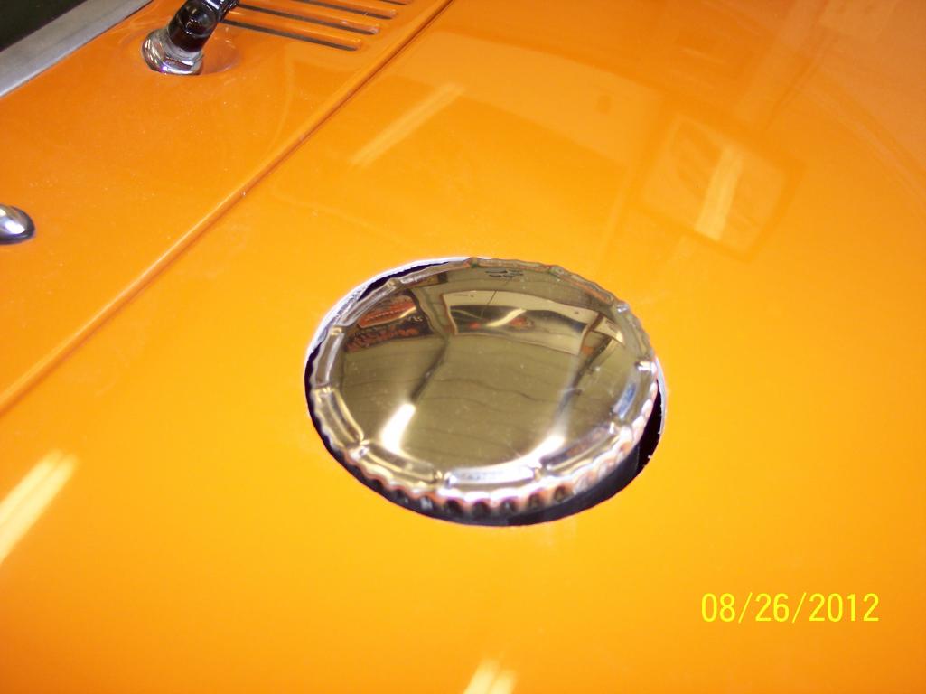

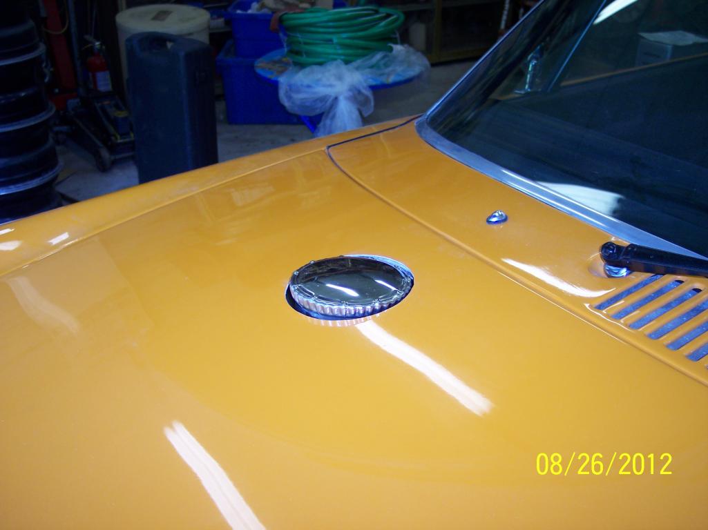

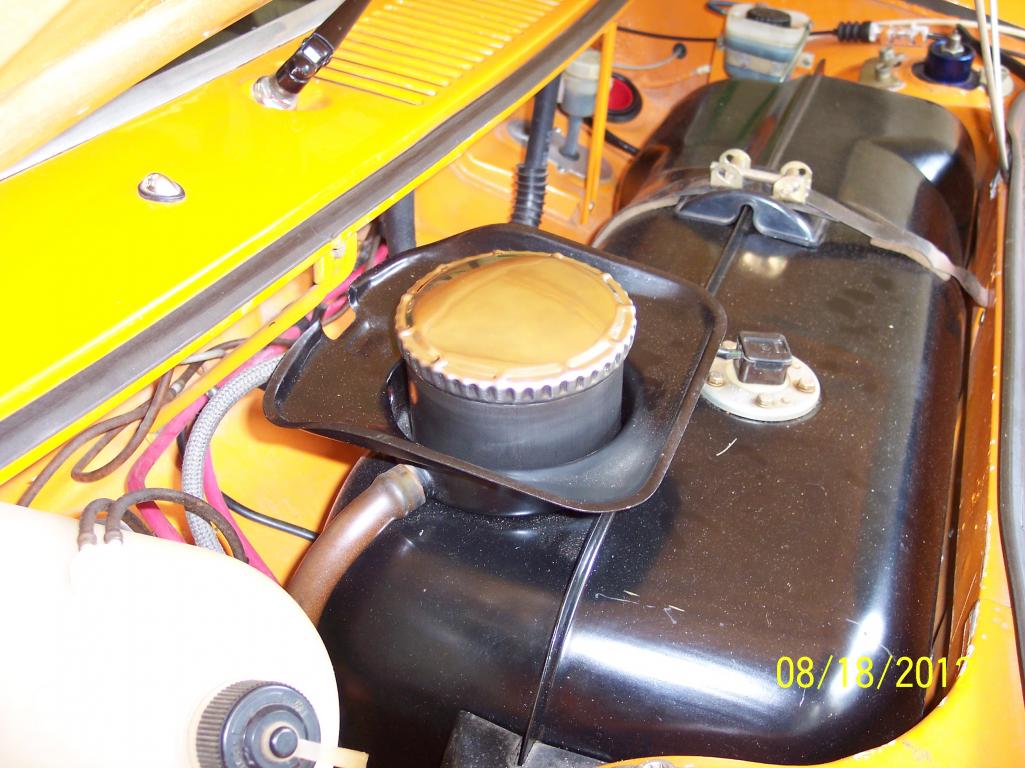

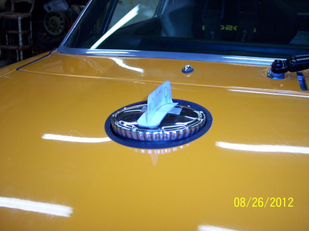

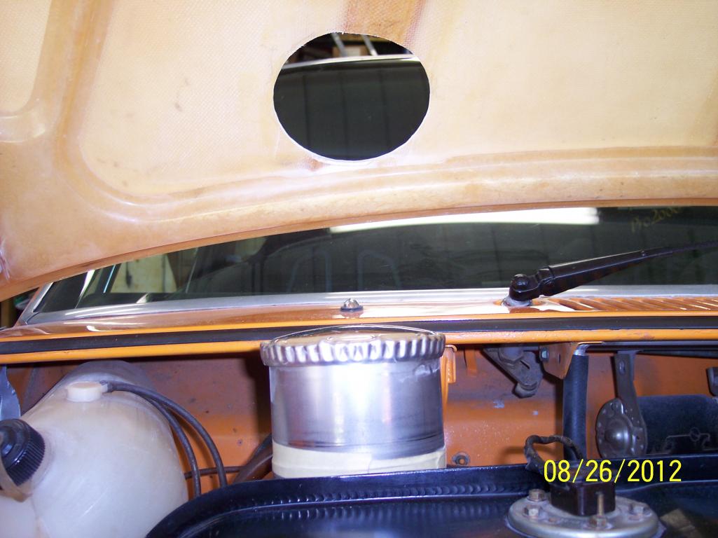

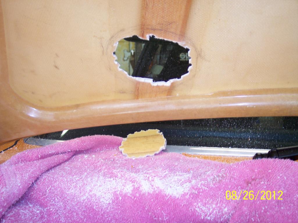

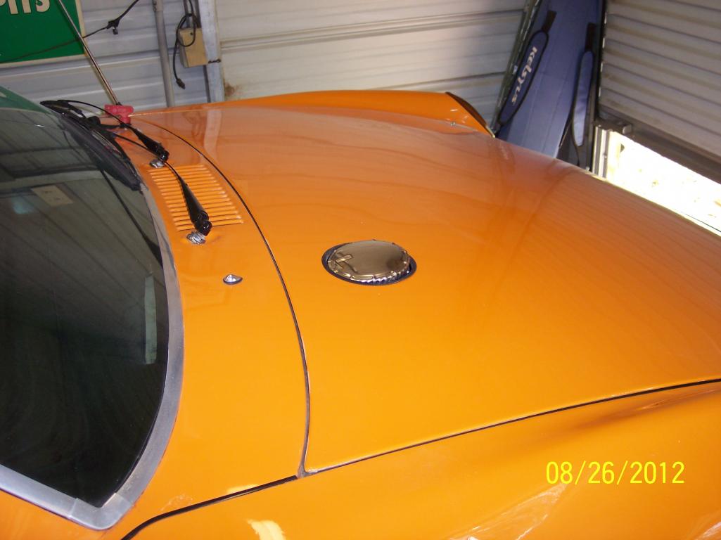

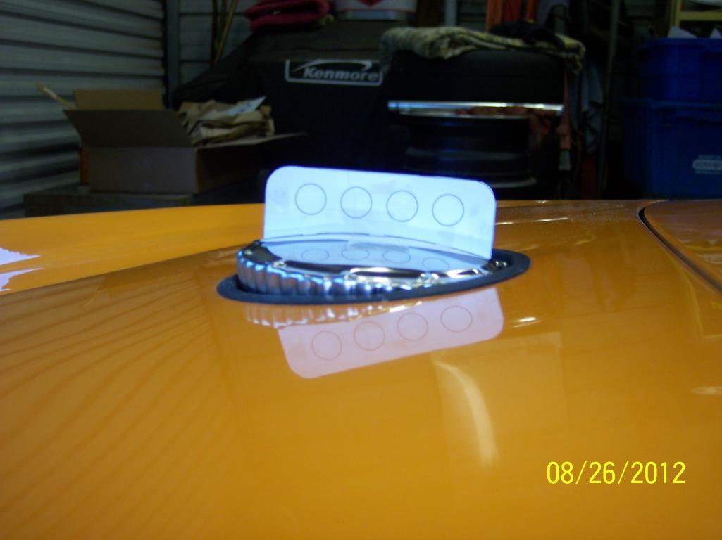

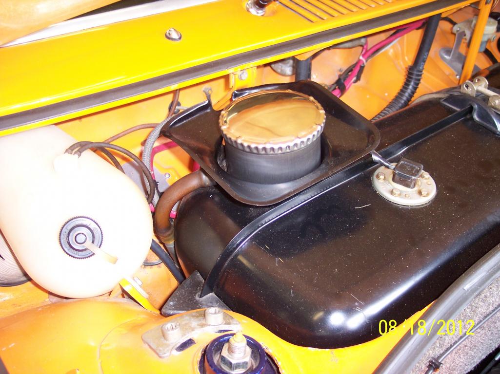

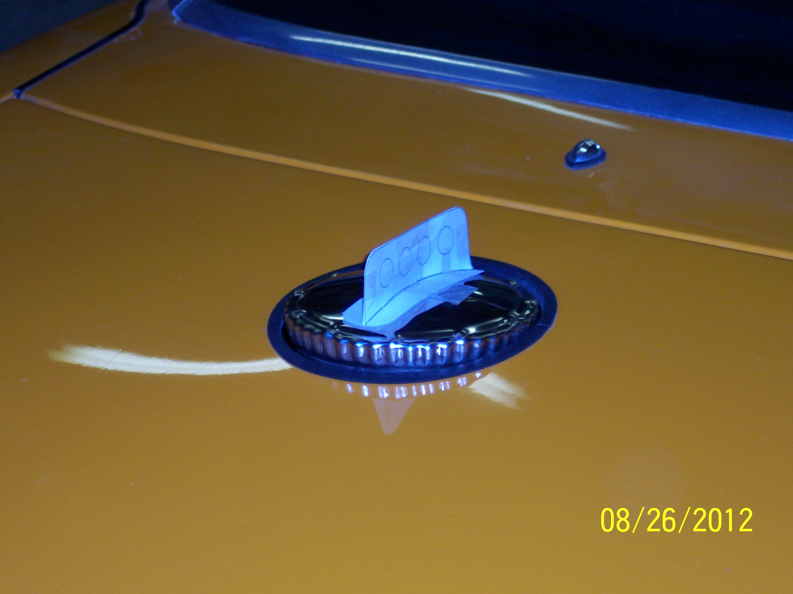

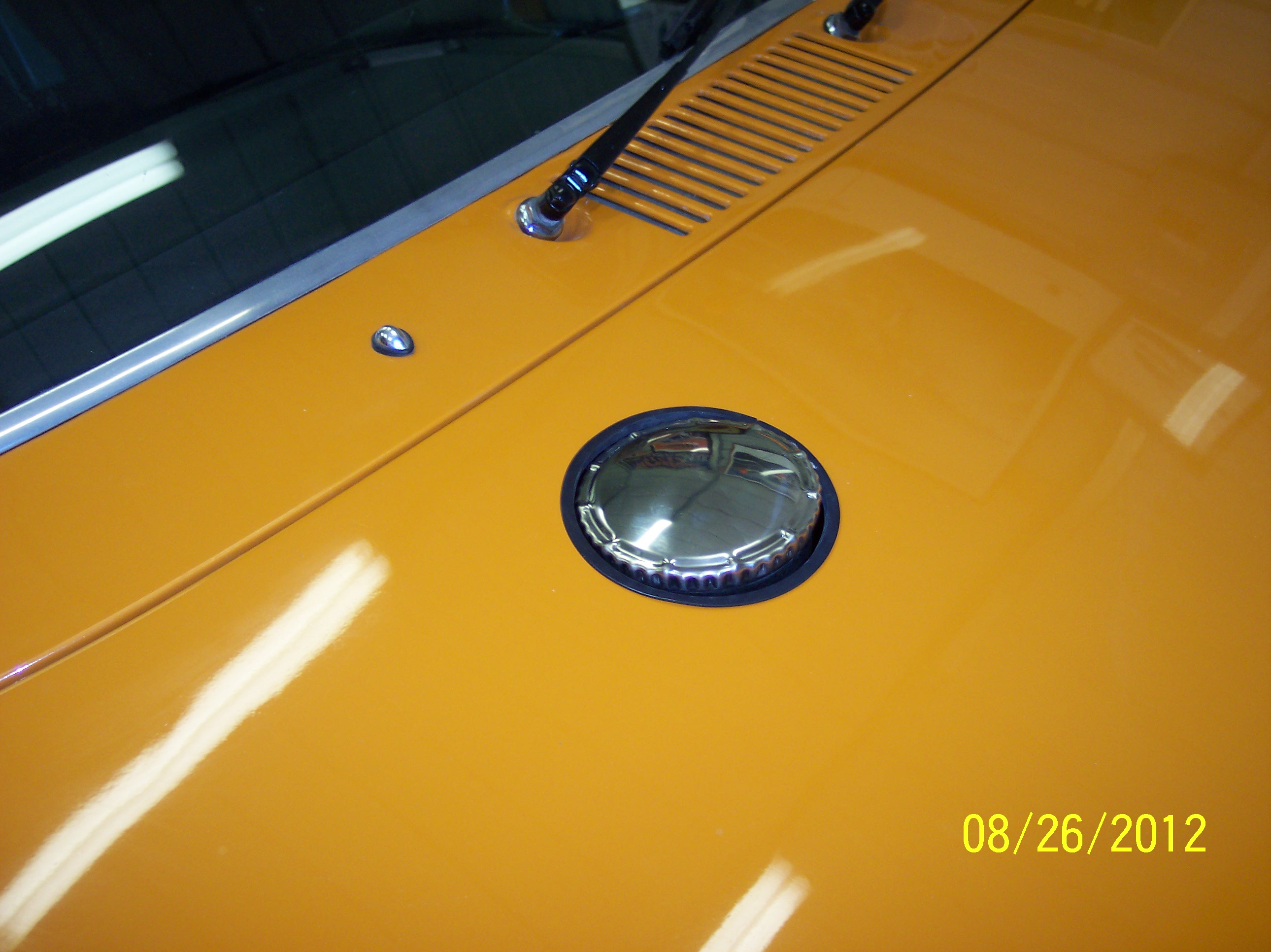

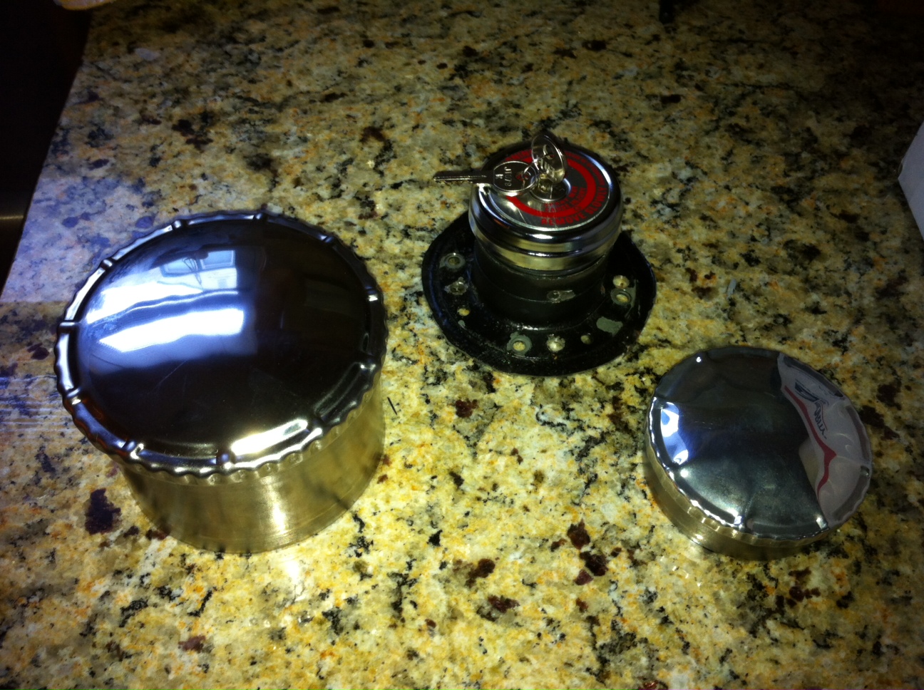

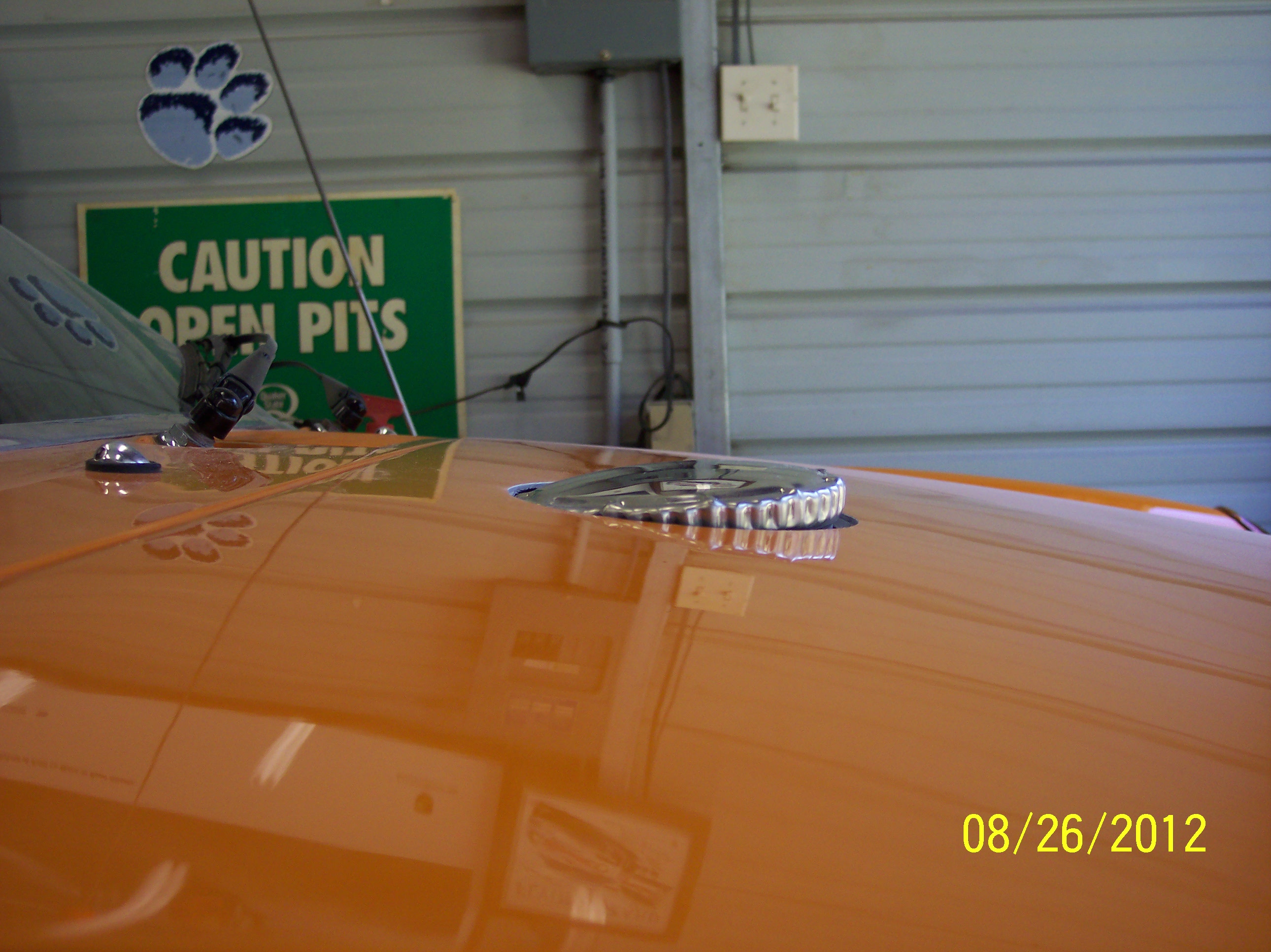

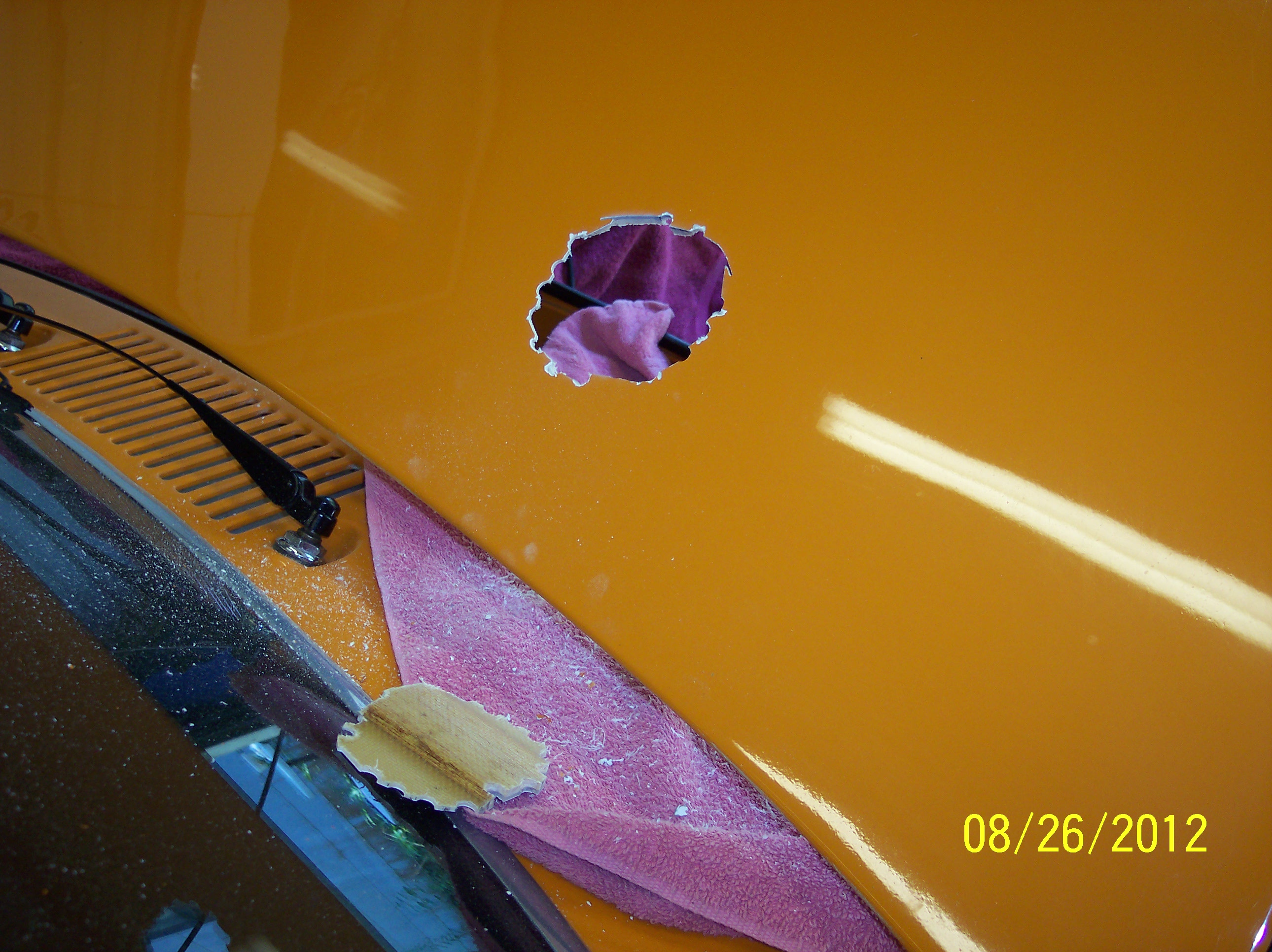

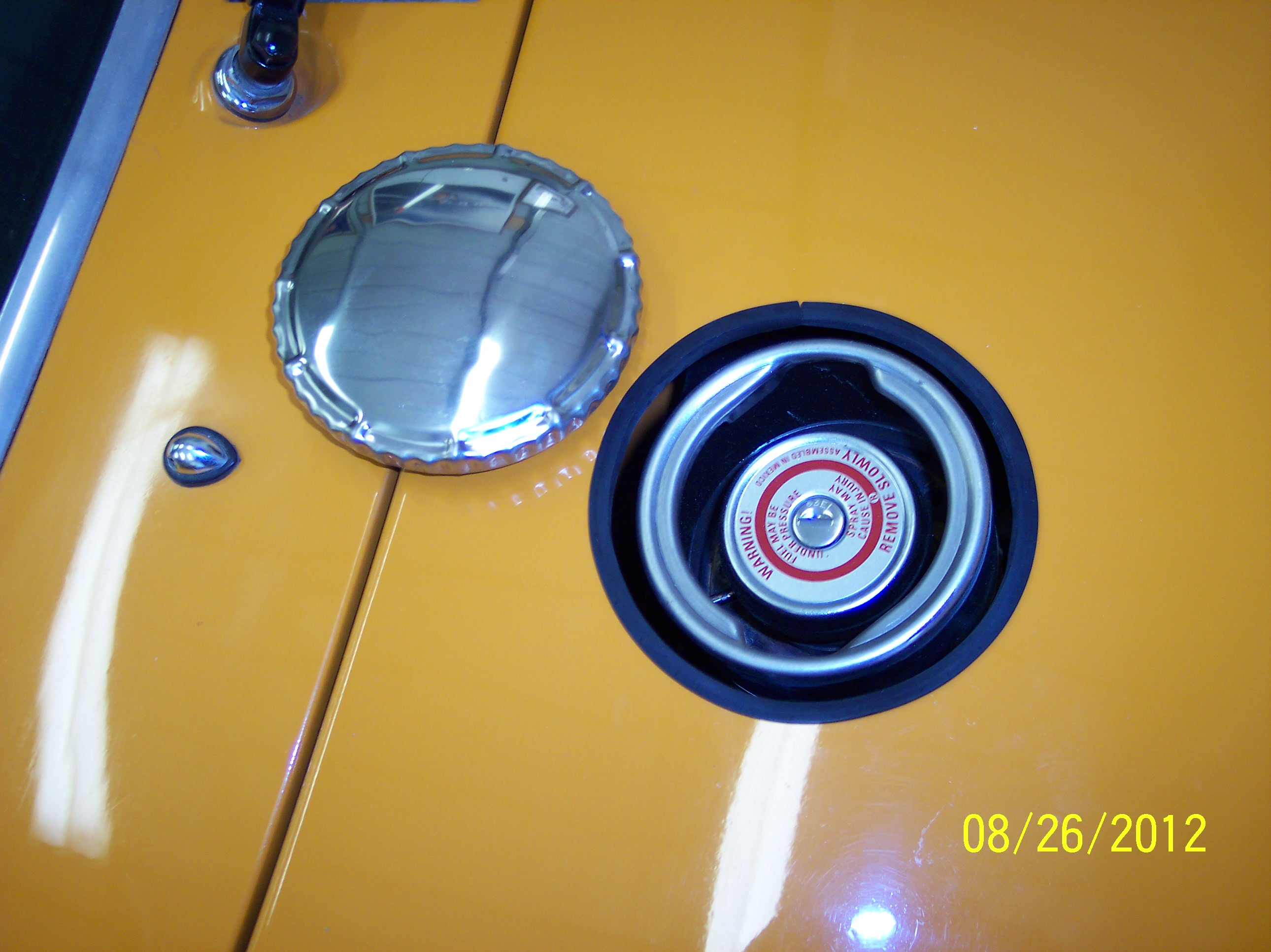

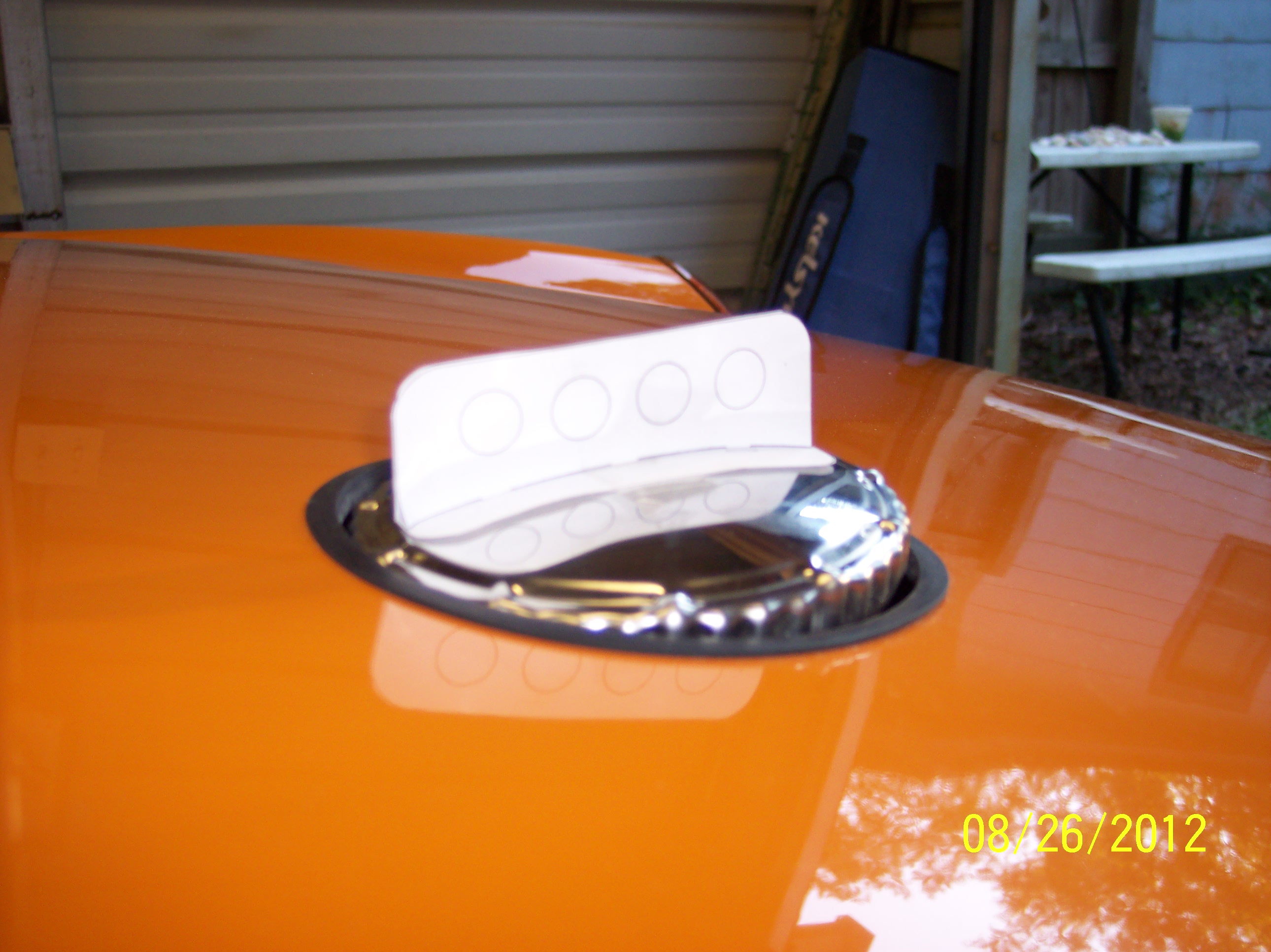

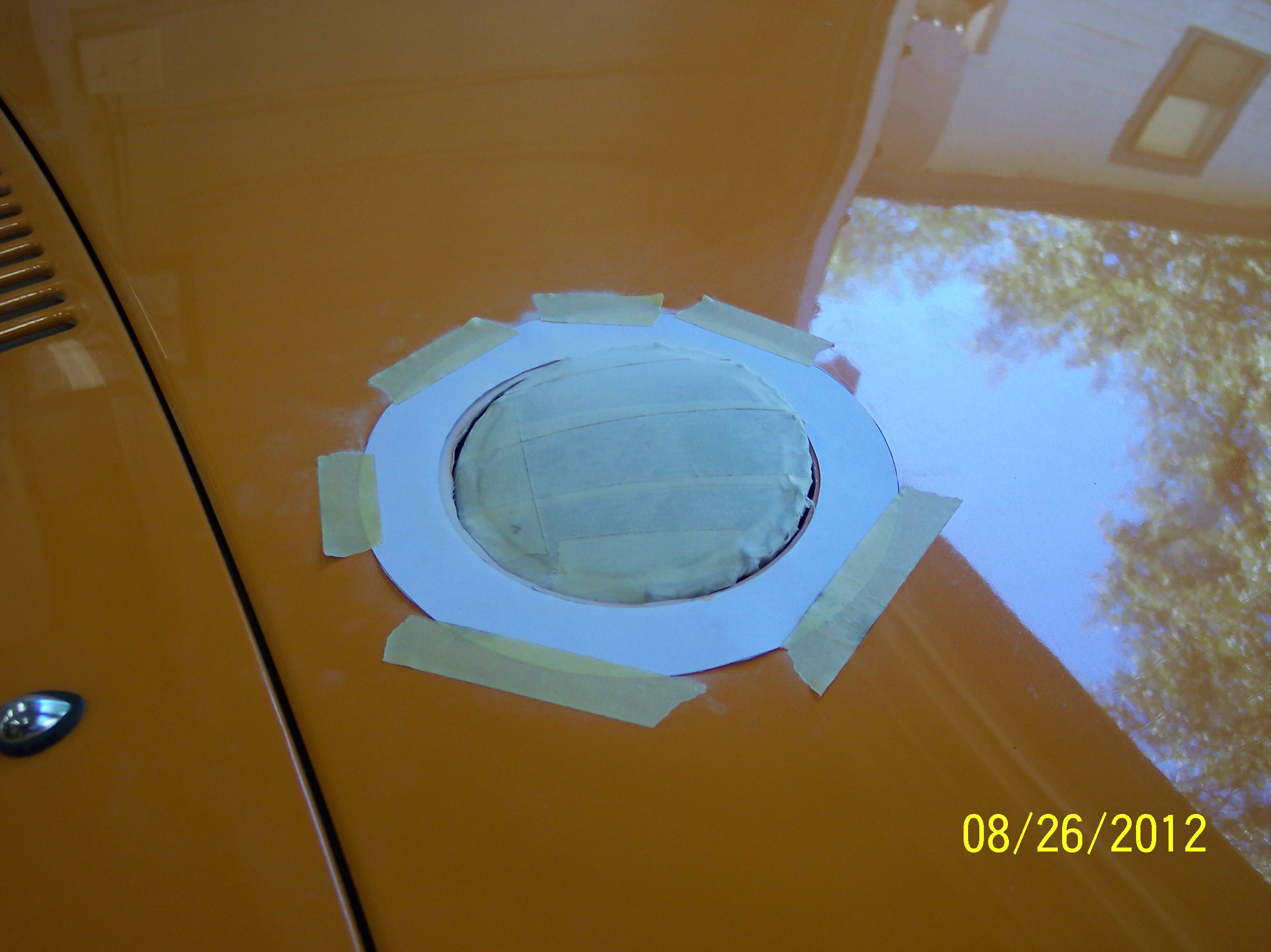

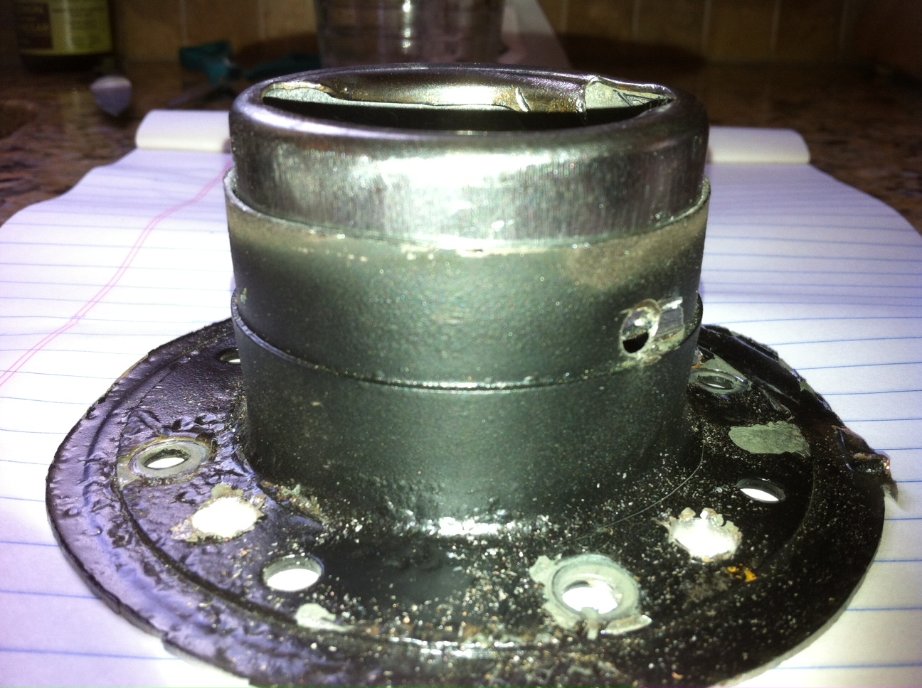

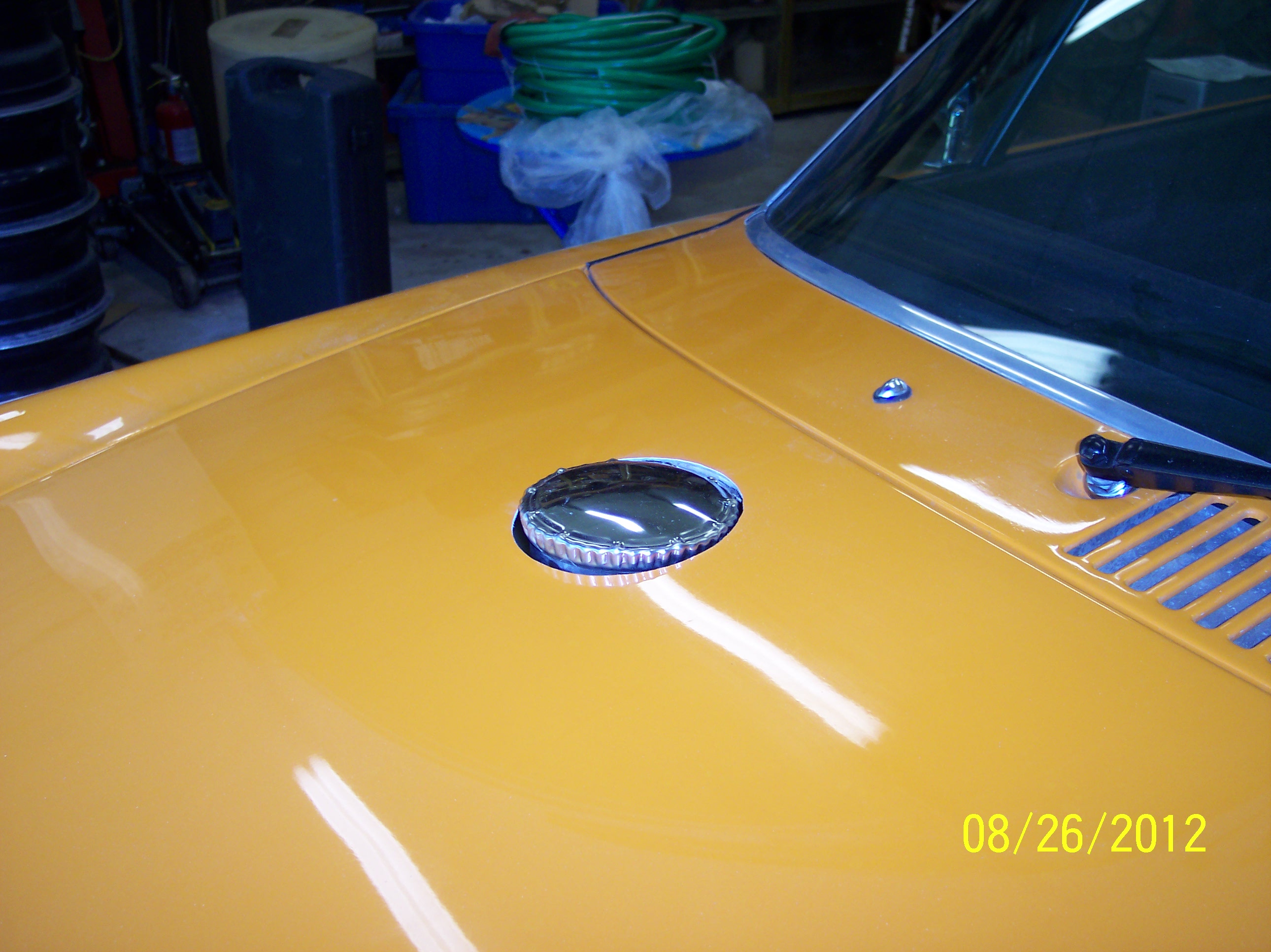

Got some work done on the cap installation. Scary day as it was time to cut the hole in a perfectly good Getty GT type hood. No going back now
I made a 1/2'' spacer to set it up high enough to go through the hood, but not set to high.
I also removed the original cap flanges from the neck, and that allowed for the setting of the new fuel neck.
I found that the neck from a 67-72 Ford F-series pickup will slide right into the 914 neck very snuggly.
Then I went to the auto parts store and got a STANT locking gas cap to fit the new receiver.
It all fits under the 110mm Blau cap with no clearance issues.
The hardest part today was cringing when I took a jigsaw to my Getty GT hood.
Scared to death I'd ruin it, but it turned out okay.
After the initial hole was cut, I printed out a hole template, taped it to the hood, and slowly opened up the with my Dremel. I used the barrel sander attachment to get the hole just right w/out ruining the paint. I finished off the hole with a piece of rubber edging to smooth the look.
Next up is welding up the receiver, and lasering out the bat handle for the cap.

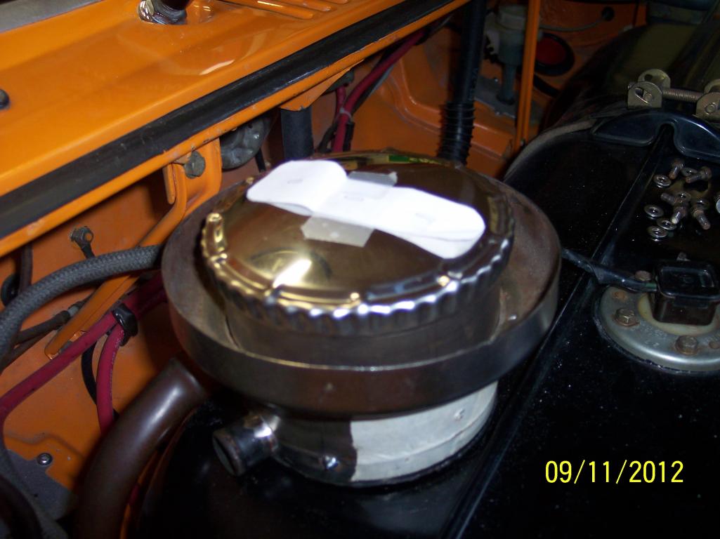

I started test fitting my parts last week. Gratuitous pics...
(IMG:http://www.914world.com/bbs2/uploads_offsite/lh5.googleusercontent.com-2075-1346435207.1.JPG)
(IMG:http://www.914world.com/bbs2/uploads_offsite/lh3.googleusercontent.com-2075-1346435208.2.JPG)

I have programmed The Bat Handle for the cap, and Bought a 12''x12'' piece of .048 #8 High Polish stainless from McMaster-Carr, to have the handle and base plates laser cut.
I am awaiting the quote from my Laser cutter to cut up the sheet. /the yield on the sheet is going to be 13 handle/base plate sets, so I'll have plenty left over.
Hopefully, next week I'll get the quote back and will give them the go ahead to cut up the handles.
I should be able to wrap this up in a month.
Ron

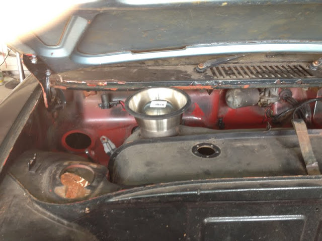

Here is what I have come up with so far. The Ford gas tank neck is proud of the Porsche neck by 10mm. Waiting patiently for the blau caps from the neatherlands.
RON S.
post Sep 3 2012, 03:13 PM
9140430841, FINALLY RUNNING
Posts: 1,216
Joined: 22-May 03
From: WALTERBORO,S.C.
Member No.: 724
David,
Lookin good so far, I can see by the pic that you've got the later style Ford neck with the shorter cap retaining lip.
The Stant Cap# 10491 will fit it with no mods.
One note, of caution, do not weld the new neck and receiver together until you have the Blau cap and receiver in hand....
When you get the new cap and receiver and place both over the Stant cap you'll notice the interference, and you'll have to compensate for it.
Ron

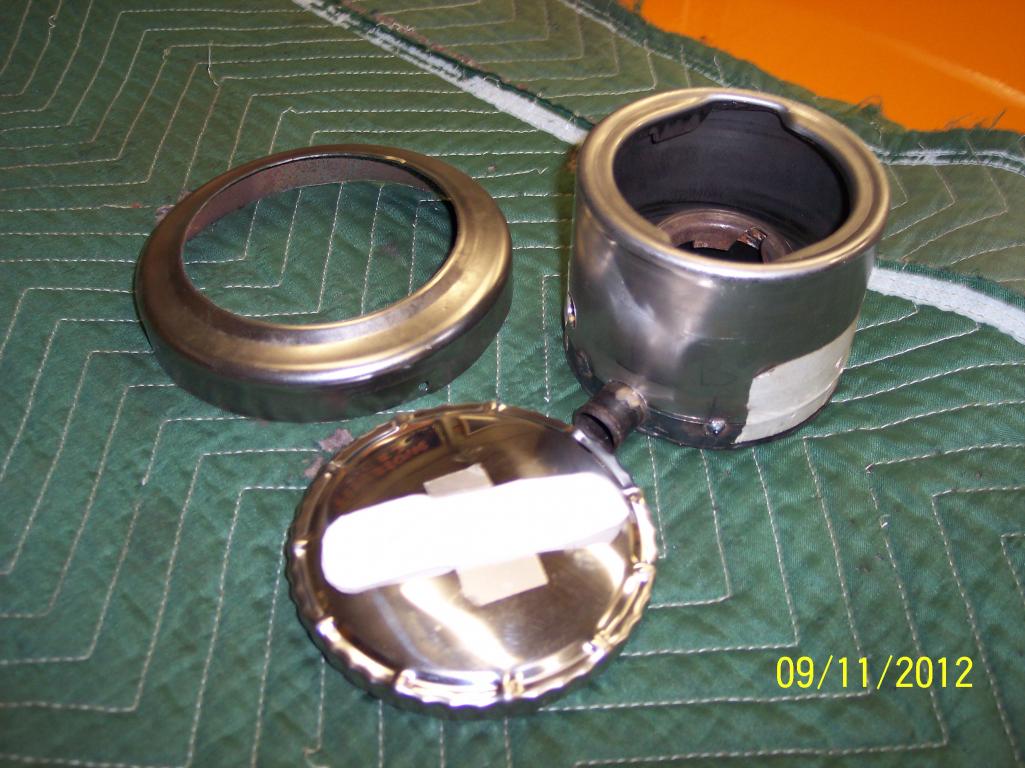

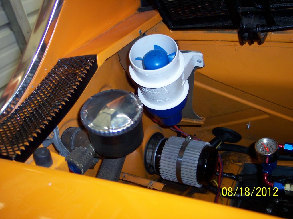

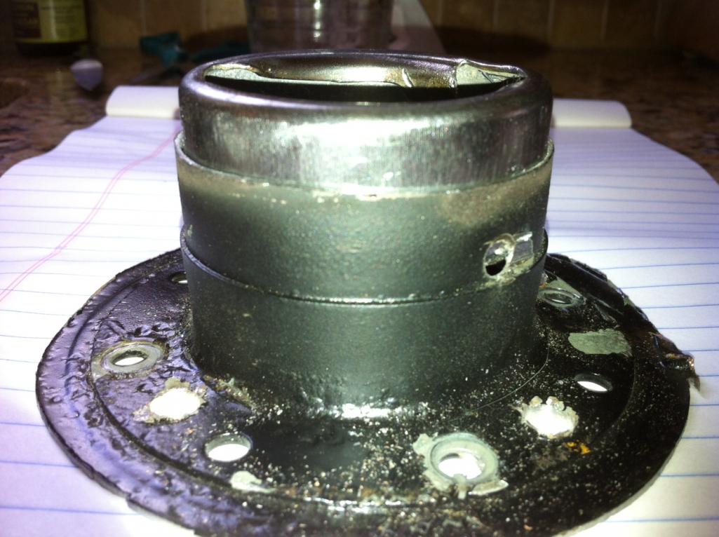

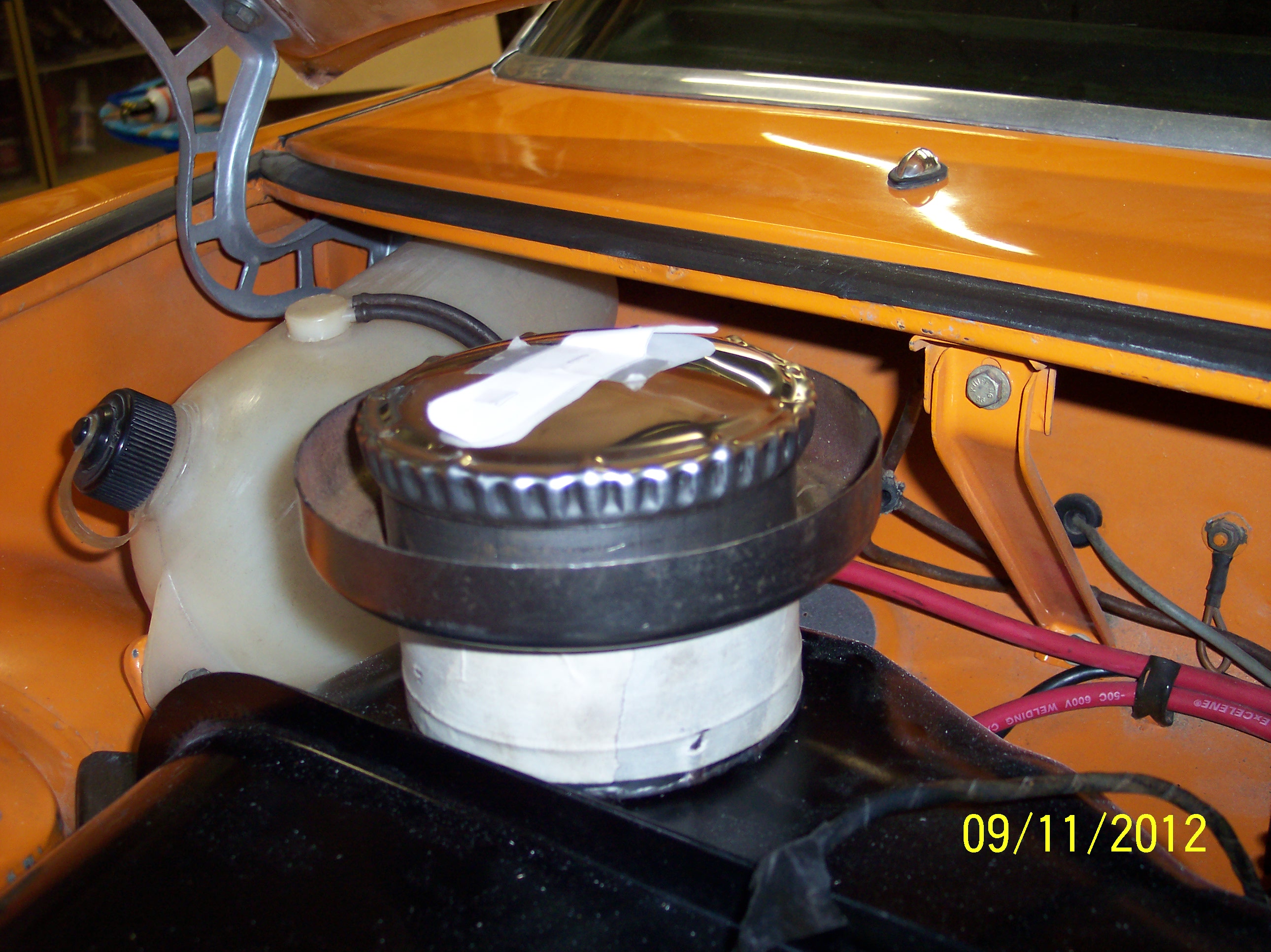

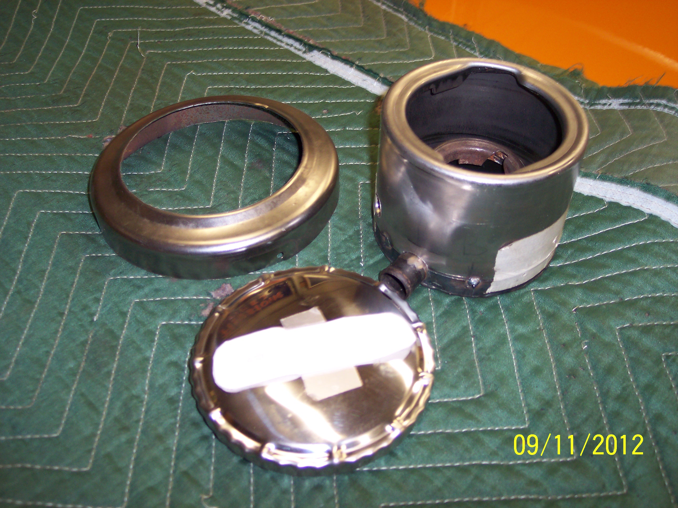

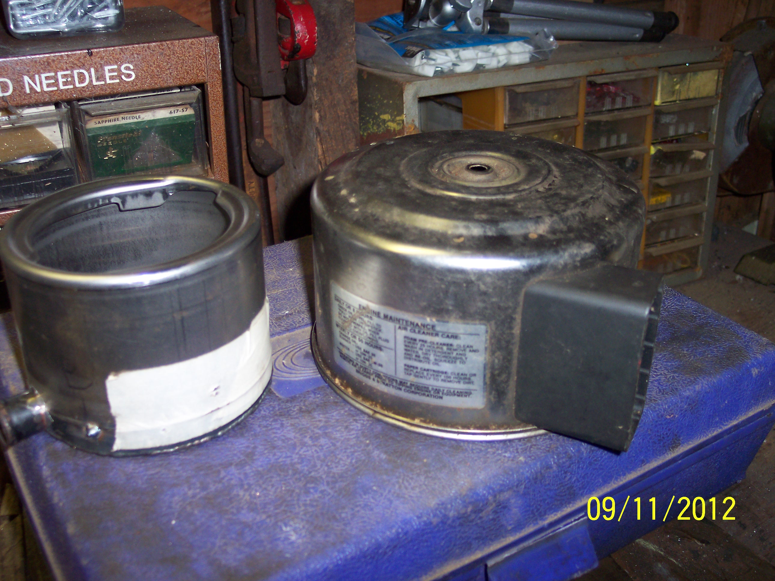

I finally got the parts for the fuel filler neck aligned, fit, and tack welded together for final fitment.
I took a air cleaner cap from a 8hp horizontal Briggs engine and used it to make the rain catch tray that will be welded to he receiver, but sit under the hood.
Another week or to, and the finished filler neck will go off to the powder coater for a shot of semi-gloss black. I also found a stainless steel sink strainer at Lowes for about 4 bucks that I will insert between the filler neck and the gas tank, just to keep crap from falling into the fuel tank due to it now having such a large opening.
Ron (IMG:style_emoticons/default/sawzall-smiley.gif) (IMG:style_emoticons/default/welder.gif) (IMG:style_emoticons/default/smash.gif) (IMG:style_emoticons/default/biggrin.gif)

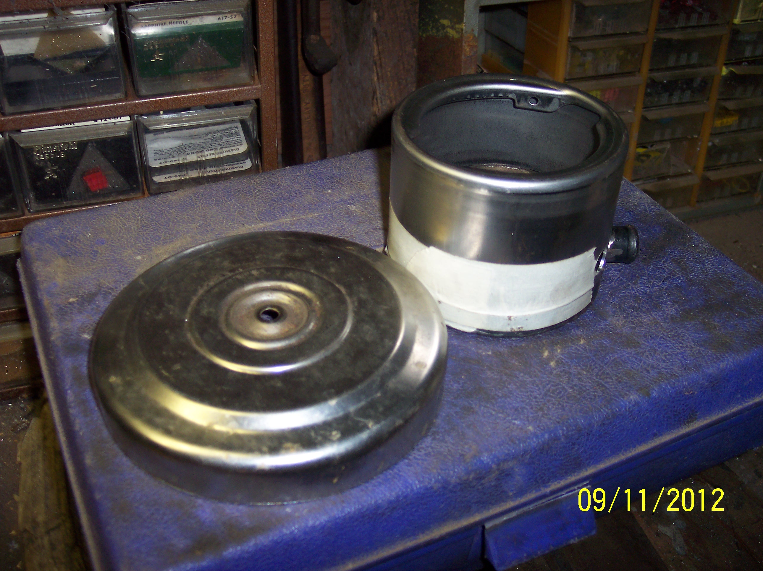

RON S.
post Sep 11 2012, 06:09 PM
Posts: 1,216
Joined: 22-May 03
Member No.: 724
Fit up pics of the rain tray...
Next up will be to get the pieces waterjetted for the bat handle that I'll have tig welded to the Blau Cap.
I have made 2 different designs to try out. I with a flat top, and another with a curved top that matches the curve of the top of the Blau cap.
Ron
