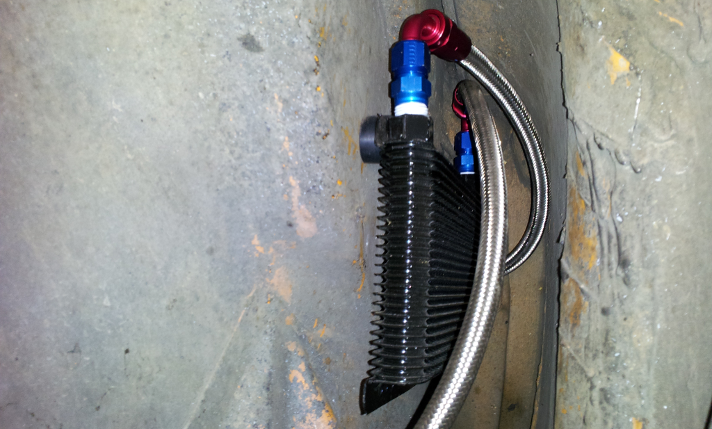

I totally agree that oil cooler(s) in the engine compartment are not a good idea, especially since there is a ton of unutilized space in front of your right rear tire.

QUOTE(pcar916 @ Aug 30 2012, 09:15 AM) *
+914 (IMG:style_emoticons/default/beerchug.gif) .............that is exaclty where I am gonna put my extra oil cooler .......... maybe put a fan and some 1/4" screen to protect from rocks ............ that is the factory oil cooler location of the 930S .... (IMG:style_emoticons/default/smile.gif)

That fender-well cooler is neat, hadn't thought about that location.
