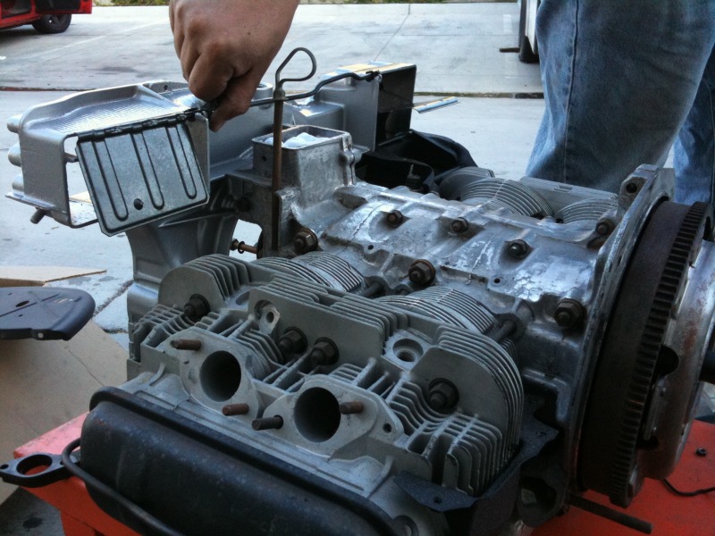

Air-cooling flaps: Cold engine position (minimum airflow over oil cooler)
JeffBowlsby
post Aug 31 2012, 10:09 PM
Posts: 9,024
Joined: 7-January 03
From: San Ramon CA
Member No.: 104
Air-cooling flaps: Warm engine position (maximum airflow over oil cooler)
post Aug 31 2012, 11:50 PM
Resident German
Posts: 42,309
Joined: 21-January 03
From: Oakland, Kalifornia
Member No.: 179
QUOTE(Jeff Bowlsby @ Aug 31 2012, 09:09 PM) *
I'm no T4 expert, but isn't that head with the CHT boss on the wrong side of the motor?

QUOTE(SirAndy @ Aug 31 2012, 10:50 PM) *
Yea but if you make your own FI harness you can put the CHT on either side (IMG:style_emoticons/default/smile.gif)
Could be that both heads have the boss.
