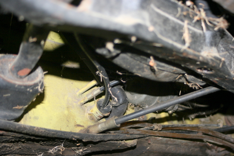

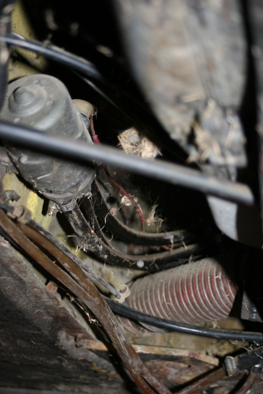

PO relocated my 74 3-port fuel pump to the rear fire wall to the right of the the speedo cable, fuel lines, flapper wires, etc.
I've got the fuel tank out to replace the fuel lines with SS ones now, but I don't want to relocate the fuel pump up front if I don't have to (don't like it being below the steering rack). Is this location far enough away from the HE's to avoid problems?

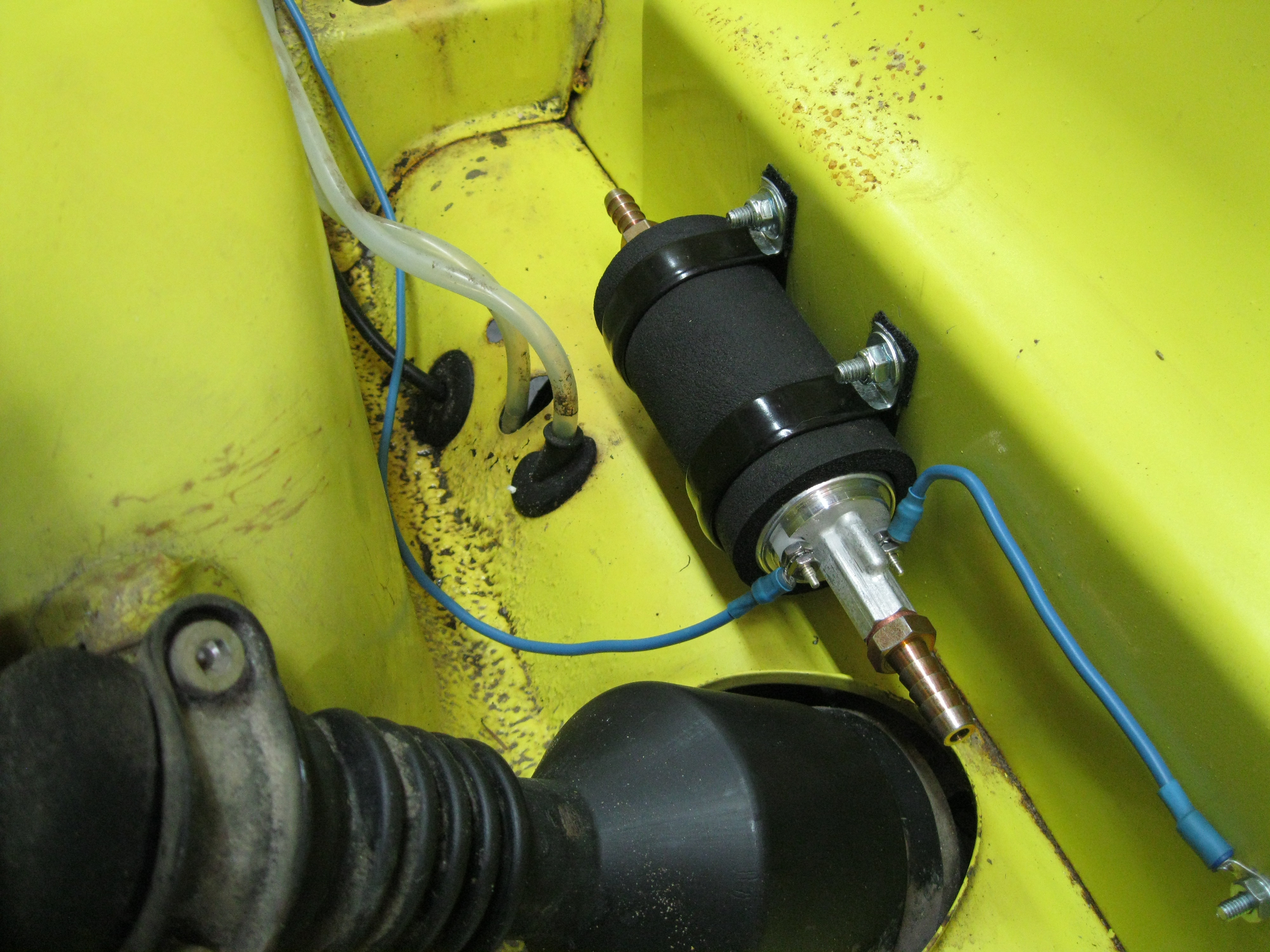

Had it up front on my last car and didn't like how it sat beneath the steering rack / how the hoses got routed through the hand hole.
