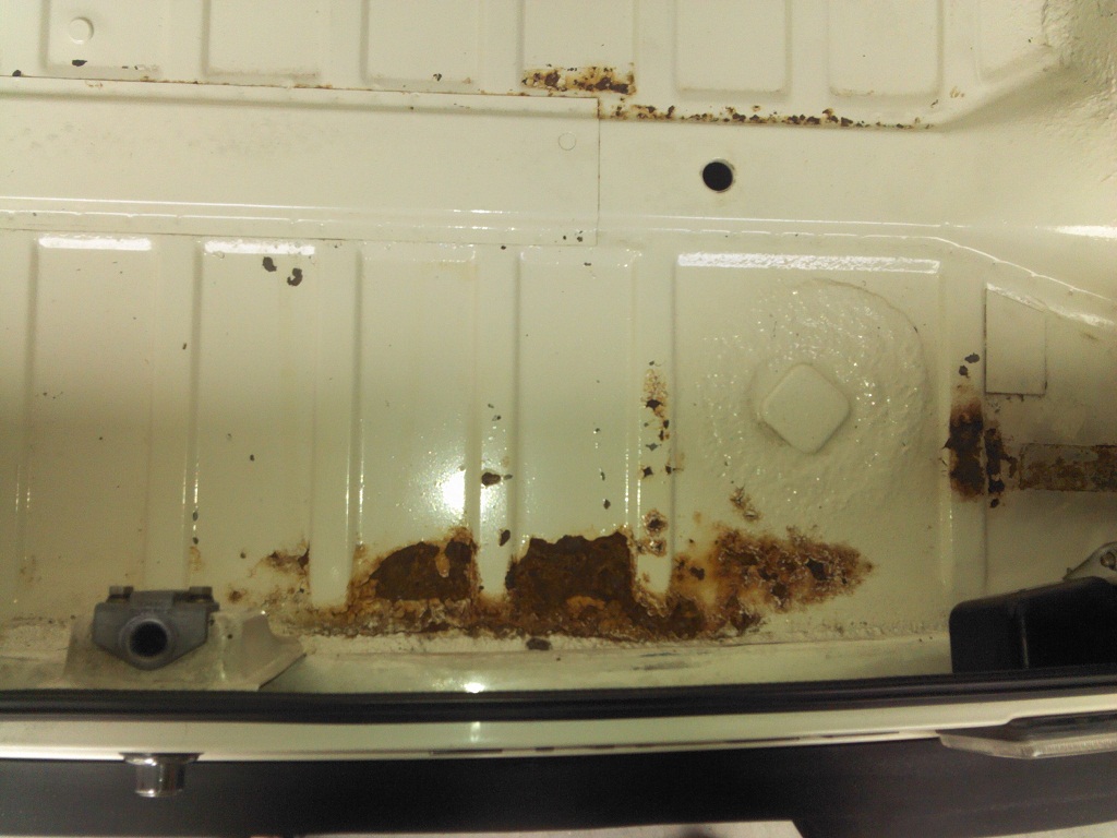

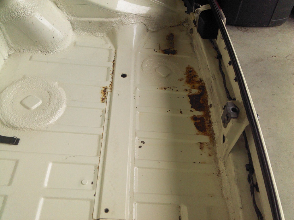

I am ready to address some surface rust in my trunk. In looking thru a variety of threads on the subject I have a couple of questions.
First the problem area:

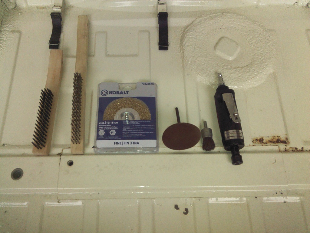

These are some of the tools I have, various brushes (steel/stainless steel/brass), Wire Wheel, Sanding disks, and air tool.

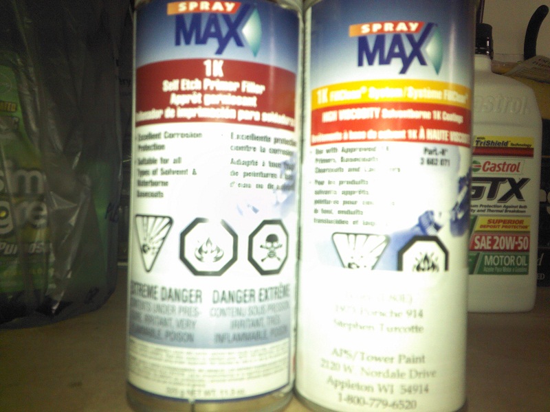

And from APS Tower Paint, two rattle cans, one of 1K Etching Primer, and one of 1K L80E Custom mixed paint:
My goal is a short term rust abatement, prior to a more full scale respray in the coming years. I belive I have to:
-use the brushes and wire wheels to remove all the rust scale and paint from the area(s) I need to address (feather the edges to blend in with the good paint?)
-clean up the area.. What to use prior to laying down the primer, just denatured alcohol, or some more specific product for pre-paint.
-lay down a couple coats of the etching primer (how many coats?) , (How long to wait before color, 24hours?).
- lay down a couple of coats of the color (how many coats?)
- not sure after that what I need to do to blend or buff the painted surfaces with the original paint.
If I'm missing any important steps, please let me know.
thx, Turk
