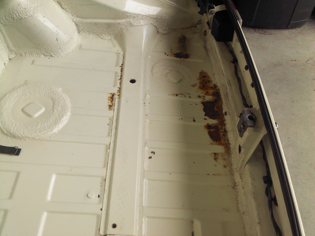

I am ready to address some surface rust in my trunk. In looking thru a variety of threads on the subject I have a couple of questions.
First the problem area:

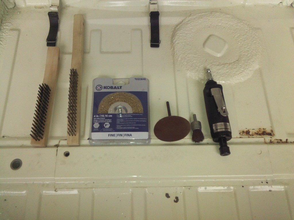

These are some of the tools I have, various brushes (steel/stainless steel/brass), Wire Wheel, Sanding disks, and air tool.

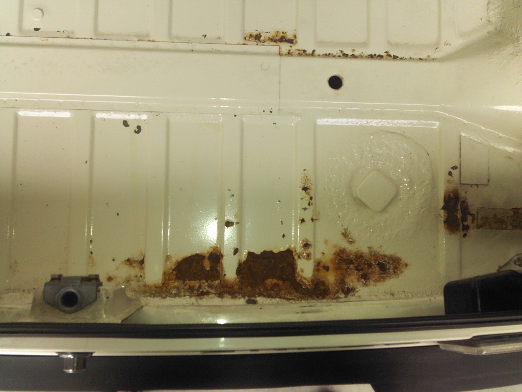

Looks like the Rust at the Back will go all the way though after you start
Katmanken
The brushes will knock the tops off the rust cells and leave the deep conical pits of the rust cells still active in the metal. You need some ospho or another acidic rust neutralizer to both etch some of the rust out of the pits, and to neutralize it to a blackened neutral state. If you don't, it's coming back real soon.
And I agree that the rust is probably deeper than you realize.

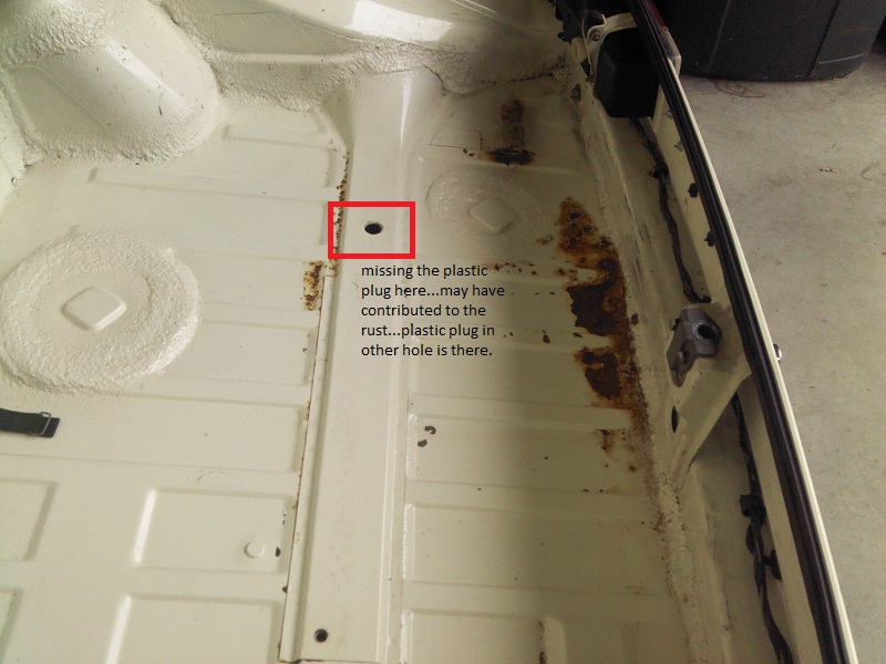

I'm missing one of the plastic plug's in my trunk rail.. I haven't seen them for sale, but I'm hoping to find a replacement:

Maybe remove the seam sealer and have that rear most area sand/media blasted. Then you'll have a better idea on what's going on. Overall the paint looks real nice in the trunk. Another area where water gets in is where the outer seal meets the rear engine lid/trunk area seal. If it's missing dum dum by the wiring harness and other side, water will get in. If you plan on driving it in the rain after it's fixed, keep the foam pad out. Good luck with your fix. Nice car!

Do you have a sand blaster? You can take duct tape and heavy plastic and mask off the trunk, insert the sand blaster in the plastic and blast the rust without making a mess all over the shop and car. You don't even need a hood over your head to do it. When your done, unmask the area and vac up the sand. Then use your metal conditioner per the instrucitons of the product label before priming and painting.

3m makes a great paint stripping wheel that will take you down to bare metal quickly. Do the surrounding area to make sure you get it all. I like them better than the wire wheels. Once you've done that you can assess if you'll need to weld in small patch(es) that you can fab yourself, or find a repro or used piece if the area is big enough to warrant it.
Clean up the metal, treat it with ospho, weld, prime and paint.

Don't waste your time with silly wheels and wire brushes. If you have compressed air get a small sandblaster and do it like I said. It will be done in ten minutes and it will last an other 30 years. If your capable of doing the paint stuff in your garage and don't want to tackle the blasting bring it to a body shop and hire them to just do the blast part.
The problem with wheels and brushes is they do nothing for the rust in the pits. BTW: the wheel you posted is for paint removal. You could try to use it on surface rust but again the issue you have is too far gone for that.

The seam sealer should come off. I did the same repair and found rust behind the seam sealer.

Oh, and if you stop by your local ACE, they'll have a whole inventory of rubber plugs. One of them will fit in that little hole.
