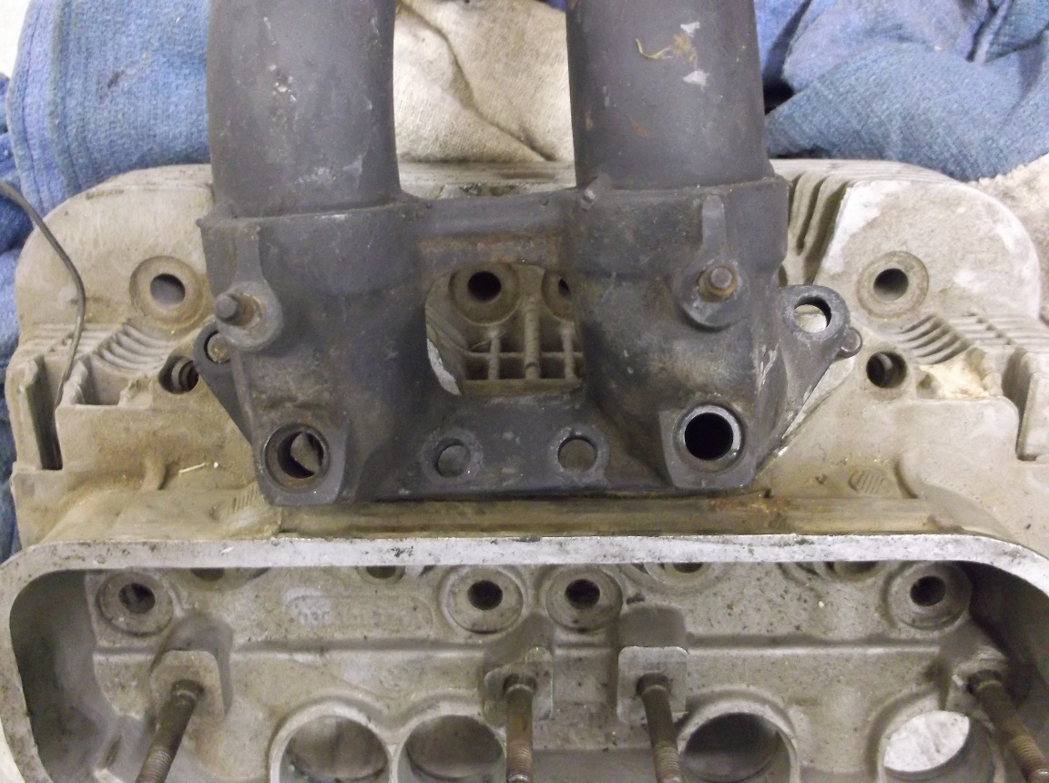

QUOTE(JRust @ Sep 2 2012, 09:27 PM) *
I don't think so. The 2.0 plenum is wider than the 1.8. I would just drill the 1.8 intakes. I think you just need to drill one hole for the lower middle stud. Someone else chime in who knows for sure. I'd say I am 75% sure & make no claim to being a genious (IMG:style_emoticons/default/blink.gif)
You can't drill the 1.8L intakes and make them work on a 2.0 head. The two outboard studs are spaced different.
This is a picture of a 2.0 head with a 1.8L runner over the stud on the left. The right stud doesn't match up.
