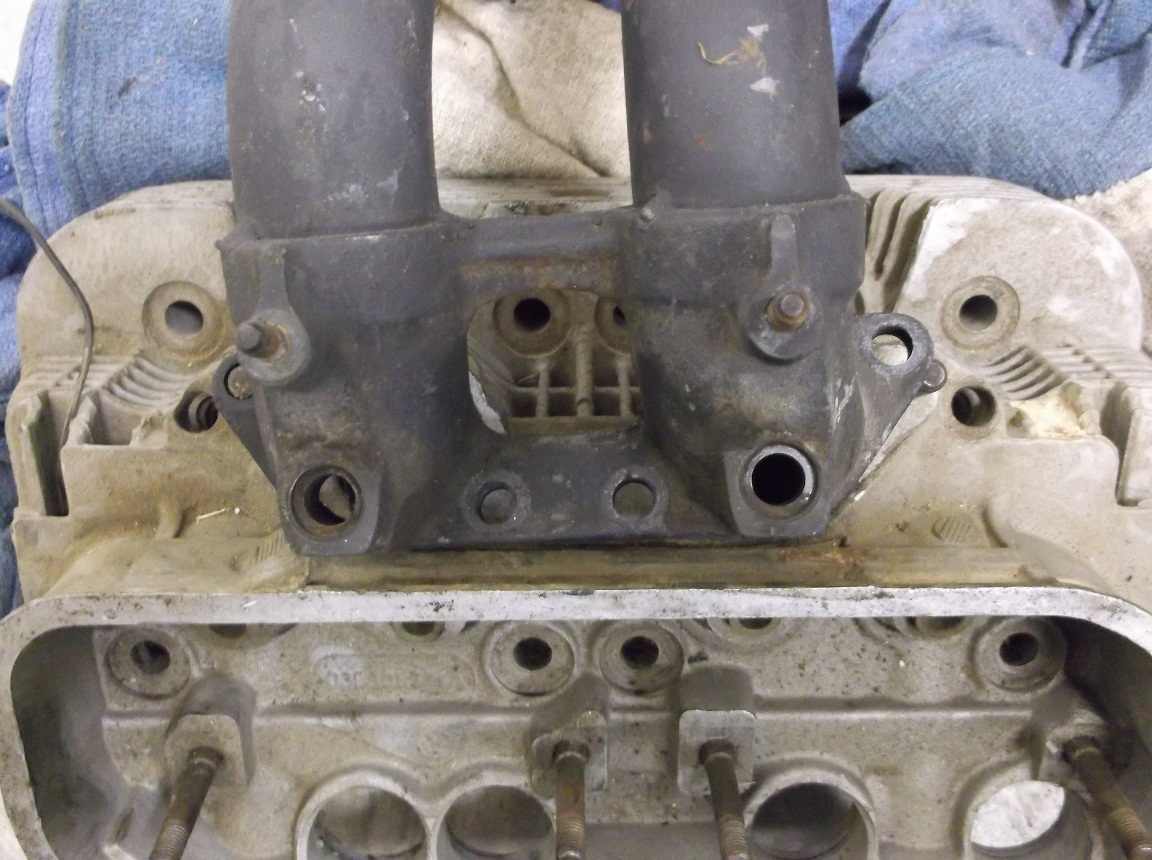

You can't drill the 1.8L intakes and make them work on a 2.0 head. The two outboard studs are spaced different.
This is a picture of a 2.0 head with a 1.8L runner over the stud on the left. The right stud doesn't match up.
