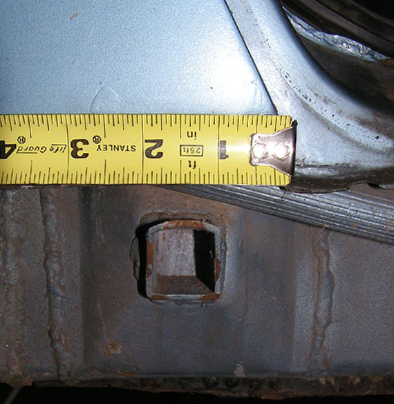

1 view (both right side)

2nd

Great Pix. Thanks that helps a lot. When your outer rocker is in place is the post pretty much flush?

QUOTE(Deano @ Oct 26 2004, 10:11 PM)
Yes.
There's maybe 1/8 to 1/16 gap, but the plug fits snug when it's in so I don't think that matters. The tube also is snug against the rocker (no rear gap that I can see), fyi.
