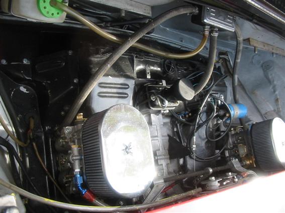

the heads "suck" at higher rpms and the oil-filler neck "blows" ... (IMG:style_emoticons/default/biggrin.gif)
soo, yes, i think it matters. i have the oil filler line go straight to the breather box as well as the 2 head vents. that way, i get a nice flow ...

Andys looks pretty much the same way as mine is done.

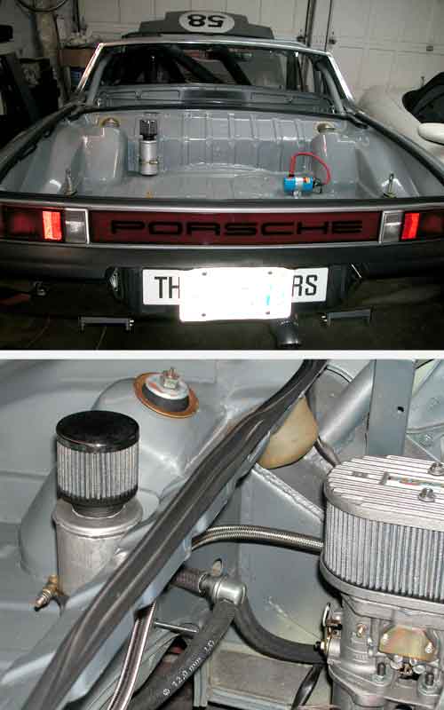

Here's a couple pics of my rig. The catch tank is in the trunk and plumbed back thru the firewall. The drain for the tank is actually under the floor of the trunk. Looks neat and when its time to drain the oil, won't mess up the engine bay or trunk.
I may change the routing of the breather lines later, right now I just wanted to get her fired.
