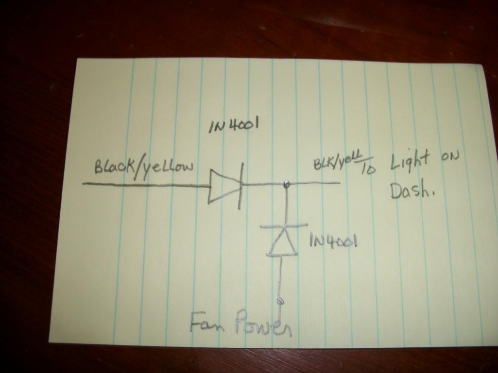

Possible by using two steering diodes. I believe 1N4001 diodes will support 1 amp. Should be more than enough for a small indicator lamp.
Jim, one power from relay ( black/yellow), other from fan.

QUOTE(Tom @ Sep 22 2012, 12:48 PM) *
Tom
Are you making 1 idiot light illuminate from 2 sources? It's a little unclear, your intentions. If so I agree with your simple schematic. (IMG:style_emoticons/default/smile.gif)

Mike,
Yes, two different power sources to light one lamp. It is for Jim in post 2.
