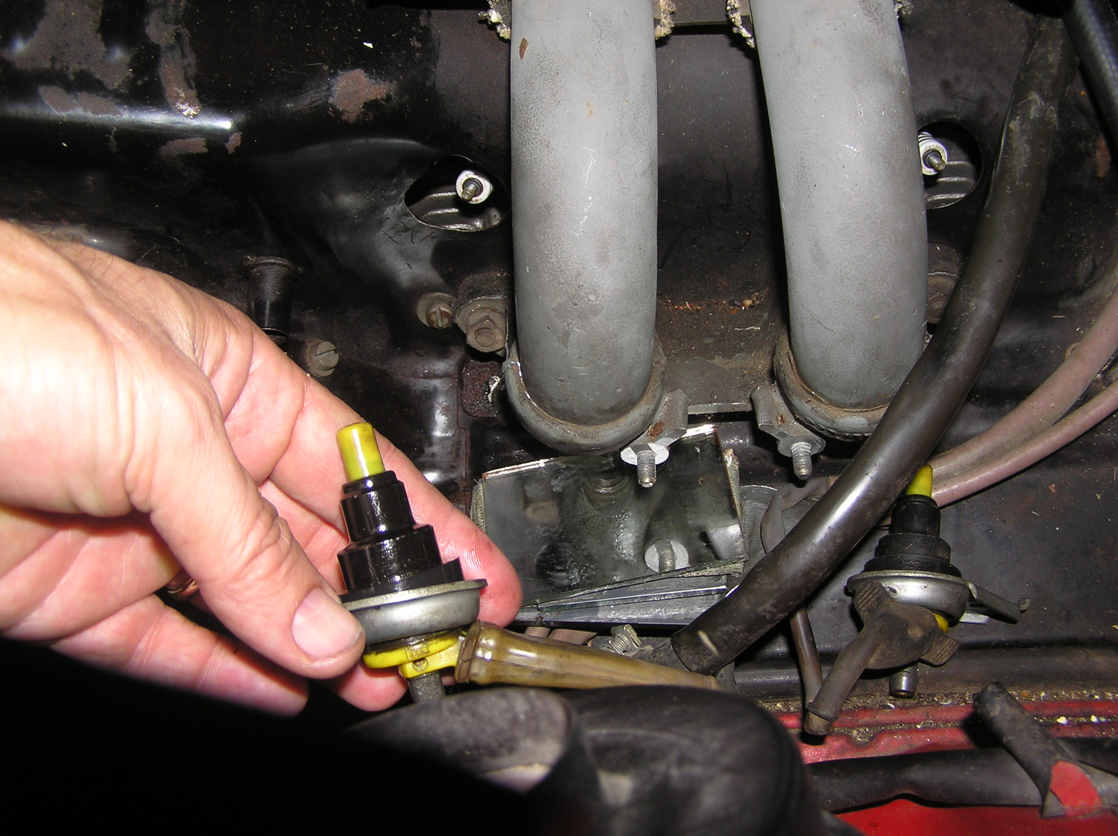

Are the injectors supposed to be yellow on a 73 2.0L?
If not then are they OK?Attached Image

NO !!!!! They are green.

Yellow means they are 1.7 injectors. Probably not supplying enough fuel to the engine. The injection rate is different. If the color was blue or brown they would be for the 1.8 L.

The spark plug holes say that it's a 2.0 as well.

dealer, or somebody put the wrong injectors in it
probably at a time when the green ones were not available.

Stick it on an A/F meter to see how it's burning. Might be running lean. If not ... enjoy (IMG:style_emoticons/default/smile.gif)

I had a similar problem last year. Someone replaced my yellow injectors with green ones in my 1.7. Installed the correct yellow injectors and I am getting much better gas mileage not to mention it is running better!

New green 2.0L injectors can be had from a few vendors for around $400 or a little less.
I also have a bag of spare used 2.0 injectors that I could send out for rebuild and supply to you. PM/email me if interested in working out a deal.

I see green ones on 1.7s and yellows on a 2.0. it is a common mistake.
1.8 injectors will not work on D jet
