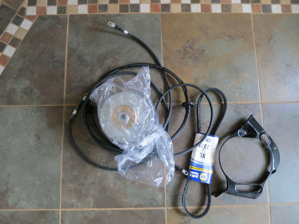

Well I did it!
(IMG:style_emoticons/default/piratenanner.gif) I cut out the middle man that was making this too expensive. (IMG:style_emoticons/default/bootyshake.gif)
The machinist!
GO TO POST#1 FOR UPDATED PRICING
I purchased some more equipment as well as some more parts.
I machined this run for nothing as far as compensation for my time or materials!
Still polishing this up.
The functionality is just fine as it is working great!
I was out in the prototype today as it was 78 degrees here.
(Talk about the calm before the storm or in this case the winter.)
The housings are good to go!
I did a run of 3 alternators, 3 tins and 3 Combo Cables to start out with.
I will do the next 3 alternators at this price point then re-evaluate the whole thing.
I would have made more but the Alternators are not the cheapest Delco's. But they fit well and the Cheaper ones just don't fit. Oh well.
I hope that this was all worth it.
Pete

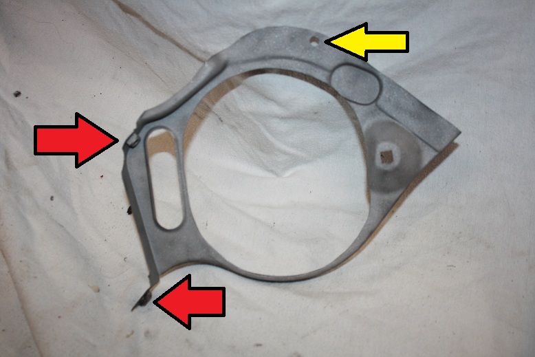

remind me again to why we need the alternator tin? What would happen if we left this piece off?

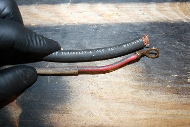

QUOTE(euro911 @ Oct 25 2012, 11:33 AM) *
This is my understanding:
The 'Installation Kit' is an extra $225, or less, depending on what wiring or parts you need
Even if you don't do a major upgrade to the alternator output like this one. The wiring upgrades are a good idea regardless.
I heard that a couple of these 914's have some rust issues (IMG:style_emoticons/default/laugh.gif) ;therefore carrying an extra ground from the battery to the engine and transmission via the bellhousing might be a good idea.
Some believe that the oem wiring besides being old and brittle was in its original form barely larger enough to accomodate the cars needs. Then some of us actually put a real stereo in the car:-O So upgrading the wiring between battery and the starter and then between the starter and the alternator is a good idea too.
(See pic Below for comparison of oem alternator wire vs my replacement.)

QUOTE(timothy_nd28 @ Oct 25 2012, 11:01 AM) *
The alternator tin ties together some of the other tins via:
-welded nuts (see RED ARROWS) -
-to the main fan housing bolt (see YELLOW ARROW)
-as well as to the alternator pivot carriage bolt (square punched hole.)
(I guess without the tin you might experience a rattle from the other parts not being as tight as they could be.)
Hope this helps. (IMG:style_emoticons/default/bye1.gif)
(Note the hole cut larger and oblong to accomodate the fan and the belt adjustment.
This is the point where I check the fitment of everything then media blast it prior to painting
