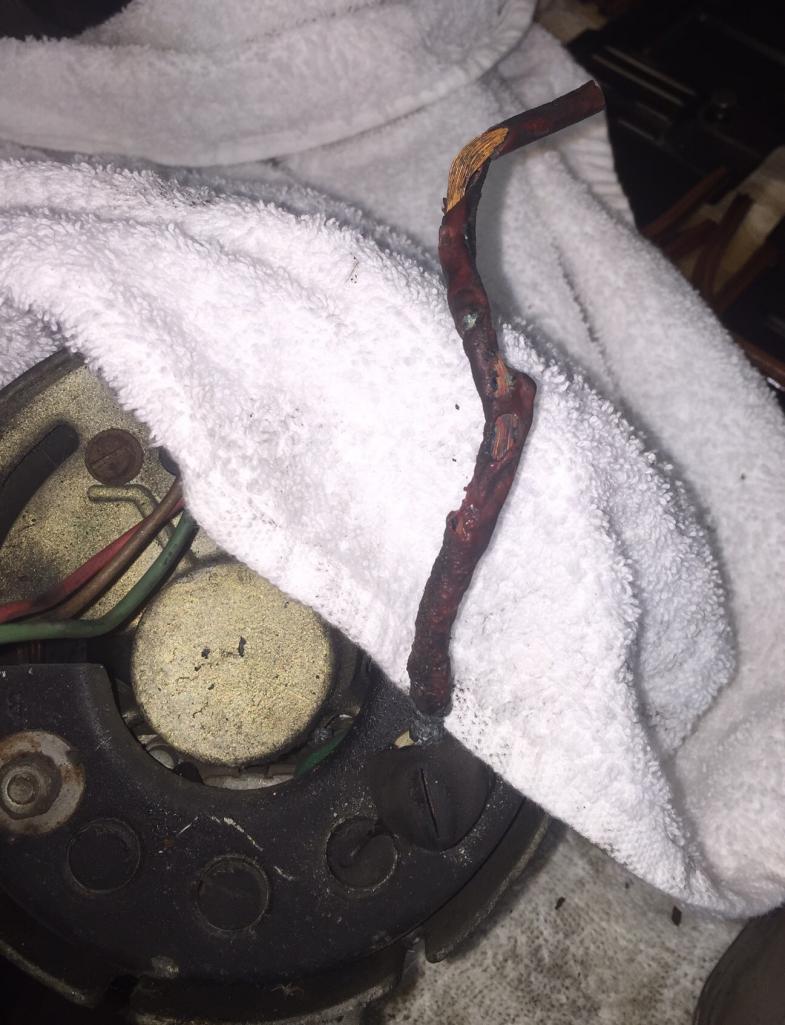

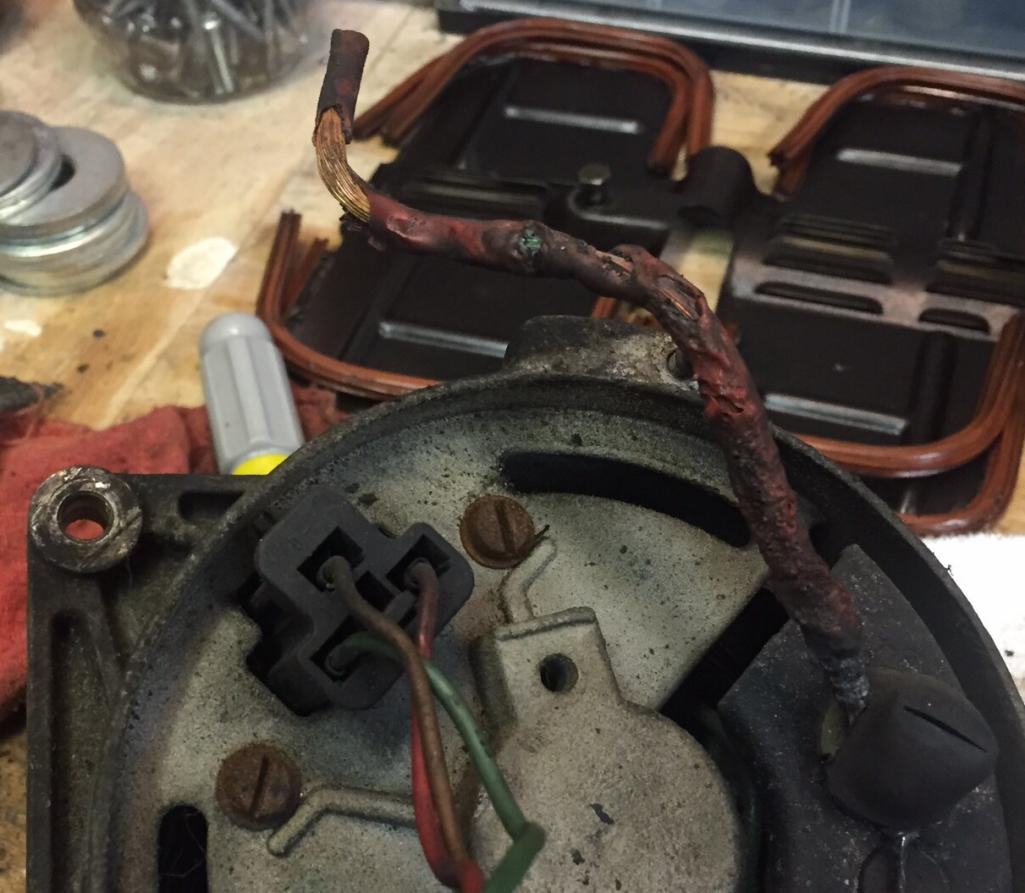

I was asked why do we need to replace our wiring let alone up our electrical load capabilities.
Instead of going on a long dissertation I thought that I would provide a picture of an original OEM system that was taken out of a car to do one of my conversions.
Too much draw through too little wire. I wonder if it provided any illumination ...like a light bulb filament?
I will let the pictures do the talking.

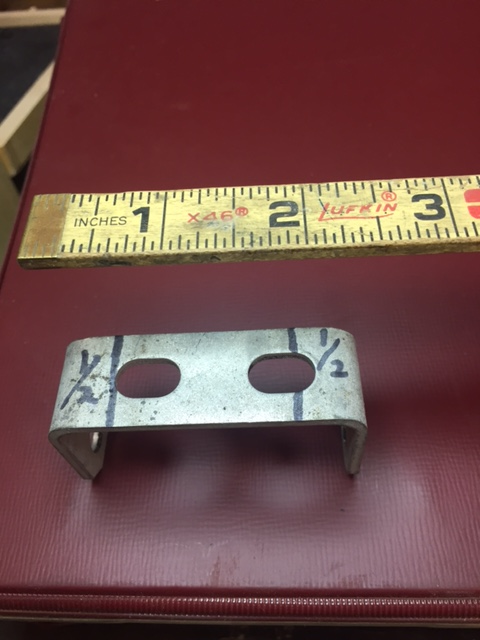

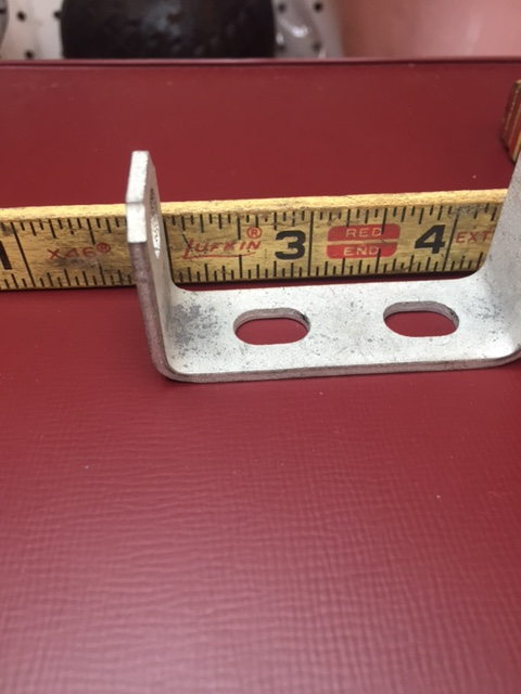

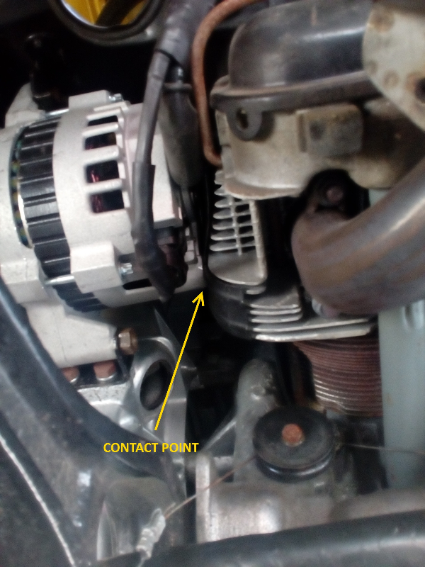

I had a person installing one of the kits have some rattle coming from their alternator. The back of the alternator was touching the cylinder head sheet metal.
(Please see the picture that they were kind enough to provide.)
They were not aware that the alternator pivot bolt U bracket that mounts to the main fan shroud is adjustable. The U bracket can be slid forward and reverse via its oblong holes or it can be flipped 180 degrees changing the offset even further as the holes are offset.
(See the pictures of said bracket that I provided.)
Noise not withstanding, it is important that the installer provide as much clearance as possible at the rear of the alternator to move the positive cable bolt down terminal forward / away from the cylinder head sheet metal as much as possible.
All better now. They flipped the U bracket setting the alternator further forward. No more noise!

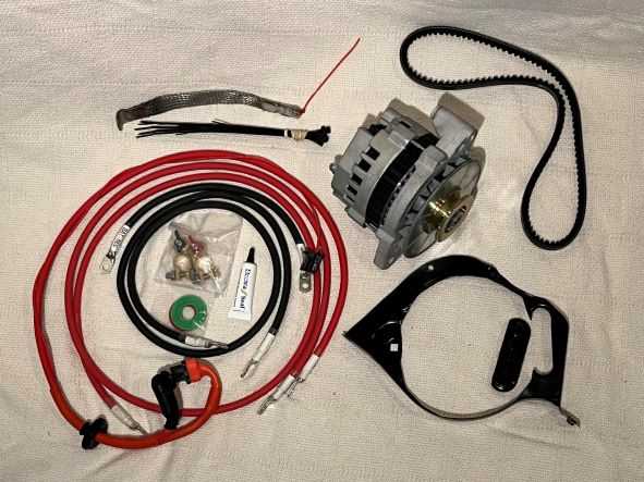

I just made a run of High-Power Type IV Alternator kits.
105-amp alternator with 160-amp stator
Plug and Play kit (see picture below).
I have only 6 kits left as of the time of this listing. ( SOLD OUT )
