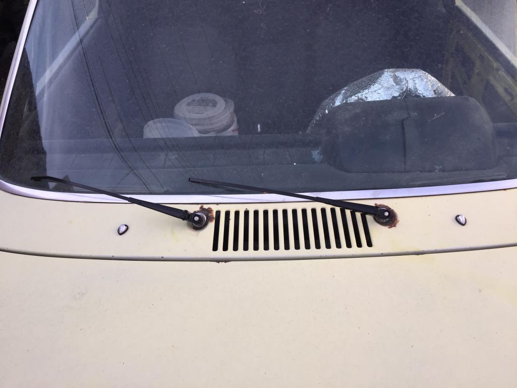

Most of the things I’m doing had been done to the sixes, or in my opinion should have been done by the factory. Darn windshield wipers park right in my field of view. I took them off for a while. Then saw a better way.

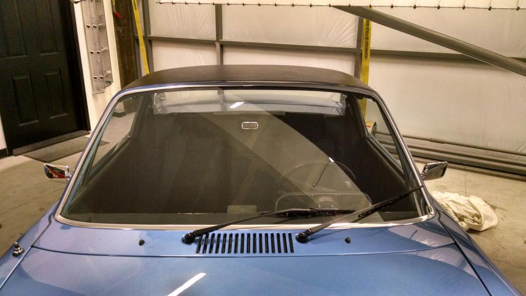

Good mod, you have the arms on the wrong spots. The one with the bend should be center so the wiper lays flat when parked. The one to the edge should be straight so the wiper doesn't hit the trim when parked.

Like this, although yours are opposite:

I love them on the driver side.
The first swing of the wipers clears the water from your view.
Move them to the passenger side and the first wipe moves water into your view.
When parked, the water that’s coming off your cowl and hood is redirected off the left of the windshield.
My wife’s Honda parks on the right. All the excess water that was pushed down by the driver side wiper now flows unimpeded over the driver side of the windshield.
Porsche had them on the right on early 911’s. I plan to move it to the left on my ‘67. Freaking out the originality guys will be a bonus.
* If you are in an area that rarely gets rain, it’s not a big concern.
