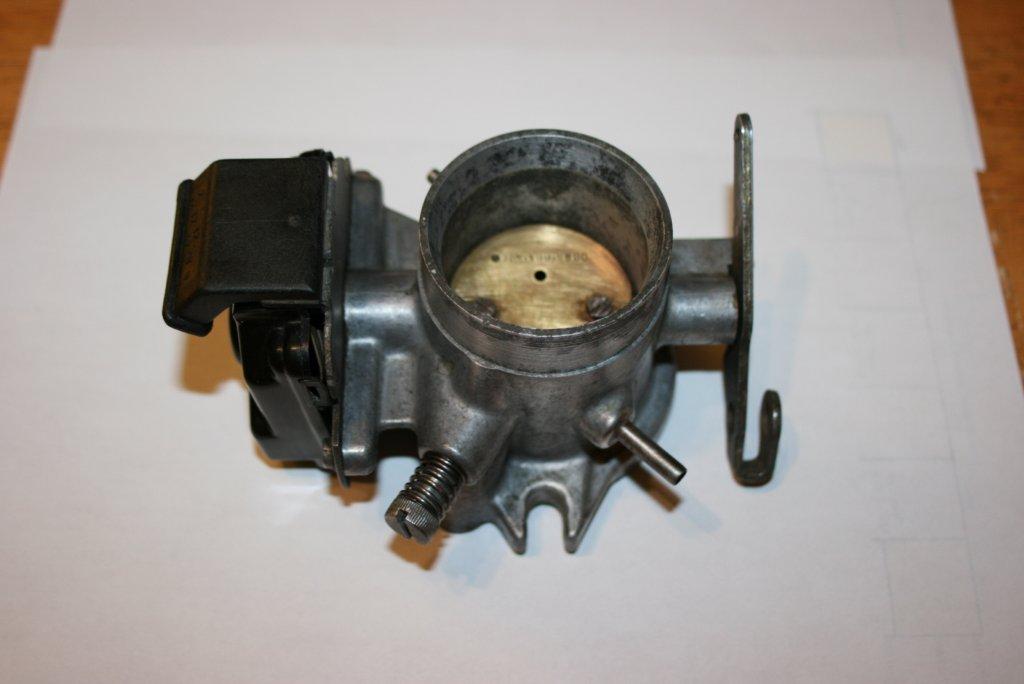

If the vacuum hoses are correct then you may just need to adjust the idle speed valve.
It is the screw with the spring in this picture. Counter Clockwise will increase idle speed.
You should really consider consulting a known good 914 mechanic though.
