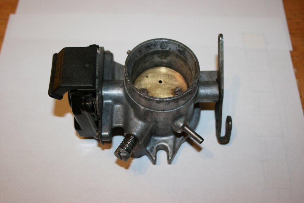

If the decel valve is plumbed wrong it could cause rough idle speed. You can check the diagrams here
http://www.pelicanparts.com/914/technical_...4_20FI_diag.htmIf the vacuum hoses are correct then you may just need to adjust the idle speed valve.
It is the screw with the spring in this picture. Counter Clockwise will increase idle speed.
Click to view attachmentYou should really consider consulting a known good 914 mechanic though.
