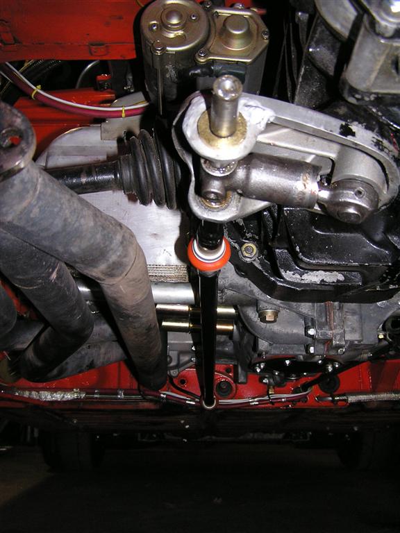

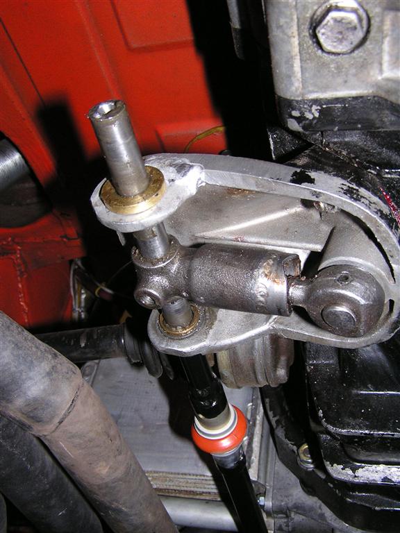

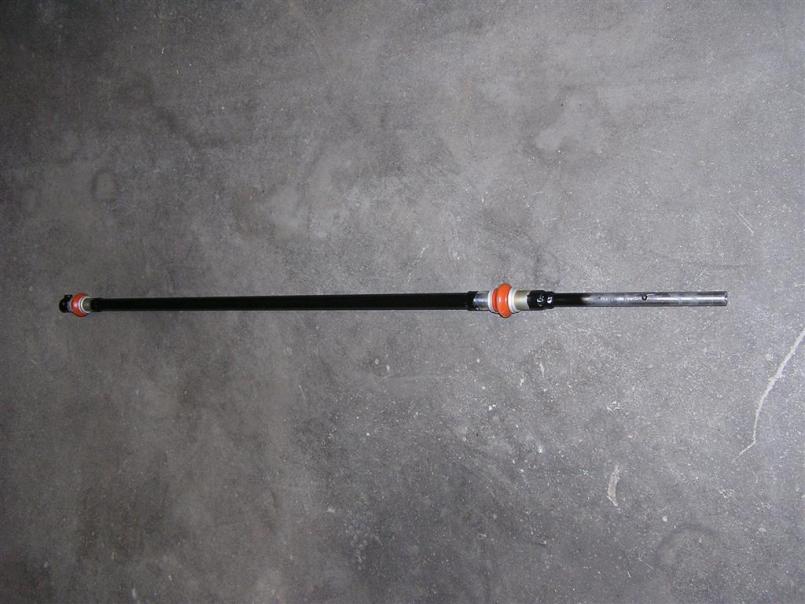

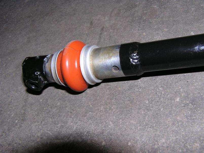

brant
post Oct 26 2012, 02:39 PM
Posts: 12,283
From: Colorado
Member No.: 47
Here is ours... a straight-hollow-cromoly bar with twin apex joints.
the shifter inside is an AJRS special
we literally cut an ear off of a second housing and tig'd it onto this shift housing to make a double support for the longer linkage. the brass bushings are custom reamed to fit.
cover not pictured, but we made one similar to Eric's
you can also see we have a custom extended cup bushing holder... basically all of it is custom. a hand machined delrin firewall bushing too....
