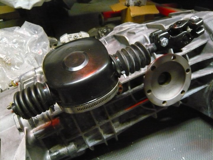

Eric_Shea
Oct 26 2012, 01:39 PM
Here's where I ran into issues...
It's not the pipe that's clearly visable in this shot, it's the middle pipe that's kind of darker behind it:
Again, I think my HE's were tweaked a bit but this was an easy fix with an acetolyne torch.

brant
Oct 26 2012, 02:39 PM
Here is ours... a straight-hollow-cromoly bar with twin apex joints.
the shifter inside is an AJRS special
we literally cut an ear off of a second housing and tig'd it onto this shift housing to make a double support for the longer linkage. the brass bushings are custom reamed to fit.
cover not pictured, but we made one similar to Eric's
you can also see we have a custom extended cup bushing holder... basically all of it is custom. a hand machined delrin firewall bushing too....
