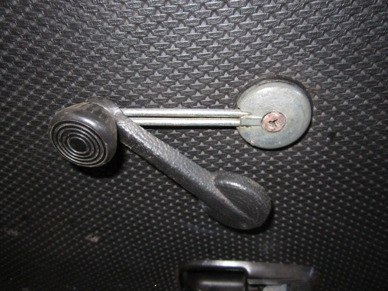

Start by pulling the rubber cover off the window crank. Then remove screw from crank and remove crank.

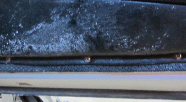

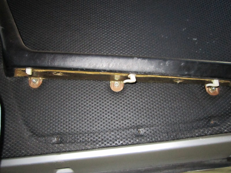

Remove three screws along bottom of arm rest. Then slide arm rest forward and down to remove.

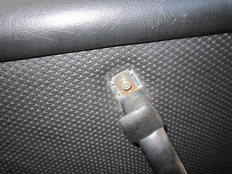

Remove three hex head screws with 4mm hex wrench from arm rest. You can see in this picture how the lower portion of the arm rest must be slid forward to remove or the plastic arms will break off. (someone broke the front one).

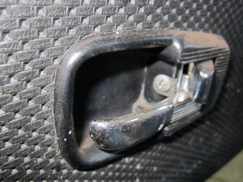

Remove the 4mm hex screw from top of door handle. Remove arm rest.

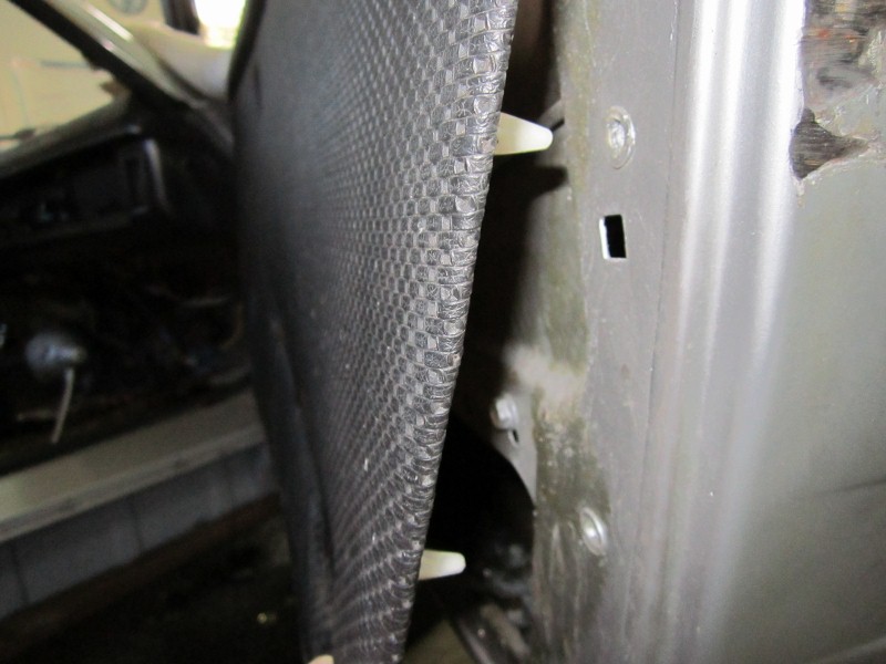

Gently pry plastic door panel clips away from door along perimeter. Then lift door panel up and off.

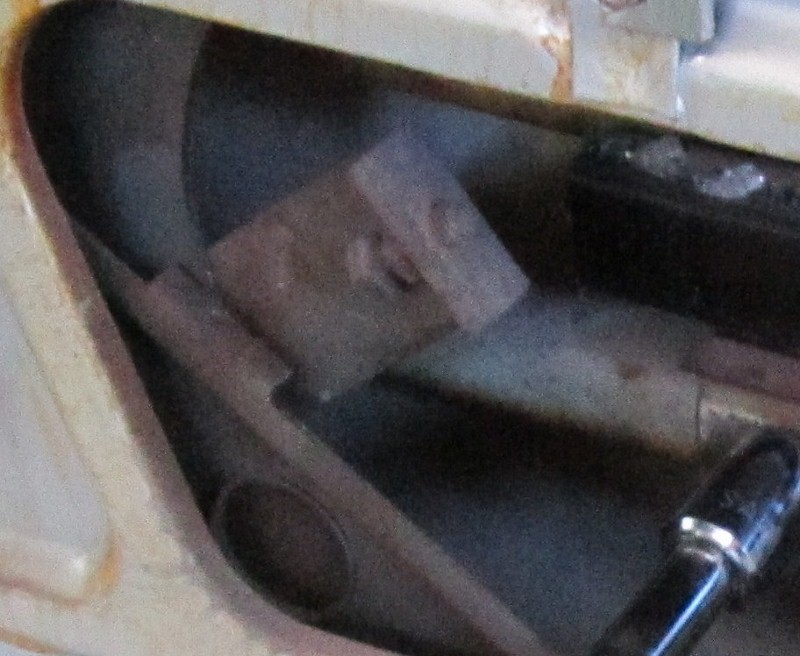

Remove front glass lifter bracket bolt with 13mm socket.
Slide rear actuator arm slider off glass lifter bracket.

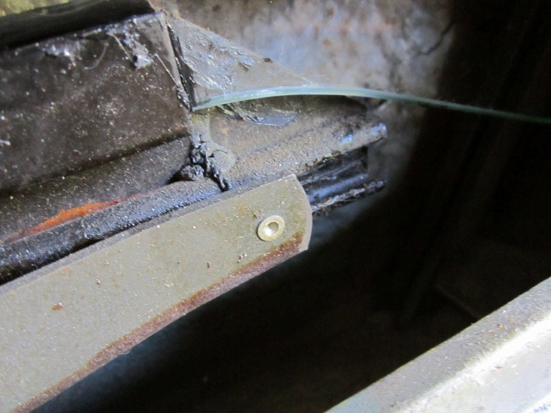

Remove glass lifter bracket from door.- (note- if your window is intact you will need to remove the front guide/vent window first to be able to remove the intact window/bracket).

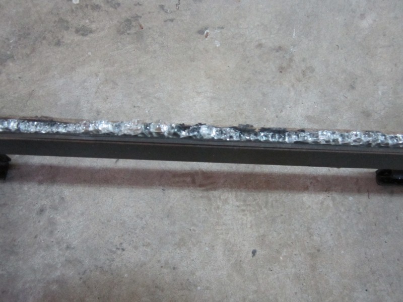

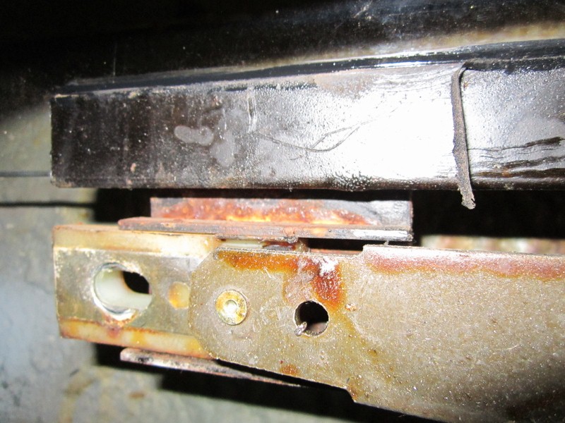

As you can see the bracket has some broken glass remaining in the channel- glued in with urethane.

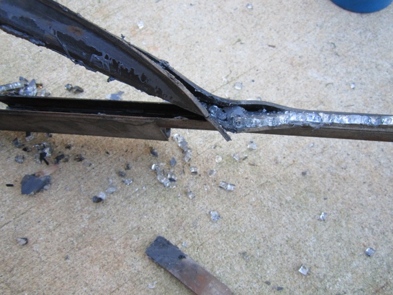

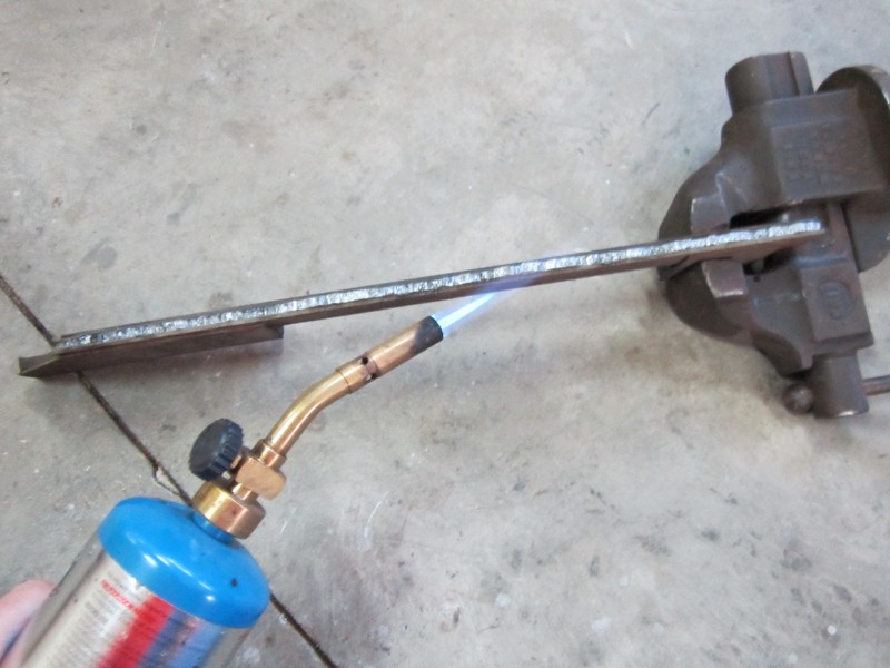

To remove this glass and urethane heat sides with heat gun or propane torch.
Pry up the urethane and it should come right out with the remaining glass. As you can see this glass was installed using a urethane channel approx 1/16" thick on each side. Easier for the manufacturer to assemble the glass and lifter than using squeeze urethane.
Next clean out the bracket channel with 3m adhesive remover, or heat and scrape, or bead blast.

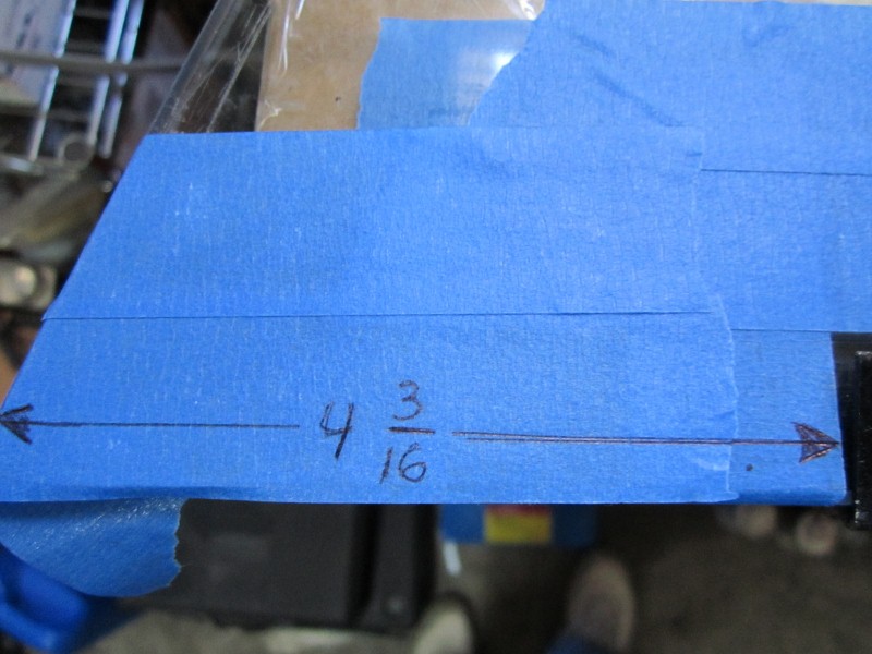

On the glass measure 4-3/16" from the front edge (measured along the bottom edge of the glass!). Place tape on this mark. This will locate the front of the glass lifter bracket. (ok, this may differ for early style regulators and even on late cars. You may have to measure off the other window)

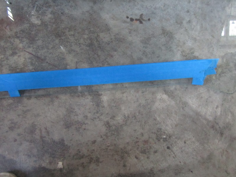

Place the bracket on the glass and tape around it on both side of the glass. This will keep the urethane from getting on the glass where you don't want it.
When you install the glass into the bracket you will need to have urethane on both sides and bottom of the glass. Remember the U-channel shape you removed. This needs to be duplicated. To do so I taped spacers (18ga. wire) to each side of the glass. Trial fit the bracket to make sure it slides over the spacers. Cut 1/4" off the same wire and drop into the bottom of the channel- it will stay there to leave room for the urethane on the bottom.

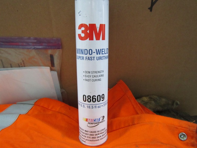

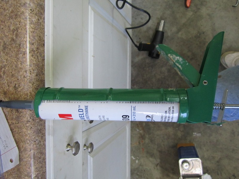

I used 3m Urethane Window Weld. Comes in a tube which fits standard size caulk guns. 3m site says you have about 10-15 minutes before set up. Warm the tube prior because the product is heavy and it will flow easier when warm. Purchased this at the local FLAPS @ 24$. Summit sells it for @17$

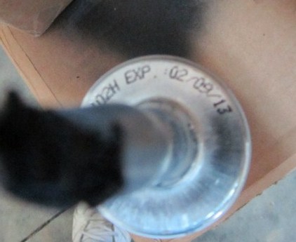

Check the expiration date on top-
Put it into the gun, puncture the top, screw on the nozzle and trim allowing a 1/4" hole in nozzle.

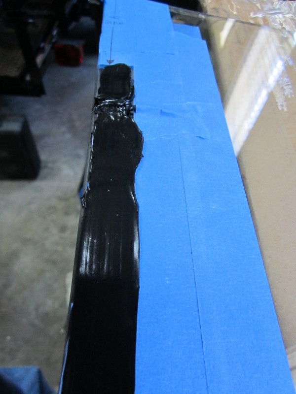

Squeeze a good size bead into the bottom of the bracket.
Squeeze beads on both sides of the glass thicker than the spacers. You have plenty of product here...plenty.
Smooth the beads on the glass but keep it thick- you want it to squish out.
Make sure you have the front edge of the glass oriented to the front of the bracket (don't install it backwards).
Slide the bracket onto the glass aligning the front of the bracket on your 4-3/16" mark. Make sure the spacers go into the bracket.
Push the glass down into the bracket channel. Make sure it bottoms out.
Gently remove the wire spacers.
Squeeze some urethane into the wire spacer holes.
Take you popsicle stick or spreader, remove excess urethane and smooth the urethane around the bracket edges. Make sure there are no holes.

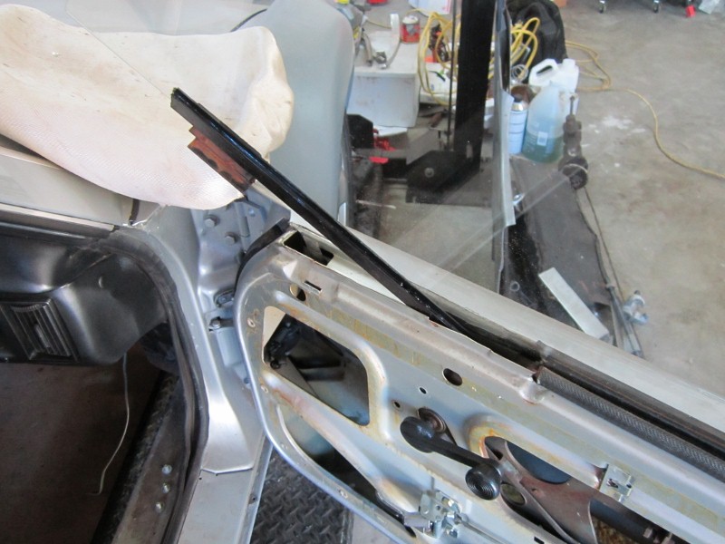

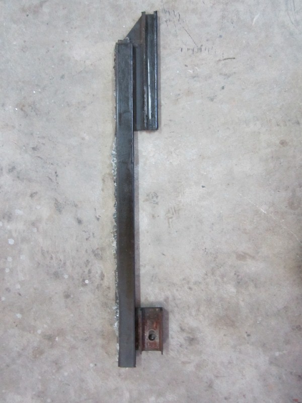

Remove the front vent window and channel.
Three 10mm bolts on top and one adjuster screw on bottom.

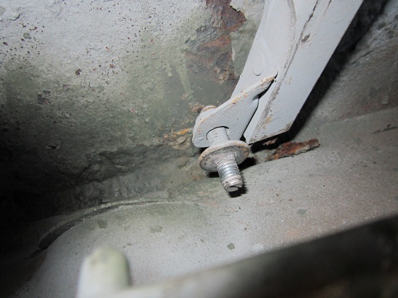

Remove the adjuster screw lock bolt (13mm) then screw the adjuster all the way in with a flat head screwdriver. Count the turns.
Reach in the door opening and gently push the bottom of the vent window channel towards the exterior of the door.
Pull the vent window and channel up until you can remove the adjuster screw from the channel.
Pull the vent window and channel out of the door.

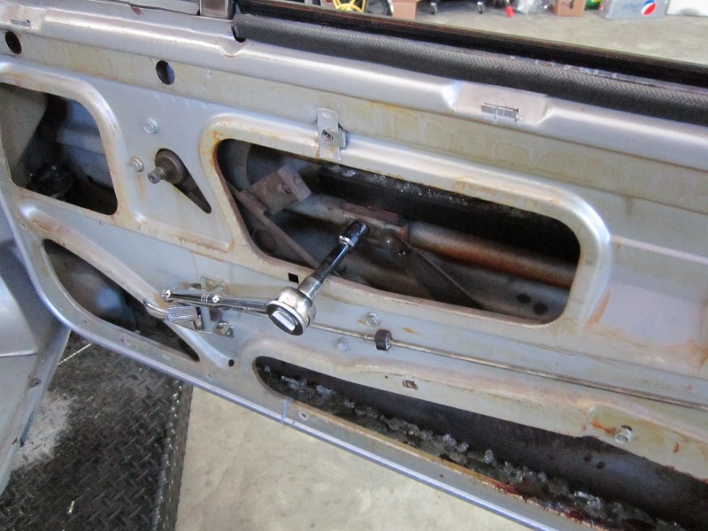

Now slide your door window and lifter bracket down into the door from the opening in
the top front. Don't scratch it!
Gently work the window towards the back until it is inside the door.
Lower the regulator until the sliders are visible in the lower door opening.
