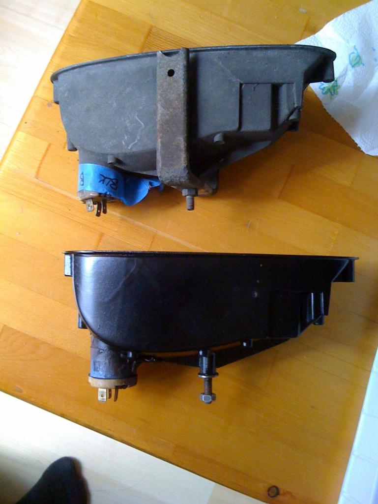

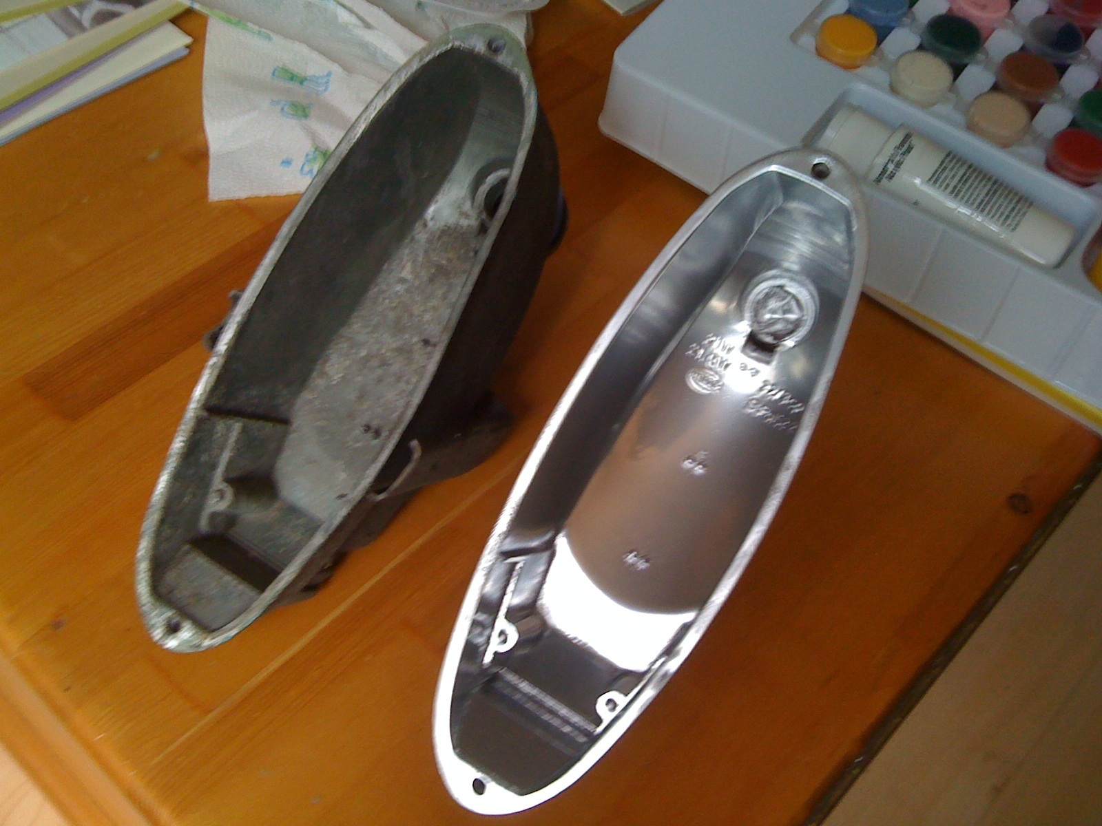

I wire brushed them and painted them with chrome rattle can.
Here is the before and after:

That's what I did to my front and rear buckets/ retainers. 2 years later of daily driving through all sorts of weather, the paint has held up surprisingly well.
It's a cheap way to get nicely reflective buckets.

I just did the exteriors in black. My car is not concours and is a daily driver. There is going to be water and dirt slung all around those signal buckets.

I did the chrome plate paint and also lined the back area with that chrome tape...shinier than the paint.

Nice job Mike. Those look really nice. I used a chrome spray and it wasn't as shiney as yours (IMG:style_emoticons/default/dry.gif) but interestingly enough, I cannot see any difference between the 2 sides at night (IMG:style_emoticons/default/idea.gif) . Oh, the other side is shiny OG chrome and obviously not a satin finish like the one I sprayed. Go figure.

I sprayed the front and rear buckets on the 'BB' with silver 'chrome' rattle-can too. They are definitely more reflective than when I first got the car.
The car has pretty much been sitting outside for a few years and the buckets still look good.
