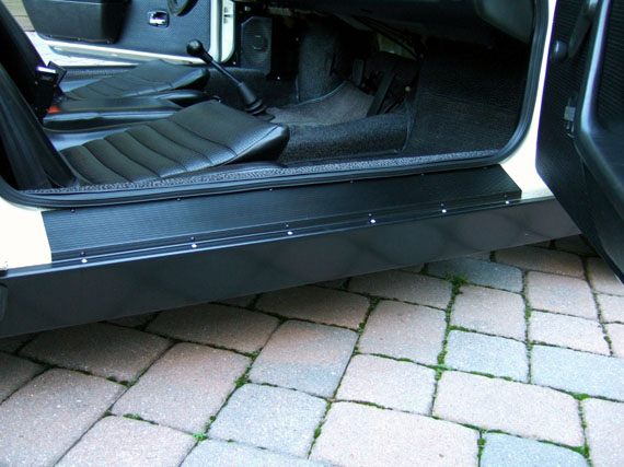

1970 Neun vierzehn
post Oct 27 2012, 09:11 PM
Posts: 3,199
Joined: 16-March 06
From: cincinnati, ohio
Member No.: 5,727
QUOTE(speed metal army @ Oct 27 2012, 06:32 PM) *
QUOTE(Mikey914 @ Oct 27 2012, 06:25 PM) *
The larger sill goes on the door threashold, the carpet strips have the edge without the screws covering the inner door seal clip on the seal.
Yes,.
The larger of the 2,does it slip uner the rocker?Or sit on top?
Should look like this.......
speed metal army
post Oct 27 2012, 09:51 PM
Waiting for the rain to stop...
Posts: 1,068
Joined: 4-September 10
From: PNW
Member No.: 12,137
QUOTE(1970 Neun vierzehn @ Oct 27 2012, 08:11 PM) *
Yes,.
Yeah yeah early car guy!
I cant tell from the photo,but it looks like the trim slides under the rocker...Also,the correct threshold trim is plastic for the late cars.Was there even the small piece of threshold trim?

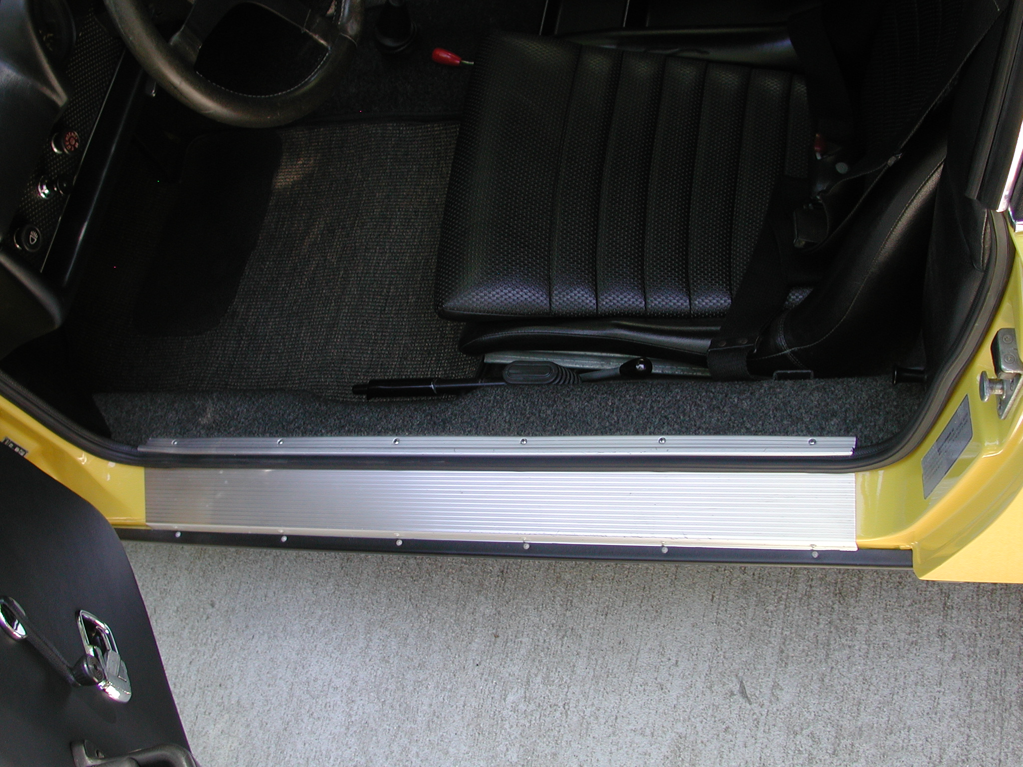

1970 Neun vierzehn
post Oct 27 2012, 10:31 PM
Posts: 3,199
Joined: 16-March 06
Member No.: 5,727
Here's a pic from a '75. It appears that both early (my 1970) and late (the pictured 1975) have the threshold plate sitting on top of the rocker panel.
Paul
speed metal army
post Oct 27 2012, 10:38 PM
Posts: 1,068
From: PNW
Member No.: 12,137
Thanks Paul!
