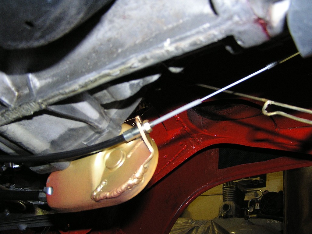

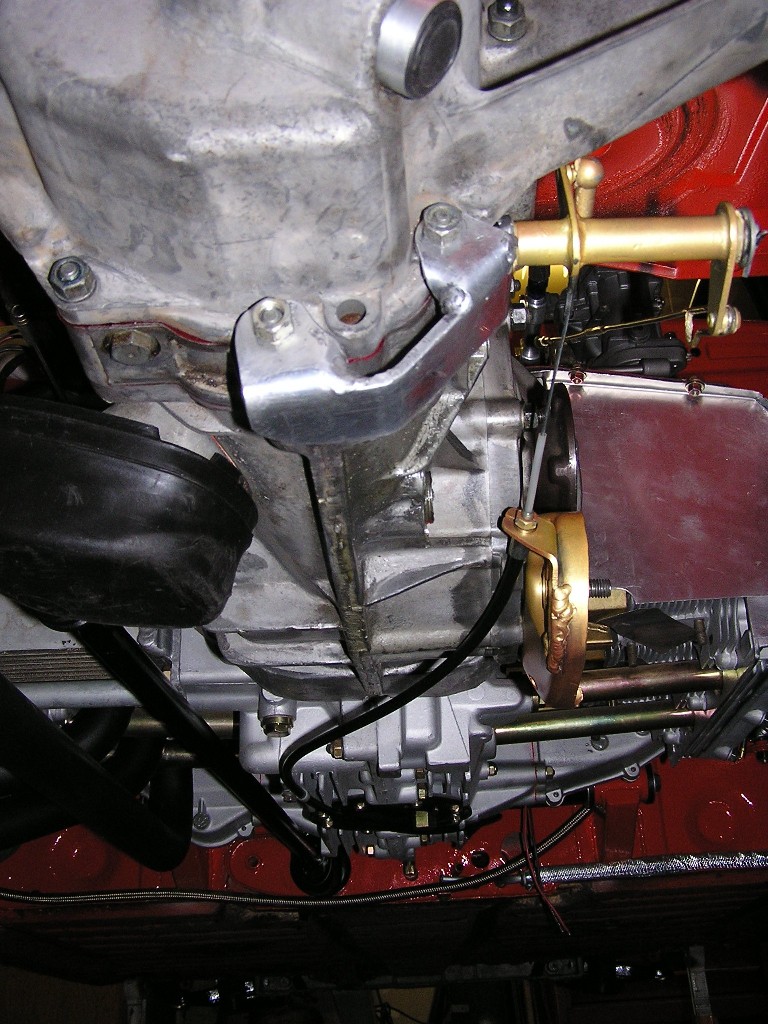

throttle cable from the back of its mount.
Its a stock -4 cable (easier to find in a time of need)
we took an extra snap-on ball from the front of a stock cable and solder-filled it in. Then re-drilled and tapped it to screw onto the back of a stock cable.
as I mentioned previously, the bell-crank mounting bracket is aluminum. The throttle cable bracket is (obviously) welded onto roller console:

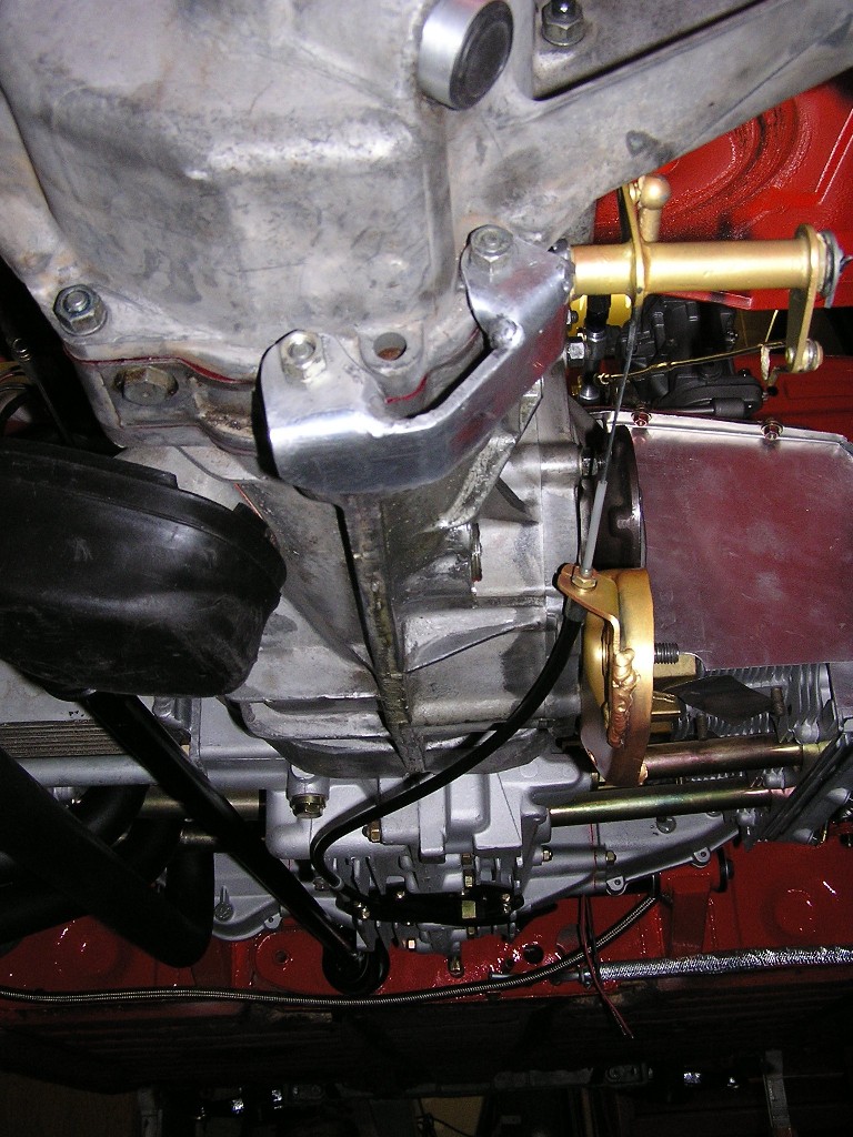

last one of the bellcrank. Here you can see the aluminum bracket better. This way I should be able to unbolt my whole throttle set up and move it to a 2nd tranny without having to tap every tranny case for a -6 bellcrank

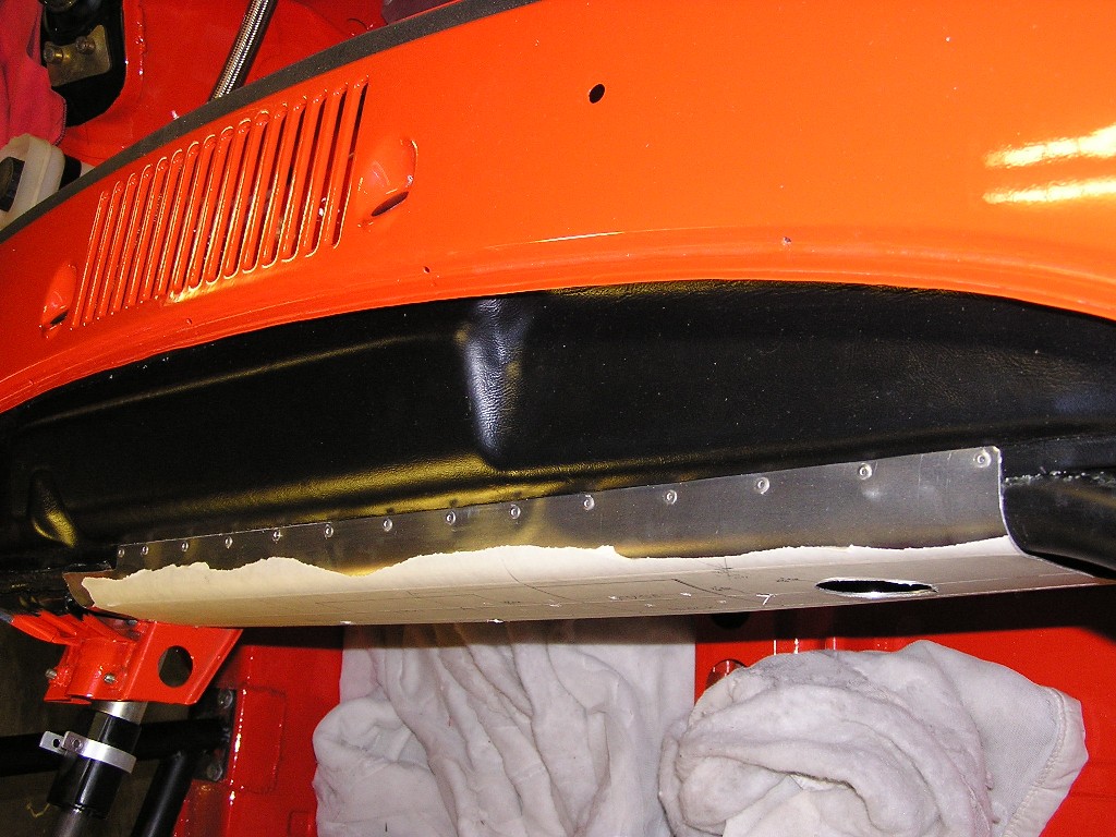

oh.. you can also see a part of the tin work my dad fabricated... That shiny piece is the one. When we removed the stock 911 tin work it was open here... so dad sealed it off since we are not running any 914-6 tin:

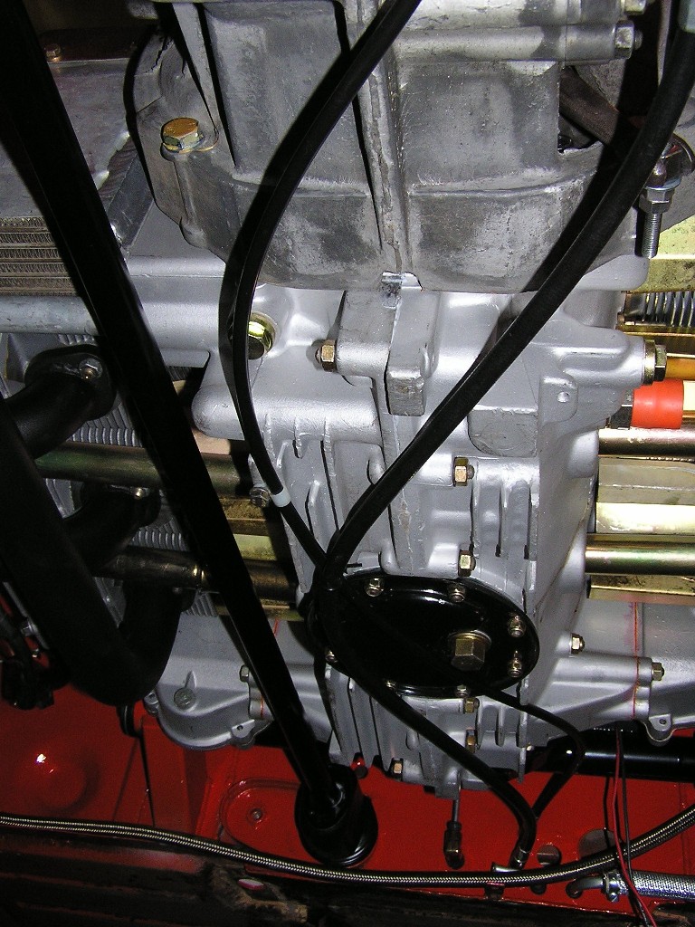

cable routing for the new set up.
Also got the shift rod installed. Its got the delerin bushing in the firewall, brass bushings in the knuckle. Knuckle is turned 90degrees, brass bushing where the bar passes through the console, and an extension on the cup where it slides onto the shaft/ball. We made the bar as straight as possible, with only the slightest curve on the back 4-6 inches:

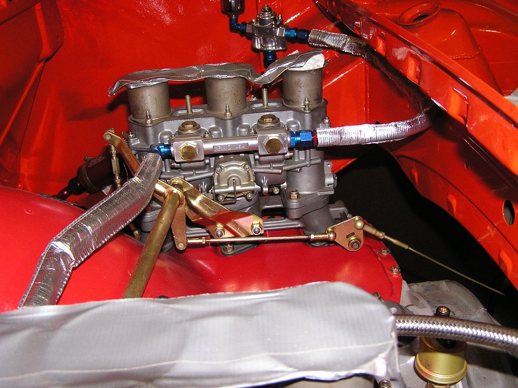

Top of the throttle linkage.
plus we got most of the heat cover, and fuel lines installed:

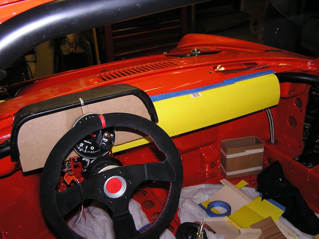

Member No.: 47
Last one for now.
We are doing some of the preliminary interior lay out.
We are building a new dash which will be aluminum (except for the guage pod) when we get done. Here are some of the templates in all there glorious colors:

Hi again...
fairly productive Christmas weekend really.
we roughed in the dash.. Took forever!
Anyways I'll post a few shots of it.
Its far from done, but at least its started...

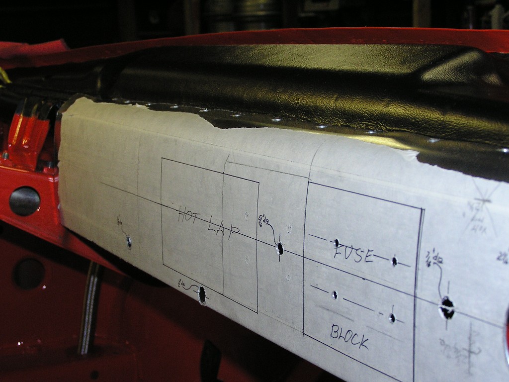

I'm doing a stock looking guage pod, which is not ready for its debut yet... but here are pictures of the larger part of the dash where it runs across the car in the stock-ish location.
Its made from aluminum sheeting, and then rolled over the tall knee bar behind it.
In the pictures its partially covered with masking tape still (which we used to reduce installation scratches):
