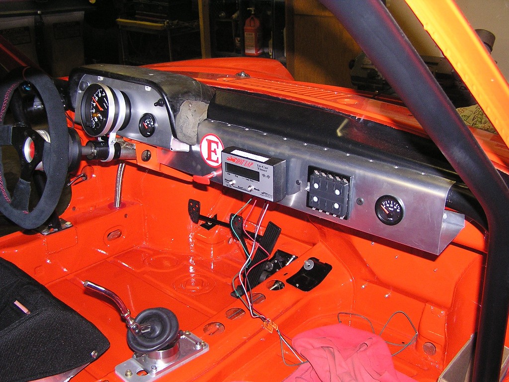

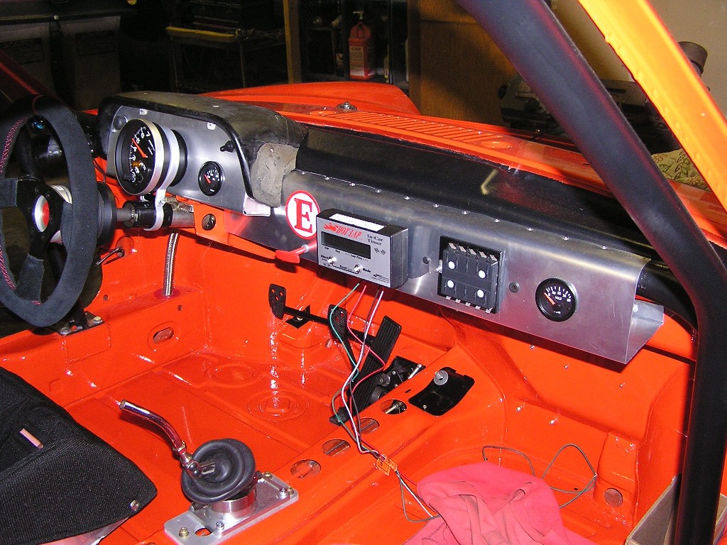

From the other side. Volt-meter was missing in that last shot, but installed in this one.
We're running a hotlap and next to it is our fuse panel
(aluminum tach mount, was another of dad's little creations):

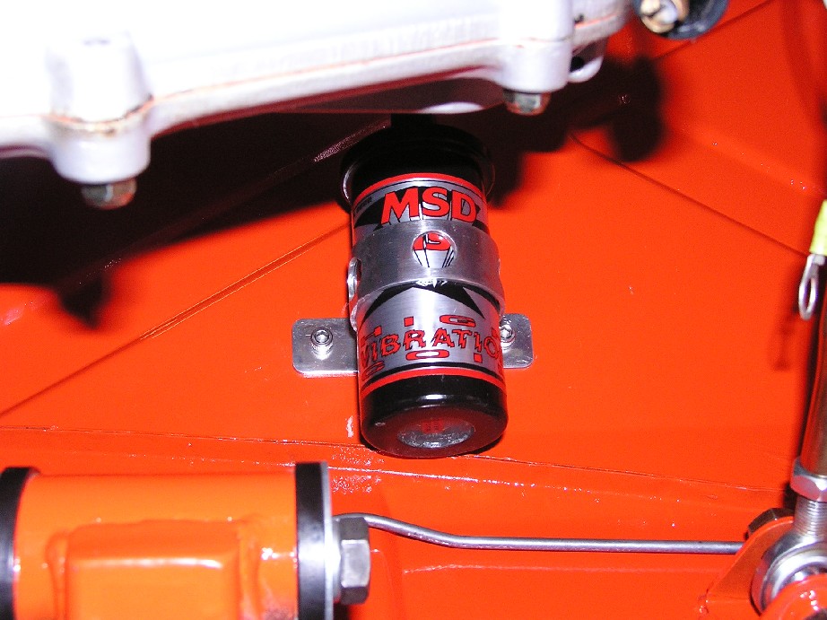

Spent a short weekend working on the car... mounted a few things and took more pics to document.
Here is the coil location we picked with dad's coil mount:

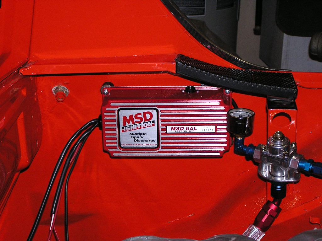

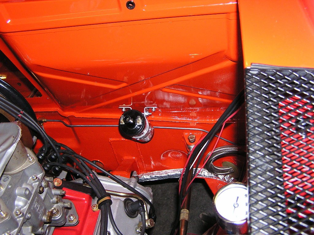

Still haven't yet created our wiring harness.. Thus the wires hanging everywhere.
but here is the MSD location:

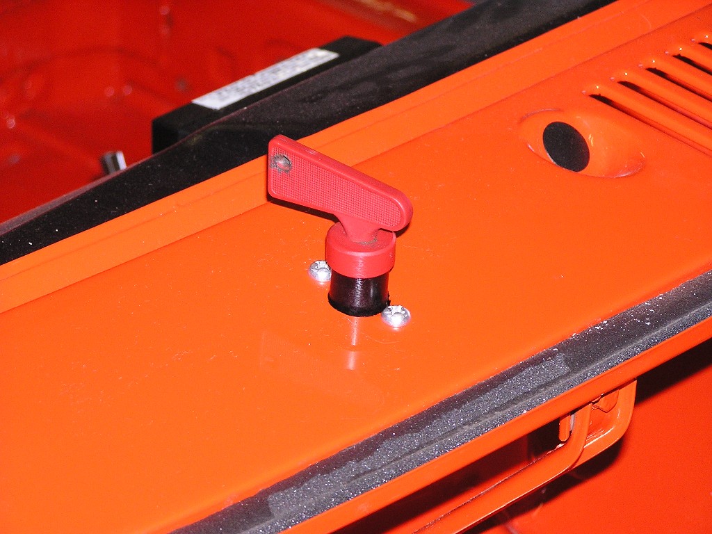

Mounted the kill switch
(which now needs wiring completed also)

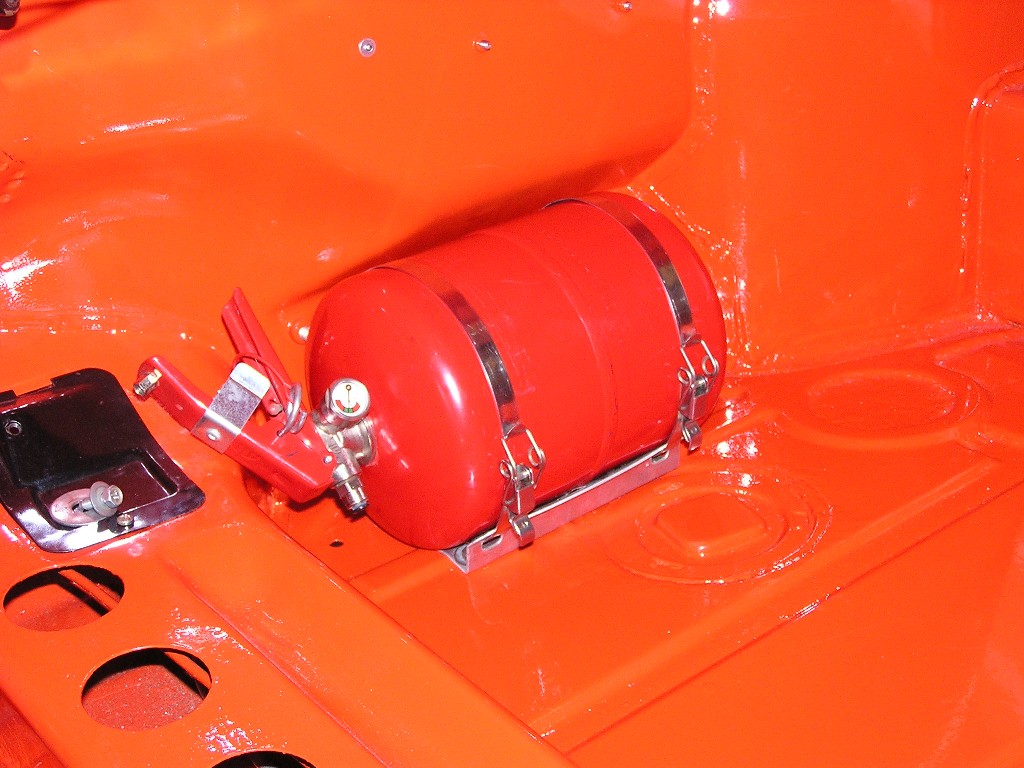

Member No.: 47
Mounted our fire bottle
(not plumbed yet)

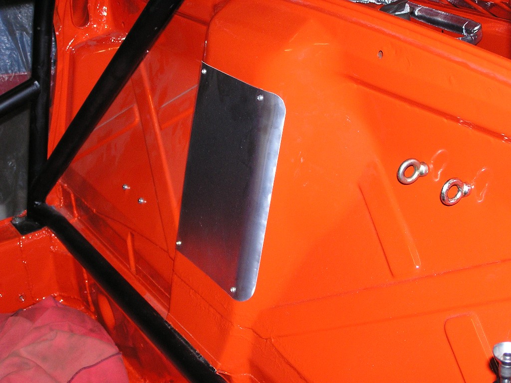

Here are the cross brace mounting support straps:
brant
post Jan 24 2005, 05:11 PM
Post #198
Posts: 12,279
From: Colorado
Member No.: 47
and I've applied for a waiver with the Captain regarding this one.. haven't heard back from him yet...

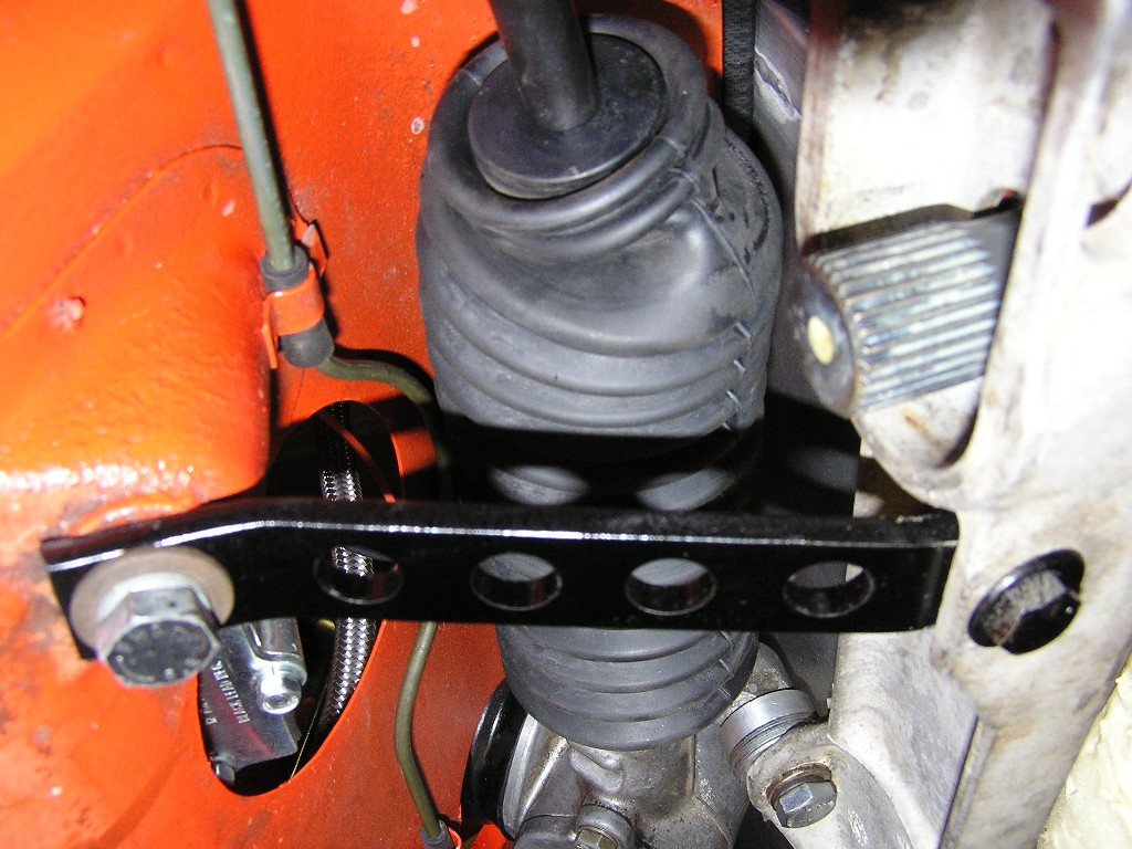

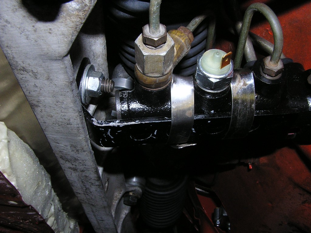

These aren't all that clear, but here is our MC brace. This came up in a different thread. We've run this same brace on our -4 cylinder car for 5-8 years. It takes out the "flex" in the floorboard. Its easy to bolt it onto an aluminum cross-brace, but shouldn't be too hard to weld, or bolt to a stock steel cross-brace:
