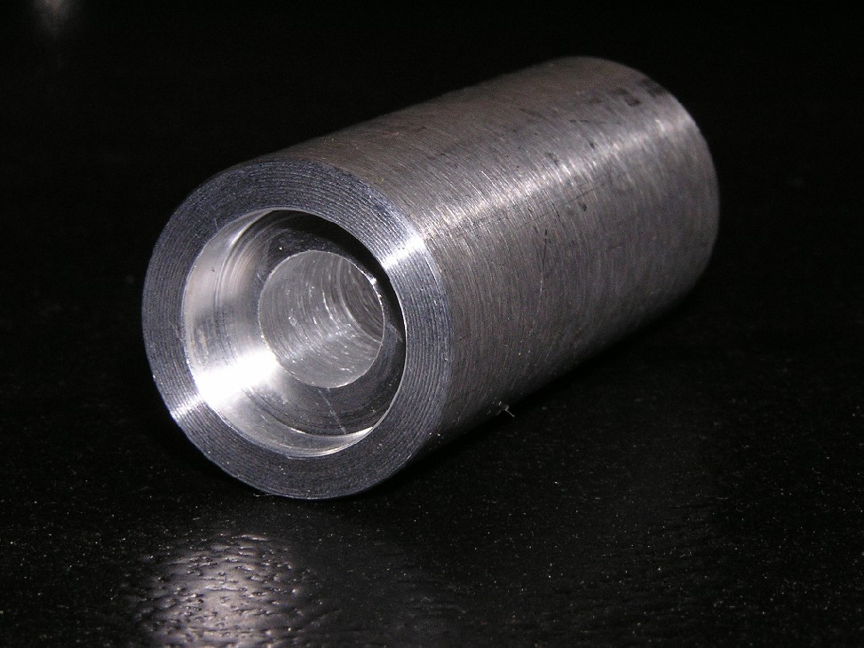

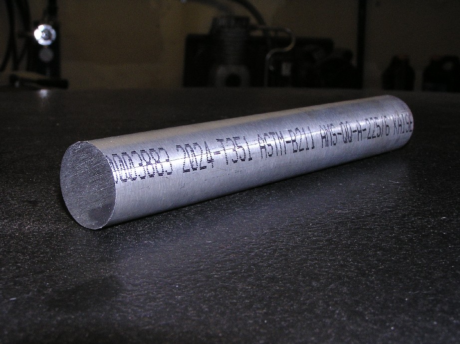

Regarding the last picture of the shock bolts. here is a picture of the stock they were made from:

And here is a picture of the seat mount spacer made from the same stock. The seat needed a tiny spacer to help with fittment. They have a welded on mounting nut, so the spacer was machined out to fit that nut. Came out really nice:

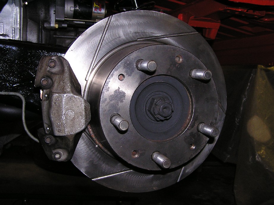

As mentioned, finally got all the brakes bled and sorted.
Front and rear are all using KFP gold pads. I really have had good experience with these on the track and have been using them for years.
Rear rotors are not allowed to be vented (my old car was)
They also do not allow cross drilled. So these are stock 914/6 solid rotors that AJRS hand machined the slots into. Rear brakes must remain porsche from the era, so were just using front early calipers moved back, as we have had good experience in the past with similar set-ups.

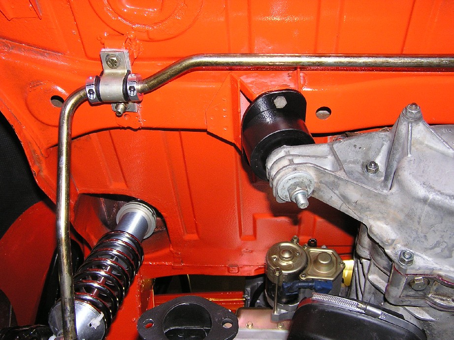

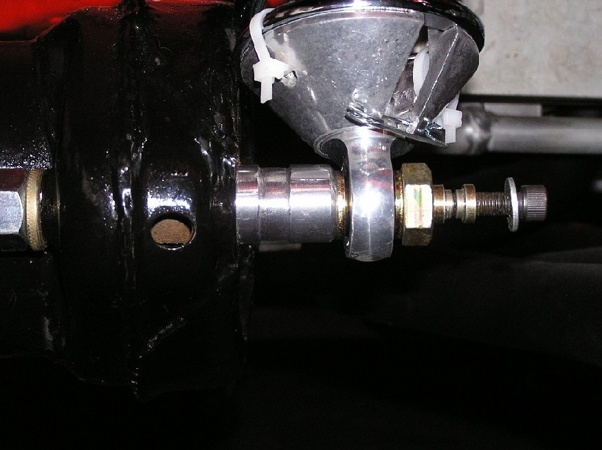

Got the rear sway partially installed this weekend:
brant
post Feb 22 2005, 05:51 PM
Post #212
Posts: 12,279
From: Colorado
Member No.: 47

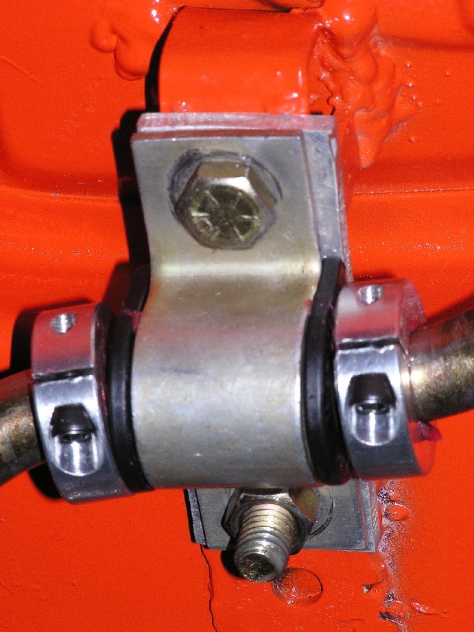

for the top part of the bracket we used an aluminum block. The locks are aluminum too. Mike Mueller turned me on to these, and they work really nice!

Brant, I think you have 2 locks more than needed
(1 lock per side is enuf)

QUOTE (Jeroen @ Feb 22 2005, 05:41 PM)
Jeroen,
I only have 2 total.
probably do to my homemade mounts, I seemed to have more room on the drivers side than passengers. I would have rather had them on the right, but they fit better on the left. Only 2 total though.

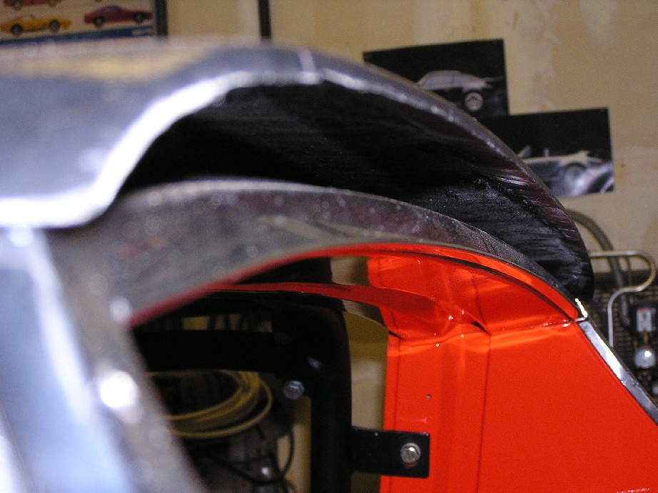

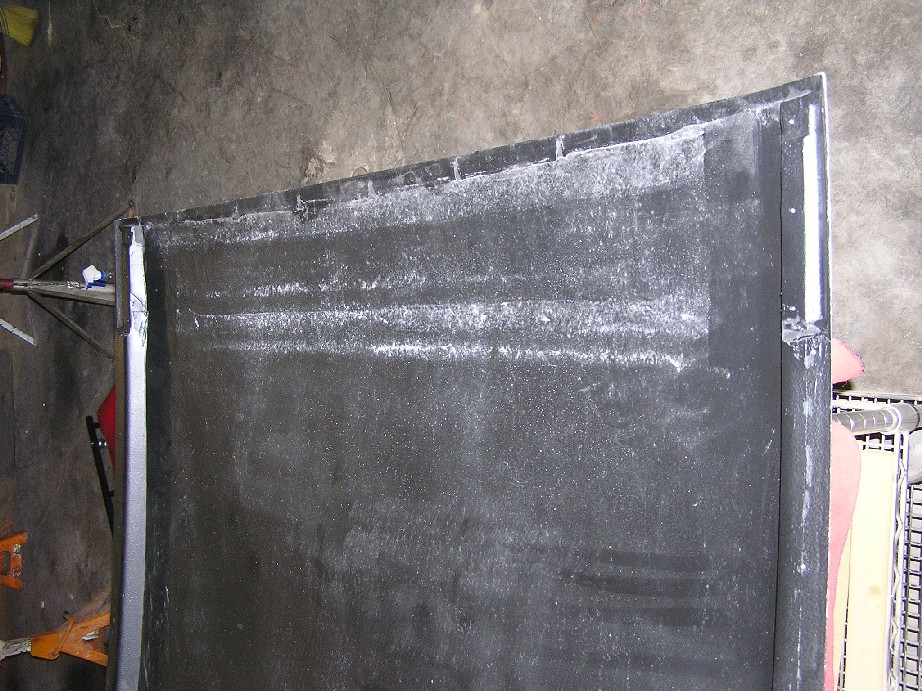

Still haven't installed the dzus fasteners, but the roof panel is nearly done. I took 36grit paper on an electric grinder and cut out the rear brace entirely. Also thinned the entire panel. (in fact I thinned it a bit too much and had to go back and fix a spot where I started going through)..
New roof weighs 11lbs
plus I've now got a decent slot over the targa bar to vent air:

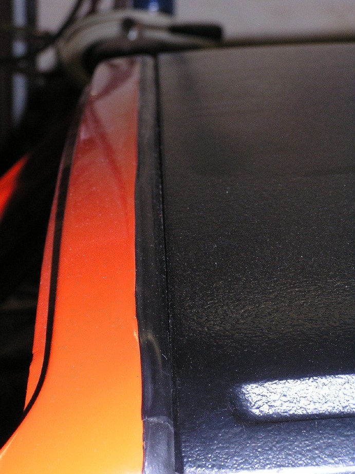

Here is one of the rear edge of roof when installed:

Thanks to Mark/cloudbuster, here is shot of the roof with a good front rubber:

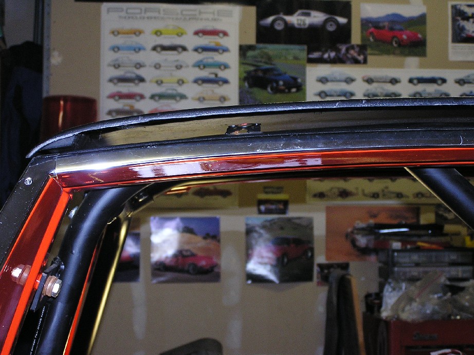

last one of the rear view:
