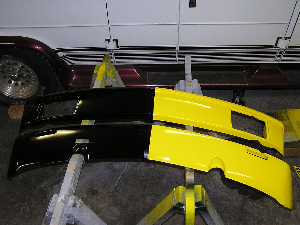

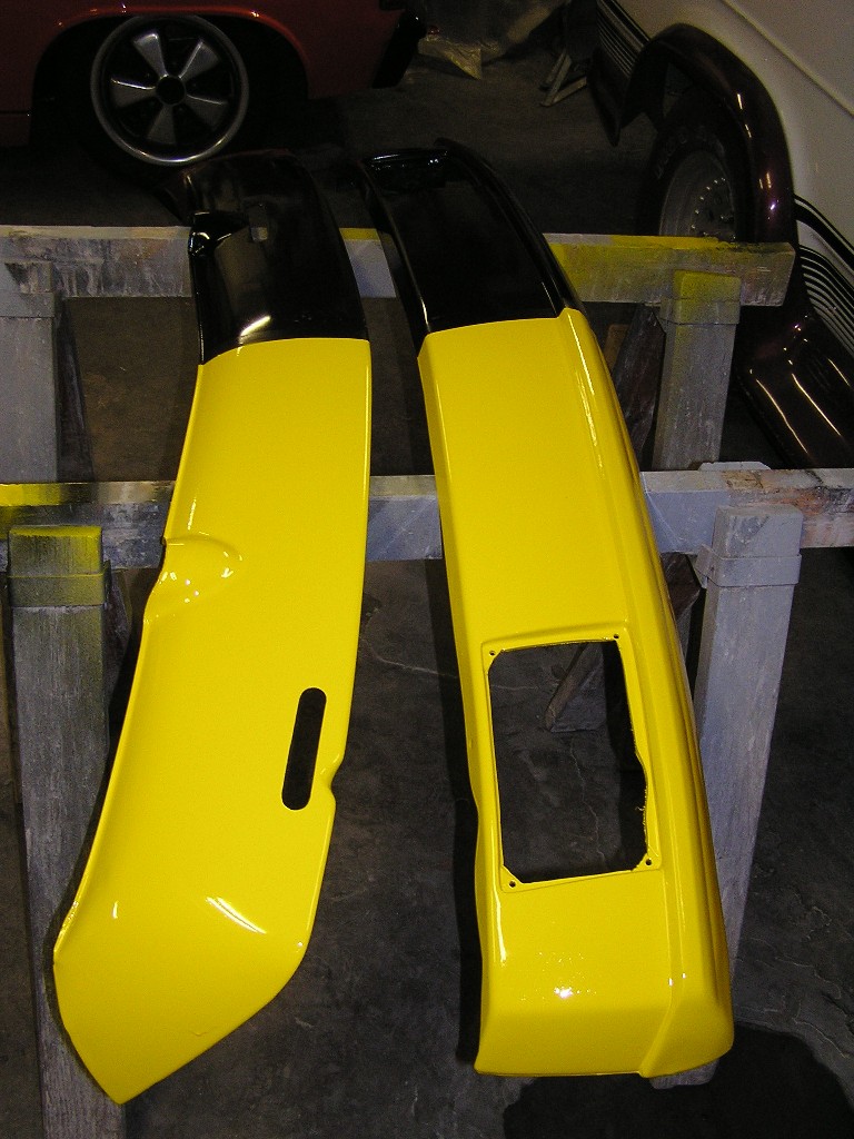

more painting.
So here is the color scheme for the front bumper:
brant

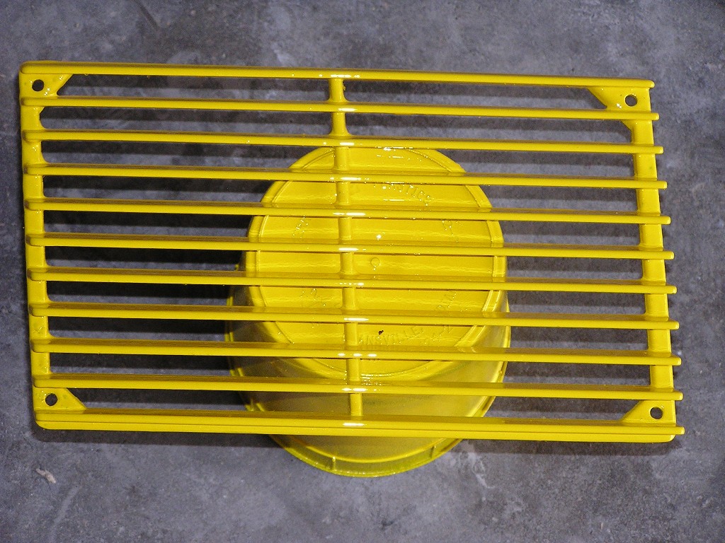

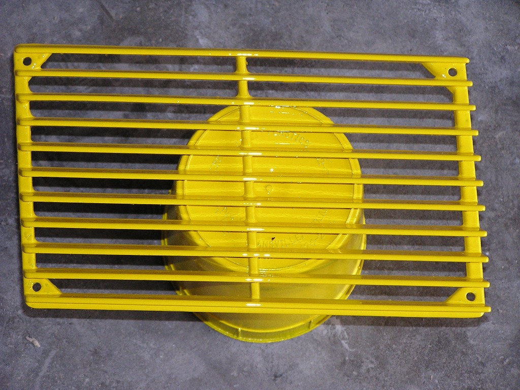

Thanks to the list and its wonderful members, I was able to come up with Horn grills for my set up:
Ferg

sweet, i can't remember if i've seen it but what exhaust you gonna use.

dude! those bumpers are hot! (IMG:http://www.914world.com/bbs2/html/emoticons/wub.gif)

last shot of the front bumpers.
I couldn't mount them yet, due to the paint not being fully cured:

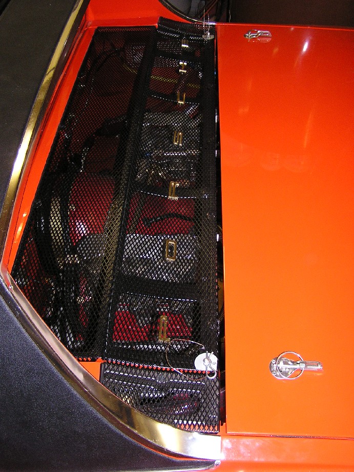

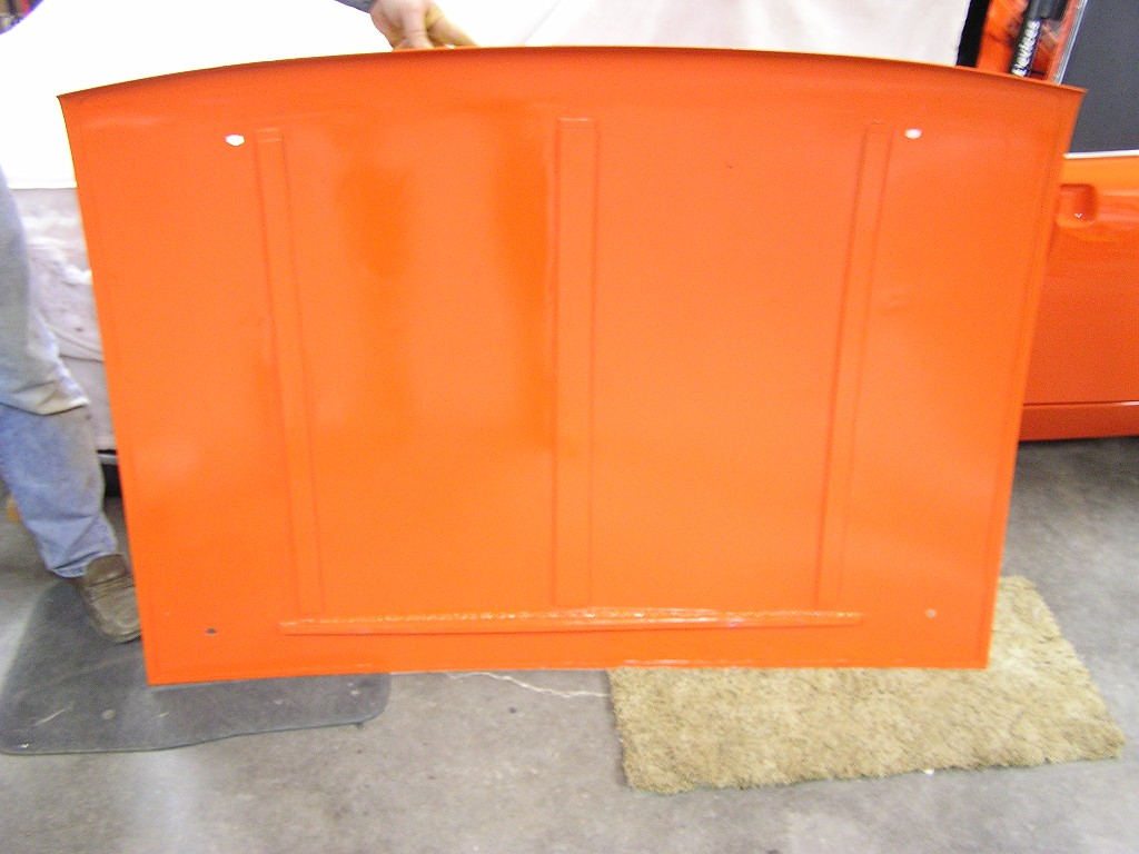

last of my pictures for now.

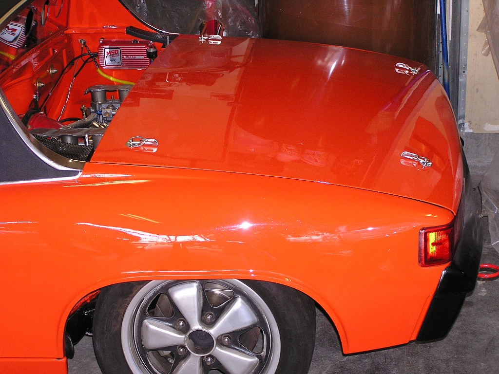

One last thing we got done was to mount the rear trunk lid. I've alluded to this lid before, and I'm pretty happy with the way it came out. Its a stock lid but with balsa wood reinforcement for a total loss of 11lbs. We bonded aluminum stops onto the lid and then cut balsa wood strips that are just long enough to have to bow (giving the lid the correct shape)
Here is what I mean:
brant
post Apr 6 2005, 03:15 PM
Post #291
Posts: 12,279
From: Colorado
Member No.: 47
Close up of the same:
brant
post Apr 6 2005, 03:16 PM
Post #292
Posts: 12,279
From: Colorado
Member No.: 47
Like I said, I'm pretty proud of it and it is still a metal hood as per the rules. Here it is mounted on the car:
brant

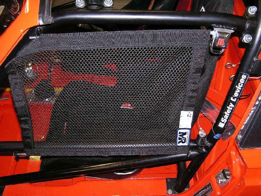

Another weekend passes, and a little bit more progress.
Here is the window net and hinged drivers side bar:
brant

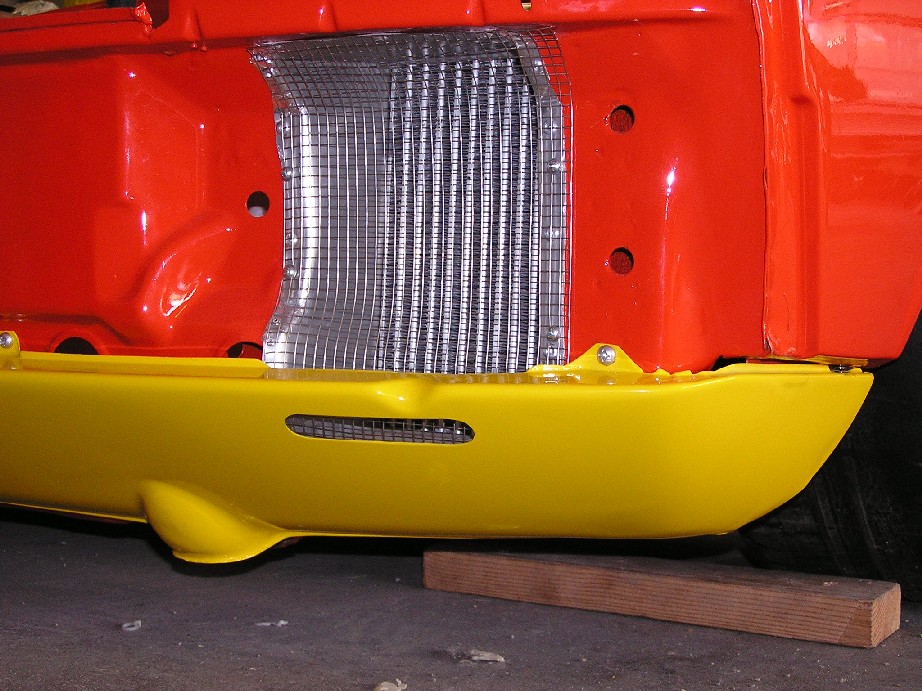

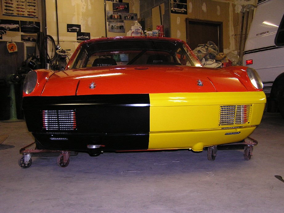

Finally got the front valance mounted.
The extra slot is additional air intake for the coolers:
brant

Spent Saturday morning re-painting the black half of the front bumper. I was trying to buff out an flaw in the paint and buffed through... So out came the equiptment and masking tape for a re-shoot.
Twas worth it though, I'm pleased with the finished result.
Front hood, head light doors, and turn signal covers mounting is still not finalized, but I needed to submit log book photos so here they set:

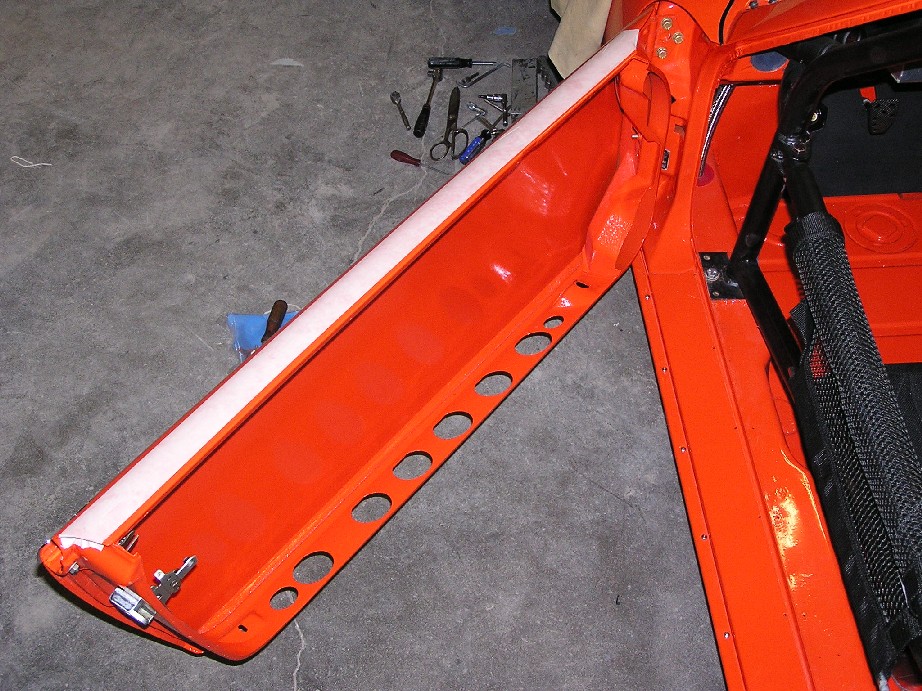

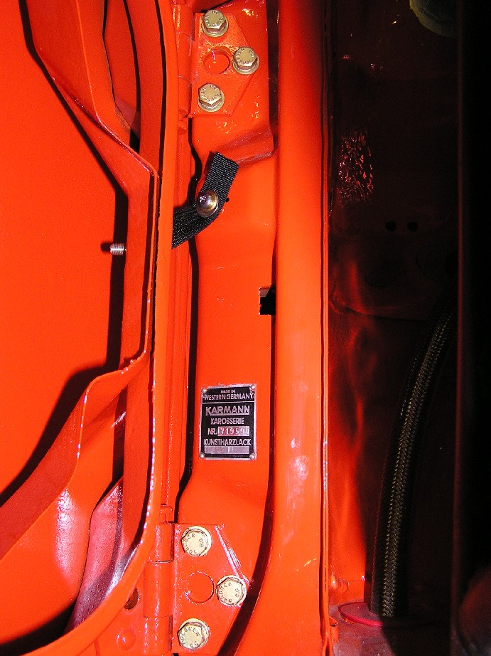

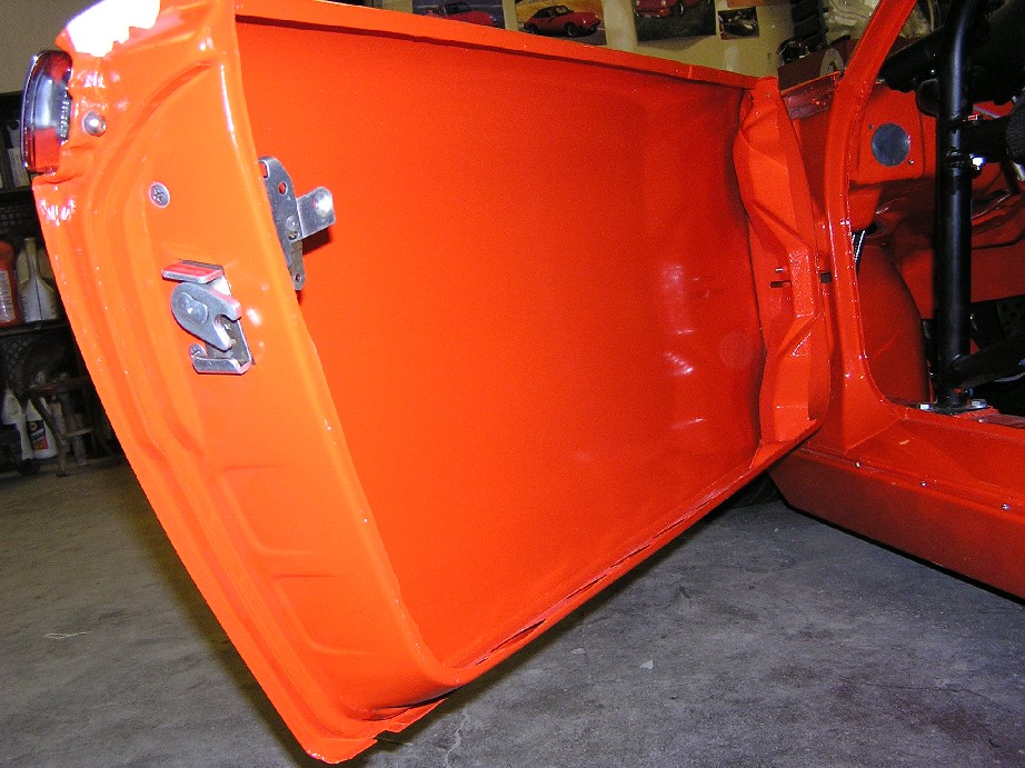

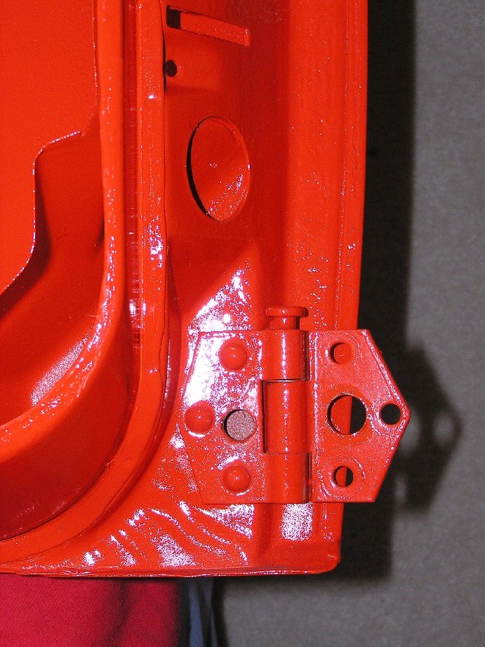

Worked on the doors. Still haven't finished the aluminum interior door panels yet. Here is a shot of the forward door hinges, with a few extra holes in them:
brant
post Apr 18 2005, 09:07 AM
Post #298
Posts: 12,279
From: Colorado
Member No.: 47
Here is drivers side mounted.
17lbs and still metal:
brant
