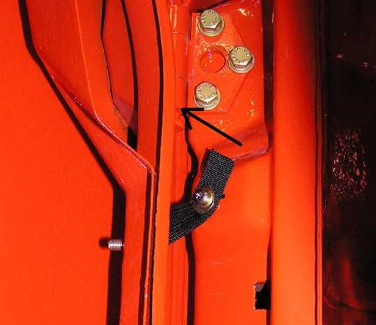

on a slightly related note...
I was thinking about grinding off the bottom part of both the door hinges (see arrow in pic)
That way, you could easily lift the door out (put them out of the way when working on the car)
Still... I can't even get the friggin' pin out of the hinge
Is there a secret to that?

QUOTE (Jeroen @ Apr 18 2005, 08:20 AM)
I couldn't get those pins to budge.
part of the reason we took the door off by pulling the 3 bolts and leaving the hinge on the door.
hanging the doors and getting the gaps is so tough. Speaking only for myself, if I was removing the doors frequently I know I scratch the heck out of the paint!
but thats a good/creative idea!

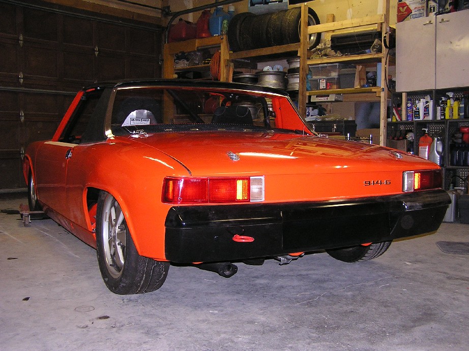

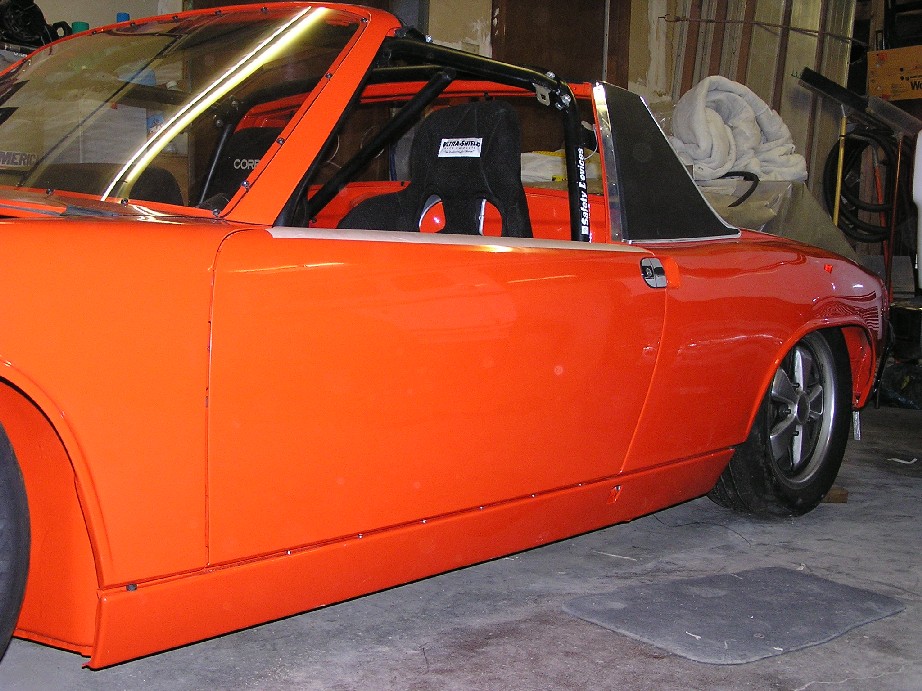

Door gaps are not perfect... but sure looks better mounted than it did in the closet for 6 months.
Lots of rear fender clearance:

I know I'm repeating myself, but I'm real happy with the way the fenders came out and I love this view:

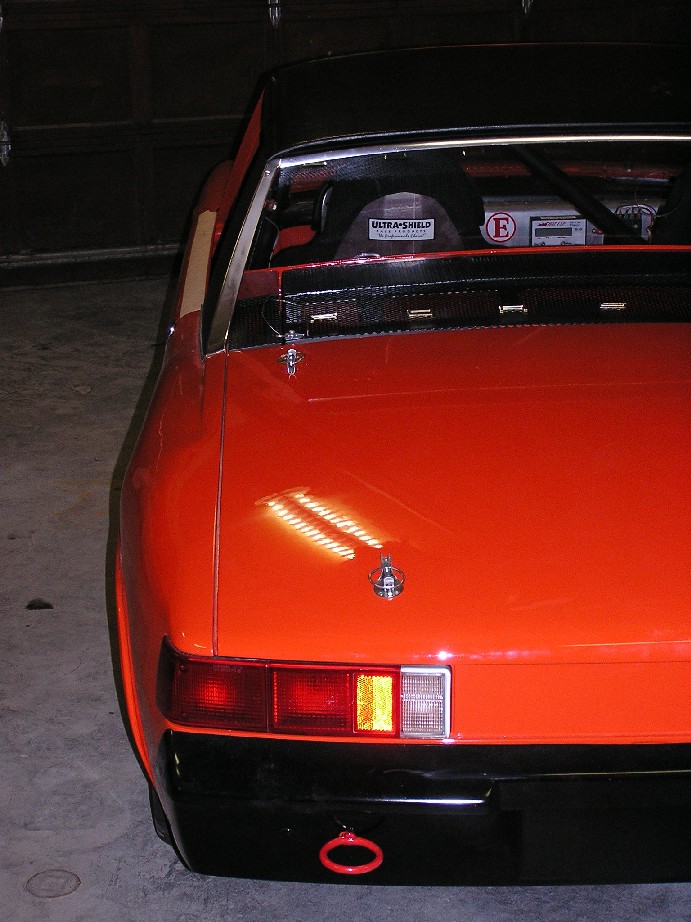

Still needing to do an exhaust:
brant

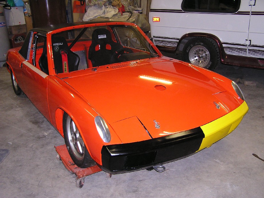

Passenger side door is on.
I have a neat little aluminum fuel door that isn't on yet, but I'm waiting on clear bra in order to finish the front end up:

QUOTE (brant @ Apr 18 2005, 07:09 AM)
our version of a door stop. Lighter than the stock metal one:
I always wondered if you could just use the little cable ones for Type 1's when they put the 1 piece windows in? (IMG:http://www.914world.com/bbs2/html/emoticons/idea.gif) Lighter, simpler, cheap. (IMG:http://www.914world.com/bbs2/html/emoticons/idea.gif)

QUOTE (Root_Werks @ Apr 18 2005, 09:00 AM)
As always Brant, your work amazes me, looks great! (IMG:http://www.914world.com/bbs2/html/emoticons/smilie_pokal.gif)
I'm not familiar with the type 1 version....
but I was thinking about cable also.
In fact I may still change out to that.
These stretch some, and I set them so that I would have 5 inches of safety margin from where the door starts to hit the strap and to where it would create damage.
Still 5inches wouldn't be a lot if the door got whipped by the wind.... So I was thinking about changing over to a more rigid cable.
You're rear fenders , Did you add metal ? or just beat em.

QUOTE (sixnotfour @ Apr 23 2005, 09:13 PM)
Nice !! They look so much better on the ground (IMG:http://www.914world.com/bbs2/html/emoticons/smilie_pokal.gif)
Its sad...
but they look short to me when on the ground, because I'm so used to always seeing mine on jackstands.
regarding the fenders...
a little bit of everything including the kitchen sink.
We even had a scissor jack in to stretch things for a while.
